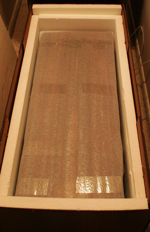

The speakers arrived, as you might imagine, in the hands of some very perturbed delivery drivers. While they were kind enough not to take out their emotions on their packages, they certainly weren't shy about expressing their displeasure at having to move around nearly 90 pound boxes. It was with a smile that they left them in my foyer for me to manhandle alone. Usually I'd take a picture of the speakers in the box outside for better lighting and setting. This time you get them in my hallway since moving them (other than sliding them across the floor) was out of the question.
HT2-TL_box1   HT2-TL_box2  HT2-TL_box3

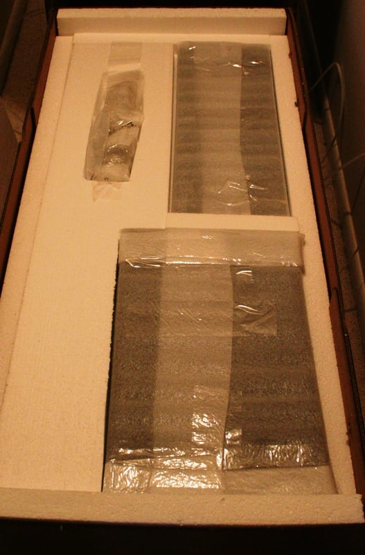

As you can see, Salk did an excellent job of packaging. Foam encased the entire speaker with cutouts for the feet and plinth. With the SongTowers the packaging had been pieced together from raw pieces of foam, with the HT2-TLs it was much more custom. I much prefer this as it means that the speakers are better protected and that customers can assume that each speaker will be packaged identically. Every component was wrapped in foam-paper for additional protection. I commend Salk for leaving out the cotton sock which many would expect at this price point. Handling a speaker at half the weight in a sock is a chore, at ~87lbs, I'm sure some lawsuits would be filed for dropped speakers or crushed feet.

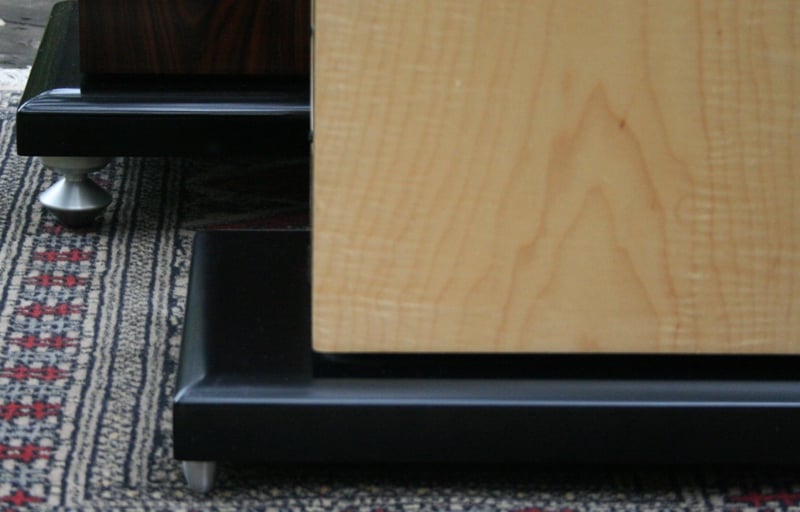

HT2-TL_bottomThe first thing you'll need to do is attach the plinth and the feet. This is fairly easily done with the supplied hardware but you'll need a socket wrench. You'll also want to make sure that the plinth is even on every side. There is a little wiggle room so positioning will be important. Once you secure the plinth (not too tightly or you risk pulling out the threaded inserts), the feet are screwed in by hand. The plinth actually mounts onto the bottom of the speaker that has been routed out about 1/2 inch so that the speaker appears to float about 1/4 inch off the plinth. This seems to be a fairly common practice in speaker design and one that I can't say does anything for me aesthetically. But it does seem to be popular.

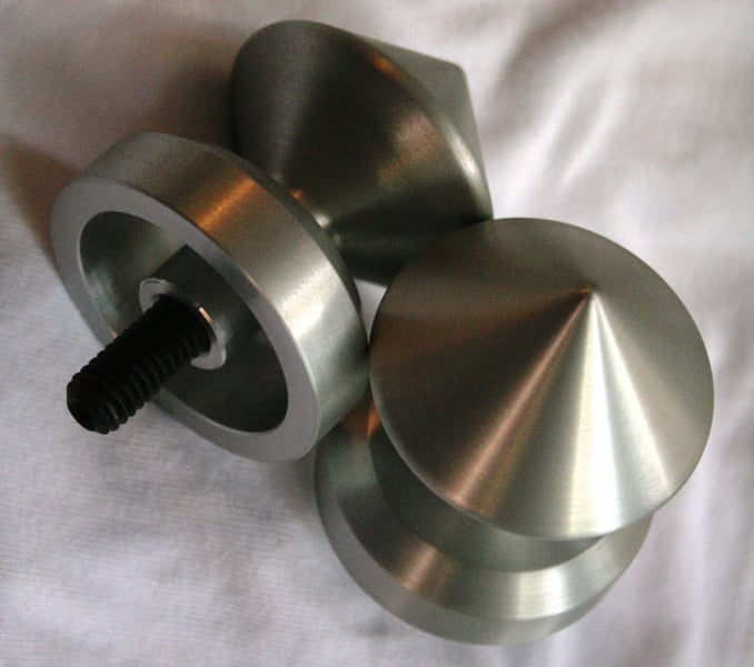

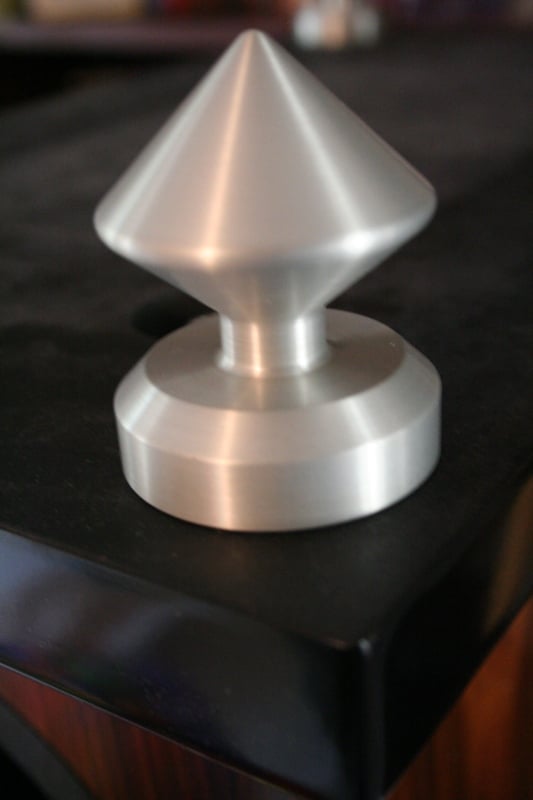

The feet (I hesitate to call them "spikes" because they aren't) are probably the most unique design I've ever seen. They are extra bulky with a metal base that seems at first blush to be completely superfluous. The entire foot assembly measures about 2" high with the first 1/2" of that in the metal base. It then tapers down and flares out again. Finally, it tapers down to a point that is even less sharp than the one I complained about on the SongTower spikes. These feet are definitely not meant as carpet spikes which are, by definition, sharp and designed to pierce the carpet making solid contact with the ground underneath. That being said, at around ~87lbs a piece, they probably don't need carpet spikes.
HT2-TL_feet      HT2-TL_foot_installed

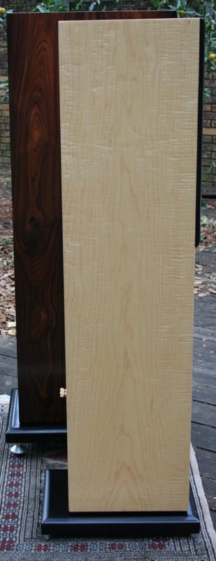

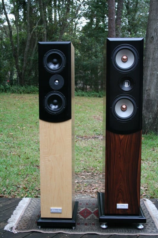

HT2-TL_compare1I slightly misspeak when I call the HT2-TLs behemoths - they are very similar in size to their smaller cousins the SongTowers. The most notable size difference is in the depth. While the SongTowers are a full foot deep, the HT2-TLs add 5 inches to that dimension (note, you can request the enclosure be built with 3/4" MDF which allows them to reduce the depth back to identical to the the original HT2's (15") without changing the internal volume). It isn't until you take off the grill that you notice some of the most significant changes. Gone are the 5" paper cone SEAS midrange and Hiquphon QW2 soft dome tweeter. Instead you see the 7" SEAS Excel W18 midrange (magnesium/aluminum alloy cone with copper phase plug) and LCY-110 ribbon tweeter. It is here where the extra height in the feet starts to come into focus. Rather than redesign the size of the box, Salk Sound, it seemed to me, decided just to make the feet bigger. Why? Well, the 7" driver pushed down the tweeter ~2". To get the tweeters to the optimal height (ear height when seated) that distance had to be made up somewhere. Salk chose the feet much to my wife's chagrin. Personally, I don't mind the feet - I think they are different and unique. Aside from outriggers, these feet allow the easiest adjustments I've ever experienced. The missus on the other hand thought they looked "stupid." Oh, well, can't please everyone. According to Salk, these are the same spikes they normally use on all Veracity models. They also have a "bullet" version for those who do not care for this design similar to the ones on the SongTowers. In addition, they would be happy to locate, purchase and install any type of spike the customer wants. Now that's customer service!
HT2-TL_compare2     HT2-TL_compare3

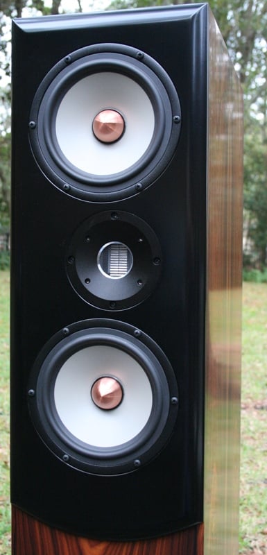

HT2-TL_binding1You are probably wondering why I haven't addressed the one feature that every owner, wannabe owner, and casual observer of Salk speakers immediately note - the finish. Don't worry, I'm getting to that. First let's look inside. The review pair of speakers were constructed out of 1" MDF and had two 3/4" MDF internal braces running up the length of the cabinet. As you might image, the "knock" test is fairly inert especially from the front, back and top. From the sides there is a bit more ringing than I expected. The back has a very high-end Cardas Premium dual binding post setup for bi-amping mounted to an aluminum plate. The jumpers between the binding posts are copper brackets - something I've not seen before. If I had a complaint here it is that there is not a color cue as to which wires go where. Usually the binding posts have a black and red label on them. On the HT2-TLs, there is a + and a - etched into the aluminum mounting plate only. While for most users this is a minor gripe as they really only install speaker wires once, for someone that is often switching speaker cables, it can be a hassle. There are also black screws securing the aluminum plate. While this is the back of the speaker and isn't getting shown off, taking the care to use an aluminum plate and then marring it with black screws seems a little baffling. It would have been better to use adhesive (like on the front logo plate) or maybe rivets. The grills on the HT2-TLs are identical (except for size) to the ones found on the SongTowers - they are constructed out of MDF, are held on magnetically, and are very secure. I'm a big fan of these grills as they are sturdy and come off just easy enough.

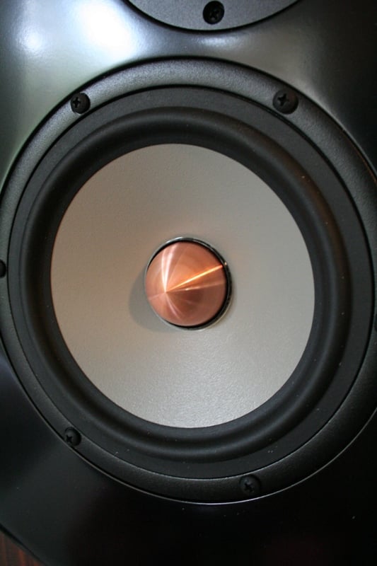

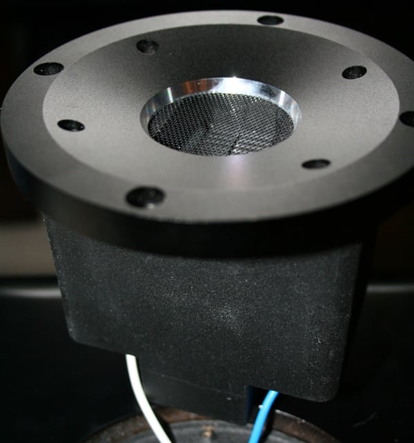

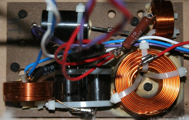

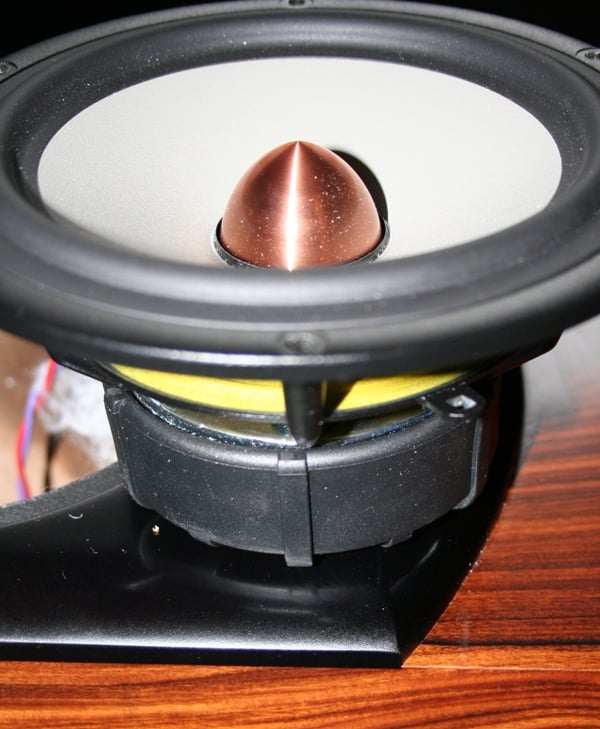

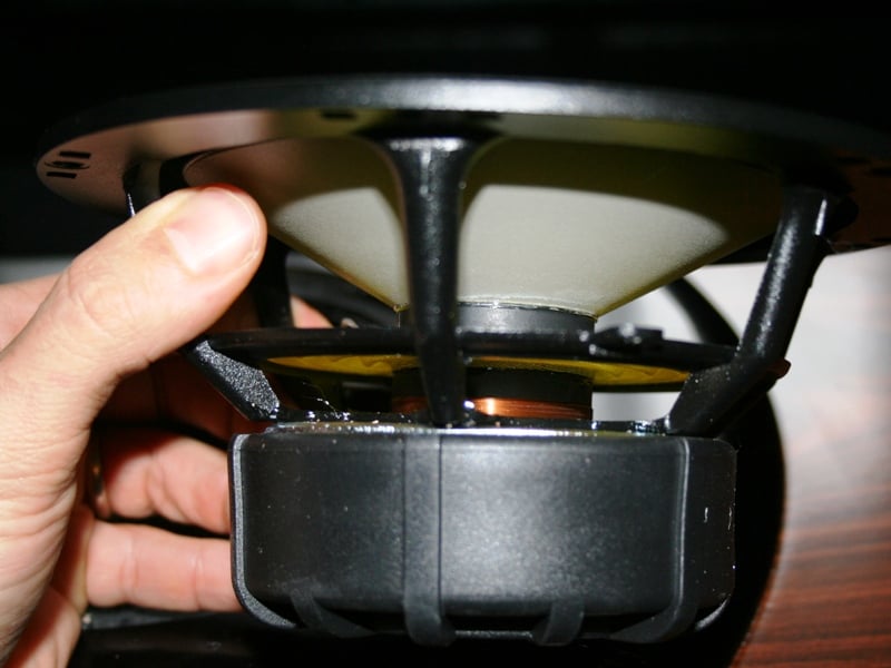

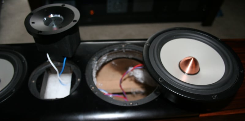

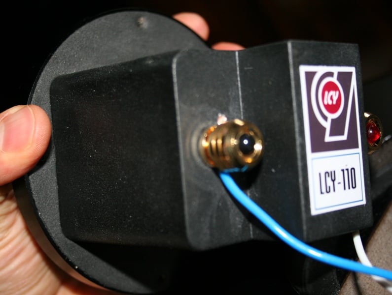

HT2-TL_apartBreaking down the speaker, I removed the LCY-110 tweeter and the bottom SEAS W18 woofer on one of the review speakers. Under the drivers I found a rubber gasket to eliminate any vibration between the driver and the baffle. Inside I first confirmed that the cabinets are built out of 1" MDF for the walls and 3/4" MDF for the two internal braces. The braces run from the floor to the roof parallel to the front baffle. They have cutouts for easy access and to reduce weight. This is actually one less brace than is found within the SongTower speaker which is a little confusing at this price point and size. According to Salk, however, they claim that the added wall thickness allowed them to reduce the number of braces. I did confirm that the knock test on the Veracity HT2-TLs sounded deader than the SongTowers so that appears to be true. The cabinet is stuffed with a dacron batting that I don't usually find in speakers. The SEAS W18 woofer was heavy and well built with an injection molded metal basket. The drivers are not shielded. The LCY ribbon tweeter is completely encased in its own enclosure with dedicated binding posts. The tweeter has "a unique design that uses two ribbons of half the length of conventional ribbons in order to control vertical plane dispersion." This essentially means that it doesn't suffer from the same off-axis response problems that plague other ribbons. The only real problem I saw in the construction was that the wires were completely undampened. At this (and lower) price points I often find a bit of sticky velvet-like material wrapped around the wires to eliminate the possibility of noise from the wires vibrating against the cabinet, drivers, or each other. The crossover was located directly behind the bottom woofer. Although it may not look as neat as an etched PCB board, great care was taken to hand build the crossover and properly orient the air core inductors to avoid mutual coupling which can have deleterious effects on performance.
 HT2-TL_tweet1     HT2-TL_woof2
 HT2-TL_tweet2     HT2-TL_woof3
HT2-TL_crossover

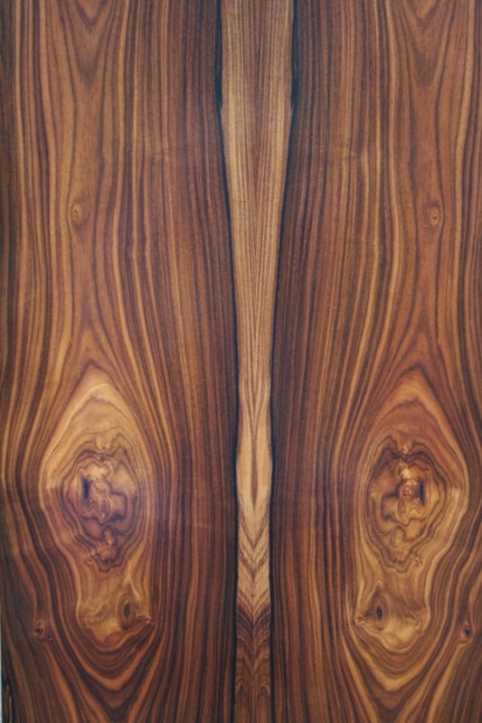

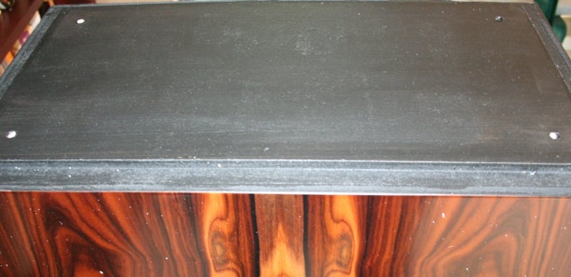

HT2-TL_woodNow, I end this section with one of the best physical features of this, or any, Salk Sound speakers - the finish. The Veracity HT2-TL's came wrapped in a Pau Ferro rosewood veneer that is, in short, stunning (it is also at a $200 premium over one of the stock finishes). A friend who works a lot with wood instantly noticed the quality of the wood veneer saying that someone that both really knows what they are doing and also really takes pride in their work veneered the speakers. When I asked why he thought so he pointed out the similarity in the grain patterns on both the speakers. He was suitably impressed. Salk Sound used a satin lacquer on the speaker which allows a bit of shine but not as much as a high gloss finish would provide. The front baffle (the speaker can be designed as a solid veneered unit for a premium) had a black satin finish. While audioholics like me are impressed with the driver typology and overall speaker design, everyone was impressed with the looks of the Veracity HT2-TLs. At this price point, you expect a speaker to make a statement both physically and audibly. The Veracity HT2-TLs screamed, even to the uninitiated, "We are quality."

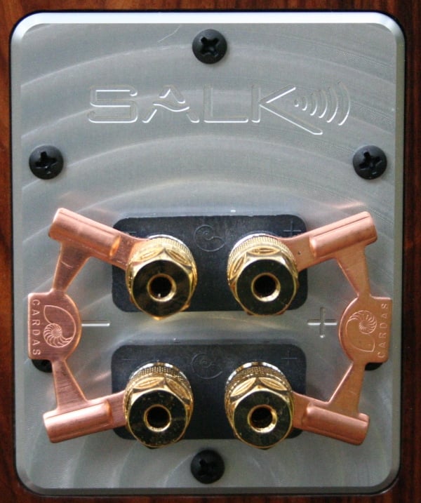

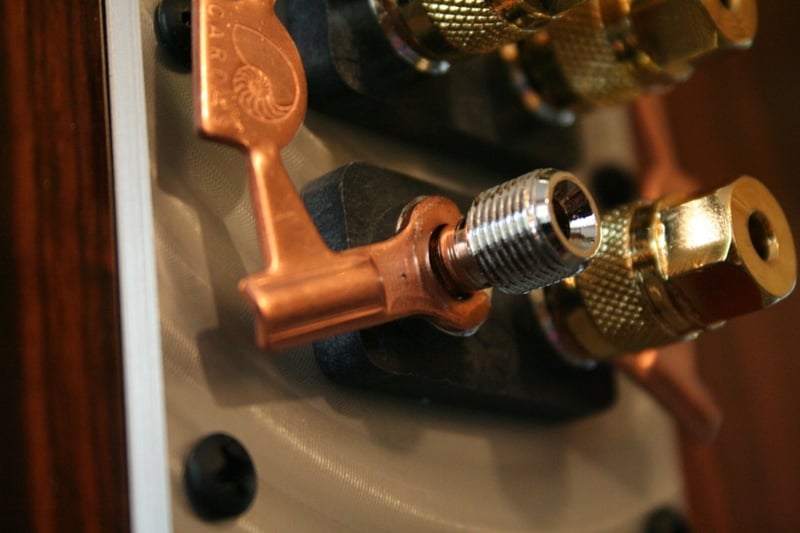

HT2-TL_binding2These speakers were mated with a lot of different gear. First and foremost most of the critical listening tests were done with the Denon DVD-3910 driving the analogue only Emotiva RSP-1/RPA-1 combo. This combo provides more power than most speakers will ever need and keeps everything in the analogue domain. Also, however, they were matched with the Denon AVR-4310CI, Seymour AV 5001 Ice Amps, and a myriad of sources. Wiring was provided by Blue Jean Cables and Ram Electronics. All listening tests were done in full range without the benefit of a sub and in pure direct mode (where applicable). All Audyssey and other processing was disabled. The room has been treated with some DIY treatments and GiK Acoustics Tri-Traps placed as recommended by Auralex via their Room Acoustics Plus consultation program.

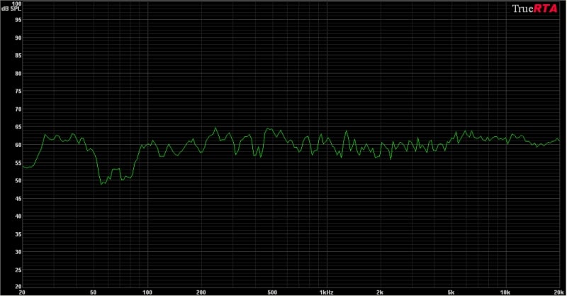

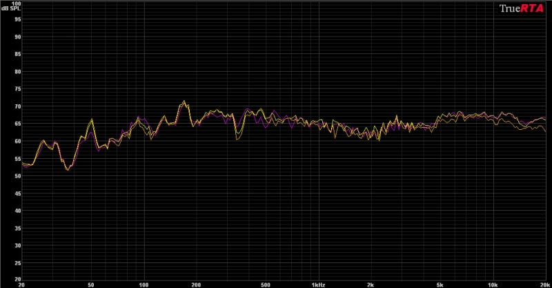

For measurements, I used TrueRTA with a Behringer ECM8000 mic and an M-Audio Fast Track Pro external soundcard. For amplification I used a Sherbourn 2/75B amp. This setup gives me a lot of flexibility as to where and when I can do measurement. To start with I placed the speakers in my Ready Acoustics treated AV Rant podcast room. This room is small but extremely dead with 19, four inch thick panels lining the walls and ceiling and straddling all the corners. While the room isn't exactly an anechoic chamber, it is a heck of a lot deader than most people would ever experience and almost every wife on the planet allow in their home. To start with I measured the speakers 1 meter on axis.
HT2-TL_meas_1mOn
Salk Sound Veracity HT2-TL One Meter On Axis 1/24th Octave
(note - not a 1 watt measurement)
As you can clearly see the Salks are extremely linear all the way through the bandwidth. The suckout between 50Hz and 90Hz is surely room/mic interaction. I verified by measuring the drivers nearfield and no suckout was present.

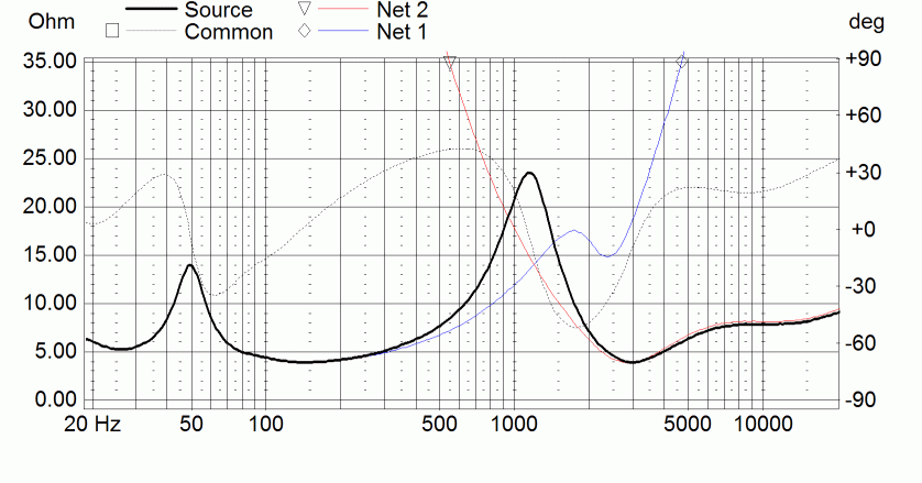

Impedance
Salk Veracity HT2-TL Impedance/Phase vs Frequency
The Salk Veracity HT2-TL actually measures more like a 5 ohm speaker but Salk appears to be rating it conservatively. There is a pretty sharp impedance peak at around 1200Hz causing a phase shift of about 75 degrees but it shouldn't cause any amplifier problems. Salk is using a higher order network to reduce the on axis response of the woofer before the crossover frequency which helps preserve its linearity. This is a common practice among competently designed loudspeakers such as the HT2-TLs.

HT2-TL_wooferThe next, and really most obvious, step was to compare them to the Salk SongTower QWTs. The Veracity HT2-TLs are the big brother of the SongTowers and for over double the price, I'd expect a significant performance increase. Again, I was still half convinced that the Songs would hold their own against their big brother. I've loved the Songs for quite some time and really thought you couldn't do much better no matter the price. So, to be honest, I was biased against the Veracity HT2-TLs before the review. Of course I based this opinion on how well the SongTower's had preformed not only in my review but in our shootout.
I was wrong.
(Don't tell my wife I said that.)
I've reviewed another pair of speakers with SEAS Excel magnesium-cone woofers - the Snell LCR7 XLs. These speakers retail for 6k a pair and are bookshelf speakers. The Snells sounded better than the SongTowers but at 3x's the price, they should. Of course they didn't have the bass that the towers had (you can't fight physics) so the comparison was very hard to do. While I no longer have the Snells on hand (unfortunately), the HT2-TL's are a much better direct comparison to the SongTowers. They have the same basic design, the same shape, and the same driver orientation. While the cabinet of the Veracity speakers is bigger and thicker and the drivers are upgraded, the speakers are basically the same.

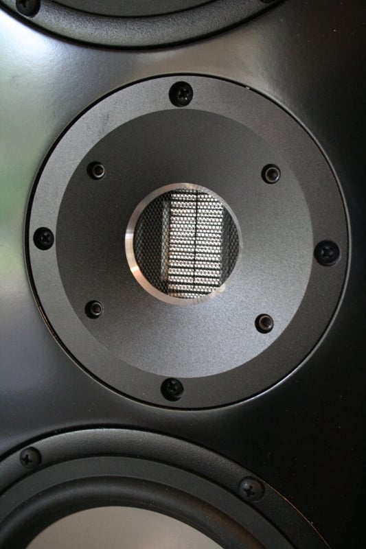

HT2-TL_tweeterThe comparison, however, showed that they weren't. The Veracity HT2-TL's bass was more than a match for the Song's. In the direct comparison, on every metric I could think of, the HT2-TLs were superior to the Songs. Bass, midrange, highs… everything. My jaw literally hit the ground. I A/B'ed the speakers over and over thinking that there must be something wrong with the wires or configuration. Sure, the Veracity's cost a bit more than 2x's the SongTowers, but to my ear, the differences were dramatic. Very dramatic. Are they worth the money…? Well, to my ear, yes. I hate saying this as I have such love and respect for the SongTowers but they don't hold a candle to the Veracitys. The bass isn't even in the same league. While I found both of the speakers to have very linear bass responses, the depth of the Veracity HT2-TLs was worlds better. The entire presentation and sound of the Veracity speakers was more natural, more lifelike, and, in general, more effortless. In fact, if I had to describe the Veracity HT2-TLs in a word it would be effortless. They don't seem to present sound as much as allow sound to pour through them.
