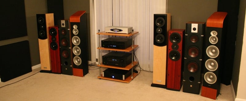

Final Speaker list:

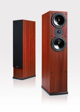

- DALI LEKTOR 8 - $1800/pair
- Infinity Classia C336 - $1798/pair
- Krix Phoenix - $1700/pair
- Salk Sound SongTower QWT - $1895/pair

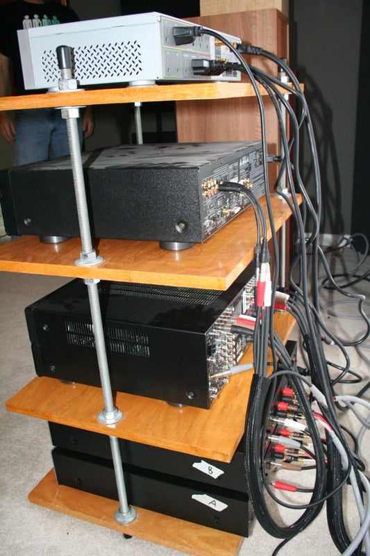

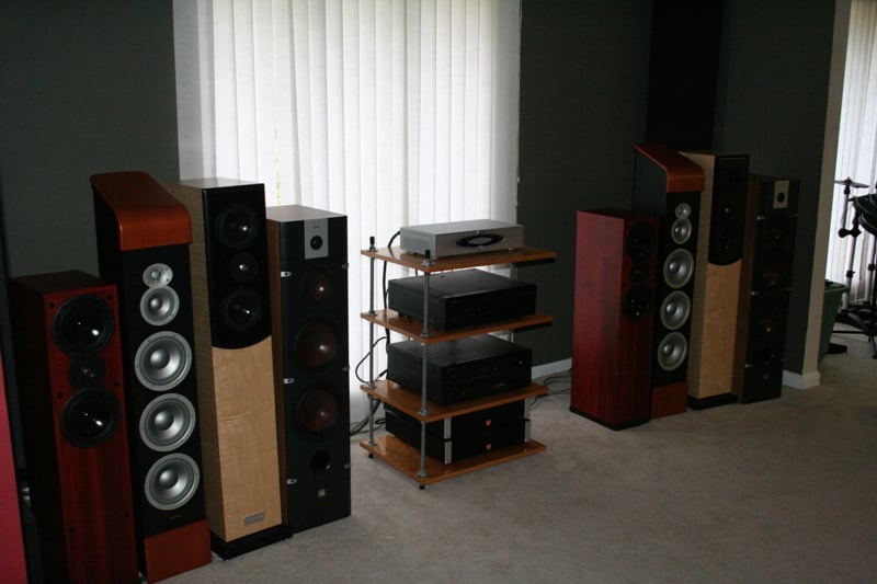

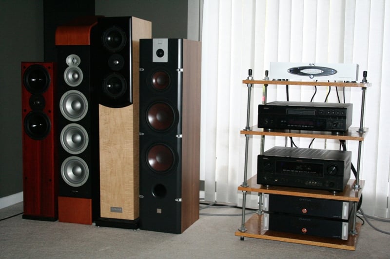

setting up a shootout, you'll want to make sure to follow the steps in our

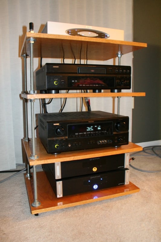

tech article on the subject. We made sure we had all the same lengths of

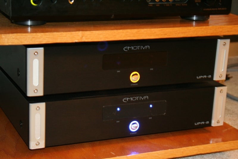

cable (speaker and RCA interconnects from Blue Jeans), amplification (two
UPA-2's from Emotiva Audio), all fed from a Denon
DVD-3910 universal player and Denon AVR-2307CI
receiver. Power was supplied by an APC H10. Switching was done manually by me.

Well, when I contacted Emotiva about providing the amps, they suggested the UPA-2. It's a new low cost amp. It has plenty of power for my application (the room is smallish and none of the speakers are all that hard to drive). What I didn't know was that the UPA-2's have a volume control on the back. I knew that the Denon AVR-2307CI didn't have trim controls for its second zone. You need trim controls so that you can level match the speakers. My plan was to split the DVD output into both the front and surround analogue inputs on the receiver, send the outputs to two separate amps, level match the two sets of speakers, and manually turn the amps on and off as needed. This would give the two pairs an identical signal, identical amplification, and level matching capability. My experience with the Emotiva RPA-1 was that the amps when on and off in a fraction of a second.
The problem was that the UPA-2s don't go on and off quite that fast. Luckily with the volume control, I could turn one up and the other down very quickly. What was unfortunate was that I didn't know that the UPA-2's had the volume control. If I had known, I could have level matched using four of the amps (rather than one for each pair) and set the second pair on Zone 2. Then I wouldn't have had to do any manual switching at all and they could have done it all from the remote. But I didn't so I ended up behind the screen the entire time flipping amps whenever they asked.

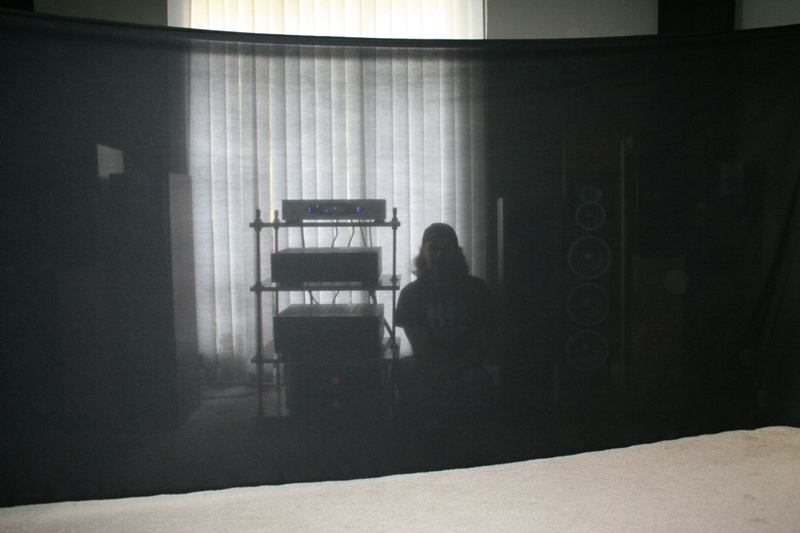

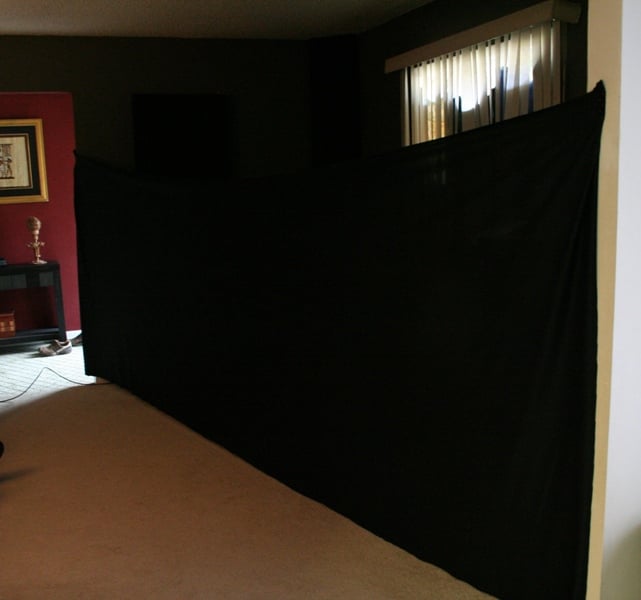

There were two different tests conducted - blind and sighted. For the blind test (which was done first) I had the entire front of the room blocked off with a large piece of speaker grill fabric. This fabric is acoustically transparent and very thin. From behind it, I could clearly see each of the participants to the point that I could tell when they were looking over each other's shoulders. Once I blocked the light coming in from the window behind the screen, the participants could neither see me nor the speakers. The screen was set up before the participants arrived on Friday and stayed up until after the blind listening tests were completed on Saturday. After each listening session, I switched the speaker cables (each marked with an A or B as were the amps), came out from behind the curtain, and let the listeners rest their ears/minds as long as they wanted. I did not answer any questions about which speakers were in the previous tests even after all the blind tests were complete. In fact, as of this writing, they still don't know. They are finding out the same time as you.
After the blind tests were done, I took down the screen. I asked the participants to examine the speakers. They inquired after the grills (which were removed for all the listening tests), they looked closely at the finishes and build quality, and even picked up the speakers. I then allowed them to switch the speakers individually and compare them as they wished. I asked for an individual writeup of each speaker for the sighted portion. They were encouraged to compare and contrast speakers in any way/order they wanted. During the sighted test, I was not in the room (for most of it I was taking a nap).

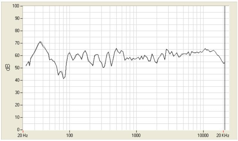

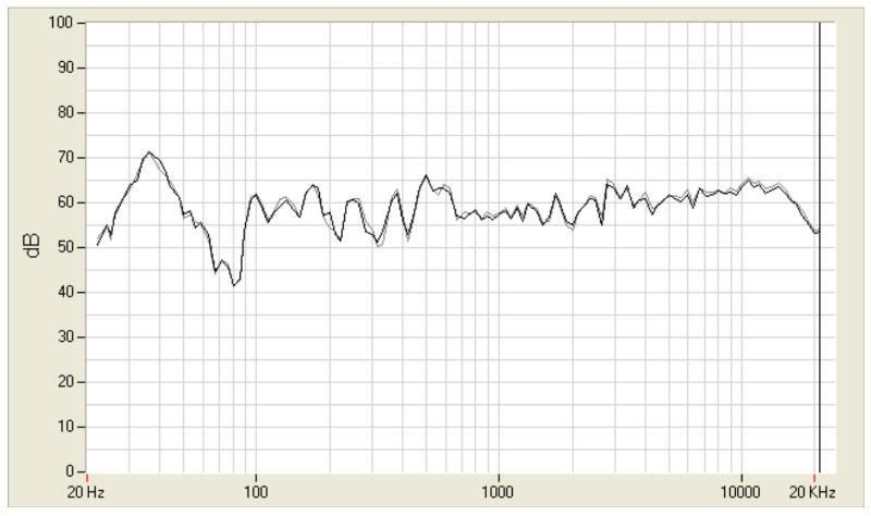

My first big concern was ensuring the signal chain didn't affect the sound. Since I was running one pair of speakers through the "main" analogue inputs and the second through the "surround," there was a concern that the sound quality would be affected. Before the participants arrived, I hooked up one of the speakers and took a measurement with the Sencore SP395A FFT Audio Analyzer. I then switched the speaker wire to the second amp and took a separate measurement.
As you can see, the measurements are identical. The second big question is how the speaker grill fabric I was using for a screen would affect the sound. With the same setup, I took a measurement and then held up the fabric and took a second measurement. This second measurement probably is worse than what you'd experience in the actual room as there may have been more folds in the fabric and my proximity to the speaker/mic could have made a difference. As you can see, the measurements are both very close.
My room is 14.5 feet long and 12.5 feet wide. It is open on two sides. It has undergone the Auralex Room Analysis Plus process which has you do measurements of your room and uses the data to suggest room treatments and locations. My room is treated by my own DIY acoustical absorbers and six GiK Tri-Traps. The room is not at all dead nor is it 100% flat. For a complete discussion of my room, please see the review of the Auralex Room Analysis Plus (forthcoming). The big problem with this setup and the room is not so much the acoustics (which thanks to Auralex and GiK are quite good) but the number of speakers. Four pairs of floorstanding speakers are a lot in a 12.5 foot wide room. What this meant was that the best spot for the listening was in one of the two center seats. The side seats aren't that great even with one pair of speakers but with four, they go from tolerable to terrible. This required the participants to switch seats - something I would have asked them to do anyways.
When picking the pairs, I went to random.org and generated pairs of numbers, each between one and four. I numbered the speaker based on the order I received them (seemed about as random as anything else). I ignored pairs that were identical (1 and 1, etc.) or that were repeated (in either order). This left me with the following order of pairs:

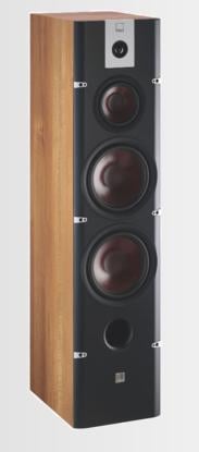

The DALI LEKTOR 8's were
consistently described as having a subdued high end. "Muted" was the
most oft descriptor though consistently the speakers were described as
"pleasing" and "natural." Bass was consistently described
with positive words like "tight" and "punchy." There were
times that the speakers came off as a little bass heavy but overall the
comments seemed to favor the DALIs in the bass department. Mids were a little
more often described negatively with words like "recessed" and
"muted" though we do see more positive words like "natural"
and "warm." While the bass and treble comments were pretty
consistent, the midrange comments were consistently inconsistent. They varied in positive and negative in the same
comparison. This may have to do more with source material and the interaction
with the room and the speaker.
Imaging and soundstage were both generally reviewed as positive by the listeners. The soundstage was described most often as "wide" except when the DALIs were compared to the Salks. In that comparison, the most oft used word was "narrow." Imaging overall was very positive with words like "good" and "detailed" but again, in the Salk comparison, the DALIs were described as "OK." Generally the dynamic range was viewed as "limited" though there were a few positive comments. A few of the listeners suggested that the bottom end response of the speaker might have been obscuring the top end and therefore limiting the range.

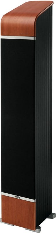

The Infinity offerings were
a grab bag of comments. On the top end, we find everything from
"SHRILL" to "relaxed." In the midrange we see many
different types of comments but a common theme of "unnatural" running
throughout. Bass is alternately described as "muddy" and
"tight" - often in the same comparison. What was most interesting was
that the most positive comments for the Infinitys were recorded during the comparison
with the Salk SongTower QWTs - one of the highest rated speakers. Consistently,
listeners used positive words for the Infinitys but only one of the three
actually preferred the Infinitys over the Salks.
"Small" and "narrow" seemed to dominate the observations about the Infinity's soundstage though there were a few suggestions of "wider." One listener remarked that the seating position on this speaker was fairly important as it changed from one seat to another. In comparison with the Salks and DALIs the Infinitys were unflatteringly described as having "lousy" and "muddy" imagining. With the Krix, however, the terms were more positive including "excellent." Dynamic range was described consistently as "narrow" with the most positive terms used in the comparison with the Salks.

DALI |
Nice drivers. Like the color. They feel substantial in weight |
Heavy and wide, solid and stable. |
The cabinet appears to be well built. A vinyl wrap was used for the wood grain verses a real wood veneer. The vinyl is very well done. |
Infinity |
The three woofers gives the impression that they might be compensating for something. They feel top-heavy and seem like they tip forward a bit too easily. |
Very impressive and solid – looks like a piece of art. |
The infinity uses a black plastic molded body that has a matt texture to it. The only wood is the trim on the top that bottom. The speakers have a decent weight to them. |

DALI |
Pretty speakers. The back gives away the fact that it's not real wood - a shame since the veneer is so good otherwise. |
Vinyl wrap looks like wood. Front and side of speaker finished well. Rear not so much. |
With the speaker covers removed, the drivers blend in with the cabinet face. The surfaces are all done in a more flat finish. |
Infinity |
The most interesting design, sure to please some who prefer a more decorative look to their speakers. The one negative is that the makeup of the front and sides is reminiscent of a "plastic" texture/material. Overall a nice look - just very different from a wood or straight veneered speaker. |
Hardwood cap and base are impressive. Silver plastic outriggers look cheesy. |
The plastic parts used for the cabinet seem to be well made. The wood accent trim on the top and bottom of the speaker makes for a nice, modern look. |

DALI |
Vinyl wrap looks like wood. Big, bold looking speaker. I love the brick red drivers – different! |
This is the largest speaker in the test but still does not look too big. There is no extra base or support on the bottom which makes the speaker look more streamlined and square to the floor. |
Infinity |
Modern, curvy look. Has high-end vibe. Looks expensive. Grey/silver drivers seem cheesy and do not convey the class of the cabinet. |
Has 5 drivers which is the largest number in the test. I liked the angled top piece of wood that will prevent things being set on top of the speaker. The silver colored drivers don’t seem to match with the brown wood trim and the black cabinet; I think it gives it a cheap appearance. |

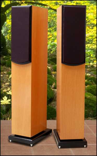

This is the smallest and most simple looking speaker of the bunch. The wood veneer is a pretty exotic looking wood. There is a black base that appears to be an after though. The overall presentation of these speakers is pretty boring. |
Salk |
Gorgeous blonde maple hardwood veneer. Cabinet seems to float above the black base. |
The magnetic speaker cover is a cool touch since there are no holes on the face for the pegs that normally attach the grille to the cabinet. This gives a streamline appearance when the covers are off. |

DALI |
Freakin loads of bottom end. Chest-thumping kick in "Happier Girl". Lots of reverb and ambience. A tad muddy when playing the chorus of this song. Wide soundstage. Could localize details in "Toy Matinee" very well. Perfect left to right pans of the toms in this tune. Can really hear the high-end detail. Female vocals seemed authentic in presentation. |
Rich, full sound. Very lush and detailed. Plenty of punch. Bold looks and the sound backs it up – these are big and beefy speakers. I love this speaker – my kinda character. |
Great sounding speaker overall. Seems a little heavy on the bass with some of the test music though. The highs and mids were clear and well defined. The speakers gave a very full sound. Because of the overall dark color, these speakers appear big. These speakers would be my second choice. |

I loved the way the shootout was set up, with the scrim hiding the speakers from us. Because Tom was willing to sit on the floor behind the rack to switch and "A-B" the speakers, it made it easy for us to focus on listening and have him toggle between two pairs. I think the most difficult part of the testing is the music selection. Each of us has our own taste in music, which means we each have songs we like and things we listen for. There always seems to be one song that, at the end of the day, becomes the song that everyone agrees can really bring out the subtle distinctions between the speakers. Although we ended up with 4 key selections, I felt that the Shelby Lynne cut became this song.

During the blind tests, I
spent the entire time behind the curtain where the participants couldn't see
me. When I came out I wouldn't answer any questions about the previous or
future comparisons. The only question I did answer was when one of the
listeners was complaining that they were feeling insecure about their
observations. I reassured him that when he found out what speakers he was
referring to (I didn't tell him the exact comment), he would laugh at his
accuracy. After all tests were done, I expanded on this informing him that he
had described the Infinitys as "tall" and the Krix as
"short" (physically, very accurate).
One thing you might have noticed was that I in no way participated in the shootout. That was partially by design but mostly because I already had a personal stake in the results. Part of the process of the shootout was that I'd review all the speakers first. Well, after reviewing all the speakers (except for the Infinitys which came in late), I had a clear idea of a favorite. Plus I had reviewed each of the speakers and if one that I reviewed positively got slammed in the shootout… well, you can see how that might taint my reactions. As a trained evaluator, I felt that I probably could control my biases but that it would look too bad to you the reader if I participated. Honestly, in retrospect, I'm glad I was behind that screen. Every time someone said something even slightly different that what I'd said in a review about a speaker I could feel myself reacting. I'm glad they couldn't see my face or body language. I very well might have given off subtle (or in some cases not so subtle) cues.
Through the screen I could see the participants clearly. One thing I wished they would have done more of is switch seats. They switched occasionally but it was mostly instigated by the two professional reviewers and not Jon. I could clearly see that Jon felt somewhat intimidated by the other two. That aside, they did not switch seats as much as I would have liked even though I did remind them from time to time. This very well may have affected some of the blind tests (I wasn't around for the sighted stuff) especially in relations to bass response (an overly bassy speaker may sound very different from seat to seat), imaging, and soundstage.
I had asked Clint and J (because at the time I didn't know Jon was coming) to pick out a few songs or pieces of songs that we would use for the shootout. What I envisioned was five or six 30-60 second song clips that we could quickly flip through on a single disc. Clint picked out a clip and two full songs while J misunderstood and brought a full disc of material. While all the material he brought was great for evaluation, it tended to be overwhelming. We ended up with Clint's three tracks and three off of J's disc. In the end, even that was too much. Too often, I saw them get stuck on a song (or piece of a song) that they glossed over in other listening tests. If we had had a more limited (and preferably targeted) musical selection, perhaps the results of the blind tests would have been a bit more consistent.
Like I said, I could see the participants through the screen very clearly. Clearly enough that I could see them reading over each other's shoulders. While they claim they weren't "copying," I know from personal experience with these shootouts that you can't help but be affected by what you read. It might be for the good ("Oh, I didn't think to listen for that") or the bad ("Gee, maybe he knows more than me") but there will be an effect. In a room such as mine (and in most rooms, honestly), you can't really separate people enough to keep this from happening. I will say that I tended to notice it more at the end of the listening sessions than at the beginning and I didn't notice anyone going back and "changing" their answers. Instead it looked more like they were confirming their own observations or checking out what other people said after they finished their own.
Is there a clear winner here? It seems to be the Salk SongTower QWT from both the sighted and blind tests. But if you look it over, you'll see that the DALIs and Krix just about tied in the blind tests but the DALIs triumphed in the sighted. One of the participants even indicated that he would purchase the DALIs over the Salks after the sighted test. So what's going on here?
Obviously, aesthetics has a lot to do with it. If we had pulled back the curtain would the Salk performance in the Krix body still have been the overwhelming favorite? Doubtful. But more importantly, I believe there were two types of speakers under review here - Detailed and Bassy. The Salks and the Infinitys seemed to be more in the "detailed" camp while the Krix and DALIs were in the "bassy" camp. Clearly the differences were large enough between the Salks and Infinitys that the Salks easily came out on top. The DALIs and Krix, however, seemed to have a much closer performance gap. Were the aesthetics enough to push the DALIs over the top of the slight lead that Krix had in the blind tests or was it something else? It's impossible to say with only three participants and one comparison between the two speakers.
Really, the Krix, Salks, and Dalis are all winners here and all four deserve a listen. You can go back through the observations and see how each of the speakers received glowing and damning praise. Music, room, seat, mood, fatigue and more all factored in to all these listening tests. In a perfect world, I'd have a lot more people doing a lot fewer (and more targeted) listening tests. But this isn't a perfect world so we do what we can.
