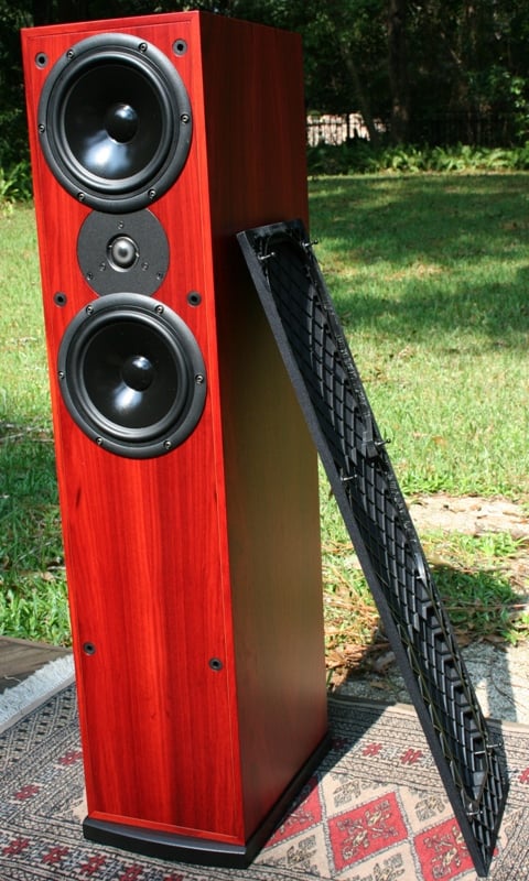

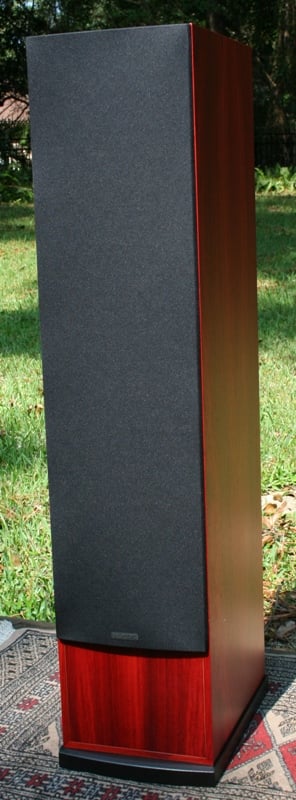

The speakers are a slight 37" tall and are veneered with real Atlantic Jarrah - a very rosewood looking timber. I'm not a wood expert but I got a kick of telling people that they were "Atlantic Jarrah" and seeing the confused looks. There is a seam around the front and back (basically, the sides, top, and bottom look like they overlap about 1/2 inch). The front panel is veneered and the back is wrapped in textured vinyl. I've seen this same sort of design on other speakers and I'm not a fan. The back doesn't bother me so much but I like the front to be seamless. The top/side transitions are flawless with no perceivable breaks. The edges and corners are a little sharp and I would have preferred a more rounded, less pointy corner look. The grain is very attractive while not standing out. The finish is very flat with minimal reflections.

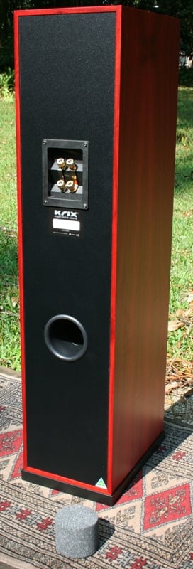

The speaker is rear ported about a third the way up the height and
arrived with a foam port plug. The directions enclosed with the speakers
suggested that you remove the port plug unless you plan on placing the speakers
near a wall. I wasn't, so I removed it. The port plug is composed of a dark
gray foam and fits snuggly without being too hard to remove. I'm generally not
a fan of port plugs because people tend to want to use them but the giant
warning from Krix to remove them in most cases made them OK for me. I actually
liked that they were thinking about how to make their speakers sound good in
non-optimal placements instead of waiting until someone called with a complaint
and telling them to shove socks in the ports. There is a small black base
already attached to the bottom of the speakers that overhangs just a bit. It is
flat black and only an inch high. It is beveled and rounded at the front with
the farthest point about an inch from the front of the speaker. The sides overlap
by about 1/4 inch and the back is nearly flush. The rear has two sets of 5-way
binding posts for bi-amping.

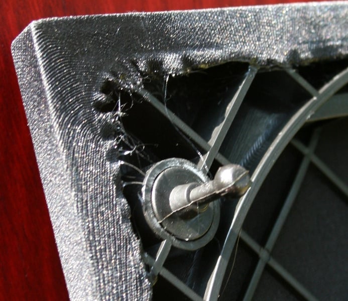

The speaker grill is a latticed plastic design and runs about 4/5ths the
length of the front while taking up most of the width of the speaker. The grill
is definitely a little flimsy from the front but doesn't torque too easily.
Basically, you might break through the front but you won't crack the whole
frame. Just avoid playing baseball in the house and you'll be fine. There is a
Krix logo attached at the bottom of the grill. The grill posts are plastic and
have a ball at the end. They snap securely into place and I detected no
movement or vibration from the grill. I've had experience with the type of
plastic posts used and they have a tendency to break off if you aren't careful.
To me, the grill seems oversized though it does harken back to your more
traditional speaker design where the entire front was grill. People I've shown
these speakers to generally either like the looks or feel they are plain.
You'll need to decide for yourself.

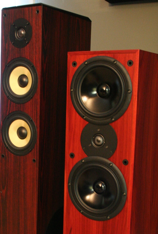

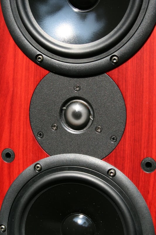

The Phoenix speakers sport an MTM design with two
6.5 inch woofers and a 1 inch soft dome tweeter. The tweeter is set flush to
the front baffle with the woofers slightly overlapping. I generally don't like
all black drivers on the front of a speaker but these tend to work for me. The
woofers have a sheen to them and the tweeter has a dark spot in the center that
gives the illusion of an eye and appears to be a copy cat design of a Dynaudio
tweeter employed by many manufacturers these days. With the red of the veneer,
this actually looks pretty nice together. The only real problem with the design
is the height of the tweeter. Here at Audioholics (and just about everywhere
except in the engineering department of Dynaudio) we suggest placing the
tweeter at ear height. Either Australians are really short, they sit on the
ground, or the Krix Phoenix was designed to have the tweeter at chest height.
At only 27-1/2 inches off the ground they are a good 10-12 inches lower than
nearly every other floorstanding speaker I've reviewed. I'm operating under the
assumption that this was on purpose and that the speakers are voiced for this
design (and not that I'm supposed to build a stand for them which is ridiculous
for a speaker in this price range and genre it is in).

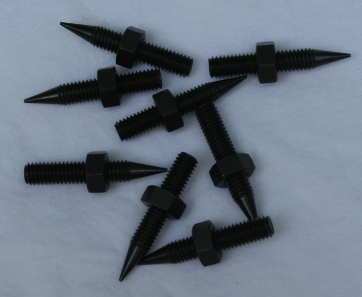

Carpet spikes are provided which
are very similar to the ones I get with many speakers. They are black, thin,
and have an adjustment nut. These spikes are EXTREMELY sharp and can be hard to
work with. With this set, the nut will screw all the way off the end and the
spike will go nearly all the way inside the base if you try hard enough. If you
can't tell, I'm not a fan of these spikes. I'm sure you could buy some
aftermarket spikes if you wanted or an outrigger setup (my preferred solution).
Remember that the base is attached so if you decide to go with outriggers it
might look a little awkward.

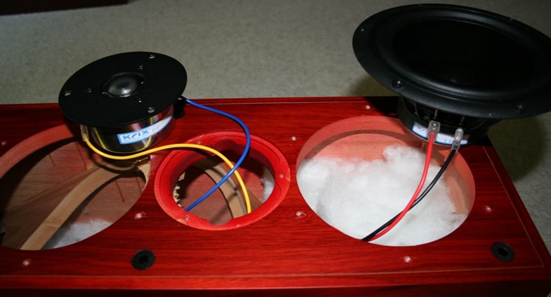

Removing the drivers, I noticed that the woofer baskets were plastic (Krix says - Fibre reinforced moulded polymer). This is actually preferable to a stamped metal basket but not as good as a cast one. The tweeter is very heavy duty and encased in its own metal enclosure. The cabinet is constructed out of 5/8 inch MDF and has two internal braces. The two braces meet on the front baffle between the tweeter and the lower woofer. They run at angles away from this point with the lower one at about 45 degrees and the upper about 30 degrees (I didn't have my protractor on me so don't hold me to that). The bottom and top areas are stuffed with polyfil and they have polyfil glued to the back. The Krix Phoenix responds well to the knock test. They are about as inert as the other speakers I've reviewed in this price range. The crossover is attached directly to the plastic binding post case and uses low gauge air core inductors, and a combination of polypropylene capacitors and electrolytics with ceramic power resistors to pad the tweeter sensitivity down to match the woofer response.

Attaching the spikes was an exercise in frustration, not because they
were hard to attach, but because they were nigh impossible to level. If Krix
had used a spike with a stopping point for the adjustment nut (instead of a nut
that screwed all the way off the spike) I could have had a universal starting
point. Instead I had to just eyeball it (never good enough for audio tweaker
types). There are no rubber feet so I'm not sure what you are supposed to do if
you want to place these speakers on tile or hardwood flooring. I've got carpet
so that wasn't a problem.

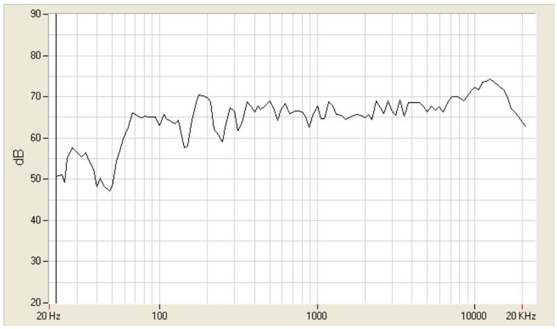

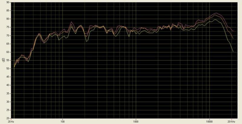

Using the Sencore SP395A FFT Audio Analyzer and a Sherbourn 2/75B amp, I measured the Phoenix's in-room on and off axis frequency response with 1/12th octave resolution with the port plugs in. Generally, what you do when you measure a speaker is look for the conversion point. This is the point where the speakers measure the best. It usually find it a hair below the tweeter. Generally, this is also very near ear height when seated. Thinking that the Phoenix's were voiced differently, I initially thought to make my measurements at ear height - just above the center of the top woofer. I quick glance told me that these measurements were so poor that I had to rethink my strategy. The high end was boosted and the midrange was dropped very low. Fiddling with the mic position for quite some time, I determined that the Krix Phoenix did indeed give me the best measurements just below the tweeter. I'm not sure what was the design goal behind this.
Phoenix 1 Meter Frequency Response (1/12th Octave) On Axis
(note - this is not a 1
watt measurement and is not intended to show efficiency)

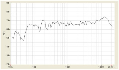

Phoenix 1/2 Meter Frequency Response
(1/12th Octave)
Pink - On axis, Orange
- 15 degrees off axis, Yellow - 30 degrees off axis
Disregarding the graph below 200Hz (due to in-room measurement inaccuracies) the on axis frequency response looks fairly linear with the exception of about a +5dB bump above 6kHz. They do exhibit a very uniform off axis response. As you can see, the upper end is voiced very high, likely intentional since the tweeters are so low to the ground. This makes for a bright speaker, especially when pushed hard. With the port plugs out, the bass is also accentuated which subjectively makes the boosted treble not so noticeable but further emphasizes an unnaturally recessed midrange. If you want to know what the other graph looked like, just think of the old “smiley face” V curve with EQ’s.

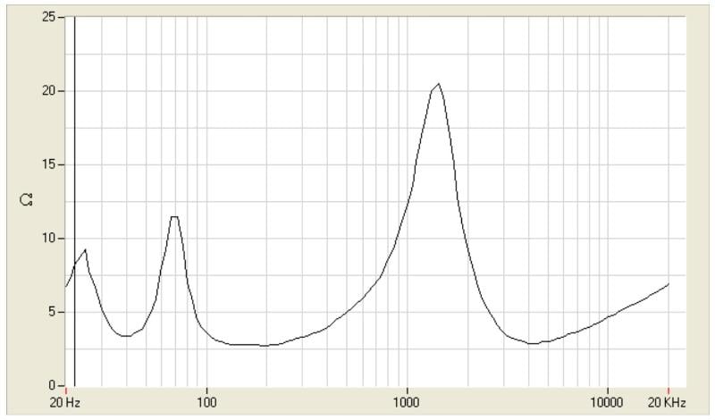

Phoenix Impedance (port open)
The Sencore consistently measures speakers about 1 ohm lower than they actually are. There is an impedance minima right around the 40Hz tuning frequency. The Phoenix present a fairly easy load that will work with most mid-fi receivers (even though it does dip into the 4 ohm range). Increased amplification would probably be appreciated for those with larger rooms.

comparison between the RBH TKs and Krix Phoenix. Overall the Krix's presentation
tended to be very forgiving with its recessed midrange. Unfortunately, it also
"forgave" some things that were meant to be there. The bassist often
got lost in the presentation which only got worse without the port plugs, whereas
he was clearly audible on my reference speakers. The Krix high end was not as
detailed as the RBHs and the midrange was definitely more recessed. Without the
port plugs, the bass was punchier and deeper than the RBHs but the RBHs seemed
a little more articulate. With the port plugs, the Krix bass was fairly
lifelike but the extension and impact was diminished. The plugged Krix bass
drum wasn't nearly as lifelike as the RBHs which is probably due to the reduced
extension. The imaging again was a bit better with the RBHs especially with the
left/right separation however the Krix definitely had no problem centering the
vocals in the soundstage.
