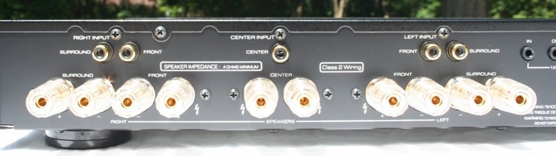

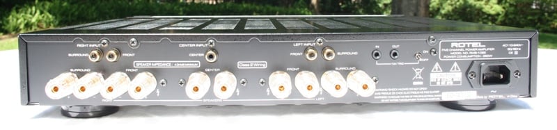

The RMB-1085 is a thin, fairly light (under 12 lbs.) unit that I had no problems palming as I was moving it around. The front face is a light grey with only a single power button and two lights. The blue light indicates power and the red a fault of some kind when the unit is powered on or standby mode when it is powered down. The only other adornment to the front of the unit is the Rotel logo and model number on the front and an embossed logo on the top. The unit stands less than 3 inches high.
The
rear of the unit has five RCA style inputs and five sets of 5-way binding
posts. There are no balanced inputs for this amplifier. The rear also sports a
removable power cord, a 12 volt trigger input and output, and an on/off switch
for the 12 volt trigger. The right main and surround were grouped as was the
left main and surround. The center channel input and outputs were alone. The
only point on concern here was that with the grouped inputs, the positive was
always on the outside with the negative in the center forcing you to switch the
order of the speaker cables. Rotel stays that they do this to reduce the chance of shorting positive to negative. The 12 volt trigger is used to turn the amp on and
off automatically when another piece of gear is powered up. Setting the switch
to "Off" ensures that the amp is only turned on manually while in the
"On" position, the amp is looking for input from the trigger input.

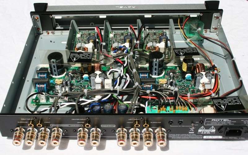

Cracking
open the amp, we can see just how compact the Class D amps are. No where to be
found is the huge toroidal power supply we see in Class A/B amps. Instead, just
three small circuit boards with minimal heat sinking. The power supply is an SMPS type with two switchers and the amp section
consists of three two channel modules, one of which apparently isn’t being used
in this design. While I understand that 6-channel amps tend to confuse people,
the lack of use of this 6th channel seems wasteful to me. Of course, for $400
more you can pick up the RMB-1076 which activates this 6th channel, adds the
input and output, and three level knobs on the front. The 1076 seems to be more
tailored to audio distribution with the lower quality binding post and volume
controls but we're willing to bet that the internals are nearly identical. The
top of the RMB-1085 has vents for cooling but there is no fan. Since switching
amps are much more efficient than conventional amp designs, this is to be
expected.

up the Rotel isn't exactly rocket science. You'll need to connect RCA cables
from your preamp/processor/receiver to the amp and speaker cables out to your
speakers. I used Blue Jeans Cables. There is a 12 volt trigger cable supplied
if you are planning on using that function. One thing that sort of irritated me
was the configuration of the speaker terminals. Switching the order of the
positive and negative just seemed like an unnecessary step that was just
begging for someone to reverse polarity on their rear speakers. Plus, the
grouping made everything a little tighter than it could have been. I'd much
prefer a visual separation (like a line on the back panel) with as much room given
to space out the inputs and outputs as possible. One of the things I hate about
most receivers is how you need to have the hands of a 12 year old anorexic boy
to get to the speaker terminals. I expect one of the bonuses for paying for
external amplification is more room to move. The grouping of the left and right
main and surrounds on the RMB-1085 felt nearly as cramped as some receivers
I've used.
