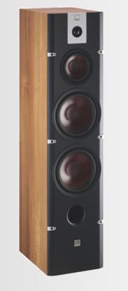

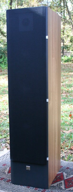

To be honest, before I even opened the box I was a bit biased against the look of the LEKTORs. Why? At $1800 a pair, I couldn't believe they would even consider a vinyl wrap. At this price point, I expect much more.
Boy, was I wrong.

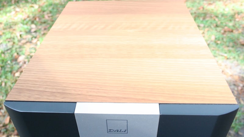

I've seen a lot of vinyl wraps in my day and I can say without
reservation that this is the best. The review pair of LEKTORs was in the light
walnut finish rather than the all black option. As much as I like a speaker
that "disappears" into a room, I find that black, in general, is
harder to keep clean and generally bores me. The woodgrain finishes tend to not

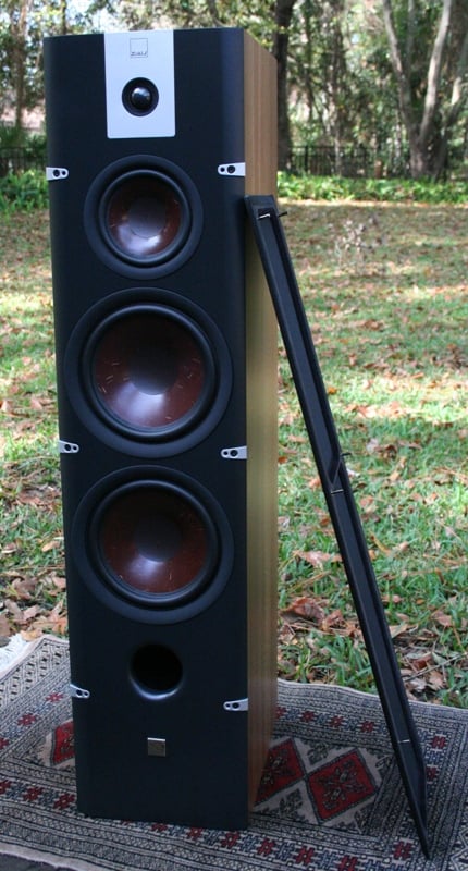

show off dust as much and definitely make more of a statement. The LEKTOR 8's
are one of the better looking speakers I've had in my room - at least from the
front. The black front baffle is nicely rounded and is matte enough to absorb

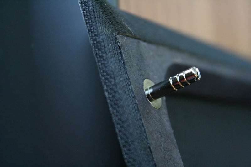

most light. The grill is a little oddly shaped until you realize that it can be
reversed so to cover or reveal the tweeter. For those that believe that grills
make an audible difference… well, they probably still think it makes an audible
difference when covering the woofers. DALI was smart enough to put their logo
on both the top (near the tweeter) and bottom (small chrome plate) so that no
matter your grill preference, you'll know who made your speakers. What you
don't know is that the DALI and LEKTOR logos are everywhere - even in places
you can't see them: Back of the woofers/tweeter, under the metal plate around
the tweeter, even on the screws!

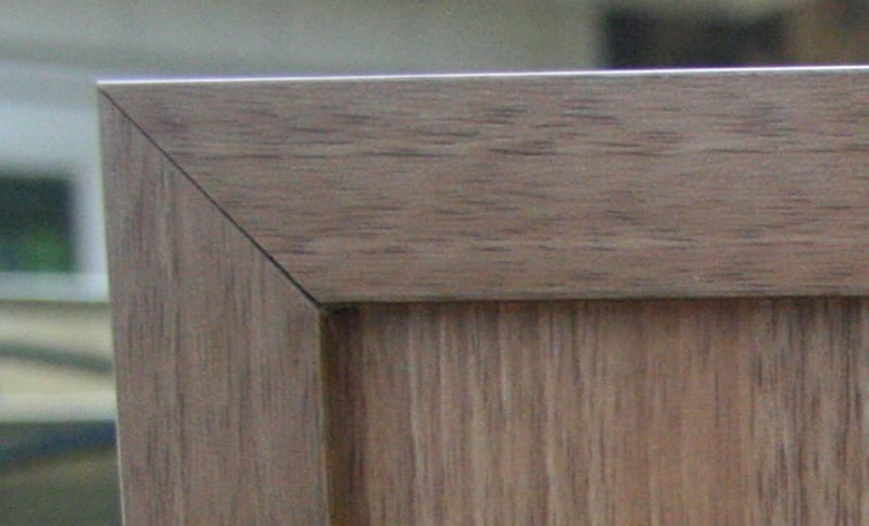

The fit and finish around the front and sides is nearly impeccable. The corners of the main cabinet are a bit sharp but the front corners are covered with the black front baffle so it isn't an issue. There is a small gap between the front baffle and the main cabinet but it would take very little convincing to make me believe this was an intentional design choice and not some sort of fit and finish issue. The metal accents on the front aren't heavy handed and give the speaker the contemporary but not gaudy look I'd expect of a Danish speaker manufacturer. The metal side pegs double as holders for the binding posts. When I was trying to dissemble the speakers, I discovered that they really don't seem to serve any purpose other than that.

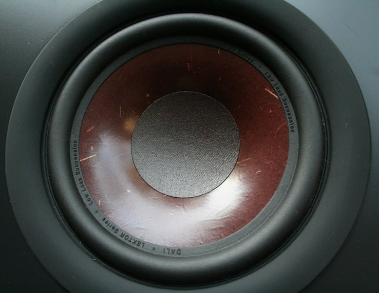

The real standouts in the
looks department are the woofers. The LEKTOR 8's sport two 8" woofers and
a 5" midrange. They are also the color of old bricks or dried blood (your
pick). This is the first time I've seen deep red woofers in a speaker -
especially one made to be seen in the home. At first, I was a bit put off by
the color - red just seemed weird to me. But the longer I've lived with them
the more I've appreciated them. The coated paper with wood fiber reinforcement
material isn't as reflective as your aluminum or some of the other woofer designs
I've seen in the past so they tend to blend better. They certainly are
different which, if nothing else, will get people's attention. Still, in a
darkened room with the lights low and the grills off, they don't stand out as
much as I'd like. Now, understand, this is purely an aesthetic opinion and has
nothing to do with performance.

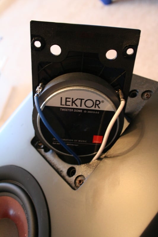

The 28mm (1.1 inch) tweeter is soft domed and black. The metal surround plate goes a long way toward making this stand out. The speaker grill is a bit flimsy for my taste and I was often concerned about breaking it during removal. The chrome posts, however, held snugly and there was never any fear of accidental removal. The problem was that the grill was very thin and the posts held it very firmly making for some tense moments. The thin frame was by design according to DALI to reduce reflections and diffraction from the frame.

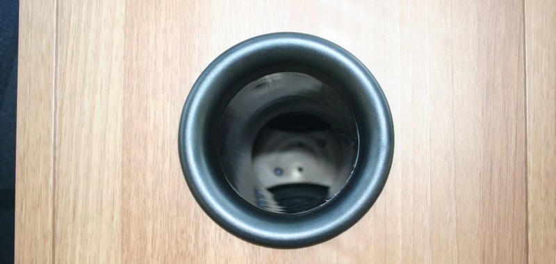

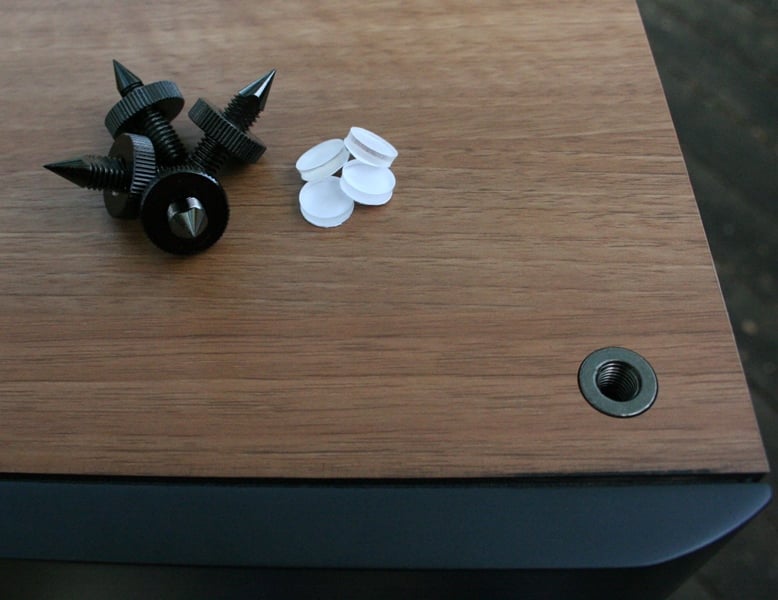

There are two ports on the speaker, one in the front near the bottom and
one about midway up the height in the back. The bottom of the cabinet sports
threaded inserts for carpet spikes (provided by DALI). The spikes have a HUGE
tightening nut which makes leveling these speakers considerably easier than
just about any non-outrigger equipped speaker I've reviewed. Unfortunately, the
only provisions for non-carpeted floors are little sticky rubber rounds that I
doubt would last a single move. If you are going to go this route, be
absolutely certain of your speaker placement before you install them as they
are sure to come loose with any adjustments. I'd get a small square of carpet
or maybe a thick towel to set them on at first until you are sure of the
orientation, location, and toe-in before installing the rubber pads. After
that, I'd leave them where they were or consider some sturdier aftermarket
feet.

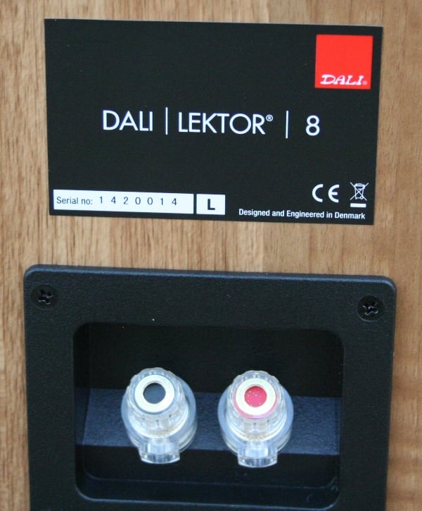

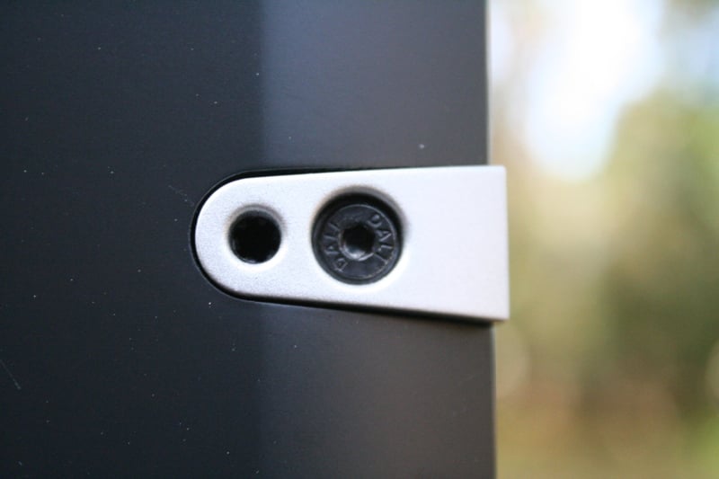

The binding posts in the back were different than any I've experienced before. At first I was convinced that they were five-way binding posts in look only. While most five-way have a plastic cap on top that is removable for use with banana plugs, it didn't look like the DALI's did. I would have sworn on a stack that the center post was solid with red or black paint on the top. When DALI informed me that there was in fact a plastic cap on top, I went back and checked. With some difficulty, I found out (much to my chagrin) that they were right. The cap is actually under the binding post nut (a bit of a divergence from the norm) which has to be completely removed to gain access. Even then, the tolerances are so tight on the plastic cap that it looks like paint. This presents a very clean look even if it did flummox me for a bit.

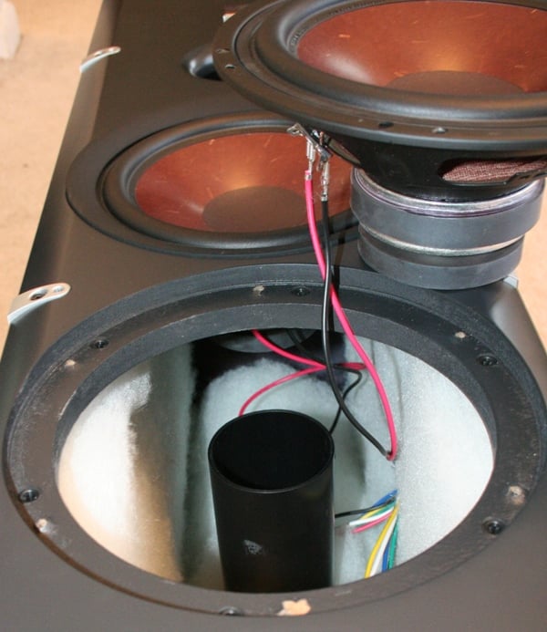

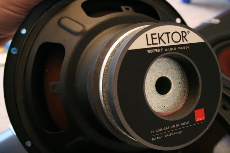

From the technical drawings,
I figured out how to disassemble (no disassemble #5) the speakers. Score one
for me. The front baffle is thicker than the other walls (according to the
documents they sent) and I measured it to be an inch thick! MDF construction
all the way around with the tweeter and 5" midrange in an enclosed box.
The two 8" drivers have the rest of the cabinet (including the space
behind the tweeter/mid box) along with the two ports. The ports are flared on
the exterior but not the interior. A layer of polyfil is glued/stapled to the
inside of the larger cabinet and pretty much fills up the tweeter/mid box. The
tweeter sports a very large magnet and is mounted to a well braced plastic
plate. There is a single brace just below the bottom woofer and above the front
port. This explains the more hollow sound at the bottom of the cabinet which
could use some more bracing. The woofers sport stamped metal baskets (I was hoping
for cast) and fairly large magnet structures. The specs say the drivers are
semi-magnetically shielded which I supposed means you can place them semi-close

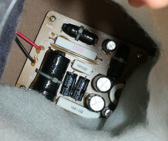

to your computer or CRT. The
crossover component parts were a bit of a disappointment (aside from the
ceramic resistors) as DALI employed iron core inductors instead of air cores,
and electrolytic capacitors with no poly bypass capacitors. I couldn’t help to wonder how much better
these speakers could have been with some higher quality component usage in the
crossover.

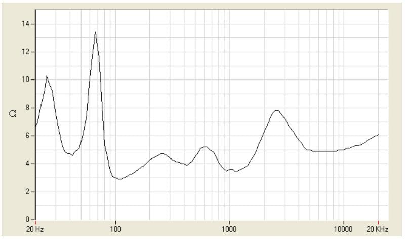

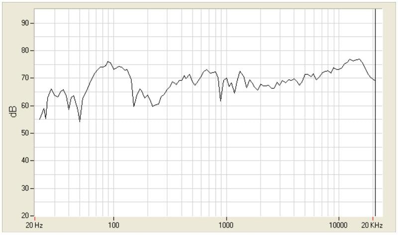

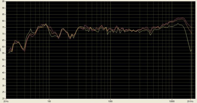

Measurements & Testing
For laboratory measurements I used the Sencore SP395A FFT Audio Analyzer and a Sherbourn 2/75B amp, I measured the DALI LEKTOR 8's in-room on- and off-axis frequency response with 1/12th octave resolution
DALI LEKTOR 8 1 Meter Frequency
Response (1/12th Octave) On Axis
Note
- this is NOT a 1 watt measurement
Our measurements indicate the LEKTOR 8’s tweeter response is set a tad too high as indicated by the rising frequency response at the tweeter crossover point. We noticed the same phenomenon when we tested the MENTOR 1’s but DALI explained this is deliberately done for a more uniform off axis power response. We suggest little to no toe-in to prevent listening fatigue.
DALI LEKTOR 8 1/2 Meter Frequency
Pink - On axis, Orange - 15 degrees off axis, Yellow - 30
degrees off axis
The LEKTOR 8’s frequency response looks best around 30 degrees off axis exhibiting a very linear response throughout the entire frequency spectrum. Its quite unusual for a speaker to have such a flat response this far off axis but it seems to serve the system well for those that like very articulate if not a lively top end response.
DALI LEKTOR 8 Impedance
The Sencore consistently measures impedance one ohm low. The impedance measurement indicates a tuning frequency around 40Hz as specified by DALI. Given the moderately high efficiency rating and fairly benign impedance profile, this speaker shouldn’t be too difficult for any decent multi-channel receiver to drive.
