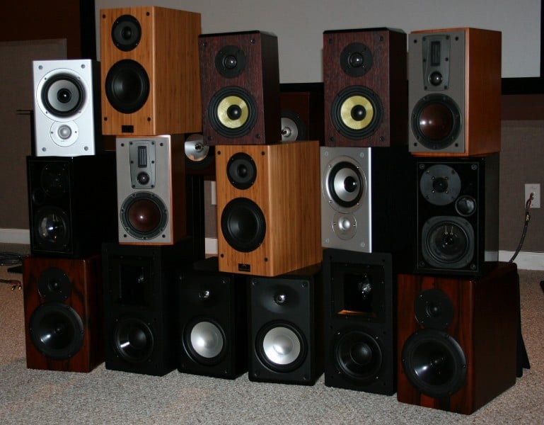

Step one, get a bunch of speakers...
One of the most popular articles we ever write on Audioholics is speaker or cable shootouts. Shootouts are really just a comparison of two or more products. This sounds like a fairly straightforward process where you place two competing products in the same room and take a listen/look. But the reality is that it is much more complicated. There are many ways that you can affect the outcome of a shootout by placement, accessories, even where you have your listeners sit. Through this technical article, we'll explore many of these issues and give you some helpful hints on how to set up the most valid and fair comparison.
