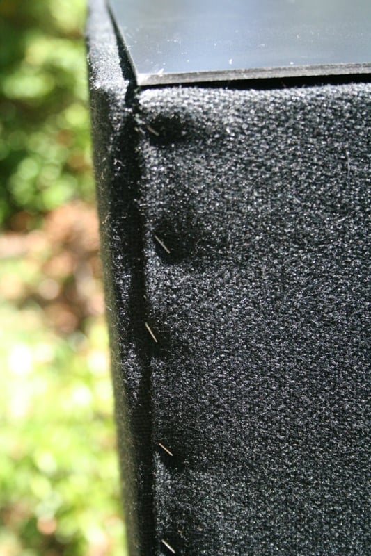

  • 2 feet wide and 4 feet tall
  • 6 Standard Colors
  • Upgrade with Guilford of Maine FR701 in 48 different as low as $20.00 per Tri-Trap
  • Come with plastic tops and bottoms that are colored - white tops on white Tri-Traps, black tops on all other standard colors
  • Convenient
  • Good size for most rooms
  • Effective
  • Price
  • Feel a little empty
  • No wall mounting system
  • Info on website hard to find/inaccurate

bpape posts on April 30, 2009 15:23
First of all, thanks for taking the time to review our product. We feel it's an excellent performer at a reasonable price.
The purpose of bass control is to not only address frequency response anomalies, but also to bring the decay time in the room more into line. In many rooms, the time for bass to decay can be almost a factor of 8-10x the time for upper mid and high freuqencies. Not only does this cause muddy bass, but it can also mask dialog, cause issues with low level details, etc.
Having treatments in the corners has specific benefits:
- Cover the corner space to minimize ‘horn effect’
- Corners are at the ends of multiple room dimensions so they tend to help with problems in 2 or even 3 dimensions
From our unofficial testing, the Tri Traps are effective down to around 50Hz. They'll still do something below that but not as efficiently as 50Hz up. 50Hz down, the waves are just SO large that they're difficult to deal with.
One other clarification from the review - while we do have a membrane in the Tri Traps, it is not the type of tuned membrane that was described. It's a damped membrane that functions over a wide area while serving double duty as a semi-reflector for upper mid and high frequencies to minimize the probability of overdamping that part of the spectrum.
For a true tuned membrane, the observations in the review would be correct and one would need to be sure that they're matching the design frequency to match the area you're trying to deal with. Ours are broadband devices. Tuning is accomplished by a combination of membrane mass, depth of cavity, and size of the membrane. For instance, a 2'x4' membrane would have a different tuned resonance than a 1'x8' membrane with the same cavity depth and membrane material.
Again, many thanks for the review. I'll try to keep watch on this thread and answer any questions anyone might have
Bryan
