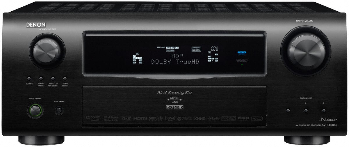

  • Product Name: AVR-4310CI
  • Manufacturer: Denon
  • Review Date: January 03, 2010 00:00
  • MSRP: $ 1999
  • Buy Now

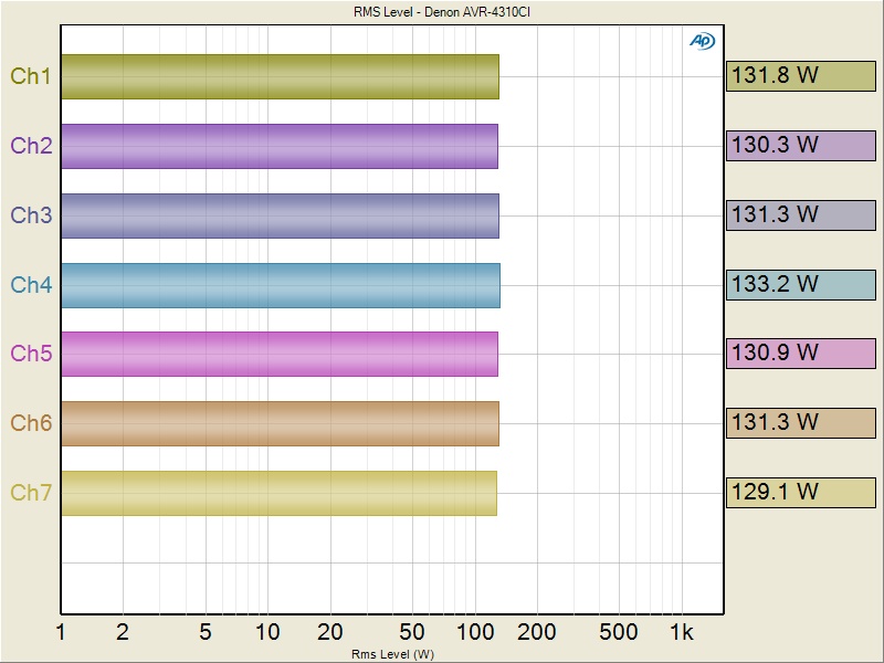

  • 130 watts per channel x 7 channels
  • Dolby TrueHD, Dolby Digital Plus, Dolby Digital Surround EX, Dolby Pro Logic IIz decoding
  • DTS-HD Master Audio, DTS-HD High Resolution, DTS ES 6.1 Discrete, DTS ES 6.1 Matrix, DTS Neo:6 decoding
  • Anchor Bay ABT-2010 advanced analog and digital video 1080p/24fps/60fps upconversion and deinterlacing with multi-cadence detection

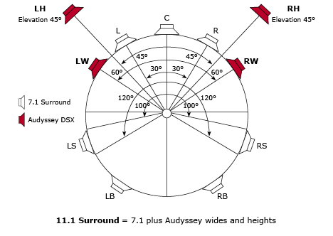

  • Audyssey Dynamic Surround Expansion for a more enveloping soundstage with front width or height channels – World’s First with DSX
  • Audyssey MultEQ XT, Dynamic Volume, Dynamic EQ
  • THX Ultra2 Certified
  • HD Radio AM/FM tuner
  • XM and Sirius satellite radio ready

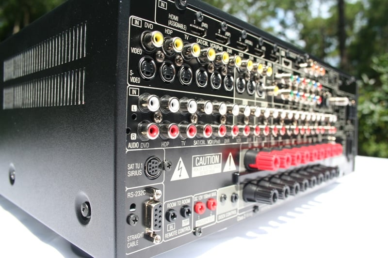

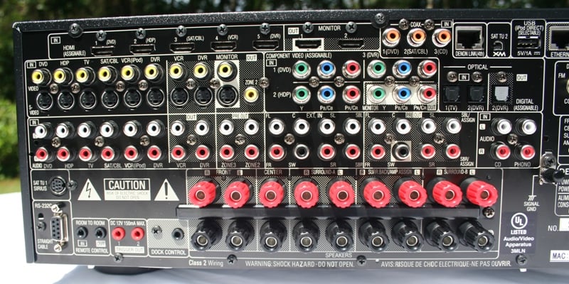

  • Six HDMI inputs, dual HDMI video outputs
  • Dimensions: 17.1" H x 6.7" H x 16.3" D
  • Weight: 34.8lbs
  • Onboard input specific video processing
  • Tons of power
  • All the latest decoding technologies
  • No input specific calibration options - only global

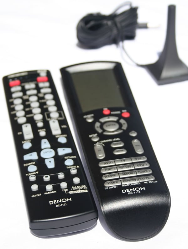

  • Remote only partially backlit
  • Wasted Surround B outputs could be put to better use
  • No multi-sub support
  • Streaming control delay

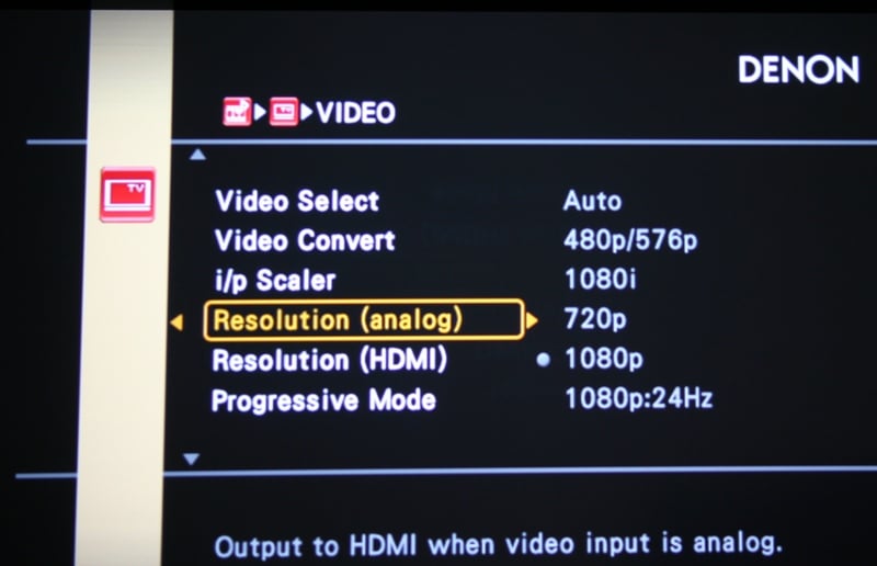

I'm the buddy from the greenline post. What's happening is if I switch inputs (I'm only using two, one for a dvr and one for a dvd) the screen goes blank. Both sound and video are gone. The TV says “no input”. If I cycle the power the input that I just switched to comes on. If I switch back to the other input the same thing happens. I have to cycle the power for the video and sound to come back.
You don't need to reset the processor if you connect to the receiver in your browser (assuming you have it connected to your network although, if you're only using two inputs, it shouldn't take too long to reconfigure.
If you're using HDMI, bypass the receiver and find out if they work flawlessly all the time (a day should do, as a time period. If you're using baluns because the distance to the TV is farther than HDMI cables will go, check the output resolution for the DVD player- is it BD or DVD?
Did you check the output resolution settings for the DVD and DVR?
Make sure you set the Input and Decode to AUTO, in Input Setup. Also, in ‘Input Setup’, click on Video when you're using the DVD and the DVR and make sure it's not set to ‘Source’. You need to do this in each, separately, because it's source-dependent.
The most important thing to remember- don't look at or consider all of the possible configuration areas at one time- think as if you have mental blinders and just ignore anything you're not dealing with at the moment. IMO, a lot of the manual could be left out and posted online in a separate section so it doesn't seem so intimidating. I don't care if it's a seasoned pro or a first-timer, nobody wants to read a 125 page manual from cover to cover.
