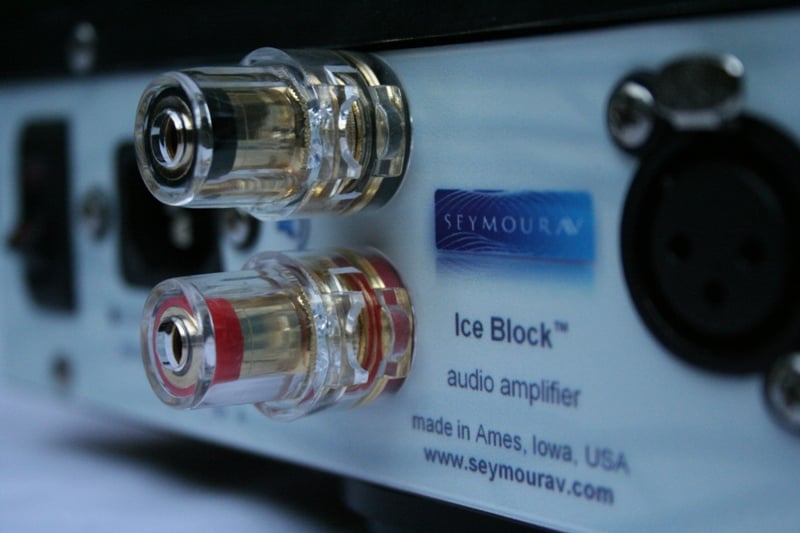

 - D.H. Labs Revelation 99.99% pure solid silver signal wire
 - WBT Nextgen Topline RCA terminal
 - Neutrik RF-shielded XLR terminal
 - Insulated, gold-plated 5-way binding posts (Uninsulated available as an option for those using massive spades. I had a customer - literally - hook up $22,000 MIT cables to the outputs, and they didn't like the insulated posts. So, uninsulated is a custom option)

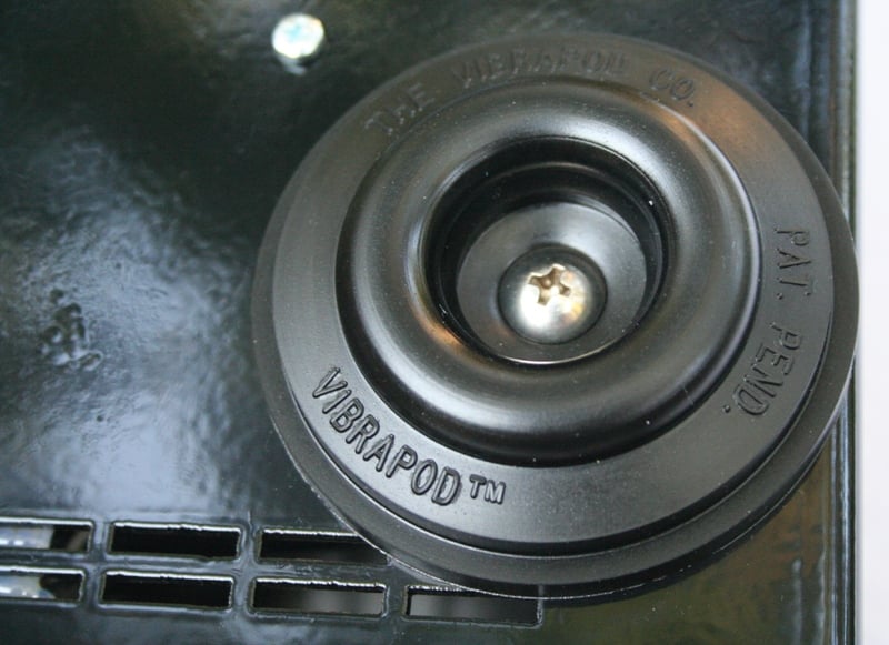

 - Vibrapod isolator feet

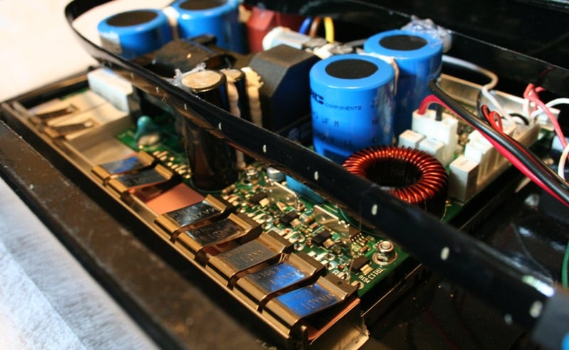

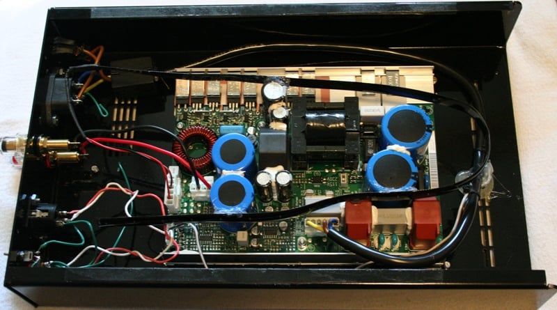

Taking apart the amp, we find the Bang & Olufsen's patented analog ICEPower amplification module mounted to a fairly substantial piece of aluminum. Around the top of the unit is a blue LED strip providing the internal lighting. I suppose if you really don't like the lighting, you could ask Seymour AV to eliminate that strip (it is plugged into the board for power and glued in several places). Between some of the components there is what looks like caulk seemingly for vibration control. I couldn't get a picture of it but there is also a sort of shock system under the aluminum plate most likely for the same reason.
I was unable to measure this amplifier since I don’t have the proper test gear to do so and it’s a bit trickier than traditional amplifiers because of the high clock frequencies associated with the amplifier topology that can manifest as poor performance results on test gear if not properly preconditioned.

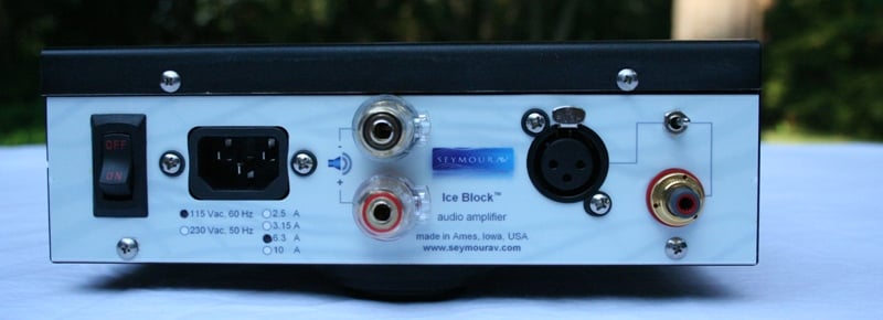

The back of the Seymour AV
5001 is as Spartan as you'd expect a monoblock - maybe moreso. There is an RCA
and XLR balanced input, a pair of 5-way binding posts, a three prong power port,
and an input switch. The power switch is fairly standard but lacking one
feature you might expect - any sort of power saving function. Now, one of the
first things you'll learn about class D amps is that they are very power
efficient. At idle, the 5001 amp only consumes 9 watts. Still, I don't always
want my amp powered up regardless of how efficient it is. A 12 volt trigger
would have been appreciated. I personally don't like (and refuse to use)
auto-on functions that sense an incoming signal and switch on so I don't mind
that it is absent on the 5001.

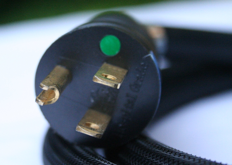

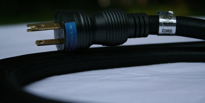

The first hurdle you're probably going to face is plugging the amp in. I
say that because Seymour AV provides an Acoustic Research Pro II Ferrite Noise Trap
(FNT) IEC power cord sometimes used to eliminate radiated noise. This is not a
desirable solution. Seymour AV has placed a ferrite filter on the power line
inside the case which seems to have pretty much eliminated the noise coming in
or out of the amp. They say that the power cord can be switched out with a
standard one without appreciable noise increase. Apparently, the upgraded power
cord was just a precaution.
The AR power cord, in practical terms, may look cool but it is the single least flexible power cord I've had the misfortune of using. While it is probably fine (and maybe even preferable) for open configurations (i.e., on a piece of marble in the middle of a room with cable elevators everywhere), forget about using them in a component cabinet like my Sanus CFA56. They just don't work. I had to use some extras I had lying around. While the cords look nice and feel very esoteric, they just aren't very practical.

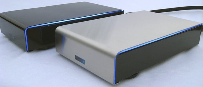

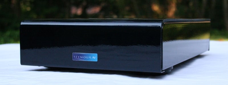

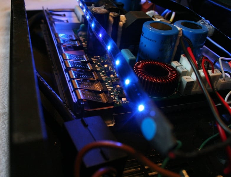

the line) has a very unique lighting scheme. If you follow the line of the amp
between the top and the sides, there is a small piece of plexiglass which is
backlit by blue LEDs. This makes for a very smooth and, dare I say it, designer
look. One of the things that the esoteric crowd has over the budget offerings is looks and the Seymour AV amps are
nose-and-nose with the best, leaving many others in the dust. The only thing
that is missing is some sort of front lighting. The Seymour AV logo sticker (the
only blemish on the amp's perfect aesthetics) is placed on the front but in a
darkened room, all you're going to see is the side lighting. This makes for a
very nice effect if the amps are out in the open (something I think even the most
devoted HGTV watcher wouldn't have a problem doing with these gorgeous amps).   Installed

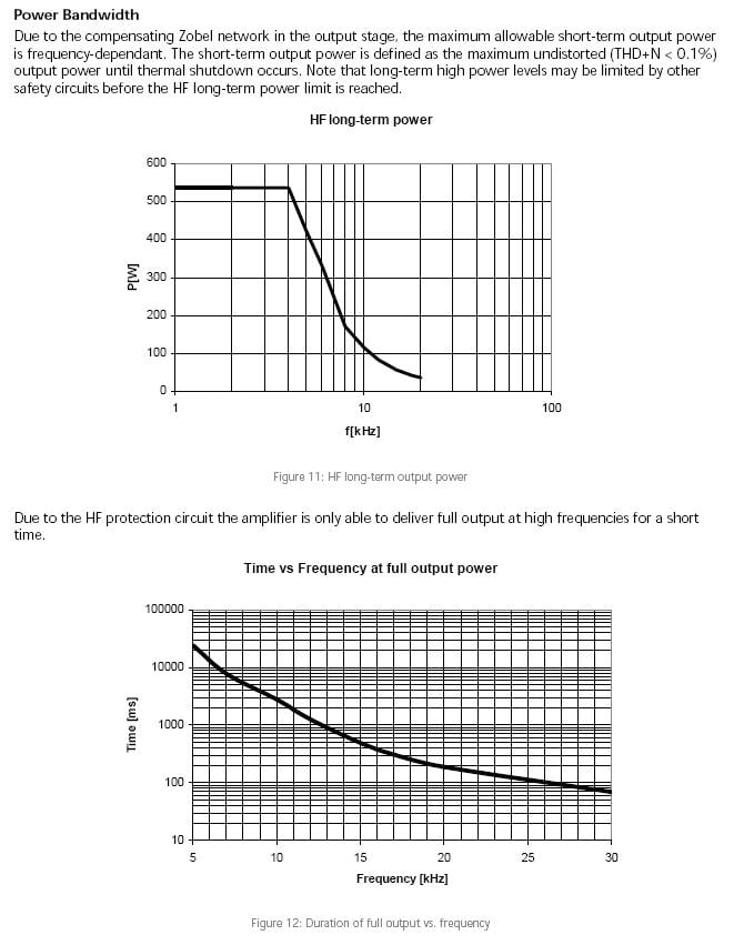

Ice Block amplifiers are equipped with a soft clipping circuit that applies light compression at maximum output, limiting the maximum signal level. This eliminates the clipping that traditional amplifiers experience when their signal exceeds the capabilities of the output devices. This feature ensure that you have optimum sound in high-level situations and protect both the amplifier and your speakers from dangerous tweeter-frying distortion.
The negative impact of this protection circuit is that this amplifier cannot do full power bandwidth continuously into a 4 ohm load as per the B&O Application note and Audioholics prior measurements of these amplifier modules. This is a limitation of the B&O module design and not representative of a flaw in the Seymour design. In most cases this won’t present a problem for real world applications but it's important to note the tradeoffs and limitations of this amplifier design.

one little wire was the culprit and will forever be banished from all future Seymour
AV amp offerings. Score one for me I suppose. Also, note the level of customer
service here. This is not just above and beyond because I'm a reviewer, but it
was a matter of pride with him. I gave him a free pass out of the review. He
could have just cut and run. But instead, he stuck with it even though he knew
(or should have known) that all of this would be in the review. That's what
Audioholics is all about - telling you how it is. That's why he wanted us to
review his amps. That's what he got and that's what we're providing you the
reader. Should you read this and say, "Whoa, that amp hummed?" No!
You should be thinking that anyone that is willing to risk a bad review because
he wants to make the perfect amp is probably going to make sure that you're
just as happy with your purchase. Something to consider.
