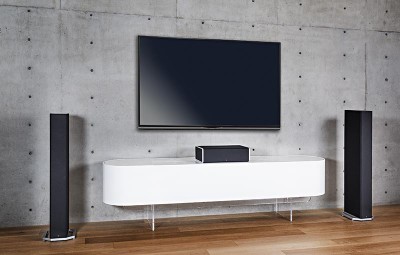

Definitive BP9080x with center channel
Definitive Technology's powered, bipole speakers have a slender styling

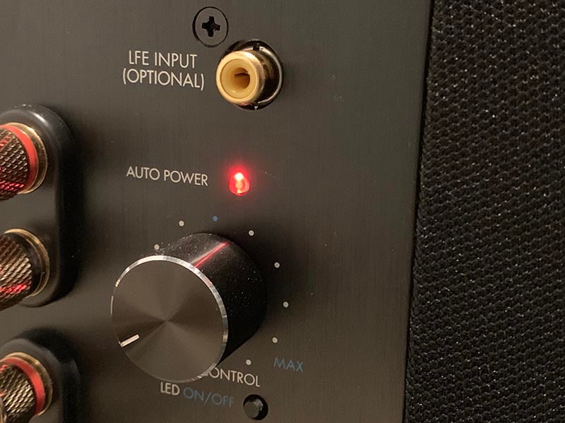

Definitive Technology BP9080x volume control and LFE input
The BP9080X, BP9060, and CS9060 all feature an LFE input and volume control.

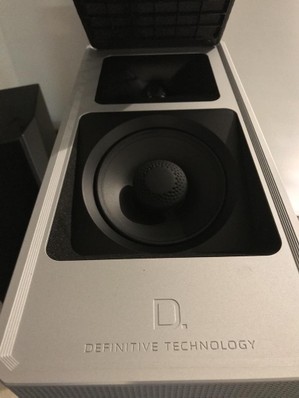

Definitive BP9080x atmos module (angled view)
View of the BP9080X's integrated Dolby Atmos height-enabled speaker. Notice how the driver is angled to fire sounds towards the ceiling.
Let me emphasize that the speakers are treated as a composite whole rather than a monitor and subwoofer combo. In fact, if you want the best performance, Definitive Technology recommends that you do not use the LFE input. The powered subwoofer is there to make the tower speaker truly perform across the audio band and into subsonic frequencies. Here at Audioholics, we have some additional recommendations that you can check out in our YouTube Video posted here below:

Definitive BP9080x atmos module built in
The BP9080X has a built-in Atmos-enabled module with a magnetic grille cover.

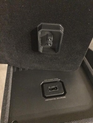

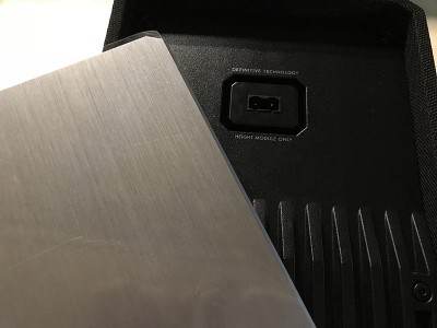

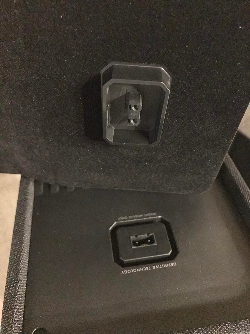

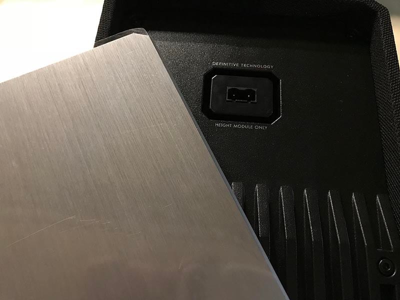

Definitive BP9060 A90 Atmos module adapter
The BP9060's top aluminum plate lifts off to reveal a plug for the A90 Dolby Atmos enabled speaker height module.

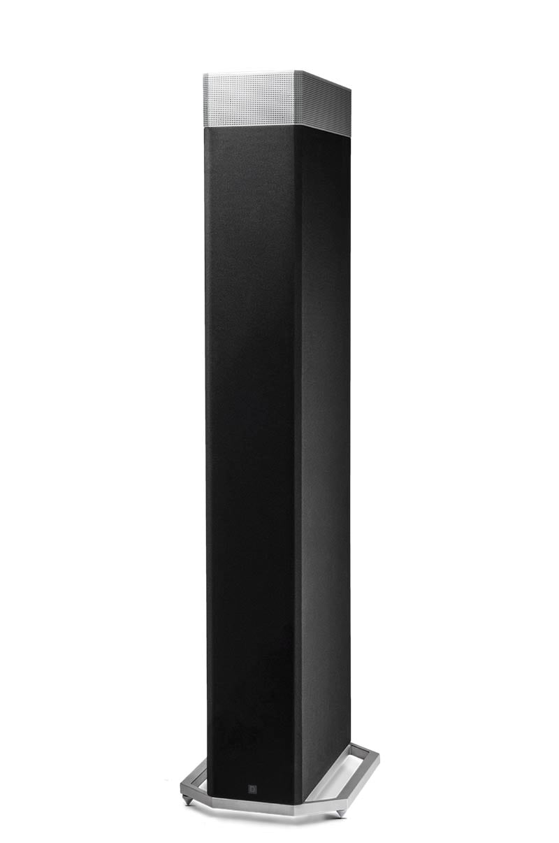

BP9080x

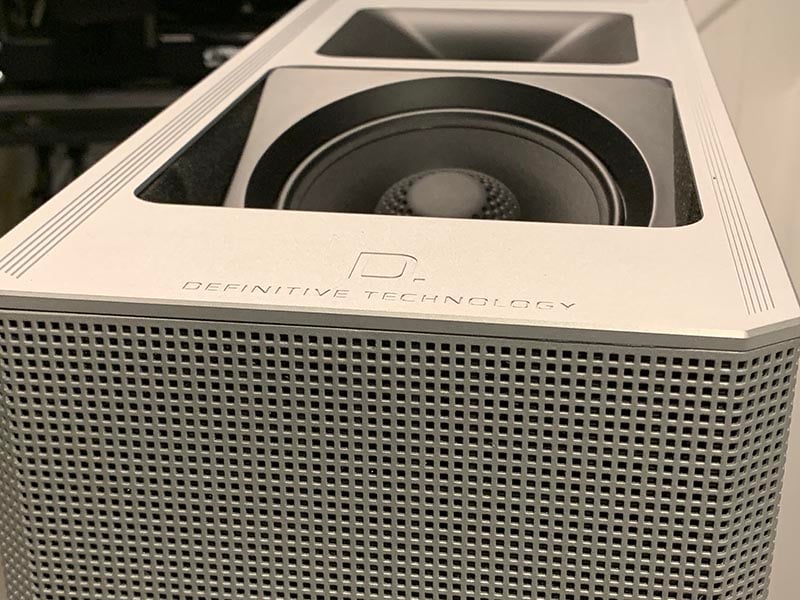

Definitive Technology BP9080X
The nearly 52-inch tall BP9080x ($3,498/pair MSRP) feature a 1-inch aluminum dome tweeter, two 5.25-inch midrange drivers, two 12-inch bass radiators and a single 12-inch subwoofer driven by a 455-watt Class D amplifier. The rear driver array, which handles the bipolar aspects, consists of a 1-inch dome tweeter and 5.25-inch midrange driver. As you'll see with Definitive's design, the front tweeter and midrange are mirrored on the back. The speaker is easy to drive with a sensitivity of 92db and an impedance of 8 ohms.
The BP9080x’s top sports an embedded Dolby Atmos enabled speaker. You cannot remove the Atmos module nor can you order a BP9080x without the Atmos enabled speaker. The BP9080X’s Dolby Atmos enabled speaker consists of a 1-inch aluminum tweeter and 5.25-inch mid/woofer. It's the same driver configuration as the A90, which I describe in more detail below. There are two sets of binding posts on the lower rear of the speaker. The top set is for the Atmos-enabled speaker and the bottom set is for the tower. You cannot biamp any of the models. The BP9080x boasts a total frequency response of 16Hz-40kHz. Definitive technology does not provide consumers with a ±db rating.  Some manufacturers provide frequency measurements at ±3db, others at ±6db, and we've even seem some rare cases of ±10db. We want to call out Definitive Tech on this issue and that they should be more transparent with the consumer about their measurements. Irrespective, many tower speakers and dedicated subs don't achieve those specs. You'll have no problem playing the deep notes of Saint Saëns Organ Symphony with these babies.

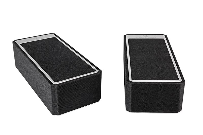

A90 Atmos-Enabled speaker
Definitive Technology A90 Atmos module
Speaking of which, the A90 Dolby Atmos-enabled speaker module retails for $499/pair and is timbre-matched for the BP9060 and BP9080x’s Atmos-enabled module. When it’s connected, you can’t tell aesthetically that the A90 is an add-on module.  The A90 is a significant upgrade to the subpar A60 first generation Atmos-enabled speaker that featured a 4" full range paper whizzer cone driver.
The A90 sports a 1-inch aluminum dome tweeter and a 4.5-inch midrange driver. As mentioned, the BP9060 has a pair of binding posts on the speaker's rear that connect to the A90. This feature keeps your speaker cabling neat and even allows you to use four-conductor speaker cables for clean runs. The A90 has a frequency response of 86Hz - 40kHz. That's a larger than expected frequency range for a height speaker. Many competing Dolby Atmos enabled speakers don't deliver as wide a frequency response as Definitive’s. In fact, most are crossed over above 150Hz so it's good to see this speaker actually has usable bandwidth almost an octave lower than most Atmos-enabled speakers.

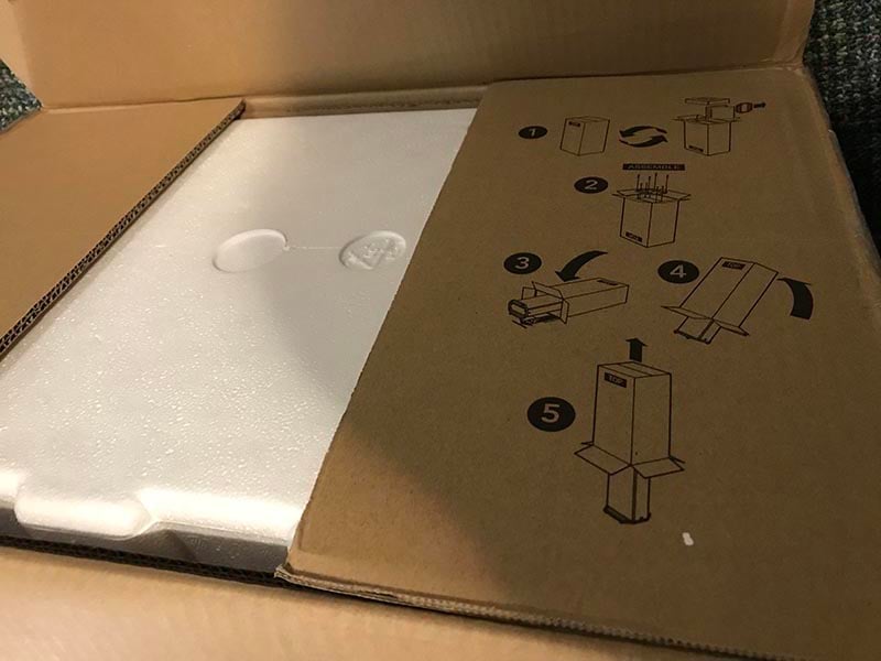

The Definitive 5.0.4 setup came on a wooden pallet for delivery. Definitive does an outstanding job packaging the speakers, giving you that "pride of ownership" experience. Each of the towers required attaching the aircraft-grade aluminum bottom plate and corresponding spikes or hardwood floor guides for hardwood floors. Both feet can be used to level the speaker on whatever flooring surface you have in your space. Build quality for all parts was outstanding. There was nothing cheap or second class in my experience. Setup took about an hour.
Unboxing the Definitive Technology Speakers
Definitive provides you with a graphical step-by-step unboxing.

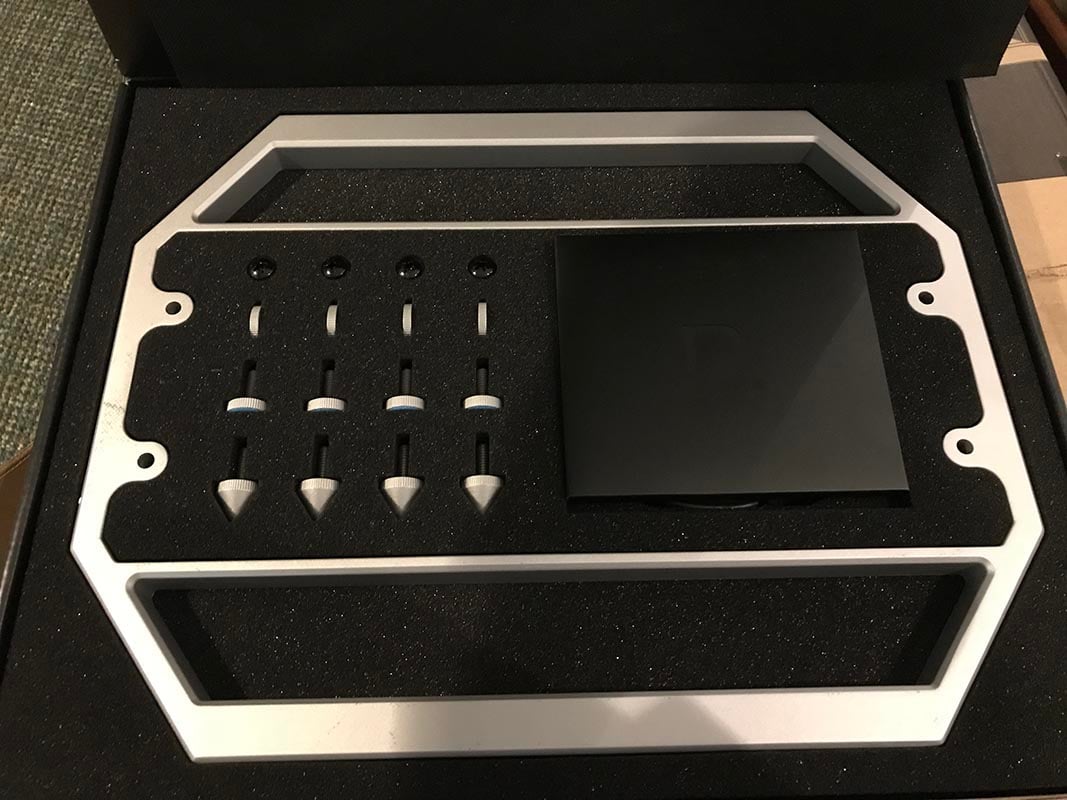

Definitive Technology spiked feet options
The accessories box comes with the speaker's footing and spiked feet options. There are traditional spikes and flat feet for hardwood floors.

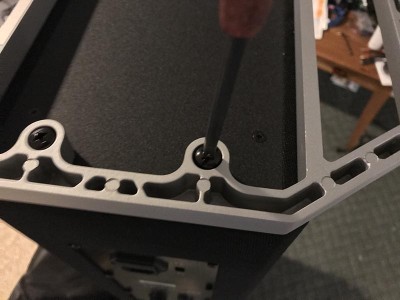

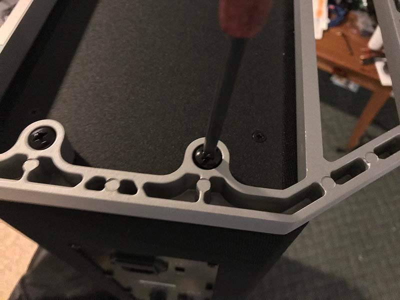

Installing the Definitive Technology Screw Plate
The Definitive Technology screw plate, made of aircraft-grade aluminum, attaches easily to the bottom of each speaker.

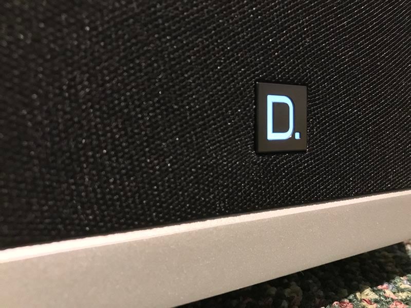

Definitive technology glowing D on each speaker
The glowing "D" lets you know that a speaker is active. You can turn the illuminated "D" off.

The BP9060's top lifts up so you can literally plug-n-play the A90 Dolby Atmos-enabled speaker module.

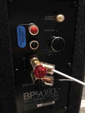

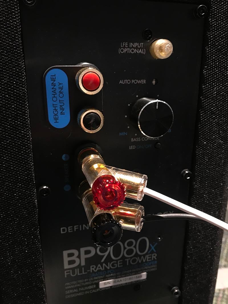

Two sets of binding posts allow you to connect height channels
The BP9080X and BP9060 have two sets of binding posts on the back so you can connect both the main speakers and height modules.
Definitive labels the height channel binding posts so you don't make a mistake.
