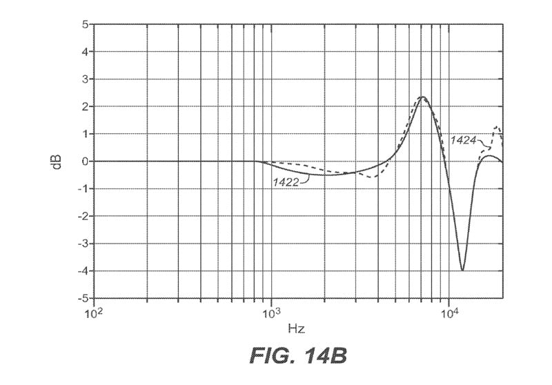

Editorial Note on Dolby Atmos Elevation Speaker Patent
It’s important to note that Dolby has applied for at least six patents relating to the Atmos Elevation speaker technology though none of them have been granted at the time this review has published. There is plenty of prior art for upward firing speakers which makes that portion of their patent rather weak. However, they do have a good case for getting the patent on the associated circuitry and firmware for Atmos.For more information see: Dolby Atmos Elevation Speakers Explained

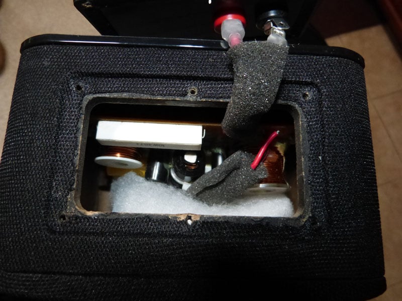

The A60 Atmos elevation speaker module employs a rather complex crossover network. As previously stated, this is part of the Dolby patent application to justify manufacturers stamping the name “Atmos” on the speaker. The crossover features 3 inductors (one air core, 2 iron core), 3 capacitors (1 mylar, 2 electrolytic) and 2 resistors all fed to a single 3” treated paper driver in a sealed enclosure. I couldn’t fit my fingers inside the enclosure to trace out the crossover but it appears to be the Dolby Atmos crossover with one additional inductor which I could only surmise was used in effort to help linearize the response of the driver around 1kHz which looks pretty nasty as you will see in the frequency response measurements.
Definitive Technology A60 with Grille
Removed (left pic) and Inside Look at Crossover (right pic)

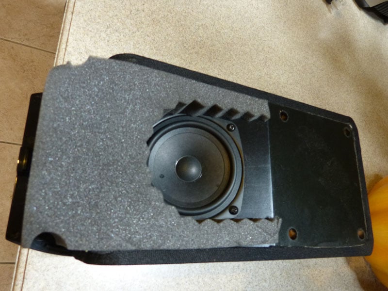

The grille is removable only if you unscrew the two screws towards the bottom front of the speaker. Once removed, you can see Definitive did put some thought into reducing diffraction caused by the recessed baffle, while also controlling dispersion by surrounding the driver in a thick foam pad. The idea here is to limit lateral dispersion so that the sound projects up to the ceiling which is a design goal of such a speaker per Dolby.

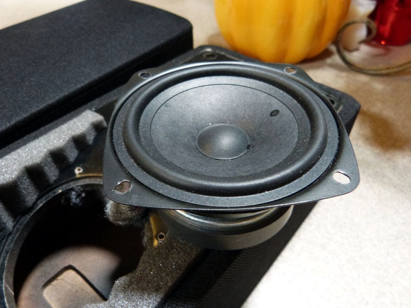

Definitive Technology A60 3” Paper Atmos Driver

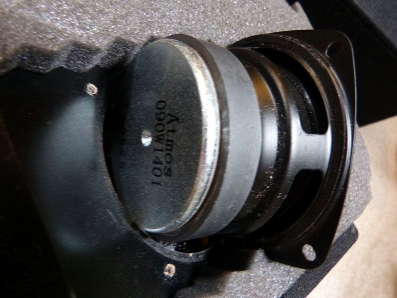

There’s not much to look at here. This 3” paper driver is reminiscent of a Radio Shack Tandy driver often found in TVs. It’s a 3” cone with butyl rubber surround and stamped basket. It has “Atmos” stamped on the back plate, which I presume has to have a specific DCR in order to work with the fixed values of the Dolby Atmos crossover. I measured the DCR to be about 5 ohms in case anyone is wondering.

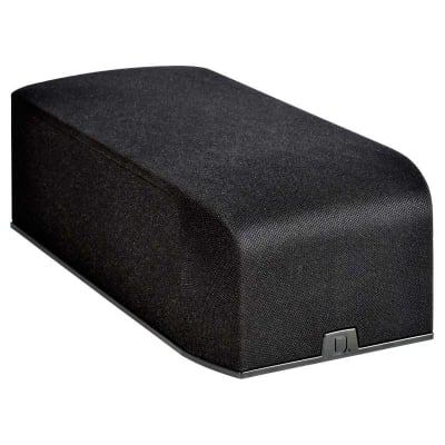

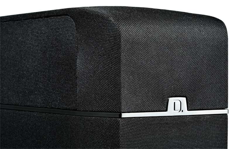

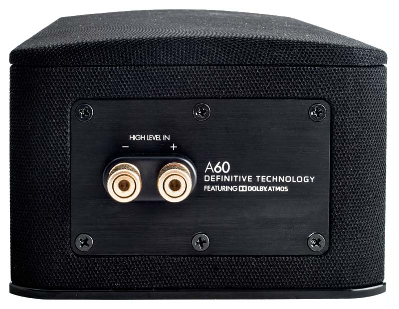

The A60 is wrapped in speaker cloth to give it a uniform look as well as help the module aesthetically blend into Definitive’s BP-8060T towers. Gold plated 5-way binding posts are employed to make your speaker wire connections to the appropriate Atmos height channels of your A/V receiver. Note the Dolby Atmos logo. Given the seemingly inexpensive components used, I suspect a significant portion of the $499/pair cost of these speakers has to do with the royalty fee Definitive is paying Dolby.

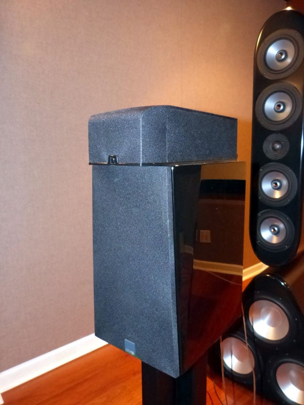

set up the Definitive Technology A60 Atmos modules in the two listening rooms:
1. The Audioholics Showcase Theater Room, which is an acoustically controlled listening space roughly 6,000 cubic feet with 8’ flat ceilings and
2. The Audioholics Family Room system which is a large untreated open room with 10’ flat ceilings.
The core of the test setup was the recently reviewed Denon AVR-X5200W A/V receiver with four A60 Atmos Elevation speaker modules. The SVS Ultra bookshelf speakers were used as the main front channels, Status Acoustics 8C for the center channel and RBH 41-SE/B bookshelf speakers for the surround speakers, with a small but potent Velodyne MiniVee subwoofer to cover the low frequencies. The source was Oppo’s BDP-105 Universal Blu-ray player and all speaker cables and interconnects were provided by Blue Jeans Cable. With the exception of my über expensive center channel, I tried to test with speakers consistent with a $2,000 A/V receiver. The SVS Ultras matched my RBH speakers extremely well, as confirmed via pink noise and program material. However, the Definitive A60 Atmos speakers were a different story. The pink noise revealed the A60s were extremely narrow band limited, and I will get into how this affected the overall timbre match of the system via the listening tests.

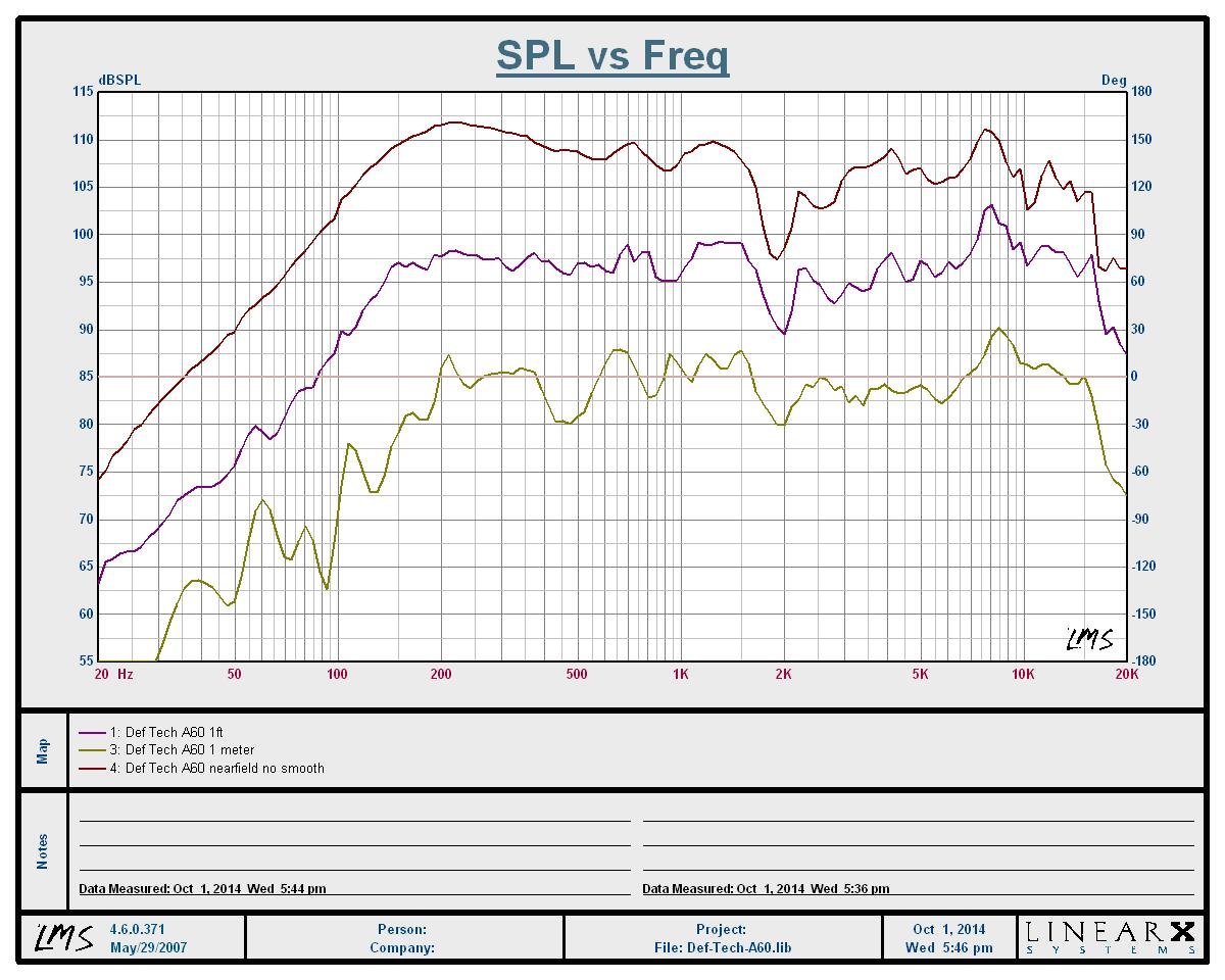

I set the A60 Atmos speaker module on a 32" stand firing up at the ceiling with the microphone from my LMS system above the driver with the proper offset to account for the angled baffle and measured at the various distances as shown below in the measurement graph.
Definitive Technology A60 On-Axis
Frequency Response Measurements
Purple: 1ft, Gold: 1 meter, Red: nearfield (no smoothing)
Dolby Atmos Speaker Target Frequency Response
Although Definitive Technology doesn’t specify sensitivity for the A60, I measured about 85dB as you can see in the gold trace measured at 1 meter. The BP8060ST is rated at 92dB SPL on-axis at 1 meter. That’s a -7dB delta and yet another reason why the A60 is not really a good match as a mating Atmos speaker module. The A60 speaker module exhibited some of the worst frequency response measurements we’ve ever seen in a loudspeaker that has graced our labs in our 15+ year history. Note the huge dip at 2kHz. I suspect this is due either to the partial horn loading of the enclosure that the driver is seeing in the cavity or just a sonic nasty from the driver or a combination of both. You can see the slight +4dB elevation at 8kHz and -2dB dip around 11kHz in the A60 frequency response. This isn’t quite on target with the Dolby frequency response graph from figure 14B of their patent application. However, this isn’t surprising when trying to do high Q frequency response correction in the analog domain with a one-design fits all crossover while dealing with not only part tolerances but driver tolerances as well. It is doubtful that the Dolby crossover is contributing anything audibly beneficial to this speaker with respect to increasing the elevation effect. This is especially true since as Dr. Floyd Toole pointed out at CEDIA, we don’t hear high frequency high Q nulls since they are not definitive and depend on many circumstances. A high frequency null is very directional at 12kHz where the wavelength is only about 1” with a .5” path difference which is significantly smaller than the space between our two ears making it impossible to detect. Thus incorporating a notch filter into an Atmos speaker crossover is not needed to help create the illusion of height
The A60 module appears to have about a 180Hz -3dB point with a 12dB/octave slope and I recommend setting the bass management of your Atmos AV receiver to its maximum setting (typically 250Hz), to help reduce its omni-directional dispersion at the lower frequencies.

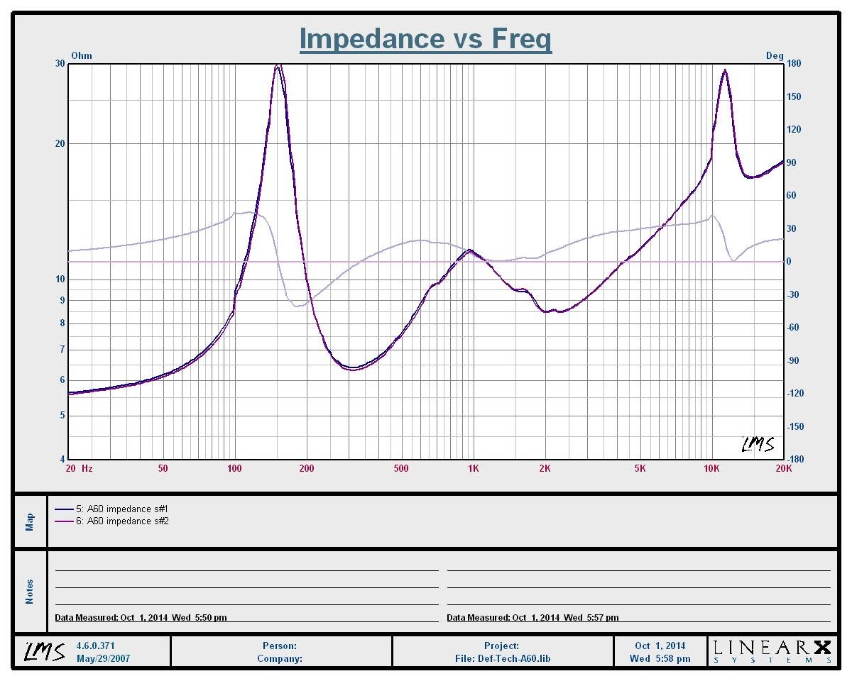

Definitive Technology A60 Impedance/Phase Response
Definitive Technology doesn’t give the full specs on the A60, but it appears to be a 5 ohm speaker. Notice the rise in impedance at 1kHz. which may explain a driver non-linearity that they were trying to compensate for with the extra inductor. Since consumers using this speaker will typically install it with bass management set to 150Hz, or higher to reduce omni-directional sound inherent at lower frequencies, there shouldn’t be any issue driving this speaker with a typical Atmos A/V receiver.
