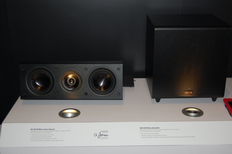

The Pioneer Elite SP-EC73 center speaker and SW-E10 subwoofer round out the package.
Moving to the SW-E10, frequency response is rated from 30Hz-150Hz, which isn’t surprising for a sealed subwoofer living in a pint sized 13” cubed enclosure. Given the 10” driver size and linear excursion rating of 1” peak to peak, it’s fair to say that the SW-E10 isn’t going to be a low end monster, or even a really mean little gremlin like the JL E110 (which is notably more than twice the price). However, given the form factor and price point, Pioneer’s Elite sub should be a capable, if not awe inspiring competitor.

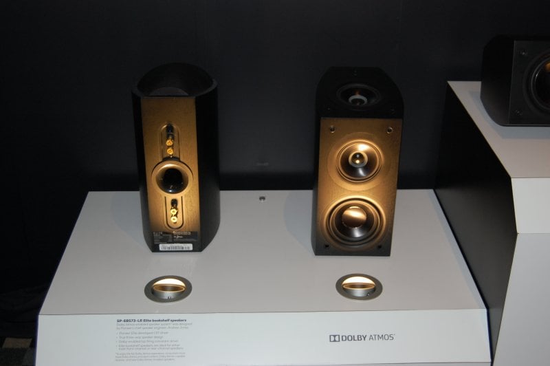

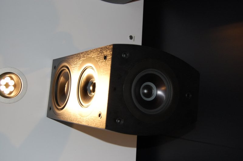

The second thing buyers will notice relates to the bookshelf and tower speakers: both feature a second concentric driver at the top of the cabinet, which fires towards the ceiling. No, this isn’t Pioneer’s attempt at an omnipolar speaker. Instead, the top-firing driver is part of how Pioneer plans to support Dolby Atmos in the home: Atmos-enabled speakers (otherwise known as Elevation speakers).
The Pioneer SP-EBS73-LR bookshelves and SP-ESF73 towers are Atmos-enabled speakers which boast an up-firing concentric driver.

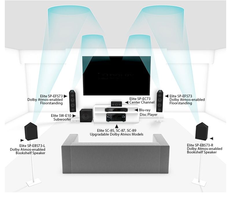

Our initial reaction to this idea was pretty skeptical. However, since Pioneer's announcement we've learned that there's more to Atmos-enabled speakers than meets the eye. A high pass filter is applied to the up-firing array at 180Hz in the AV receivers bass management when you select "Atmos speaker", easing its burden considerably. In addition, Dolby has formulated a bit of DSP magic which they claim will allow an Atmos-enabled speaker to convincingly pull off the illusion of height. The big question is: how well does it actually work? Fortunately, we were able to score some demo time with a full Pioneer Elite theater system at CEDIA, so we're able to answer that question. Suffice it to say that in spite of our initial skepticism, we walked away duly impressed with what Pioneer is offering. While an Atmos-enabled speaker doesn't necessarily deliver the exact same experience as an in-ceiling speaker, the Pioneers were able to pull off height effects quite effectively, including a thunderstorm raging over our heads. After our experiences in the demo room, we would definitely like to get these in-house for a bit of further testing and evaluation.

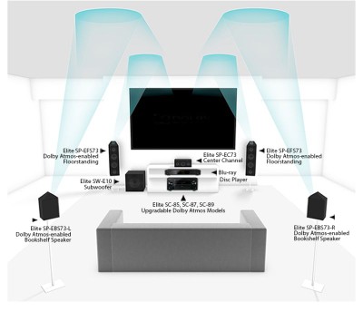

5.1.4 Atmos system diagram using Pioneer's Atmos-enabled speakers.
Ever since Andrew Jones stunned the audiophile world with his budget speaker line, we’ve been waiting for the encore. While the new Pioneer Elite lineup probably won't win any awards from interior decorators, for the home theater buff on a budget, they're worth a close look. In addition to bringing a high tech concentric driver to the table, these speakers feature an integrated Atmos Elevation module, allowing for a 5.1.4 Atmos setup that looks like a standard 5.1 system, while forgoing the complexities of adding in-ceiling speakers. While we had some questions about the effectiveness of the Atmos Elevation speaker concept, a demo of Pioneer's full Elite theater system at CEDIA has allayed many of our concerns. At this point, the only questions we have are a. whether other finishes will eventually be offered, and b. if we'll see non-Atmos versions of these speakers for those who opt not to upgrade to Atmos or choose to go with in-ceiling speakers.
