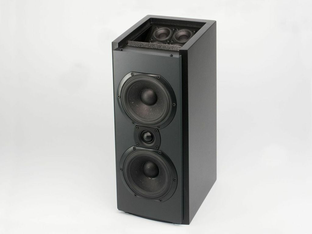

Triad Bronze LR-H Dolby Atmos Elevation Speaker (MSRP: $1000/ea)
Triad has stuck with their tried and true formula for the Bronze LCR with
the LR-H. On the front are two 5.5" SB Acoustics drivers and one 1" SB Acoustics fabric
dome neodymium tweeter in a D'Appolito configuration. The speakers come in a
variety of finishes including custom paint if you so desire. While details of

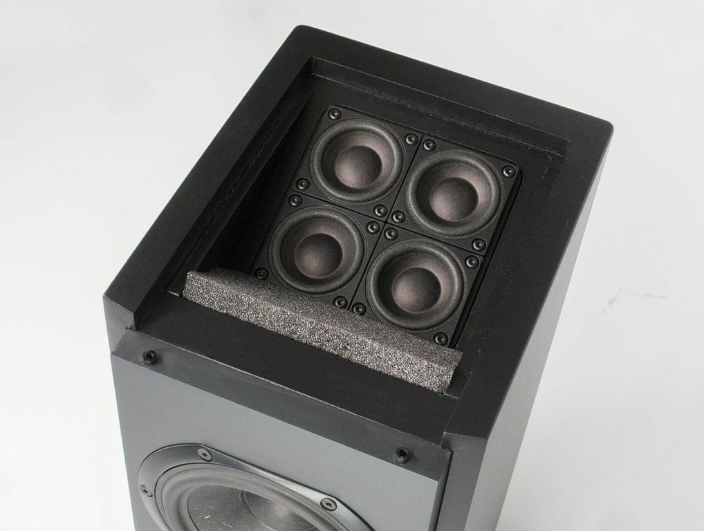

the angle of the Atmos drivers are limited, we do know that each Triad Bronze
LR-H will have four, 2" full-range ScanSpeak neodymium drivers on the top. Scan-Speak make some of the best drivers in the world so don't scoff at this upon first inspection. The tight pattern on the ceiling is said to yield a better effect, without the untidiness of a wide-dispersion array. The usage of four drivers for the Atmos module also greatly increases power handling which is a point of concern compared to the single 3" driver solutions we've seen from a few competitors. We are curious how these will perform seeing how directional cues from Atmos HRTF from 7kHz and up would require adjacent driver spacing to be no greater than 1" (1/2 wavelength of 7kHz) to minimize driver to driver acoustical interference issues but theory vs reality often produce different results.
As Dolby has now specified that rear speakers are supposed to be at ear-level (rather than farther up on the wall as we were told before the days of Atmos), the Bronze LR-H speakers are sold individually and can be used as front Left and Right speakers are well as rear left and right speakers. The Triad Bronze LR-H speakers claim a frequency response down to only 88Hz (-3dB) which means you may have to raise the crossover point of your subwoofer to 90Hz for a more optimal blend. They are also a 4 ohm speaker indicating that they may require external amplification to play to their fullest.

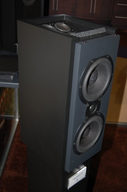

Currently, the only place to see or hear these new Triad Bronze LR-H speakers is a CEDIA 2014 where they will be debuted. They are scheduled to ship in the fourth quarter 2014. As you would expect, the Triad Bronze LR-H is voice-matched with the rest of the Bronze line so that you can build a complete home theater with subs, surrounds, and even in-ceiling Bronze speakers.
