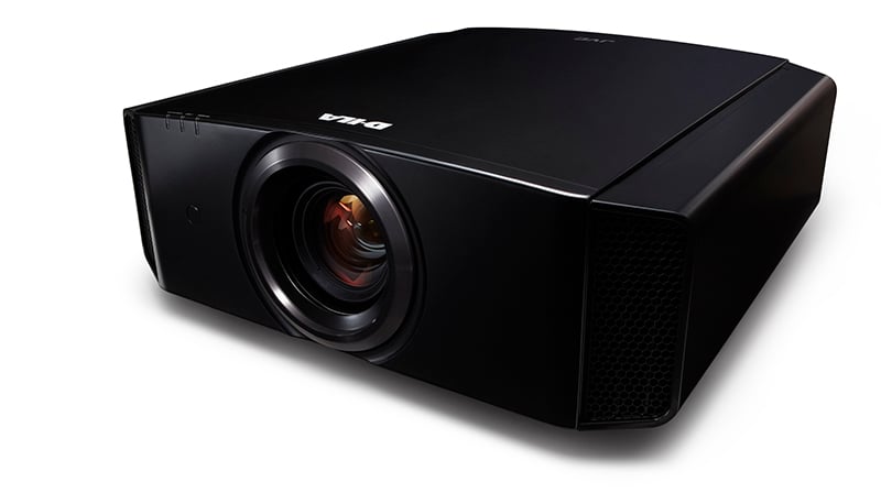

The JVC’s NSH 265W lamp is capable of pumping out 1,800 lumens to a screen size between 60 - 200 inches diagonally.  JVC claims that you’ll be able to get about 4,500 hours from the lamp in low power mode and 3,500 hours in high.  When you need to replace the lamp, it will set you back $599 (MSRP), though I found some street prices under $500.
As a side note, using low brightness mode in a projector will increase its lamp life and is generally quieter (less fan speed needed to cool the bulb) but it produces a dimmer image. Whether you chose low (called “eco mode” on some projectors) or high brightness mode with traditional HD sources typically depends on your projector screen’s gain (or capability to reflect projected light) and your ability to control light in your room. Remember that ambient room light will wash out a projected image.

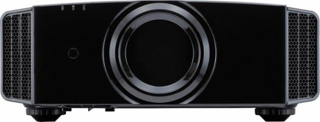

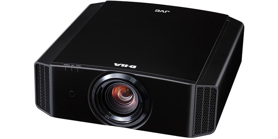

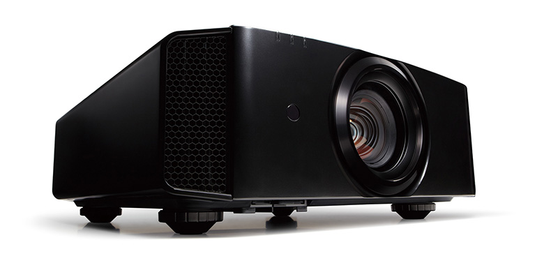

JVC DLA-X570R profile view
Front and side view of the JVC DLA-X570R
You should typically use the high brightness setting in scenarios where you need higher brightness like 4K/UHD and HDR sources; using a lower-gain screen, or you don’t have great light control in your room.  There’s typically some color shifting that happens between low and high brightness mode, so if you’re calibrating your projector, you’ll want to do a calibration for each mode.  Thankfully, JVC allows you to save individual calibration settings. You could, therefore, do a calibration with the projector in low and again in high and call them up separately if needed.
In low brightness mode, JVC says that the projector’s fan noise is about 21dB.  To put that in practical terms, in my testing fan noise in low brightness was close to inaudible. Only when I switched to high brightness did the projector get noticeably louder than my room’s typical noise floor.  Using an SPL, I measured a 6db difference between the two modes at about six-inches from the projector. Of course, the further away you go the less dramatic the difference. I noted about a 2-3dB SPL difference between low and high brightness mode at my seating position approximately 9.5 feet away.

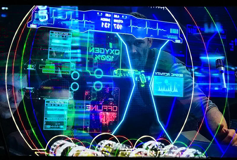

Difference between SDR and HDR images
JVC's marketing images give you an idea of the differences you'll see between an SDR (standard dynamic range) and HDR (high dynamic range) image with expanded color gamut.
While these images are simulated, there's no question that HDR and expanded color are the real deal.

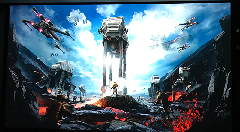

Star Wars: Battlefront on Xbox One
Star Wars Battlefront on Xbox One and any game for that matter was simply spectacular through the JVC.
The new low latency mode for gaming made a noticeable difference.

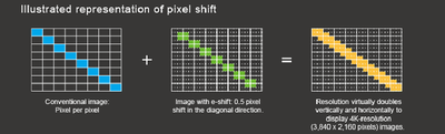

Remember, the JVC DLA-X570R is technically a 1080p projector. However, thanks to JVC’s pixel-shifting technology, the DLA-X570R is capable of pumping out a 4K image. JVC first introduced their e-shift pixel shifting technology in 2013. The DLA-X570R contains JVC’s fourth generation e-shift technology.
Let’s explain how the X570R accomplishes this 4K/UHD feat from a 1080p projector. The JVC breaks down a native 4K/UHD 3840 x 2160 signal into two 1920 x 1080 images. The JVC then projects the first 1920 x 1080 image and a fraction of a second later projects the second 1920 x 1080 image but shifts the second image diagonally by a half pixel.  It then repeats this process, constantly alternating the two portions of the 4K/UHD signal. Because this happens so fast, our visual perception creates a composite 3840 x 2160 image whose resolution is virtually indistinguishable from a true 4K projector. In fact, if you had a native 4K projector side-by-side with the X570R you’d be hard-pressed to tell the difference. It’s that good. The effect, if you think about it, is a bit similar to how traditional film tricked our visual perception to assemble individual frames together to create the illusion of motion.
JVC eShift-4 Technology
How JVC's e-Shift4 technology works to create a 4K/UHD image from 1080p chips.
In my tests across a variety of UltraHD Blu-rays on both a 90-inch and 119-inch screen, I found JVC’s E-Shift4 to be absolutely stunning. It’s not a gimmick; it works wonders.

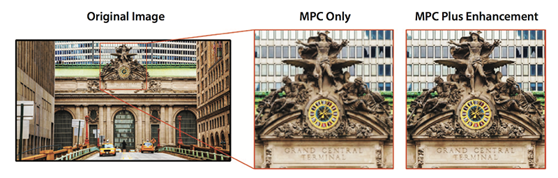

There are a few other technologies that JVC includes to enhance your viewing experience. Most notably, JVC includes MPC (Multi Pixel Control) and CMD (Clear Motion Drive) which is the company’s 120Hz frame interpolation. MPC is a new image processing algorithm that JVC developed that the company says creates a natural impression that areas in focus are sharper and areas not in focus are softer. The company says it creates a greater sense of depth with 4K/UHD sources. It’s an interesting feature and you can adjust its intensity or leave it off.  I used the default settings, which I found to be just right.
JVC X570R MPC
JVC's MPC enhancement technology

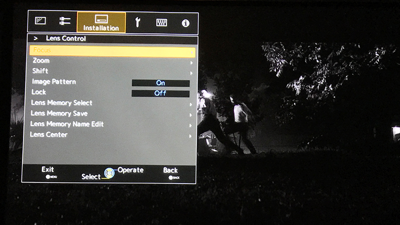

JVC Lens Control
There are ample lens control and lens memory options available on the JVC X570R.

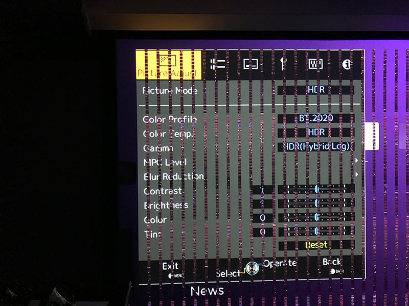

Now some users have reported online that enabling CMD can produce vertical banding on some material. Vertical banding is an issue you’ll sometimes see with LCD projectors (DLP-based projectors have their own issue called rainbows). When vertical banding occurs, you start to get subtle, but noticeable, vertical bars in your image. The vertical bars can sometimes be as wide as 1-inch. Vertical banding can subtle all the way up to nasty and really distracting. As a general rule with LCD projectors, vertical banding and its severity can sometimes differ with different units of the same model (and can be maddening).
I reached out to JVC to ask about these reports.  JVC told me that if vertical banding does occur it can be minimized by adjusting levels in noise reduction. I saw that some users claimed anecdotal evidence that the severity of the banding varied depending on the 4K/UHD player. In my testing with my source UltraHD Blu-rays and Oppo UDP-203, I did not readily notice any vertical banding during actual programming.
Enabling CMD did have another impact that I experienced. It tended to increase the X570R’s lag time to switch resolutions when handshaking HDMI sources.
Enabling CMD did have another impact that I experienced. It tended to increase the X570R’s lag time to switch resolutions when handshaking HDMI sources. The JVC isn’t a speed demon to begin with, so this made the lag time even worse. This was most painful with switching screen resolutions on the Roku. It took so long for the JVC to switch resolutions that upon initial setup I couldn’t see the Roku’s picture settings dialog box to confirm them.  I was stuck at 720p in an unending Ground Hog Day loop.  Turning off CMD will improve the JVC’s X570R speed, so keep that in mind.

I set up the JVC approximately 24 feet from my two screens. I placed the projector just below the ceiling.  Using JVC’s granular menus and feature set, I was able to get the projector spot on.
I appreciated the JVC X570R’s lens memory feature. I have both a 90-inch 1.1 white gain and 119-inch 0.8 gain grey screen (one screen is immediately behind the other). I created two lens profiles with custom settings for size and focus. I could switch to either lens memory setting at the press of a button on the excellent remote. Once set, the X570R kept fairly consistent memory settings between the two screens that didn’t require constant readjustment.

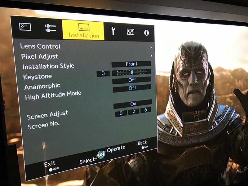

One feature is a screen adjustment option where you reference your screen's manufacturer and model and enter in a screen number so that the projector can make adjustments.
Here, I am entered in screen number corresponding to my Draper 0.8 gain grey screen.
Because the projector’s approximately 24-foot throw from the back of my room created an image slightly larger than 90-inches, I used the projector’s built-in masking tools to trim the edges for a perfect fit when I was evaluating content on the 90-inch screen.

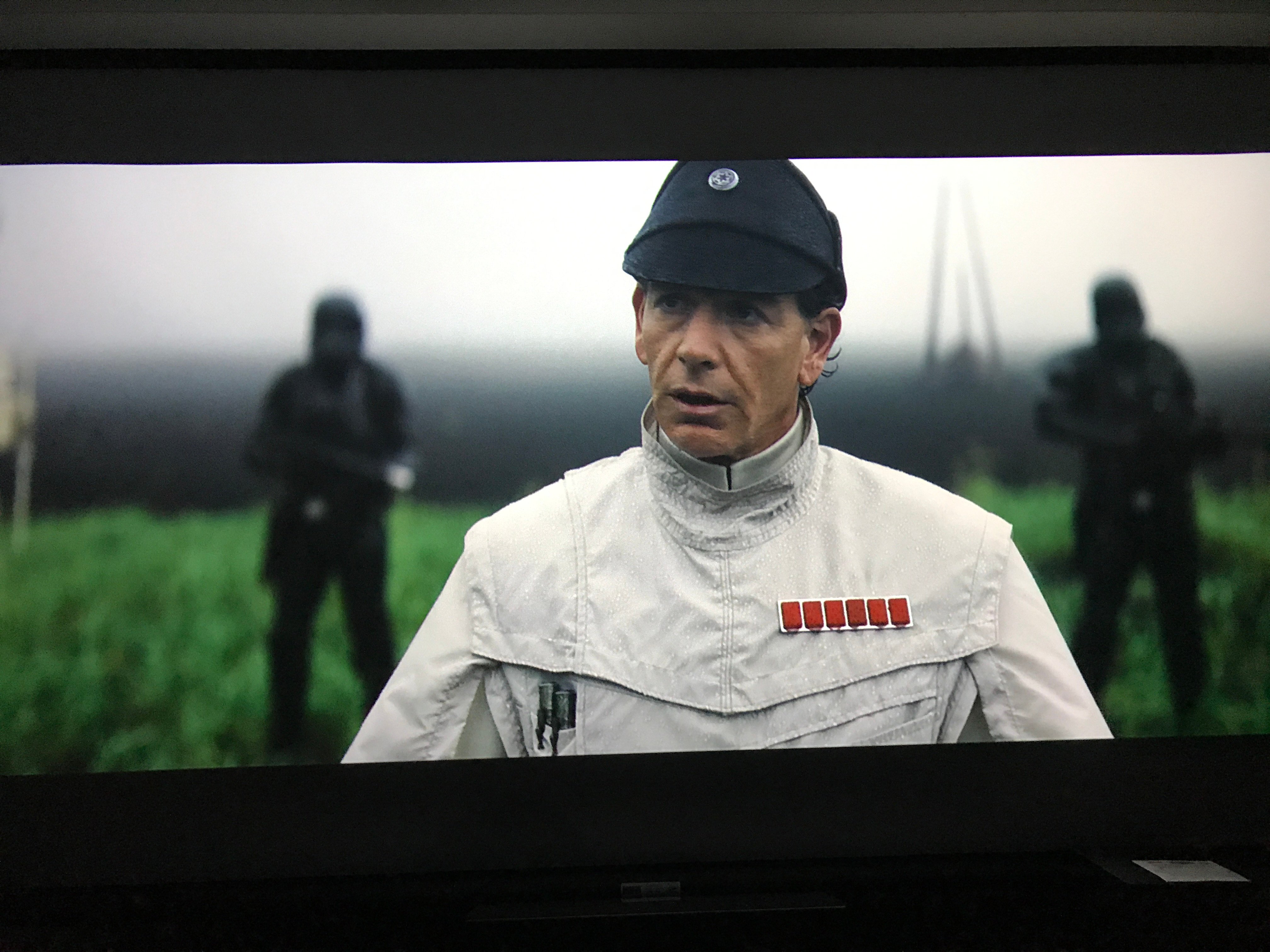

Star Wars Rogue One- Krennic

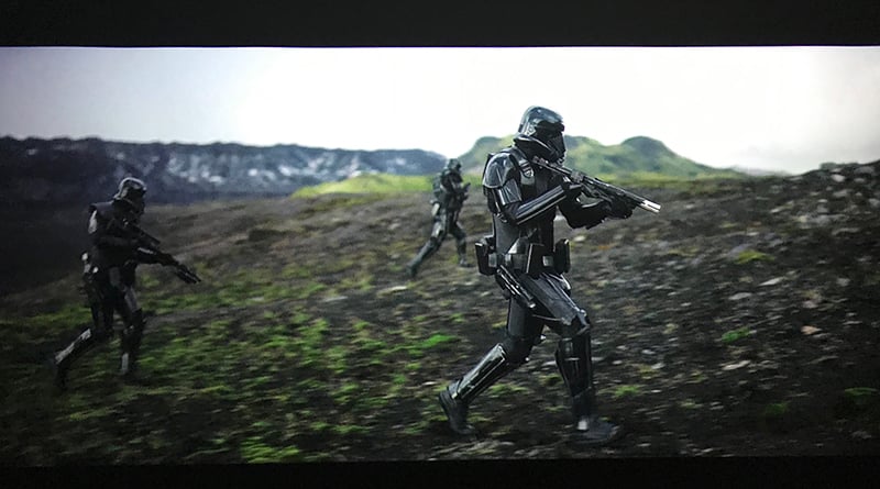

The JVC X570R rendered incredible detail on both Blu-ray and 4K/UltraHD Blu-ray sources.

JvC X570R Vertical Banding
On two occasions I experienced what JVC described as a synchronization error when I opened up the projector menu.  Each time it went away when I closed the menu and never experienced it during movie content.

JVC X570R black level and details
The JVC X570R's black levels were superb. With Rogue One on Blu-ray, the X570R displayed deep blacks and fine shades of grays.

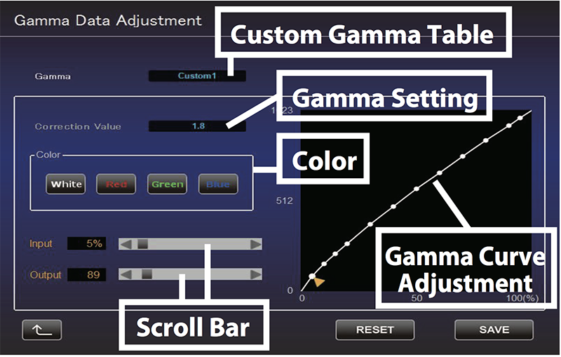

JVC X570R Gamma Adjustment
JVC's free Windows-based software gives you the ability to fine-tune the projector's gamma curve.
Performing the auto calibration with JVC’s software was very easy and relatively painless.

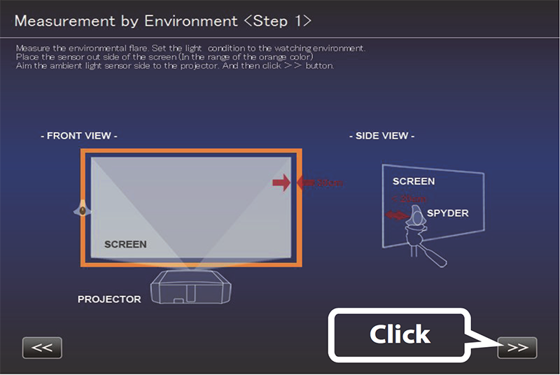

To use JVC’s calibration software, you must connect the X570R via Ethernet to your network.  There’s no other option. You then type in the IP address of the X570R in the JVC software to connect to the projector.  The software won’t auto-discover the projector on the network.
Once you connect the software with the projector, you choose which of the two meters you have. You’re then presented with all the projector’s profiles.  You chose which profile, gamma setting, and projector lamp setting you wish to calibrate.
In my setup, since I have both a 90-inch 1.1 gain white screen and 119-inch 0.8 gain grey screen, I performed two calibrations. For purposes of this review, I’ll be referring mostly to the calibrated 1.1 gain screen as reference.
Using JVC’s Projector Calibration Software
If you are using the Spyder meter, you point the meter directly at the projector, not the screen.  If you’re using the X-Rite i1 Pro2, then you take your measurements off the screen.
When you fire everything up, the JVC Calibration Software will take a light measurement and present you with an orange rectangle.  You need to place the meter at a distance from the projector where it lands within the orange rectangle. If the meter is too close to the projector, it will get oversaturated and yield incorrect readings. Everything updates in nearly real-time so you’ll know if you need to move the meter closer to the projector or closer to the screen. The best practice is to put the Spyder about one foot in front of the screen.

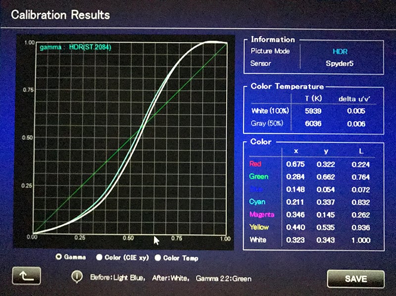

JVC X570R PQ Curve results
The JVC's Projector Calibration Software did a decent job of getting me a decent PQ (Perceptual Quantizer) Curve post-calibration for HDR.
I checked my results with R. Masciola's HDR 10 patterns and noted that post calibration, the X570R was graded to show content up to 1,000 nits peak brightness.

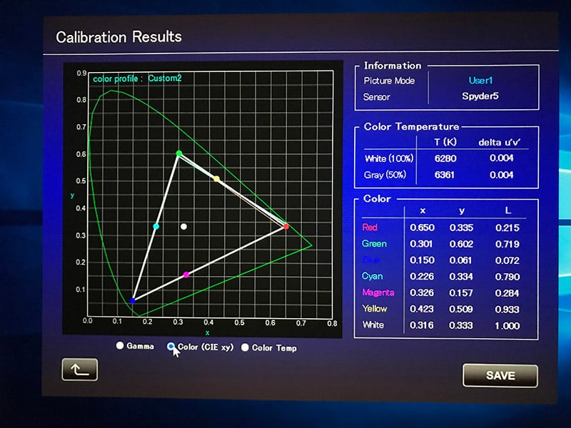

JVC X570R Rec. 709 calibration
The JVC did a decent job of giving me a good Rec. 709 calibration for HD content.
What I liked most about the JVC software is that it measures and sets your gamma and PQ curve. Measurements were generally excellent but weren’t always spot-on. I sometimes had to perform a calibration twice to eliminate obvious anomalies post-calibration.  The good news is performing a second calibration typically fixed any issues.

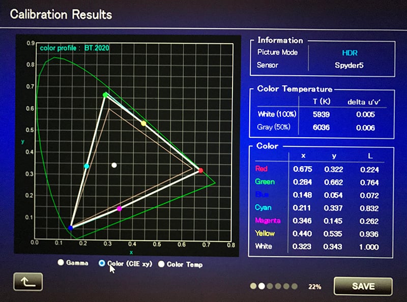

JVC X570R color gamut calibration
The results of one of the calibrations of the BT2020 profile using a Spyder5 with JVC's Projector Calibration Software.
In the BT.2020 profile, JVC told me that the X570R will cover slightly beyond the Rec. 709 color gamut but doesn't cover either the full DCI-P3 or BT.2020 color gamuts.

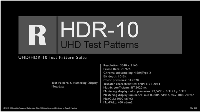

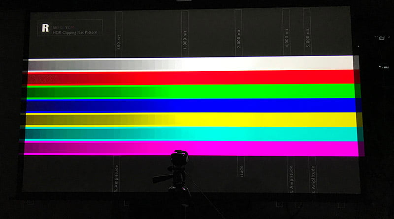

For HDR calibration, I used Ryan Masciola’s HDR10 patterns. Ryan’s patterns have a CalMan 5 HDR workflow included. I loaded the HDR patterns on a USB stick and displayed them via the Oppo UDP-203’s USB media port.
R. Masciola's HDR 10 Calibration Patterns
I used R. Masciola's HDR 10 patterns with Calman to check my HDR calibration settings.
The X570R’s brightness was very good. I measured just over 29fL in low mode and over 35fL in high. With HDR calibrations, I measured over 37fL. JVC told me that these readings were right in line with what I should expect with my setup.
So that I don’t prolong this aspect of the review, I’ll note that Calman 5 does not support HDR projectors. In fact, when you take readings, all readings will be below target—even though the picture looked very good post calibration. This initially drove me crazy until SpectraCal referred me to this thread. This correlates exactly with my measurements. In summary, you need to adjust CalMan by a factor of four to get the right HDR readings. Just to be sure, I sent my calibration results to JVC, who confirmed this to be the case and they recommend a factor of four when they do their training with partners who use CalMan. Needless to say, this made me feel far more at ease. From that point on, it was time to see what this projector could do.
R. Masciola's HDR Clipping
R. Masciola's HDR 10 UHD test patterns had just about everything I needed to see the results of a calibration.

Rec.709 and HD sources
Star Wars Rogue OneBlu-ray, HDTV, and 1080p streaming sources were nothing short of spectacular on the X570R. I fired up Star Wars: Rogue One on Blu-ray.  In the opening scene, Commander Orson Krennic, lands on the desolate planet, Lah’mu, looking for Galen Erso, a brilliant scientist who had been responsible for the development of the Death Star. When Krennic’s Delta-class T-3c shuttle passes over the planet, the earthy-color pallet of the barren ground and hills basks in blacks, dark greys, and subtle dark shadows.
The JVC’s ability to render these darks was superb. When Krennic lands his shuttle and walks across the landscape with an accompaniment of Death Troopers, Krennic’s light grey attire beautifully pops on-screen. The Death Troopers’ all-black armor maintained its menacing feel without becoming washed out or lost against the black earth of Lah’mu.  Close-up scenes of Krennic showed nearly infinite detail. I could easily see detailed water droplets shimmering on his commander’s uniform.

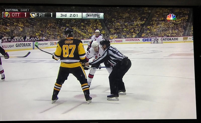

I was fortunate enough to have the JVC X570R during the NHL’s playoffs through the Stanley Cup finals (alas, my Boston Bruins didn't get past the first round this year). I watched the playoffs on the NBC Sports app on the AppleTV and via an over-the-air HDTV antenna.
The X570R had no problem rendering the details of ice surfaces while also pumping out the deep black accents of the Pittsburgh Penguins’ uniforms. The JVC’s excellent motion processing also eliminated the overwhelming amount of motion blur during fast moving plays, making any hockey action easy to enjoy.
2017 Hockey Playoffs on JVC X570R
Watching the NHL playoffs, NBA playoffs, or any sport for that matter was thoroughly enjoyable on the X570R.
Blacks were deep, colors were vibrant and tough shots, like hockey rink ice, were always spot-on.

Let me offer some concrete examples. First, I fired up the UltraHD Blu-ray of X-Men Apocalypse. In the opening chapter, Apocalypse’s outdoor procession in Egypt basks in sunlight. Dark scenes were wrapped in deeper shadows and bright scenes or highlights captured your attention. Elements like Psylocke’s telekinetic katana (her glowing purple blade of psychic energy) also took on a vibrant glow on-screen. Did the JVC enhance my movie experience? You bet.
