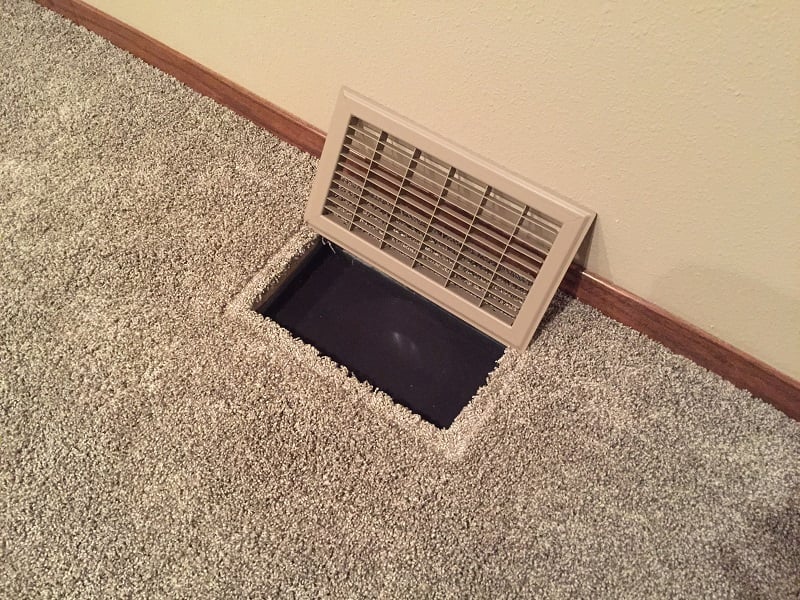

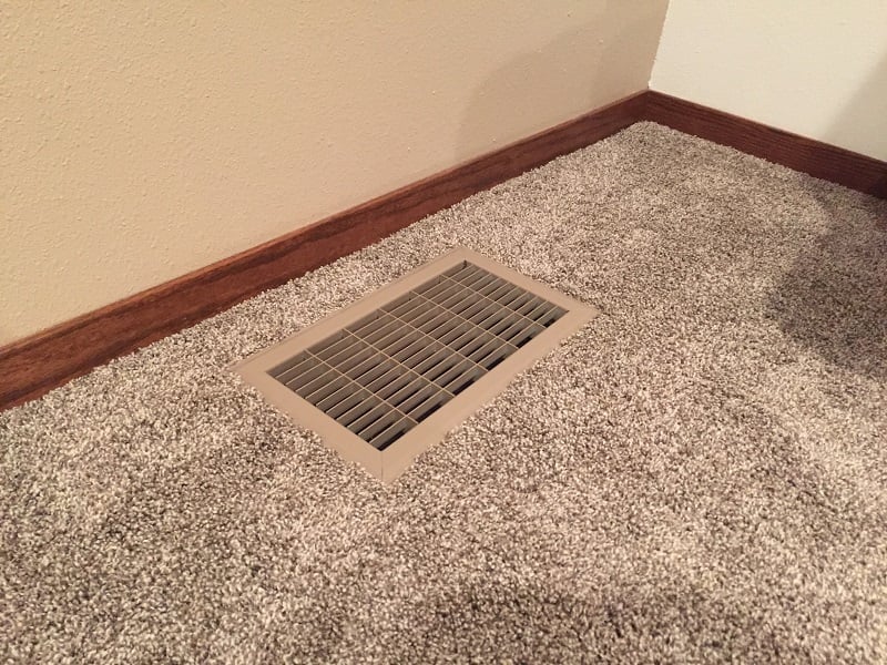

Two key characteristics set apart the SI-1010 from a typical subwoofer. First, and most obvious, it’s hidden in either the floor or ceiling of a home. It lays flat against either the ceiling/floor, between the joists/trusses, and is screwed into the joists/trusses. The sound then passes through a 6” x 12” cut-out in the floor/ceiling. The SI-1010 comes with either a white cold air return vent cover for in-ceiling installations or a tan heating vent cover or in-floor installations. When finished, your guests would have no idea that what looks like a standard heating or air vent is actually part of a high powered subwoofer system. Alternatively, you can use any vent cover that matches your decor, as long as it doesn't restrict airflow.
The second key difference between a typical sub and the SI-1010 is that the SI-1010 is passive, meaning that it does not have a built-in amplifier. Instead, RBH uses their separate SA-500DSP subwoofer amplifier. Speaker wire is used to the connect the SA-500DSP to the SI-1010. The sub and amplifier can be purchased together (RBH refers to the combo as the SI-1010P) or separately. While this setup differs from typical subwoofers, passive designs are the standard for in-floor/ceiling and in-wall subwoofers.
SI-1010 installed in the floor

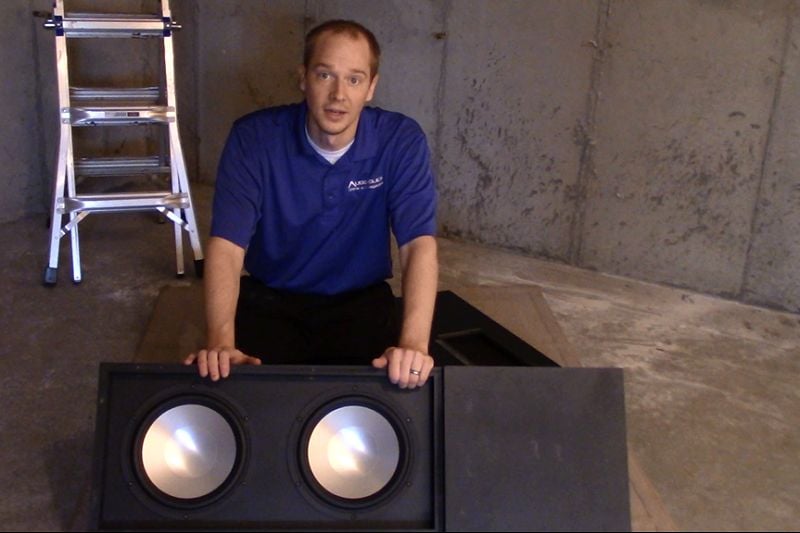

SI-1010 with the baffle removed
SI-1010 with vertical baffle installed

Other than being hidden away and utilizing an external amp, the SI-1010 is much like any other subwoofer. It’s a sealed design with dual 10” aluminum cone drivers. RBH rates the SI-1010 with a 28Hz-200Hz (±3dB) frequency response. When compared to larger, ported subs, 28Hz isn’t deep for a system with an MSRP of over $2k. However, considering the size limitations placed on the design (it needs to fit in a standard floor cavity), 28Hz is pretty low.
At 68lbs, the SI-1010 is no lightweight. Much of that weight comes from the MDF used to construct the 13-1/2" W x 42" H x 9" D cabinet. Although the sub is hidden, it’s not small, which makes installation a two-person job.

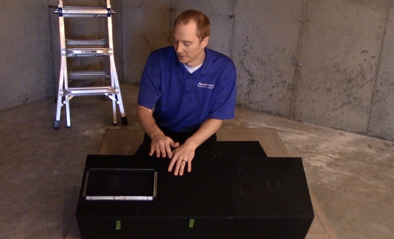

The SI-1010 is either hoisted up between floor joists or gently laid down on the ceiling, between ceiling trusses. Once it’s in position, it’s secured by driving screws through the joists/trusses and into the sides of the SI-1010. This is where each installation will vary. Depending on the construction of your home, you may have to use extra lumber to secure the sub in place. Really, unless you’re installing it in a floor with 2x10” joists spaced 16” on-center, you will have to use a little extra lumber and ingenuity to secure the sub. This isn’t an issue with the design, as comparable subs installs the same way. It’s just the nature of custom installation products.
The SI-1010 temporarily in place. For final installation another set of 2x4s was used to raise the unit until it fit snugly against the floor above.
Note that RBH sells both a vertical and horizontal baffle for the SI-1010. Changing the baffle rotates the vent 90 degrees. And don’t worry, if you order the sub with the wrong baffle you can purchase the correct one and swap them yourself. I speak from experience.

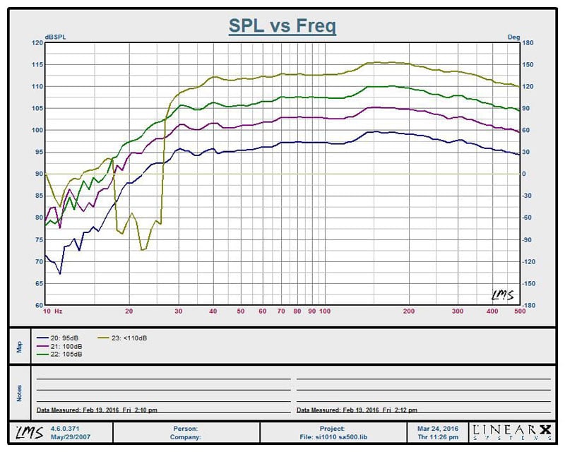

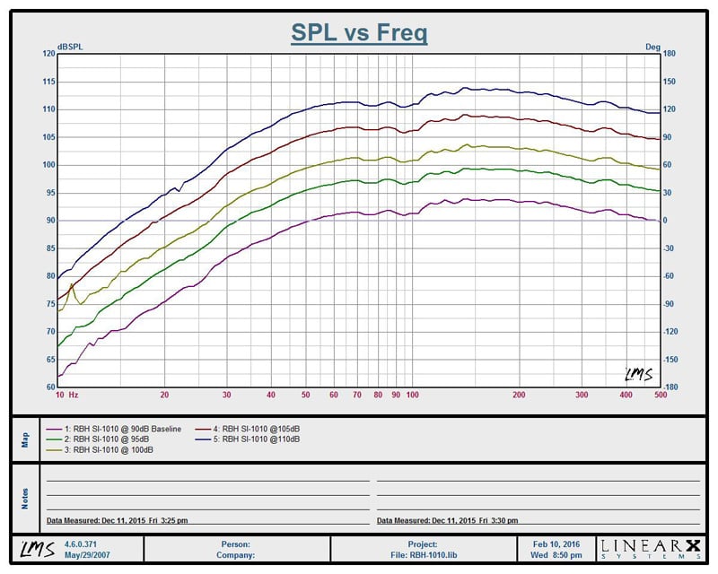

We positioned the SI-1010 sideways on the floor with the microphone 1 meter away equadistant from both drivers. The front panel cover was removed so we could test for the highest output possible. RBH informed us with the panel removed, the SI-1010p will play about 1.5-2dB louder than with it installed. If you don't need to hide the woofers for aesthetic reasons, then we'd recommend removing it.
RBH SI-1010 SPL vs Frequency Response @ 1 meter Groundplane
The SI-1010 sealed narrow enclosure somewhat prevents it from digging as deep and loud to comparably priced large box subwoofers. The measurements above did however demonstrate that this sub has quite a lot of output for something you can conveniently hide in a ceiling or a floor, something you can't do with a big bulky box subwoofer. The -3dB pt of the system was 40Hz with NO EQ applied but virtually ever sub on the market employs low frequency boost to yield better extension. As is, the SI-1010 played loud and clean with no hint of distress. It stopped getting any louder as a result of the limiter circuit build into the SA-500DSP. If I had a more powerful amp, I am confident this sub would have a good deal more output to reveal. The SI-1010 is flat all the way to almost 400Hz making it an ideal sub to blend with small satellite speakers that require a higher than 80Hz high pass filter.
RBH SI-1010P SPL vs Frequency @ 1 meter Groundplane with EQ
With EQ applied, I was able to lower the bass extension to a -3dB pt of around 25Hz which held up even at high SPL output. However, due to the long sweep tones, it tripped the self-resettable fuse in the subwoofer that protects the driver from excess current when sweeps exceeded 110dB. Although this is a bummer on the test bench, it's not something that ever happened in real world listening tests with real program material. It is actually a good design compromise to increase reliability. The one thing you don't want is to blow a driver once you have this box installed in your ceiling or floor. I checked with RBH and since this products inception over 10 years ago, they've had only a few unit requiring service in the field due to a blown driver and that was before the SA-500 amp was being used to power it.
If you want your SI-1010 to exhibit the frequency response measured above, than you'll need to set the EQ boosts in the SA-500DSP amp to the following settings:

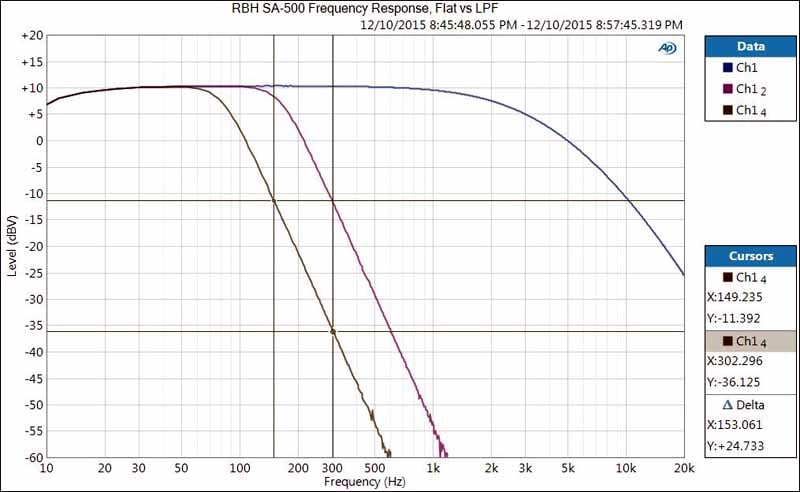

Frequency Response
RBH SA-500 Frequency Response

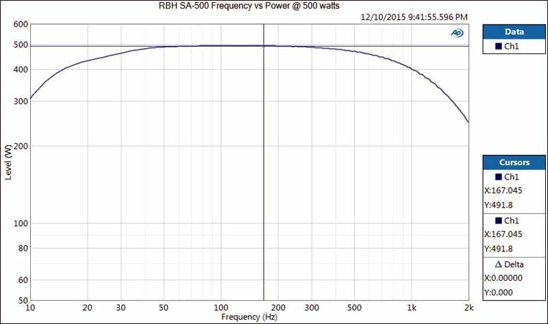

The SA-500DSP is clearly NOT a fullrange amplifier. In fact, I measured a -3dB of about 2kHz so this amp is for bass duties only. I checked the Low Pass filter response and found the unit measured a -3dB pt of the crossover you selected (ie. 80Hz) with the desired slope (in this case I had it set to 24dB/oct). I would have liked to see the crossover point selected actually be the -6dB pt with the slope set to 24dB/oct as it is with THX certified products when matching subwoofer and satellite systems with a HPF slope of 24dB/oct in the AVR bass management circuit but it shouldn't be too hard to dial in a proper response since both the frequency and slope are adjustable on the SA-500 amplifier ( 9 bands and slope from 12 to 36 dB/oct).

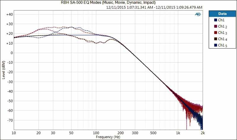

RBH SA-500 Pre-Programmed EQ Settings
Shown above is what the pre-programmed EQ settings does to frequency response of the amplifier and corresponding subwoofer attached (in this case the SI-1010). If one of these modes don't suite your needs, RBH does offer adjustability of +- 6dB for its fixed 9 band EQ of frequencies of 20, 25, 31, 40, 50, 63, 80, 100 and 125Hz. I tested these and they worked as expected but would have preferred adjustable frequency and Q for finer tuning.

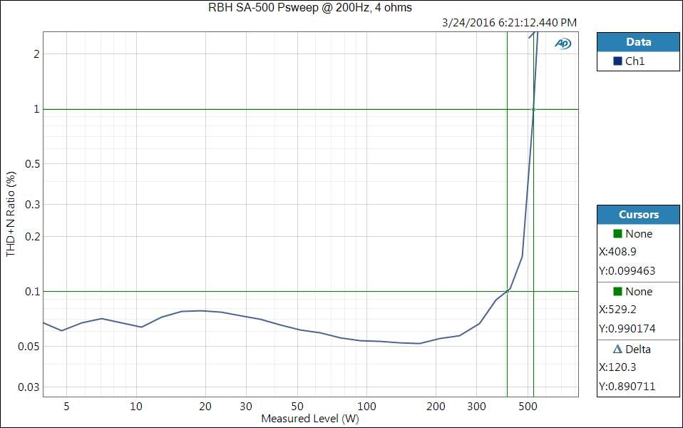

Power & Distortion Tests
I was able to hit the 500 watts continuous power rating into a 4 ohm load for the bandwidth of operation of concern.
RBH SA-500 Continuous Power vs Frequency

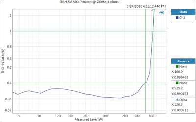

Sweeping the SA-500DSP at 200Hz for power vs distortion revealed the actual 500 watt rating was hit at a rather high distortion of 0.4% THD + N. This is acceptable at bass frequencies but far from state of the art as far as full range amplifiers are concerned. Using a CEA-2006 burst test, I was able to get 540 watts into 4 ohms at 1% THD +N for our dynamic power testing.

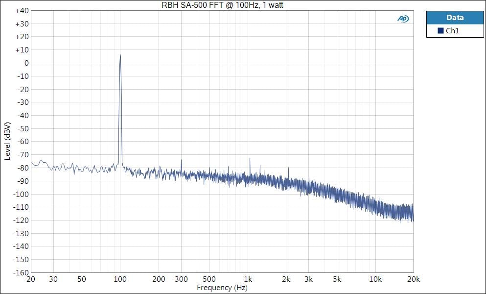

RBH SA-500 FFT Distortion Analysis
There is no kind way of saying that this measurement is mediocre. While the residuals at 1 watt are clean, the noisefloor of this amp just isn't all that stellar. It should be a good 20dB lower than this. However, I only found this to be slightly detectable as background noise if I stuck my head within a few feet of the connected subwoofer when it was turned on with no program material running through it in a quiet room. In this day and age there should be no reason for this so we hope RBH can improve upon this in future iterations of the amplifier. However, for long cable runs, we recommend using twister pair to minimize noise pickup since this amp seems a bit more sensitive to it than comparable linear AB amps we've previously tested.
