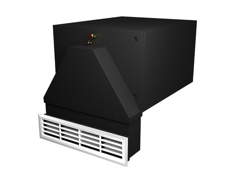

In-wall speakers are pretty common but in-wall subs are fairly rare. B&W is throwing their hat in the mix with the new ISW-3 Subwoofer - a speaker that can be placed in any wall of your house (including your ceiling and floor) and even has a right angle adapter for in-cabinet installation in a kitchen.
ISW-3 In-cabinet with Right Angle Adapter

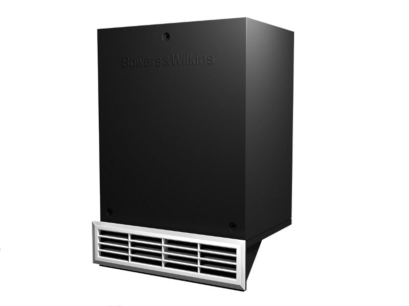

When you are looking for an in-wall sub, you need a few things. First, you want it to be as invisible as possible. The ISW-3 has a small (2" by 12"), slotted grille that looks like an HVAC vent - something consumers will barely notice. It is small enough that it can be placed into the base or toe-kick in a bathroom or kitchen.
The sub features dual 6.5" Paper/Kevlar cone long-throw drivers in a balanced design eliminating transmission of vibrations through the enclosure and into the surrounding walls. When you install a sub into your kitchen cabinets, this is important as you're likely to aggravate your client if every time a kick-drum hits their glassware rattles. The ISW-3 is only 13" wide by 9.25" deep and 18.5" tall making installation inside walls between trusses a breeze.
