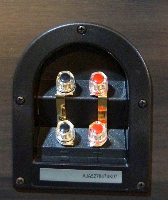

1.) Dual Binding Posts on Normal Speakers
One engineering practice that is very often nonsensical is the use of dual binding posts on normal home audio loudspeakers such as bookshelf speakers and non-large tower speakers. By non-large tower speakers, I mean a floor-standing speaker that doesn’t have a heavy-duty bass driver section that could actually benefit from a serious amplifier beyond the standard one or two-hundred watts or so that many of us have in our mass production AVRs. Are you wondering if you have such a speaker? There is a good test that will let you know for sure: if you have to ask, you don’t have one. Few people own home audio loudspeakers with that level of capability like these monsters from Status Acoustics.
That isn’t to say that your speaker won’t benefit from more wattage than what your name brand AVR can supply, because many normal floor-standing home audio speakers could probably take more power than what a typical AVR can give. Rather, bi-amping (and especially bi-wiring) isn’t the best way to go about that. For starters, many users would be tempted to use different amps to power the different sections of the speaker since they might have a spare 2-channel amp laying around with their AVR. The problem with that is that now there is a good chance that the bass section of the speaker is no longer level matched with the tweeter/midrange section. The only way to be sure that it would be is to use the same amplifier on the same gain settings for both sections of the speaker. What is more, many people would be tempted to use their AVR to power one of the sections of the speaker, and that potentially compounds the problem because there might be a processing delay on the pre-amplifier outputs that can cause an extra latency on the bass section of the speaker.
Some AVRs have settings that will enable them to be used to bi-amp the main speakers, but the problem with that is it usually doesn’t grant you any more headroom since the power supply is shared by the amplifier circuits for both sections of the loudspeaker. The best approach is to just avoid bi-amping the speakers and use an amplifier with enough power for the dynamic range that you want.
So why do loudspeaker manufacturers put dual-binding posts in
speakers that do not realistically benefit from it? The answer is that it makes
the speaker seem fancier and it’s cheap to do. My wish is that they would drop
this pretense and just use a single set of quality binding posts for any home audio
speakers except for the truly massive ones. Dual binding posts are more often a
means of screwing up the set up of a speaker system rather than an opportunity
for an improvement in the sound.

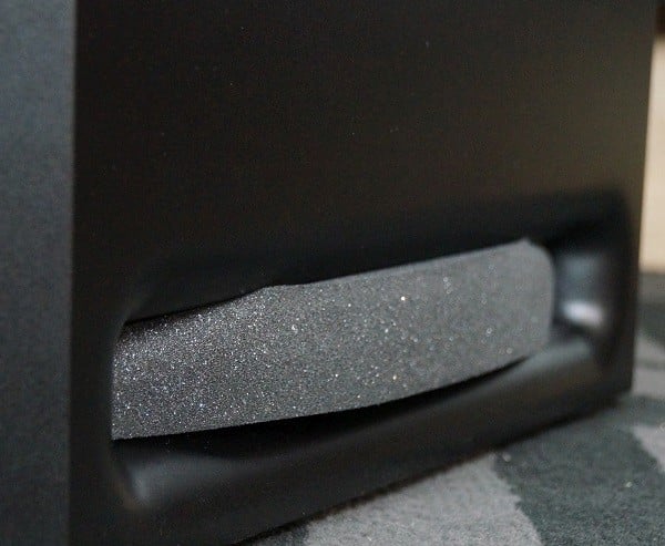

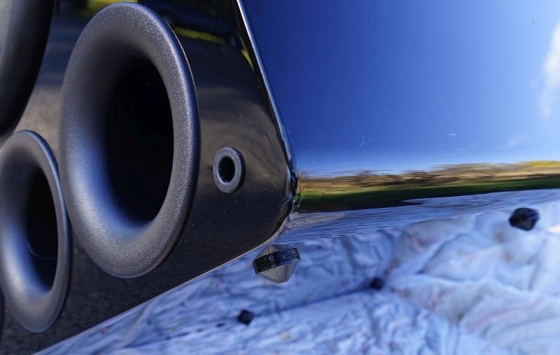

2.) Small Feet on Big Subwoofers
I review subwoofers as well as regular loudspeakers, and I have had to deal with a slew of humongous subs that had feet that were too small for the size and weight of the unit. Regular readers will know the manufacturers that I am talking about because I do mention this problem in those reviews, but I am going to name the worst offenders here anyway: SVS and Monoprice Monolith! The shame of this is that these manufacturers make outstanding products otherwise as we have seen, in review after review.
The main problem is the feet that they use on their large and heavy subs do not offer as much clearance for fingers as they should for lifting and lowering the subs on and off the floor. Both manufacturers in this instance use some small plastic conical feet that only give about a ¾” clearance from the floor. While that might seem like just barely enough height for fingers to get under, the problem is that these subs sink into a carpeted flooring and can compress the carpet fiber so that there is very little space between the sub’s cabinet and compressed carpeting. That creates a potential pinch point for those who are setting the subs down on carpeted surfaces.
Among SVS’s subs, this becomes a real problem in the 4000 series (except for the PC-4000) and 16-Ultra series subwoofers, since the weight of all of those exceeds 100 lbs. Indeed, the weight of the PB-4000 is 153 lbs. and the weight of the PB-16-Ultra is 174 lbs. It is not so bad with the 1000 Pro series and 2000 Pro series since they are relatively lightweight. Monoprice’s Monolith series, on the other hand, are all very massive subs; the 16” THX Ultra is 171 lbs. And the M-215 THX Ultra is a staggering 216 lbs. I could easily see any of these subs crushing someone’s fingers sitting on a dense carpeted surface in a lowering-it-into-place accident.
Why do these manufacturers use such small, wimpy feet
on such giant subwoofers? The answer is that the subs look nicer when the feet
are not exposed. These feet are not really visible, especially on carpeted
flooring. What is more is that these have to be some of the cheapest feet to
buy in bulk quantities out there, so it is a win-win for these manufacturers.
However, in my opinion, these feet are a hazard for consumers. My
recommendation is that these manufacturers use feet that offer at least a 1”
clearance, but 1 ¼” would be better. That should give people adequate clearance
to safely lift and lower these subs on carpeted surfaces.

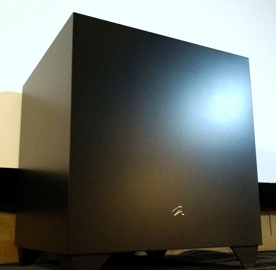

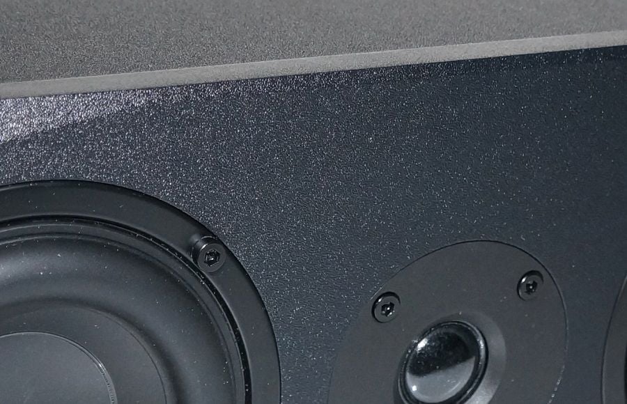

3.) Matte/”Satin” Finish Confusion
Something that should stop (but is unlikely to) is when manufacturers claim a “satin” finish on products that really couldn’t even claim a matte finish. If you are purchasing a loudspeaker or subwoofer that claims a satin finish, beware. In my experience, it is more likely to be a textured vinyl finish unless you are paying for a premium item. These finishes have well-defined meanings that have been blurred by marketing departments trying to make the product appear nicer in brochures than they are in actuality. Proper “satin” finishes are silky and very smooth and do have a reflective sheen although a lot more diffuse than a gloss finish. A true satin finish is smooth to the touch and has no texturing. A proper “matte” finish should still be smooth but has very little light reflectivity or sheen. Matte absorbs light. It would not properly have a rough texture though.
Textured vinyl finish- this is not satin!
In many instances, I have seen speakers that have a satin or matte finish listed in the specs but in reality, the speaker has a textured vinyl finish. That stretches the definition past the breaking point. These speakers should just list “textured vinyl” in the specs as the finish. It is not as glamorous, but it isn’t really all that bad either. The nice thing about these textured vinyl speakers is that they are a much more durable finish than a smooth satin or matte finish, and fingerprints don’t easily show up on them. It would be a bummer for someone who is looking for an upscale appearance for the product to order something promising a satin finish and end up with textured vinyl, and it is due entirely to deceptive marketing. I would guess many people are savvy enough to not expect a true satin finish on a set of speakers that cost $200 even if it is listed in the specs, but a lie is a lie, and it should come to an end.
A real satin black finish

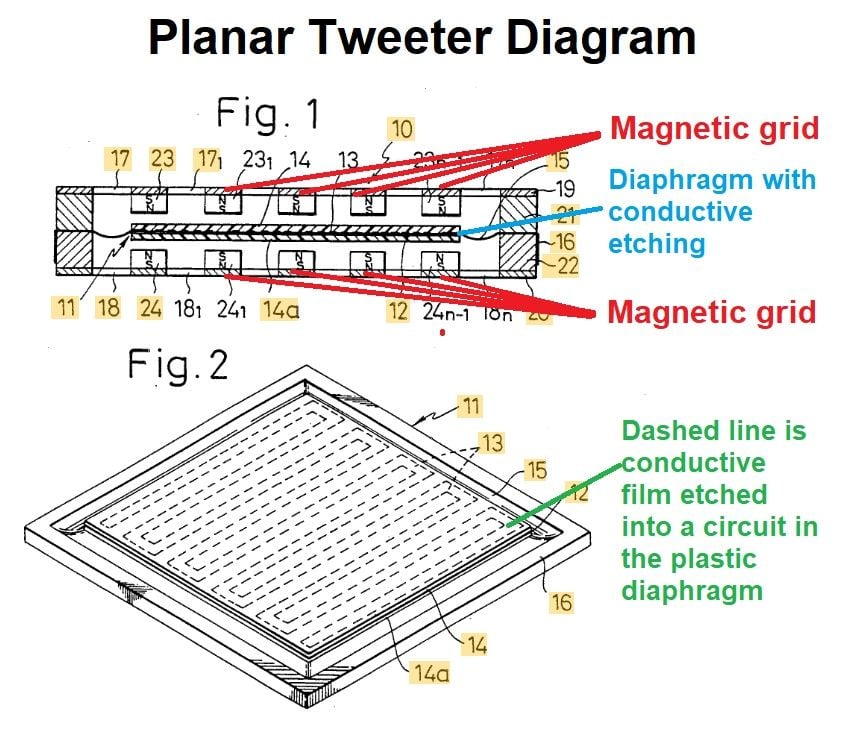

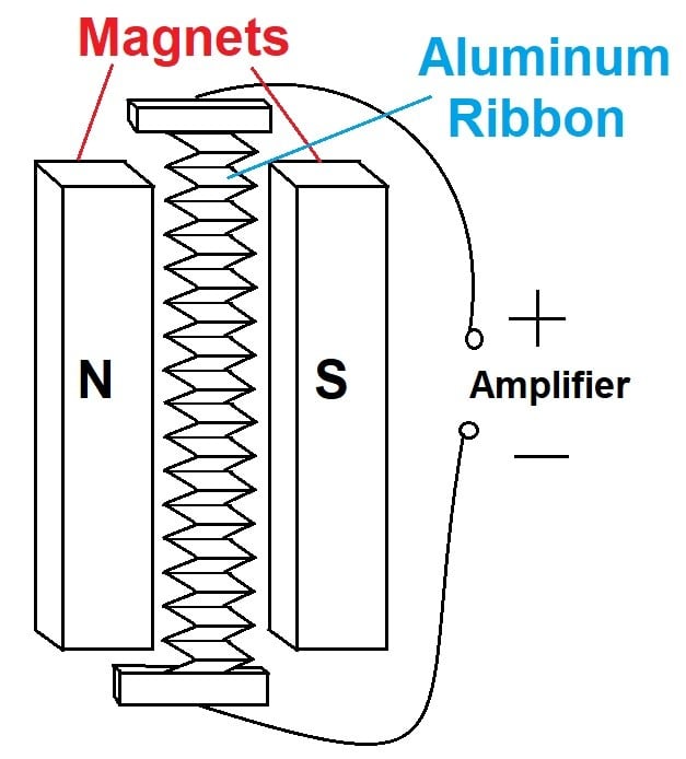

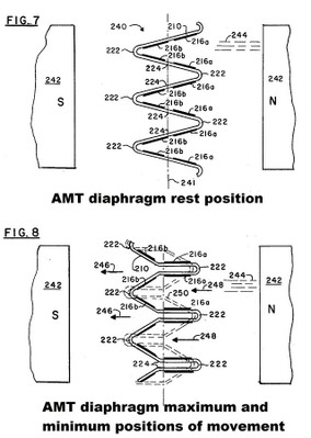

4.) Not All Non-dome Tweeters are “Ribbon” Tweeters
If we were to trust loudspeaker marketing departments, it would seem that we are living in an era of a ‘ribbon’ tweeter renaissance. Where once there were only dome tweeters for home audio speakers (with a few exceptions), now we are flooded with an assortment of affordable speakers using “ribbon” tweeters that claim a higher fidelity. Except they aren’t. True ribbon tweeters are still relatively scarce and remain primarily on fairly pricey speakers. They certainly can’t be found on any models priced less than $1k/pair. So what then are all of these so-called “ribbon” tweeters on lower-cost loudspeakers?
Many tweeters being sold as “ribbon” tweeters are really either AMT tweeters or planar tweeters, and all of these tweeter types have very different methods of transduction. First, we have to define what a proper ribbon tweeter is, which isn’t difficult, since mechanically speaking, it is one of the simplest tweeter designs. Ribbon tweeters work by suspending a very thin strip of aluminum between some powerful magnets. Alternating current is sent through the aluminum strip, and the accompanying magnetic charge of the electrically-charged strip whips it back and forth in the permanent magnet’s field. The aluminum strip is so light that it can easily oscillate to very high frequencies well above that of human hearing.
Planar tweeters work by printing a conductive film trace on a flat plastic diaphragm that is usually rectangular in shape and then inserting that diaphragm between grids of magnets. The conductive film trace is electrically charged with alternating current, and the corresponding magnetic charge of the electric charge is enough for the conductive film to move the entire diaphragm back and forth very rapidly. A key difference between planar tweeters and ribbon tweeters is that the charged element of the moving assembly in the planar tweeter composes only a small fraction of the moving assembly, whereas in a ribbon tweeter, the charged part of the moving assembly is the entire moving assembly. Since the entirety of the moving assembly of a ribbon tweeter is conductive, it doesn’t have much electrical resistance, so in order for it to work with normal amplifiers, the resistance must be raised by a transformer. So one way to identify a real ribbon tweeter is that it will always come with a transformer.
Air Motion Transducer tweeters, or AMT tweeters, work by creating a pleated polymer diaphragm that is vertically lined with conductive aluminum struts. This pleated or ‘folded’ diaphragm is set in a magnetic field, and when the aluminum struts are charged with alternating current, the folds expand and contract depending on the polarity of the current. The contraction of the folds shoots air out, and the expansion sucks air back in. A major advantage in this design is that since it is the folds of the diaphragm are much deeper than they are wide, the air is ejected out much faster speed than the vibration of the diaphragm itself- as much as five times faster. Much like a planar tweeter, AMTs do not need a transformer to step up the resistance of the circuit. They are pretty easy to discern the difference between true ribbons in that AMTs will have a wider pleated diaphragm surface instead of a thin metal strip; if it has folds, it’s an AMT.
These tweeter types don’t have all that much in common. However,
many loudspeaker manufacturers have decided to promote planar and AMT designs
to the status of ribbon tweeters since ribbons are typically much more
expensive and usually seen on higher-end loudspeakers. They are banking on the
public’s ignorance of the differences of these designs versus that of the much
more visually obvious difference between them and dome tweeters. The problem is
that words have actual meaning, and it is dishonest to blur the difference.
What is worse is that each has its own strengths, and
planar and AMTs can have
advantages over ribbon tweeters. So, there is no shame in using planar or AMTs
over ribbons, so long as the end design has good performance. While we are
discussing this subject, domes, rings, and compressions drivers all have their
strengths as well, so these flat plane diaphragms aren’t necessarily better
than round ones; it’s all a matter of achieving a good performance target.
My recommendation to manufacturers is to just call AMT and planar tweeters what they are, and promote them for their respective strengths, which are considerable.

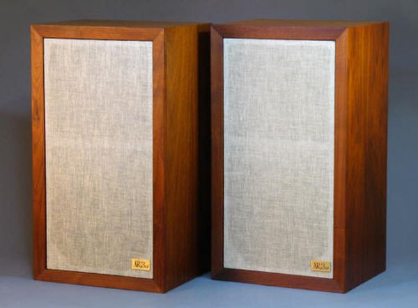

5.) Not All Sealed Loudspeakers are “Acoustic Suspension” (Almost None of Them Are)
There are many instances where loudspeaker manufacturers will label their sealed design as “acoustic suspension” or even brag about their high-fidelity “acoustic suspension” enclosure for more “accurate” or “tighter” bass. However, those designs are almost never true acoustic suspension designs, and they are almost always simple sealed loudspeakers. Our frequent contributor Steve Feinstein wrote a great article going into detail about the design and history of true acoustic suspension here: “Sealed is Not Acoustic Suspension in Loudspeakers,” so I won’t go into much detail here, since it is well worth reading his article. I will only briefly go over the definitions, so readers understand the difference- and why true acoustic suspension speakers are basically non-existent on the market today.
Acoustic Research AR-3a (1969)
Acoustic suspension has a lot to do with how the moving assembly within the driver is controlled so that it has a healthy level of excursion without needing a lot of power to move it. Acoustic suspension is defined as a speaker where the restoring force for the bass driver relies on the air pressure in the enclosure. In a typical driver in a typical speaker, the restoring force lies in the motor and suspension components. In an acoustic suspension system, air pressure forms a significant part of the restoring force and more specifically the back spring pressure from the interior of the speaker. That kind of system doesn’t need suspension with as much tension, so it can be driven quite easily. There is a whole other host of advantages that Steve goes over in his article. This design requires a delicate balance of enclosure volume and driver specifications that just isn’t how modern loudspeakers are engineered anymore, for better or worse. It’s a very different system than an ordinary sealed loudspeaker.
Editorial Note by Steve Feinstein:
Air is linear in its compression/expansion, much more so than a driver’s mechanical suspension. Acoustic Suspension proponents claim that this linearity can give AS systems lower distortion than other types, especially in lower-cost, small systems. A $100 ported bookshelf speaker with a garden-variety 6 ½” woofer likely won’t have the greatest mechanical linearity, but a properly designed AS system of the same size/cost will have cleaner bass/lower THD because of the air spring’s inherent linearity/regularity.
So why do loudspeaker companies still call their ordinary sealed
design “acoustic suspension?” I would guess that the reason is pretty much
simple ignorance layered with marketing gloss. Probably most people involved
with the marketing and promotion of loudspeakers do not know what an actual
acoustic suspension speaker is (not that being informed ever stopped marketing
departments from twisting the truth). Many of these people would be too young
to know about the original designs. And the misleading practice of calling
simple sealed systems “acoustic suspension” has just carried over from decades
past from those marketers who might have known the difference.
The solution to this is clear: just stop giving the label of acoustic suspension to sealed loudspeakers. It’s not like the phrase “acoustic suspension” has so much added dazzle since few people even know what it is anymore.

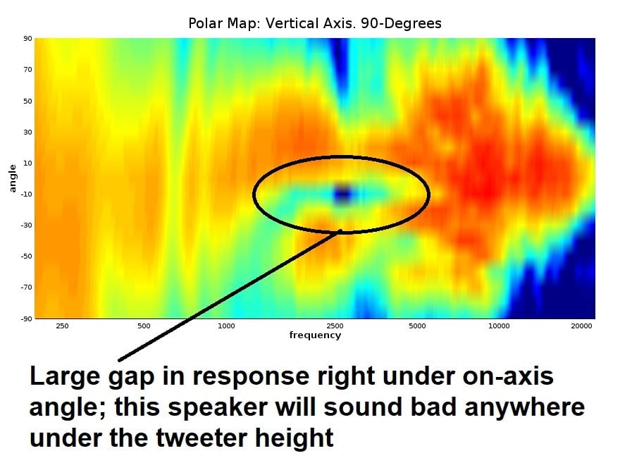

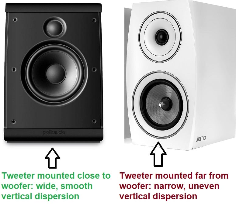

6.) Mounting Tweeters Away from Midrange/Mid-bass Drivers
One thing I would like to see change is having fewer speakers where the tweeter is mounted a significant distance from the adjacent driver in frequency bandwidth, whether that be a midrange driver or mid-bass driver. There are exceptions where this is an OK practice, such as when the tweeter can accommodate a low crossover frequency, but there are significant acoustic penalties for setting the tweeter distant from the next lowest range driver. The reason for this does take a bit of explanation, but when the tweeter is closer to the midrange/mid-bass driver, it can be a significant benefit to the speaker.
The reason why mounting the tweeter away from the midrange/mid-bass driver is a bad thing is that the areas in which the signals from those drivers integrate become much more narrow. The problem is that the sound wavelengths in normal crossover frequency ranges to the tweeter are very small, and if they are being emitted by two different sources that are spaced apart, they will conflict with each other everywhere where the distance between them is not the same. The further that the tweeter is from the midrange/mid-bass driver, the greater the potentially conflicting bandwidth a loudspeaker can have. Of course, this problem is contingent on the crossover frequency to the tweeter, and if a tweeter can have a low crossover frequency, that can do a lot to mitigate this problem. However, normal tweeters mounted flush on the speaker’s front baffle can’t usually handle a low crossover frequency. Most of them are crossed over between 2.5kHz to 3kHz. The wavelength of 2.5kHz is 5.4 inches. The distance of interest to us is the center of the drivers that have adjacent bandwidths, and this is called center-to-center spacing. We do not want the center-to-center spacing of the tweeter to the midrange/mid-bass to exceed one wavelength of any of the frequencies near the crossover frequency, and ideally, it should be a lot closer than that.
The result of widely spaced drivers is that the off-axis areas where the sound waves will conflict end up becoming deep nulls where output is totally canceled. These are called crossover nulls. This happens with any spacing between the drivers, but the further the drivers are mounted from each other, the worse it gets. When the drivers are close together, these crossover nulls occur further off-axis and can be less severe, but with a far spacing, the nulls can hang right around the on-axis angle, and that means that if you aren’t listening dead on the tweeter axis at a far enough distance, a big chunk of the sound will be gone because the sound from the tweeter is out of phase from the sound of the woofer. What is worse is that the frequency band where this usually occurs is an important part of the speech band, so this occurrence can negatively impact dialogue intelligibility.
This is why I always find it to be a matter of careless speaker
design when I see the tweeter set a good distance from the midrange driver.
What is also strange is that a lot of pricey “hi-fi” tweeters have large faceplates which necessitate a distant spacing. All that
does is make the loudspeaker very picky about placement. If you are listening
slightly above or below the tweeter height in such a speaker, you will be met
with a big hole in the response and a noticeably incomplete sound. What is
more, the vertical acoustic reflections are audible and can impact the sound,
so a poor off-axis vertical response may adversely color the sound as well. If
you are a loudspeaker manufacturer and have a tweeter mounted in a flat baffle,
get it as close to the midrange as possible. It needlessly makes the speaker
worse to put distance between them when it was possible not to.

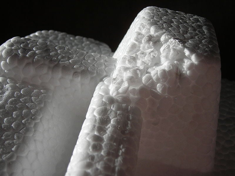

Once in a while, I receive a speaker that uses styrofoam for packing material. Usually, the styrofoam is broken if not completely shattered. On a couple of occasions, it failed to protect the product just through a single, one-way trip, and the product was damaged. It simply is not a good enough packing material for anything with significant weight. There is one famous loudspeaker manufacturer that is notorious for their poor packing practices that I won’t name (hint: starts with a K and rhymes with “lipsch”). The only speakers that styrofoam packing is adequate for are very light ones of less than 10 lbs., and even then a good amount of styrofoam is required to protect the items.
I get why some companies opt for styrofoam packing; it is much
cheaper than polyethylene foam. A lot of people probably don’t realize the cost
of safely shipping items like
loudspeakers. It is a lot and constitutes a significant chunk of the price.
Maybe some accountant crunched some numbers and found that the cost of
shipping-related damages did not outweigh the savings on using styrofoam
packing, but that calculation ignores the feeling of disappointment of the
end-user who was looking forward to the speakers. Furthermore, presentation
matters, and it inspires more confidence in the buyers when they unbox their
loudspeakers and see good packing materials. It means that the manufacturers
consider their own products to be worth the extra expense and effort.
My recommendation: stop shipping anything over 10 lbs. using styrofoam packing!

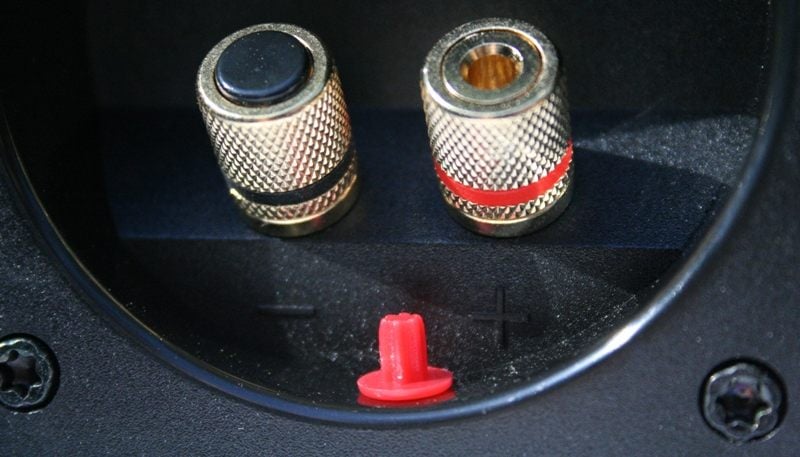

9.) Plastic Tabs in Binding Posts
Some loudspeakers manufacturers put plastic inserts inside of the
binding posts for some reason. They have to be removed before using banana plug
terminators. In some cases removing these tabs can be annoyingly difficult.
Harman is guilty of this, and I have seen this on Infinity and Revel speakers,
but I have also seen this done in some non-Harman brands. Why do they do this?
I can’t think of a single reason why this would have any benefit. Thankfully,
it doesn’t seem to be very common. Nonetheless, it should be nonexistent.
Loudspeaker manufacturers: stop wasting pennies on tabs for binding post
inserts! You tell them, Gene!
The reason for plastic tabs in binding posts is for CE (European) safety reasons. The ¾” binding post spacing is exactly the same as the spacing for the round spades on European AC cords. Plus, binding post holes will accept those round EU AC spades. Some brilliant bureaucrat somewhere thought that people were going to start plugging in toaster and TV AC plugs into speaker terminals. I don’t know for the life of me what they thought was going to happen, but that’s where those plugs originated—to prevent Euro AC plugs from being connected to speaker terminals. The reason for their inclusion in North American loudspeakers: in addition to the above, it’s so U.S. speaker companies don’t have to build and inventory “domestic” and “European” speaker inventory. They build one variant and ship it wherever.
10.) Sealed Configurations on Large Ported Subwoofers
Many manufacturers of high-performance ported subwoofers have decided to include the option for running the subwoofers in a sealed operating mode by including port plugs as an accessory. The question I have is why? Why would anyone buy a giant ported subwoofer but then decide not to take advantage of the very thing that makes that huge size a necessity (their super-deep bass extension)? The reason why those ported subs must be so large is so that the enclosure volume can support the very low port tuning frequencies. In other words, a big box makes deeper boom boom. Sealing the ports completely negates the ability of the ported sub to produce big SPLs in low frequencies, and so it negates the reason for the enclosure size to start with.
The only reason why sealing ports of a ported subwoofer could be useful is in a small room that gets so much acoustic low-frequency gain (this is called ‘pressure vessel gain’) that it massively blows up the low-end of the in-room frequency response and produces a boomy or bloated bass sound. However, a better method of tempering the deep bass is to simply EQ the response. That way you can get a nice in-room response without losing the headroom that is granted by the ports. Many of these subs come equipped with onboard ways of electronically reducing deep bass output, as opposed to the physical method of closing a port. And the likelihood of someone placing these huge subs in a small room is low- and if they do, they probably want that excess deep bass.
It seems to me that subwoofer manufacturers do this because the
foam inserts are cheap to include as an accessory and the manufacturers can
then claim more operating modes in the checklist of the subwoofer’s features.
But what is likely to occur is that those who don’t know any better may simply
leave the inserts in the port and run the sub like that unknowingly eliminating
most of the sub’s deep bass output capability. In other words, it is more
likely to be a source of confusion and thus suboptimal system setup. It just
shouldn’t be done, as there is very little benefit to this ‘feature.’ My
recommendation to subwoofer manufacturers: don’t bother with the inclusion of a
sealed operating mode in your ported subwoofers. The reality is that it doesn’t
do any good.
