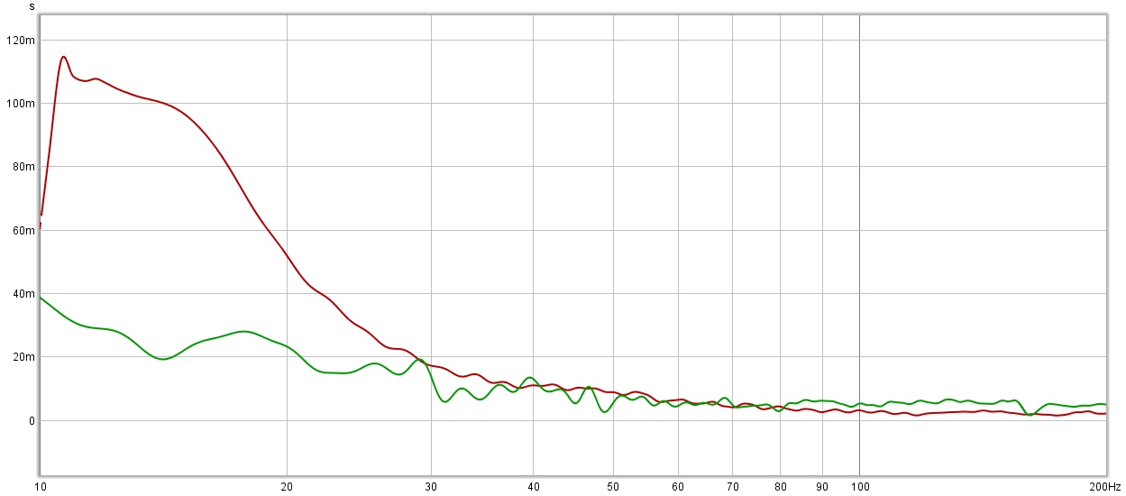

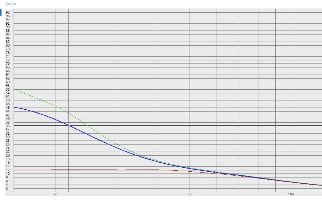

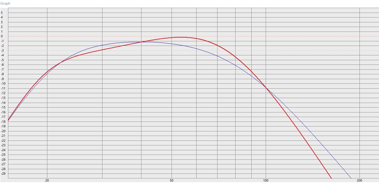

Dayton Group Delay Comparison  GD CompPrtSld
Diagram 1                                                                                                                            Diagram 2
In diagram 1, we see a simulation of a subwoofer driver in both a sealed and ported enclosure. The ported subwoofer does not use EQ to flatten the response but does include a high pass filter to protect the driver against over-excursion, and a low pass filter. The Sealed subwoofer has the same filters but also includes EQ to flatten the response. You can see that once you have done this the group delay of the two is very similar. However, simulations are not worth much if they don’t hold true in real life. In diagram 2 you can see the real-world measurements of the HSU VTF-15H Subwoofer in 1 port mode. This is a ported subwoofer setup in a way that would ensure the lowest group delay for a ported design. The sealed subwoofer is a JTR RS1, a brand new sealed subwoofer from JTR with state of the art drivers. This subwoofer has extremely flat and low group delay, and because of its extremely high excursion driver and dynamic limiters, it can avoid a high pass filter.
Note: The group delay of the RS1 and VTF15h are nearly identical down to 30hz. As you can see, in practice, there is no difference in group delay between ported and sealed subwoofers. The rise below 30hz is so low in frequency and our ears so insensitive, that it is highly unlikely to be audible.
Both subwoofers have just half a cycle or less of group delay down to 30hz, and the ported sub rises to just 1 cycle at 20hz, still below the 1.5 cycle sometimes cited as the limit of audibility.
