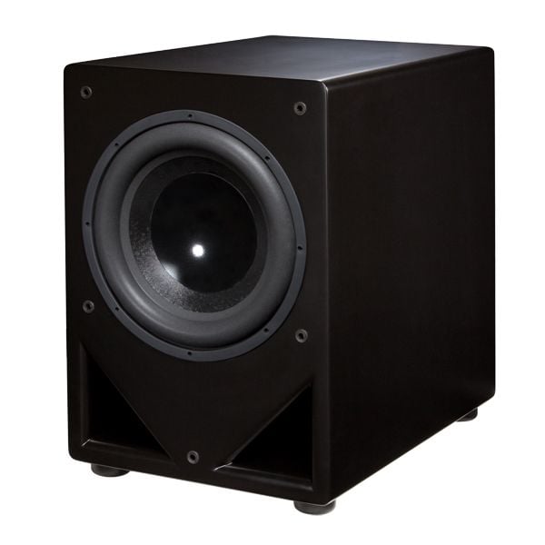

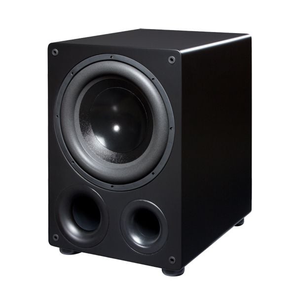

Unlike the outgoing models, the VTF-15H MK2 and VTF-3MK5 HP are very similar on paper. Both subwoofers feature a new 15” fiberglass reinforced driver built on a cast frame and boasting a much heftier motor structure than the old VTF-15 woofer. The new VTF-15H and VTF-3 both also feature the same amplifier, rated at 600W RMS continuous, and 2000W RMS short term, which is a bump up from the old 350W continuous / 1400W short term amplifiers in the outgoing models. Where the designs diverge is enclosure volume. The VTF-3 MK5 HP’s enclosure measures in at 24”H x 17.25”W x 21.5”D and sports a 4” diameter port plus an additional 3” diameter port. The VTF-15H MK2’s enclosure is both wider and deeper at 24”H x 18”W x 26”D, and boasts a pair of triangular ports stated to be comparable to dual 4.5” diameter round ports. As you’ll see below, this gives the VTF-15H MK2 an extra helping of low end power relative to the VTF-3 MK5 HP.
The VTF-15H MK2 (left) and VTF-3 MK5 HP (right).

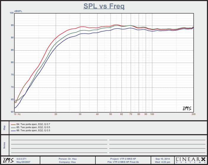

In terms of feature set, both new models have the basics for integrating the subwoofer with a system lacking bass management. A phase switch is on board along with a variable (and bypass-able) crossover knob with settings ranging from 30Hz to 90Hz; the crossover slope is stated to be 24dB/octave. The VTF-3 MK5 HP and VTF-15H MK2 are also notably variable tune subwoofers. By blocking one triangular port on the VTF-15H, tuning is dropped from the native 22Hz down to 16Hz. Meanwhile, blocking the 3” port on the VTF-3 MK5 HP drops the tuning point from 22Hz down to 18Hz. In order to further shape the sound, these subwoofers boast a “Q Control”, the effects of which you can see below.
Frequency response of the VTF-3 MK5 HP with both ports open. The three curves show how setting the Q control affects the response.
