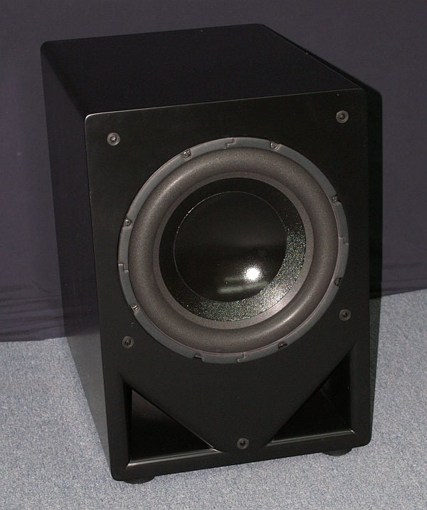

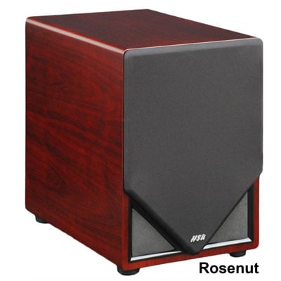

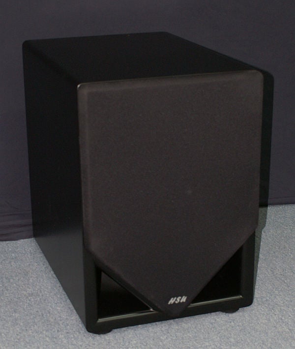

HSU VTF-15H Introduction
 The
Hsu VTF-15H is a self-powered front-loaded vented subwoofer featuring a
15" long throw driver and 350 watt amplifier with controls to allow
tweaking of the low pass crossover as well as the bottom end of the subwoofer
to optimally match it to your room and listening preferences. Weighing in at 123lbs
and costing $879 for the black finish, it was hands down, the “BEST BUY” of the
group of subs we compared.  It's no
lightweight, and requires a lot of depth if you orient the box with the normal
orientation of woofer/ports facing forward. (Almost 30 inches if you plan on
actually plugging some cables into the back-plate amplifier.) Considering the
small amp employed to power the Hsu, the output with music was truly
impressive.  I listened and tested the
sub as supplied, that is with both ports open.

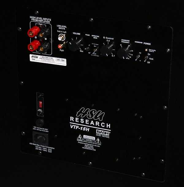

The Amplifier
Actually, I was quite surprised to find the
amp b eing used with the Hsu was a BASH design.
I will admit my bias against the company, yet I found it had the ability
to drive the Hsu sub to considerable volume levels in a very large room. My
experience in the past with BASH amps, has been less than encouraging, but I
have no negative
have no negative
comments to make about the finesse and skill which was used to adjust the maximum output of this amp so that there were no hard clipping or compression artifacts audible enough to make me complain. Anyone who knows me well will be quick to inform you that making me complain does not take a whole lot of effort or much in the way of an error.
My first complaint with the amp is that the potentiometer action felt rather soft or loose. Not the feel you would expect from a high end product control, but when you price subs at these points, you have to count the pennies as well as the dollars.
My biggest criticism of the amplifier was the fact that we are only given a very limited range of Low Pass frequencies to use. (30 – 90 Hz) Limiting the top end of the Low Pass to 90 Hz, means that this sub should not be used with very small satellites tops (those using a single 4 or 5.25” midbass driver) unless you have an outboard bass management system to allow you a more suitable crosssover point than 90 Hz. Since it would not have cost a dime to increase the frequency range of the Low Pass, and since the sub is clearly able to go up well above 90 Hz, I must assume the reasoning was that it is better to offer the user finesse and finer control within the range of 30 to 90 Hz (since most potentiometers are limited to a rotation of 300 degrees) rather than to offer the user the option of a higher crossover point.
While not the path I would have taken in the design of this product, I will bow to Poh Hsu's expertise on his own market, and assume of the majority of the buyers for this product will have full range systems having no problem with an 80 Hz crossover point or simply don't own small 4 or 5 inch full range tops that would benefit from that higher crossover point. It is also possible the majority of those purchasing this subwoofer will have an external bass management system, and so be prepared for almost any combination of components.
Like with all subs used in a home theater environment, we highly recommend utilizing the internal bass management and level control of your A/V processor and either bypassing the sub's internal filters or using them in conjunction (if needed) to ensure the best integration with your speaker system.

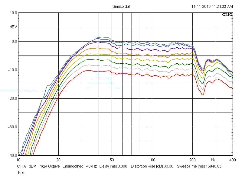

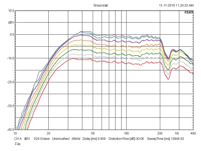

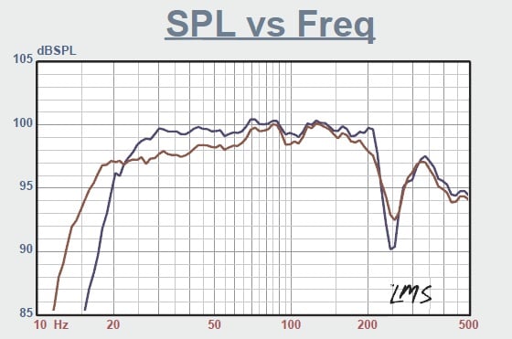

The first part of testing was to measure the frequency response from a modest output, all the way to the point where the system was clearly compressing and had hit the output wall, so to speak. I must admit, using the CLIO unit in this way, is a bit like using an elephant gun to shoot down mosquitoes. CLIO is an incredibly powerful and accurate instrument capable of taking a huge number of valuable metrics for characterizing an audio system. That said, on to our audio 101 exam of the Hsu Subwoofer. With the crossover control bypassed, the “Q” control set to 0.7 (meaning maximum bass), both ports open, and the “Operating Mode” switch set for both ports open, (Higher cutoff frequency) the following curves were run.
Hsu Research VTF-15H Frequency Response at Various Output Levels
Without compression, the level difference between the two top curves, the dark gray and the blue, should be the same db difference as between the two lowest curves, the red and the light gray. Since the power output is not limitless, at some point, the input is compressed, and a 3 db increase in input does not result in a 3db, or even a 2db increase in output. That, in essence, is compression. That is also the point to be understood and taken away from the above collection of curves. What is also noteworthy about this is that this is LONG TERM CONTINUOUS power, not instantaneous or peak power. This sweep starts at a very high frequency (for a subwoofer) 400 Hz, and slowly (14 seconds) sweeps down to 10 Hz. Notice the top curve starts to head south (lose output) near 40 Hz, while the lowest red curve hangs in there all the way down to 30 Hz before starting to fall off. Once again, we see here that compression is not a frequency independent event, but rather starts at a higher frequency for a higher drive level as shown in the above curve.
What can also be gleaned from the Clio curve above is that the port anti-phase is well above the bandwidth of the speaker with both ports open, so this subwoofer can do rather well with a higher crossover point as the response up to 200 Hz is ruler flat. So much of a problem in some of the other cabinets was, with both ports open in the Hsu, pushed well outside of the passband, and not as severe in its effect. This is in part due to the port geometry, and (I would assume) also in part to the shorter length of the ports needed to tune a larger box to about 22 Hz.
This slight underdamping of this woofer in this box was evident in listening tests, and the “Q” control supplied with the amplifier did not seem to make any perceptible difference with both ports open while listening to music. Now having seen the curves, I can imagine it would have been immediately apparent with pink noise. In short, without a bass management system and measurement gear on hand, tuning the optimal Q by ear alone would be a daunting task.

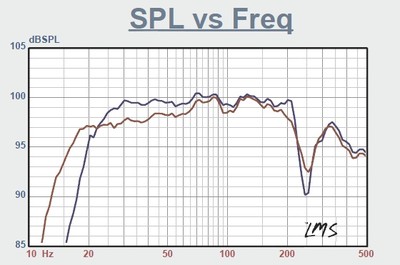

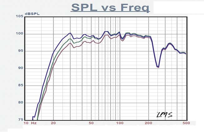

Effect of Q Control on Output of System as Measured by Hsu Research
While seen from the Clio curve, although not
apparent in the Hsu Resarch curve is that there is a slight rise at the bottom
range of frequencies suggesting this woofer might have been more optimally
damped (at the expense of some maximum output) with the optional foam plugs Hsu
includes than with both ports open.
While I did not take such a measurement, Dr Hsu was kind enough to
provide his to me which is reproduced below
Effect on Output when Triangular Foam plugs are used to lower Box tuning
This curve clearly shows the adjustment made by the “Q” control allowing one to tweak the box slightly tilting the curve to better adjust the response in room. If you look closely, you can see that the foam decreases the system Qts, lowers the cutoff frequency (with notable loss of output) and changes the rate of slope below resonance (port is less effective as reducing cone output below Fb). You can also notice the foam damps the antiphase output from the ports at 250 Hz.
Unfortunately we had time to only measure and listen to one mode (all ports open). As seen in the curves provided by the manufacturer, the one port open mode should provide true below 20 Hz extension (at reasonable SPL levels), an overdamped response (gentle downward sloping response), with stronger output at 16 and 20 Hz, but slightly less output in the 25 - 32 Hz range (port output actually cancels woofer output at 16 and 20 Hz in the two ports open position). With this model, you can choose your own set of compromises. When listening to music that does not require as much bass headroom, but you want very tight sounding bass, set it to one port open or sealed mode. When you are watching movies with lots of sub 20 Hz, set it to one port open. When you watch movies or listen to music that does not have sub 20 Hz content but want the most visceral impact with minimum compression artifacts, use the two port open mode (and set to lower Q if you want a tighter bass).

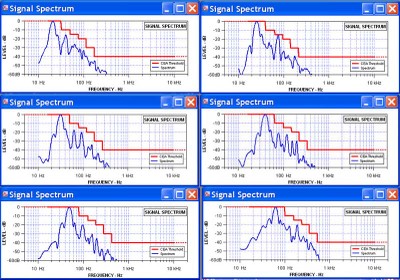

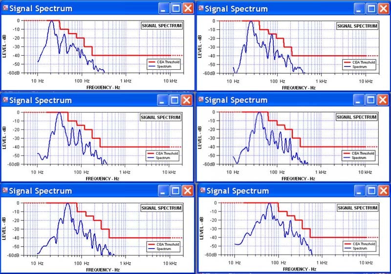

CEA-2010 Test Results
On to the CEA 2010 testing. CEA testing was performed with both ports wide open (response as shown in Clio) for achieving maximum output over the majority of the subwoofers bandwidth at the cost of a small amount of output at 20 Hz. To understand the meaning behind the graphics below and testing methods used, please refer to the prior article (Subwoofer Shootout Measurements Overview) on this method. The process is a simple one. Drive the input to the system to the point where either the amp, its compressor, or its speaker simply refuses to give you more output, or the distortion created at that output level exceeds the CEA “redline”. In EVERY system tested, the result (if not the peak SPL) was similar in one regard. At the highest frequencies in the sub's bandwidth, we ran out of amplifier power, or the compressor refused to put out more power than the amp could cleanly deliver. At the lowest frequencies, the subwoofer runs out of excursion. This is completely normal and what is to be expected. It may also explain why the CEA standard does not bother testing higher than the center frequency of 63 Hz. Below is a spectrum capture of the Hsu Research VTF-15H system at maximum usable output for each of the standard 1/3rd octave centers from 20 – 63 Hz.
Hsu Research VTF-15H CEA-2010 Distortion Test Results
| Hsu Research VTF-15H | CEA Test Performance | |
| Frequency | Maximum Peak SPL @ 1 Meter | RMS @ 2 meters |
| 20 Hz | 112.9 dB | 103.9 dB |
| 25 Hz | 118.8 dB | 109.8 dB |
| 32 Hz | 122.0 dB | 113 dB |
| 40 Hz | 124.7 dB | 115.7 dB |
| 50 Hz | 124.7 dB | 115.7 dB |
| 63 Hz | 124.6 dB | 115.6 dB |
Max SPL Output Data of the Hsu Research VTF-15H Subwoofer
Why not test this speaker up to 80 Hz? Surely it is important, no? Yes of course. Two primary reasons I believe that the CEA standard excludes an 80 Hz measurement. Any large sub will be amplification limited by the time it is going as high as 63 Hz. Looking at 80 Hz will add little to the value of the testing. The reason the Hsu Research VTF-15H sub limits at 121.7 to 121.6 Db from 40 – 63 Hz is not simple coincidence. This is the point at which the amplifier “runs out of gas”, in this case the compressor itself puts on the brakes to continue the analogy. Going higher in frequency should not yield a different result with any real serious subwoofer. Let's also bear in mind the CEA pulse signal centered at 63 Hz is only 3dB down at 80 Hz, so if the sub was falling off that low it would affect the 63 Hz measurement as well. Differences in testing of less than a db in these circumstances should not be viewed as meaningful. The 0.1 db loss at 63 Hz was likely an effect of a very minor amount of VC and/or amplifier heating as the procedure I used was in testing from lowest to highest frequency.

We ran a complete battery of new measurements and analysis on various port tuning modes and configurations

In order to make it easier for our readers to compare our CEA data between subwoofers tested prior to our new Subwoofer Measurement Protocol, we scaled our 1 meter peak CEA data to 2 meter RMS by subtracting 9dB for each frequency. We also added +3dB to the 1 meter test data to represent true peak output performance.

The Hsu sub as submitted had a smooth black finish, neither attracting attention nor warranting special notice. There were no issues to be seen with the cabinet finish, and I found the dual V shaped ports at the bottom of the cabinet both sound from an engineering standpoint, as well as visually appealing. If you have the room for it, there is not too much chance it is going to clash with any of your furniture or draw much attention to itself. What I liked most was that it's styling of the ports and grilles was both unique and attractive. During his visit to my laboratory, I was informed by Dr Hsu, that the "Rosewood" would be available at a $999 price point. For some reason, the $999 model is called "Rosenut" on the website. (It looks like Rosewood!) Likely for the same reason that Champagne is called sparkling wine when the grapes are grown in California instead of the Champagne region of France, but I should leave that explanation to Dr. Hsu.
