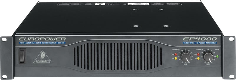

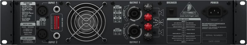

Behringer™ EP-4000 2000 watt RMS Professional rack mountable amp included (http://www.behringer.com/EN/Products/EP4000.aspx)

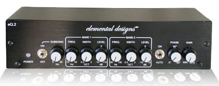

Elemental Designs eQ.2 bass controller included (http://www.edesignaudio.com/product_info.php?products_id=657)

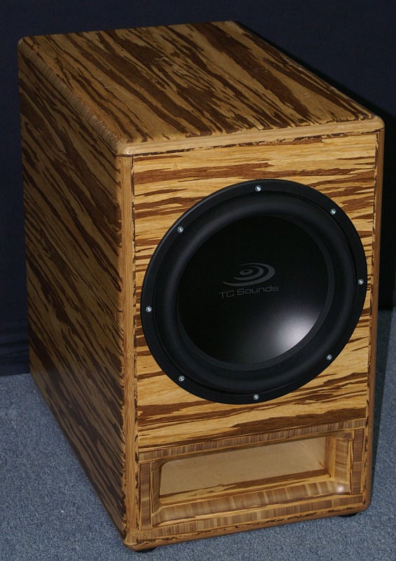

TC Sounds 12" Aluminum Cone Driver LMS-R (http://www.tcsounds.com/)

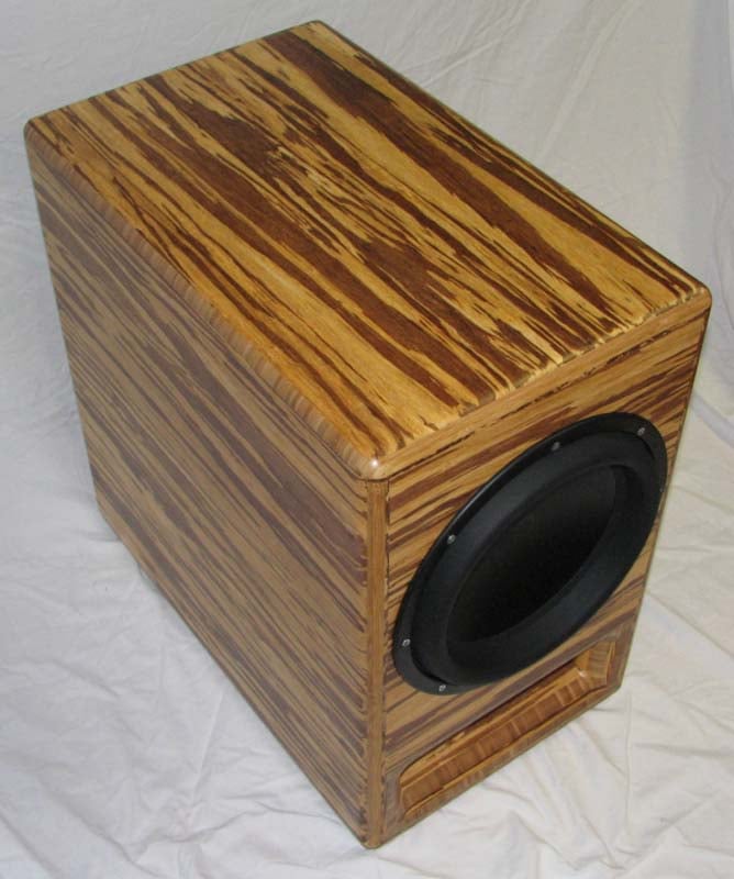

1.5" front baffle
High flow slot port with large radius's for low turbulence
Multitude of different cabinet finishes offered
Size: 24” deep x 14.5" wide x 24" high.
Weight: 115 pounds (Speaker & box only)
  • Unsurpassed Cabinet workmanship & Aesthetics
  • Delivers true 20Hz performance
  • Very small enclosure – High Wife Acceptance Factor
  • Separate amplifier means woofer and amplifier do not exacerbate each others performance
  • No electronic equalization necessary for LF extension down to 20 Hz
  • Small company to work with, so if you have an issue, the boss picks up the phone.
  • Box is heavy even minus the amplifier
  • Amp is best used for professional applications – contributes small amount of fan noise
  • Very low driver sensitivity (84.5 db or 0.18% conversion efficiency)
  • Not an integrated solution as submitted for review – No B.M.S. Available for the next 2 months without spending an extra $349
  • No remote control
  • No compression for speaker protection
  • No subsonic filtering available from the only currently available BMS; the Antimode 8033
Introduction

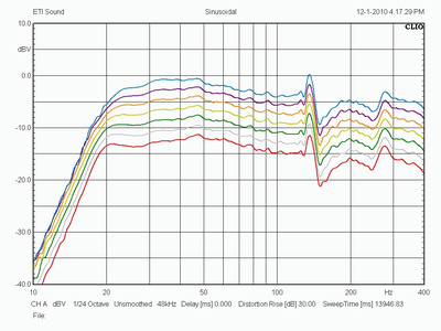

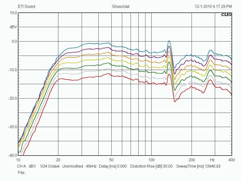

The Funkywaves FW 12.X Ported 12” subwoofer is a beautifully crafted piece of furniture. It must be said here, measurements alone do not adequately explain the unique sound of this sub. The tonal character is not matched by any of the other shootout entrants. It is a true subwoofer, offering flat performance all the way down to 20 Hz without any electronic equalization whatsoever. This product is, in a nutshell, very old school in its approach to making a small box go down to 20 Hz. It does so, not by any electronic signal manipulation, but by good old fashioned mass loading. There are definitely both advantages and disadvantages to this approach which are discussed in detail in this review.
