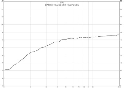

1. Basic Frequency Response: After calibrating the test equipment the subwoofer is placed in the testing area, the microphone is placed at a 2 meter distance from the closest edge of the subwoofer and basic response measurements are taken over a range of 10-200Hz. An effort is made to adjust the subwoofer to achieve the most natural unprocessed response by defeating the crossover if available, or setting it to its maximum position and defeating any on board EQ if that option is available. If the subwoofer is anything other than a simple front firing model an effort is made prior to this point to determine the best subwoofer orientation for the tests. This is the basic configuration that the subwoofer is left in for all tests afterward except for the testing of the subwoofer controls effect on its response and in cases where there are multiple subwoofer configurations or manufacturers suggested settings. In some cases a measurement with an extended upper range will be taken if the sub exhibits good response up to 200Hz. This test gives a look at the basic range the sub is suitable to cover and also some clues to the actual alignment of the subwoofer enclosure and driver.
Example: Basic Frequency Response of a Subwoofer
The graph above is a fairly typical frequency response of an unprocessed sealed subwoofer showing a slow and gradual 12dB/octave roll off into the low frequencies. A typical bass reflex, horn, or band-pass alignment will often exhibit deeper natural extension before the response corner, but will have a sharper rate of roll off from there, typically 36dB/octave or even faster after a high pass, or rumble filter is applied to the natural roll off. You could say that a perfect flat line from one end of the graph would be the goal but that is probably unrealistic and in some cases not even ideal for most system/room combinations. The important thing to look for here is that the subwoofer exhibits a smooth overall response with no radical changes in the response throughout its intended bandwidth: Spikes, dips, notches, or other response artifacts, may indicate problems with resonances, or ringing. Slow, gradual changes in response that are small in magnitude are usually less detrimental and more easily compensated for.

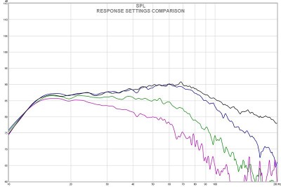

2. Effect of Subwoofer Settings on the Response: After the basic frequency response settings and orientation to be used for the tests are determined, the effects of the various subwoofer controls on the response will be measured. EQ boost will be engaged or disengaged, if there is a parametric EQ a measurement will be taken with boost at minimum, maximum and middle settings and also with low, middle and high Q at the lowest, highest and middle center frequencies allowed. A response measurement will be taken with the crossover set to its lowest, middle and highest frequencies. If there is an LFE input with crossover bypass that will be checked also. Any other available settings such as room compensation or damping settings will also be checked. This shows not only how the controls interact but how flexible the unit is and gives a clue as to how easy it will be to integrate well into a random room or system.
Example: Effect of a Subwoofer’s Different Crossover Settings on its Response
Here in the above example we see how various settings of this particular subwoofers low pass crossover affects its response. The purpose of examining how a subwoofer’s controls interact is to get an idea of how much utility and flexibility they will have to help in integrating the subwoofer into a random system, or room.

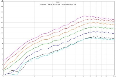

3. Long term power compression testing: Using a 50Hz sine wave the DUT’s output is adjusted until it produces 90dB at 2 meters. This is the basic starting level for high power testing. After the level is set an ascending sine wave sweep covering 10-120Hz and of 24 second duration is sent through the DUT starting at the base 90dB at 50Hz level. The upper cut-off of 120Hz was chosen as this corresponds with the LFE roll off in modern movie soundtracks. The reason that I use this full range even though many subs have no appreciable output at the lowest frequencies below 20Hz is because today’s blockbuster movies often have ridiculously hot bass content that many times extends well below 20Hz and even 10Hz. If the subwoofer designer has done their homework they will have built in protection or some other means for their subwoofer to cope with these occasional monstrous ultra low frequency signals showing up at the inputs, if they have not then this will be exposed very quickly with a sweep of this nature. After setting the basic 90dB at 50Hz sweep level, the sweep is repeated in rapid succession, each time with the level increased by 5dB, until the subwoofer ceases to increase in output or is driven into limiting, over-excursion, distortion or other obvious duress. Many times an increase of a full 5dB on the last sweep is far too much to try so an increase of 2 or 3dB is tried instead. After the final highest power sweep the DUT is returned to the drive level that produced the initial 90dB at 50Hz base level and another sweep is run. The tabulated results of this test show whether the output from the sub is increasing in a linear fashion. In other words with a 5dB input increase the sub should increase its output by 5dB. In the real world thermal heating effects, port compression, driver excursion limiting, amplifier clipping or limiting and driver impedance rise due to thermal heating of the voice coil causes the subwoofers to compress the input signal when driven hard. Additionally these effects vary throughout the frequency range as the subwoofer impedance, excursion, vent or passive radiator loading and demands on the amplifier all change. A better sub will exhibit less compression overall. The final repeat of the 90dB sweep after all of the other sweeps indicates how the heating of the driver motor and voice coil are affecting even the low volume basic response now. Less change is better here too.
Example: Power Compression Sweep measurements of a Subwoofer
What the graph above is showing is how the subwoofers output level and response shape changes with a long term, high duty cycle signal applied at ever increasing level. The topmost trace in the graph is the subwoofers maximum long term output. Ideally you would see a linear increase of output that perfectly tracks the increase in the input signal level and a response shape that looks exactly like the low volume ones except louder, of course.
