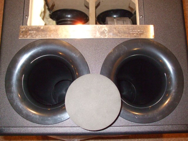

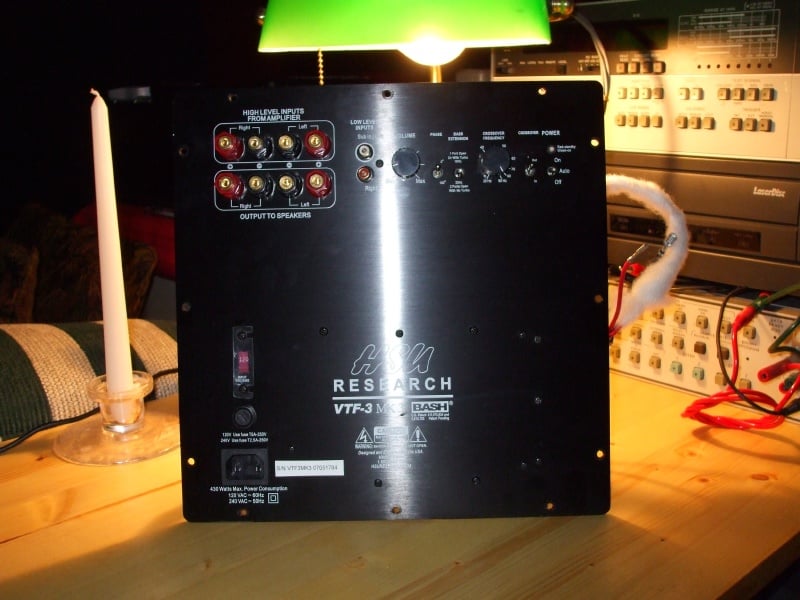

performance capabilities are and where the real value of the sub lies. Take,
for example, the pair of 4” ducts (seen at right) found just above the amp’s
control panel on the back of the sub. 3” ducts could have been used, but
narrowing the diameter would have increased the air velocity within the ducts, (under
normal operating conditions) in turn increasing the likelihood of wind noise. In
terms of unwanted noise, the quieter a sub, the less it calls unwanted attention
to itself, allowing one to better the enjoy the music listened to or the movie being
watched. The gray disk seen in the photo, perched as it is between the two
external ports, is the plug inserted into one of the ports when you want to
switch from max. output mode to max. extension mode. Hence the “VT” or
“variable tuning” in the VTF-3 Mk3’s name.

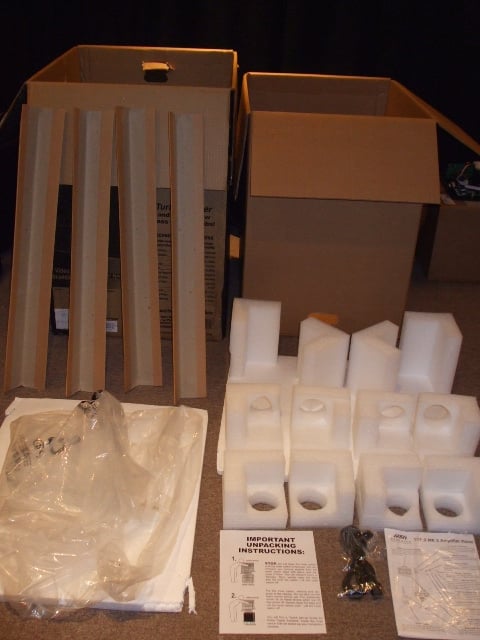

 Hsu Research wants their products to arrive intact! They’ve taken the
carton-within-a-carton approach and you’ll find instructions on just how to
unpack the unit pre-placed along the way. Once unpacked, you’ll have quite a
collection of packing material (as seen at right) that you’ll probably want to
hold onto. You’ll also have before you, of course, the VTF-3 Mk3, instruction
sheet & manual, along with the sub’s power cord. Time to get busy setting
the thing up!

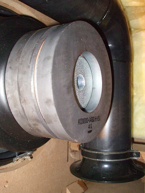

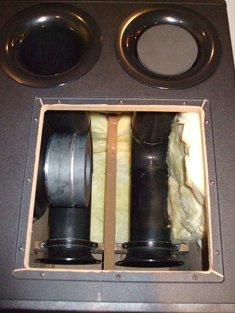

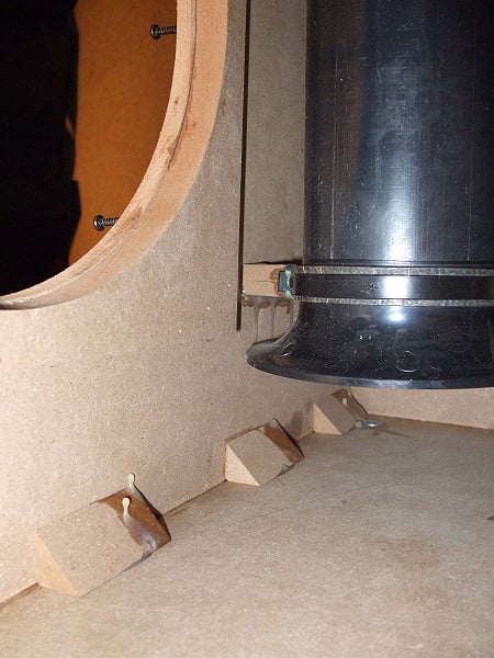

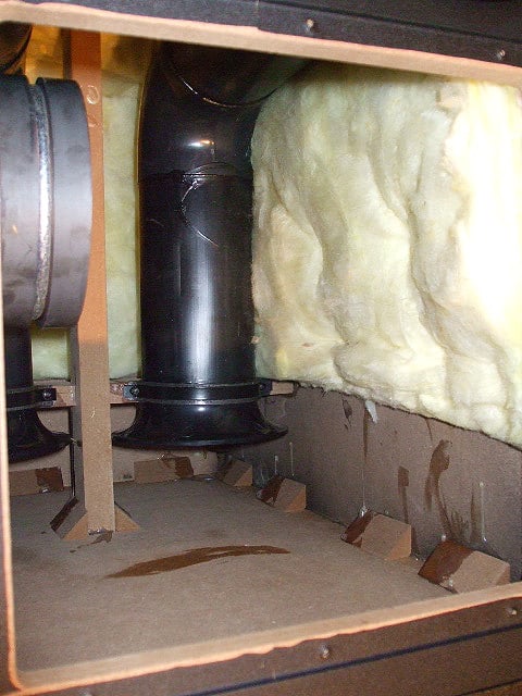

Remove the VTF-3 Mk3’s amplifier and - after the size of the driver’s motor structure - probably the most interesting if not downright fascinating feature are the ducts (as seen below). They’re lonnnnng and bent: at a 90° angle, which really is the only way you could fit a pair of ducts, each 4” in diameter, of the length necessary to tune the particular driver/cabinet combination that makes up the VTF-3 Mk3. Having worked out some of the engineering challenges getting the air flowing correctly through that 90° bend is the subject of a Hsu Research patent, now pending.
The cabinet itself comprises panels of various thicknesses, glued together, secured with glue blocks throughout, cross-braced (said bracing doubling as a mechanical support for the ducts) and lightly lined with fiberglass cladding on some of its interior surfaces. The driver (and power amp) both bolt directly to the cabinet. Hsu Research have taken steps to keep mechanical noise down, such as employing the vibration-resistant banding used in clamping the interior end of the ducts securely to the cabinet. That’s a nice, basic feature when you consider how easy it is for mechanical vibrations to set up in a sub, resulting in one of the most instantly annoying sounds ever heard! Fit and finish were very good. I found no flaws worthy of mention anywhere.

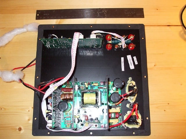

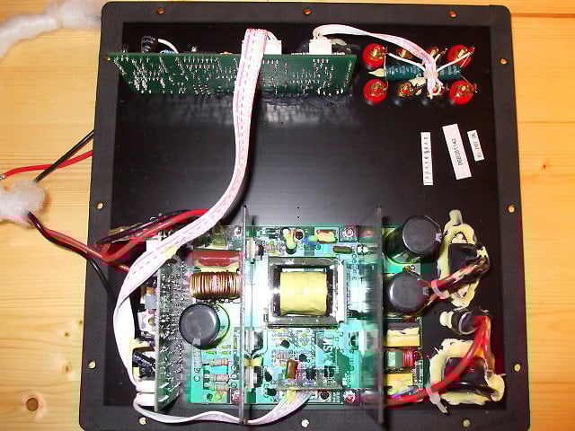

The VTF-3 Mk3 features a 350W Class-AB output stage with tracking power supply. The unit is bolted into the back of the sub and sits just below and to the right of the system’s ports. It features a 3-way power switch (On/Auto/Off), continuously low pass filter (30 Hz – 90 Hz, with 4th order/24dB octave crossover slope), crossover bypass switch, 2-way phase (0° - 180°) switch, two line-level inputs, a pair of speaker-level inputs & outputs, and a switch used for selecting either max. extension or output modes. There’s also the polarized, two-conductor power jack, user-replaceable fuse and protected input-voltage switch. This is, by the way, a new, updated version of the amp that was originally released with earlier versions of the VTF-3 Mk3. (See Figure 1b below for a comparison of the old & new amp’s transfer function).
The amp is also where we again see Hsu Research’s attention to minimizing unwanted mechanical noises: where air leaks across the amp’s metal faceplate might be a problem, they’ve applied a sealant. The power leads (seen on the left side in the above, right graphic) feeding the driver itself are wrapped in such a way as to prevent any kind of noise arising they should come into contact with any internal components.

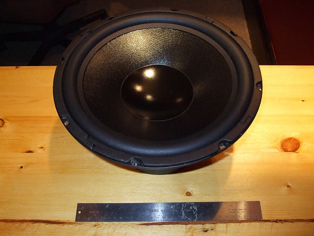

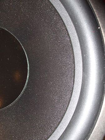

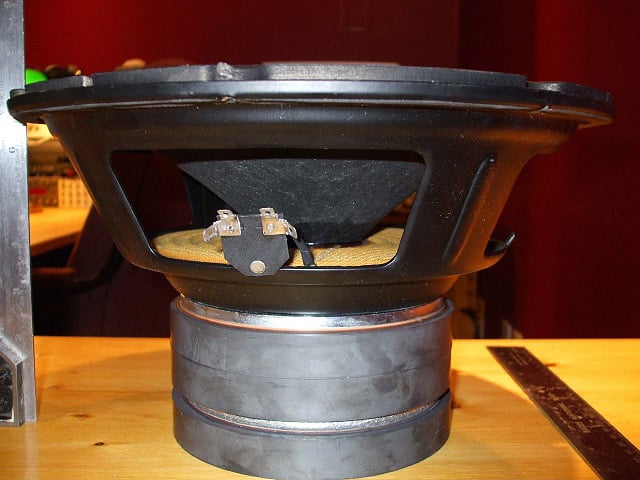

 For my money, the real star of this show is the VTF-3 Mk3’s
driver. It’s a nominal 12” unit, with a half-roll surround, and sporting a
massive vented motor assembly. Hsu Research has, from its inception, focused on
12” driver as its driver of choice and they have over the years refined their
design approach to where their products perform out to the limits of what a12”
driver can do. In the world of subwoofers it’s easy to overlook 12” drivers,
seemingly overshadowed by their 15” and 18” brethren. Underestimate the VTF-3
Mk3 at your own risk – this is one potent sub! For the specification-inclined I’ve
included a table with some of the driver’s T/S parameters.

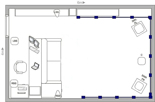

Listening was done in a room measuring approximately 6m x 4m, no windows and enclosed on all four sides, with the VTF-3 Mk3 located at one end of the room. (See illustration below). The sub was (at various times) positioned either between the front center channel speaker and the front left channel speaker or simply placed in substitution of the sub that ordinarily sat beneath the front left channel speaker.

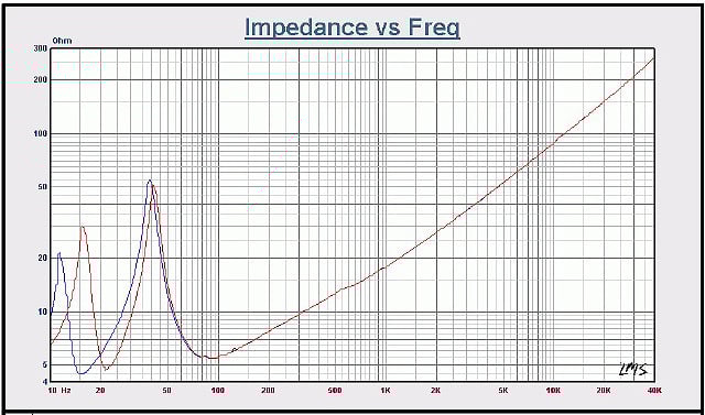

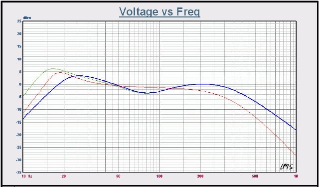

Figure 1a, b.: System Impedance at left, amplifier transfer function, at right.
The impedance curve of a system (seen above, right) can provide useful information about the system, including the presence of any pathologies that might effect its performance. The impedance scans were done with the VTF-3 Mk3’s power amp disconnected, the cable connecting the driver to the LMS card fed through one of the system’s ducts. As always, the 4-wire measurement method was used.
The red curve is the system’s impedance with both ports open (max. output mode) and the blue curve that with one port blocked (max. extension mode). At left we see the typical max-min-max curves presented by a bass-reflex or ported system. The blue curve’s local minimum at just over 15 Hz and the red curve’s local minimum at just over 21 Hz indicate the system’s native (driver/cabinet with no power amp in the circuit) tuning frequencies when set to operate in either max. extension mode or max. output mode. Further examination of the curves present no noteworthy pathologies.
At right, Figure 1b presents 3 amplifier transfer functions. The blue curve is the transfer function of the current amp, set to run in max output mode. The green curve is again for the current amp. this time set to run in max. extension mode. For comparison purposes, the transfer function of the old, original power amp (red curve) and no longer used by Hsu Research, is included.
All three measurements were made driving a single line-level input channel directly with the LMS card’s line out. (Driving both of the VTF-3 Mk3’s line-level inputs will result in a 6 dB increase in the amp’s output. (You are getting more voltage gain for a given input but the overall power limit of the amp will be unchanged).
The left most peaks for both the max extension and max output modes of the current amp have been shifted below and above the old amp’s LF speak (respectively). Both of the new amp’s curves feature a gentle roll-off immediately above their respective peaks, hitting a local minimum at around 80 Hz. Capturing data plots of a powered sub’s amplifier transfer function is a good to gain further insight to just how a particular sub functions. As a side note, if you know what a powered sub’s amplifier transfer function and you know what said sub’s dB spl response plot is, with just a bit of math you can derive thesub’s native dB spl plot.

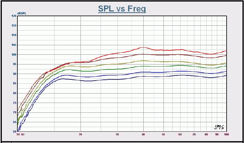

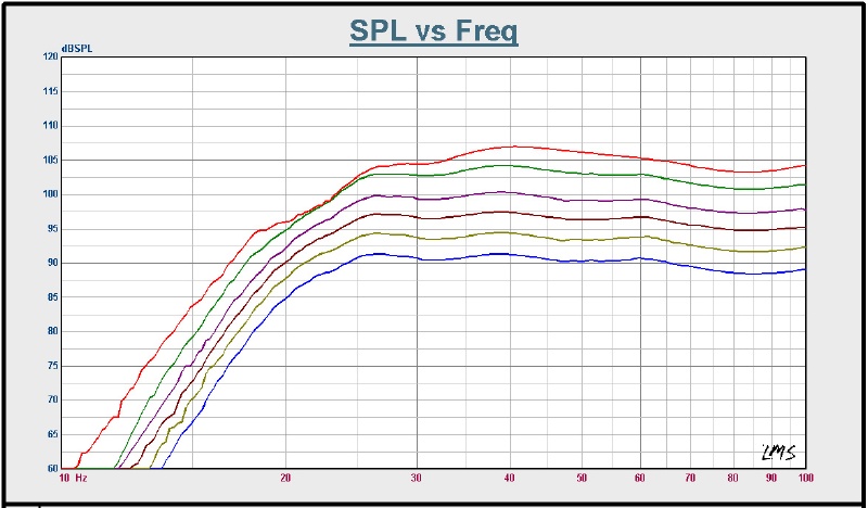

Figure 2a, b. Amplitude response plots, VTF-3 Mk3’s. At left, max. output mode) & max. extension mode) at right. 2m, on-axis, dB re 20 µPa., ground plane, no scaling. All measurements done outdoors.
In Figure 2a & b we see (at left) the amplitude response plot of the VTF-3 Mk3 when operating in max. output mode (both ports open) and max. extension mode at right (one port open). The outdoor ground plane measurement approach was used, with the LinearX M31 microphone placed 2m, on axis from the sub. No scaling or smoothing has been used. Ground plane at 2m produces results very similar to that of measurements made under anechoic conditions at 1m.
The scans in both cases were started at a drive level sufficient to produce approximately 90 dB in the passband and re-run with the drive level increased by ~ 3dB at each turn until compression significantly affected the system’s output. The phase switch was set at 0°, the crossover was bypassed and mode switch was set, of course, at either max output or extension mode. Note that at no point during measurement or listening was the optional turbo unit used (none were provided for the review). Adding the turbo, had one been available, would have resulted in a system capable of as much port-noise free sub- 20 Hz output as two VTF-3 MK3’s!
The measurements fairly well speak for themselves. We see the compression kicking in as the curves (in the mid-bandpass region) approach the 105 dB spl mark. At the higher output levels, particularly when the VTF-3 Mk3 was operating in max. extension mode (and much as Hsu Research would prefer it not to) at 16 Hz, the MK3 without turbo has port noise creeping in well before the amplifier runs out of steam. Adding the turbo (had one been available) would have effectively given about 6 dB more port-noise free output at 16 Hz. Overall, the VTF-3 Mk3 proved it self an excellent example of a well engineered product, purpose built with the intention of wringing every last drop of performance possible from a single 12” driver in a vented cabinet. Let’s see you top this one, Dr Hsu! ;-)
