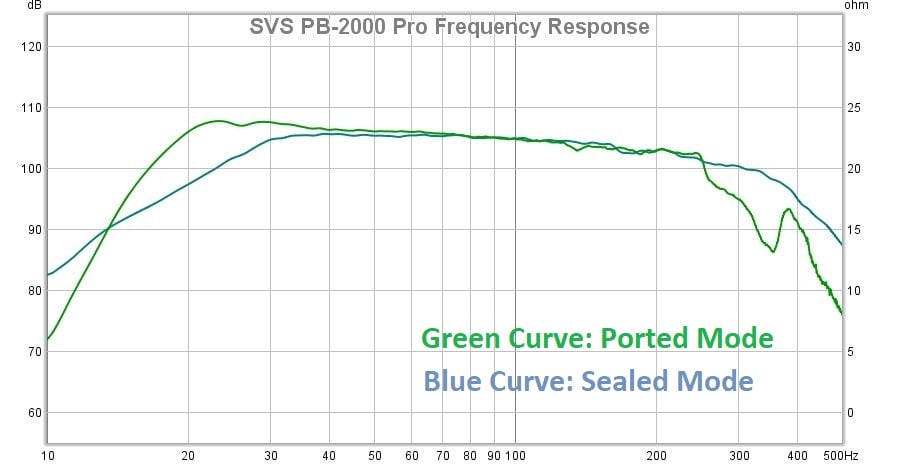

  • 16Hz to 290Hz +/-3dB (standard mode)

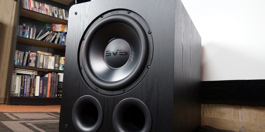

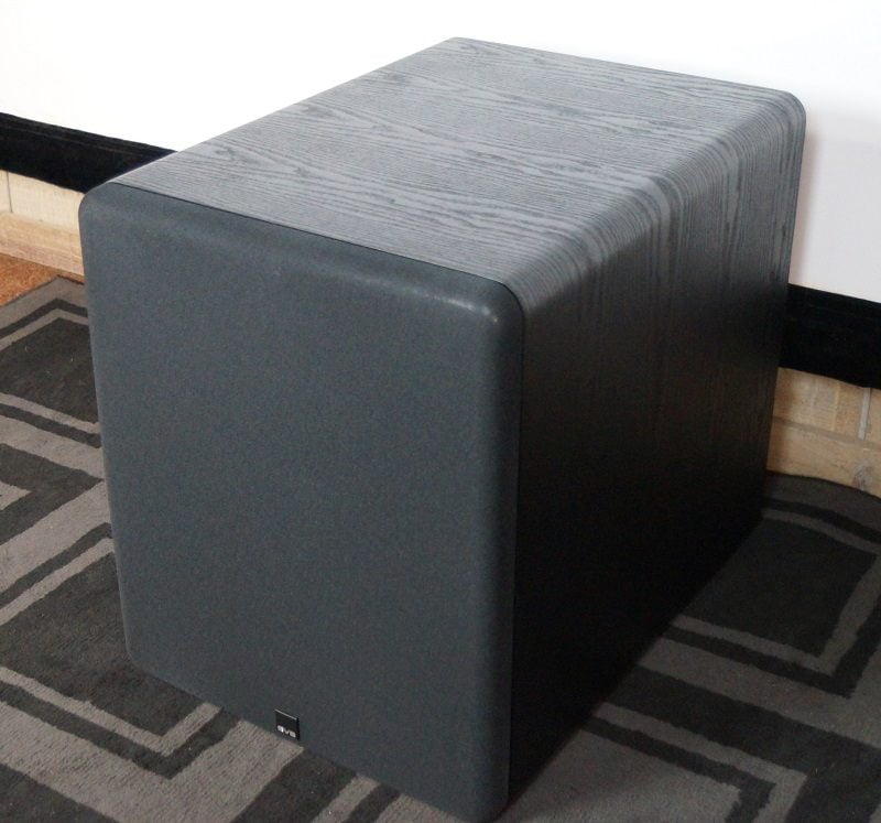

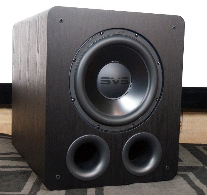

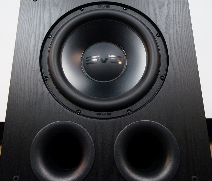

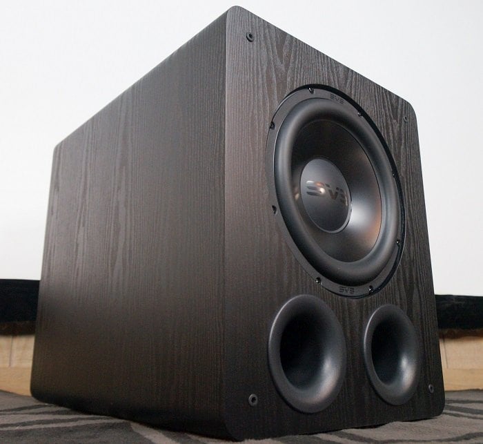

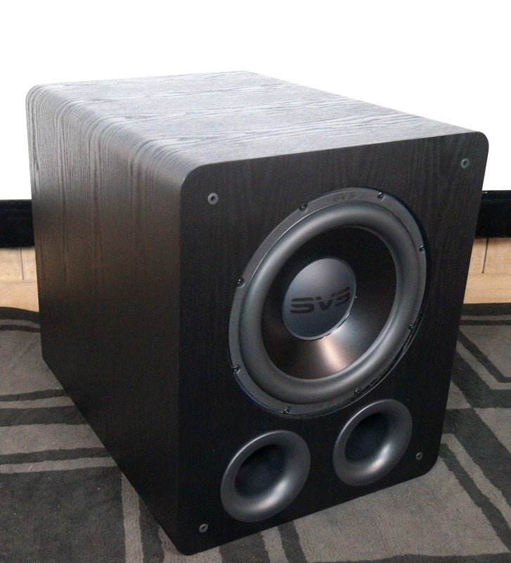

2k pro box.jpgAppearance-wise, not a whole lot has changed from the PB-2000 to the PB-2000 Pro. Pretty much the only significant visual changes are that there are two ports on the front baffle instead of one, and the Pro uses a fabric grille instead of a sheet metal grille. The PB-2000 Pro is a fairly basic subwoofer enclosure, and SVS tried to make it more appealing by using a black ash woodgrain veneer on it and rounding the lateral edges. That does make it look a touch classier or at least a bit more interesting than a plain black box. The move to a fabric grille from a metal grille is a step up, aesthetically speaking. The metal grille of the previous 2000 model had more heft and did a lot more to offer protection for the front baffle, but it also made the overall appearance look a bit more industrial, and it wasn’t all that attractive. The fabric grille simply hides the driver and ports discreetly.
The PB-2000 Pro is not a huge sub but it isn’t a small one either (by Audioholics’ standards, at least). If other household members are fussy about the furniture and interior design, it may not be able to have a place in an elegant living room setting. It isn’t an offensive piece and should be OK by more relaxed interior design standards. Since the PB-2000 Pro occupies a middle territory in both size and aesthetics, it is something that will be highly subjective on an individual basis. The PB-2000 Pro is not a bad looking sub as subwoofers go, but it isn’t quite beautiful either. Its appearance is very much in line with its product class. It looks fine.

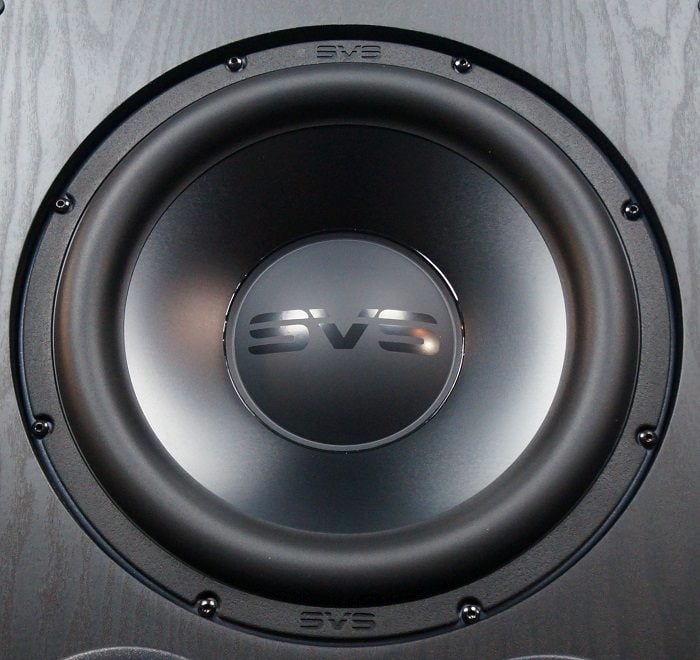

2k pro cone.jpgThe design of the PB-2000 Pro is a lot like a slightly smaller version of the PB-3000. It has the same cabinet and amplifier design (albeit with less power), same operating modes, and the same user interface. The most significant difference seems to be the driver, where the PB-3000 looks to have a beefier driver, which is no surprise in a more expensive subwoofer. To go over the basics, the PB-2000 Pro is a vented subwoofer that has front-mounted ports and driver. It is natively a ported subwoofer but comes with port plugs and a DSP setting to be operated as a sealed sub as well. The PB-2000 Pro powers a 12” driver with a 550-watt RMS amplifier and uses two ports to augment low bass. For a more detailed look, let’s talk about the driver to start with, since it looks to be the most novel component here.

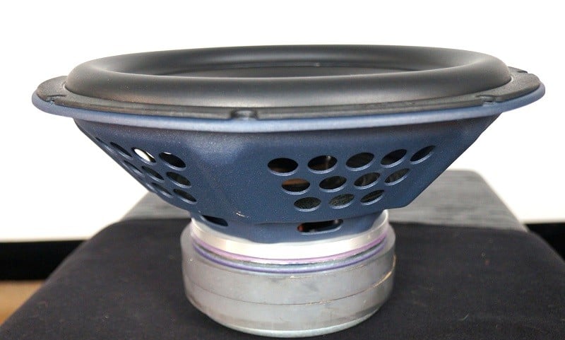

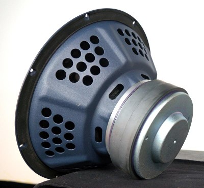

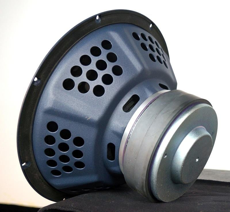

The previous 2000 series subs used drivers that were based on the Peerless XXLS platform, but the 2000 Pro line seems to be taking a new direction. The aluminum cone looks to be similar along with the double stack of ¾” thick magnets, but the top plate looks slightly different, and SVS now uses a stamped steel basket instead of cast aluminum. While stamped steel is normally thought of as an inferior basket compared to cast aluminum, the thickness of the steel in the 2000 Pro is substantial, so it could well be that SVS has been able to shed the cost of cast aluminum without also shedding its advantages as a basket material. Regarding the cone, aluminum is advantageous as a cone material not only for its lightweight and high stiffness, but it can act as a heatsink for rising temperatures from the voice coil. The cone attaches to the fixed pieces of the driver by a Nomex spider and large rubber-foam surround. The motor uses an aluminum shorting ring in order to reduce inductance thereby improving linearity. The backplate is bumped out for higher excursions before reaching mechanical limits.

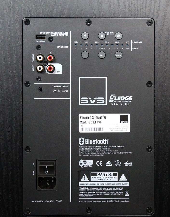

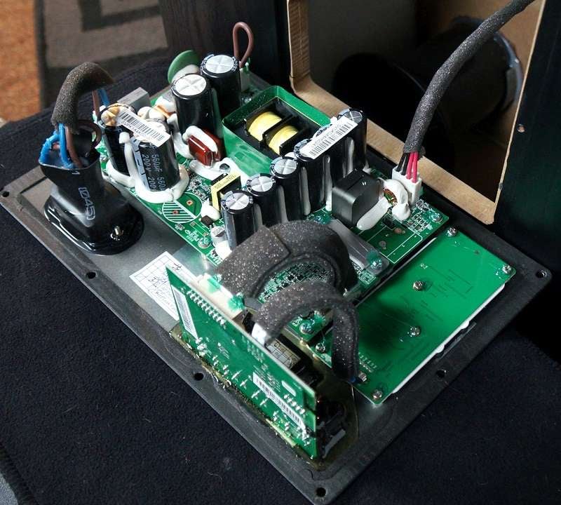

The Class-D amplifier now uses discrete 25 amp 600-volt MOSFETs along with the same 50 MHz Analog Devices DSP with 56-bit filtering that is found in SVS’s higher-end subs. It has been given a small 50-watt bump over previous 2000 series subs. The PB-2000 Pro has right/left and LFE RCA inputs as well as RCA outs in case you want to daisy chain the signal to some other device. It also has a USB input to power an SVS Wireless Audio Adapter for those who want to go wireless. As with SVS’s higher-end subs, you can control the PB-2000 Pro with the SVS Subwoofer Control app on either iOS, Andriod, and Amazon Fire devices.  With SVS’s Subwoofer Control App, the user can control the volume down to a single dB of precision, low-pass filter behavior from 30 Hz to 200 Hz down to individual hertz frequency precision and also with a choice of slopes of 6, 12, 18, and 24 dB/ octave, phase control from 0° to 180° selectable down to individual degrees (or you can just flip the polarity from positive to negative), room gain compensation response curve selectable from 25 Hz, 31 Hz, or 40 Hz with a choice of a 12 or 6 dB/ octave slope (this is very handy for taming low-end boominess for those who get a lot of room gain), and port tuning configurations. One neat thing that is especially easy to use with the SVS app is a 3-band parametric equalizer with which the user can adjust the bass response to their taste. It can also help tame peaks in the response that are produced by room acoustics. The PB-2000 Pro’s onboard control is the same ‘Intelligent Control Interface’ that was used in the 3000 series. It is fairly sleek and intuitive.

The best placement for a single sub in my room gives me a relatively flat response for an un-EQ’d single subwoofer, with a window of +/- 4 dB from 25 Hz to 100 Hz with no broad dips in important ranges. This location trades low-end room gain for a relatively flat response, a worthwhile trade for my tastes. The receiver used was a Pioneer Elite SC-55 and the crossover was used mostly at 80 Hz. The music was sourced from Qobuz. As always, I will note here that since room acoustics have a huge effect on low frequencies, the way these subwoofers sound in my room at my listening position is not necessarily going to be the way they sound anywhere else for anyone else, so readers would do well to keep that in mind, and not just for this subwoofer in this review, but for any subwoofer in any review.
