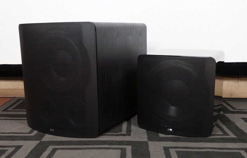

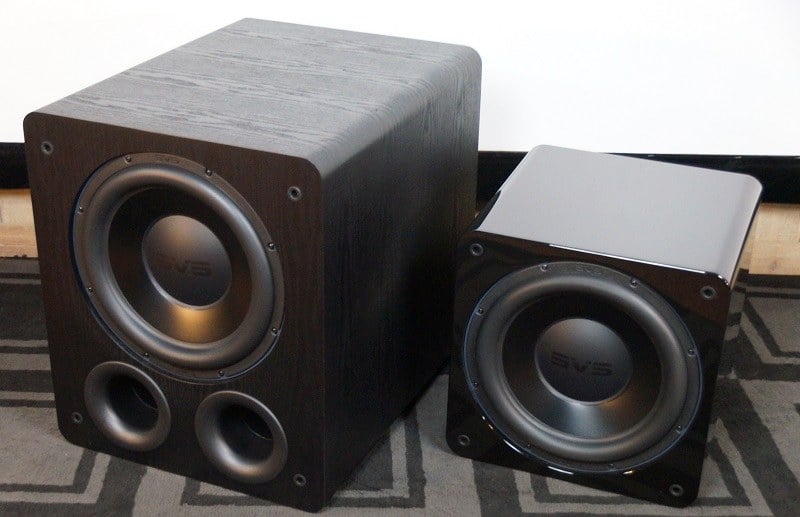

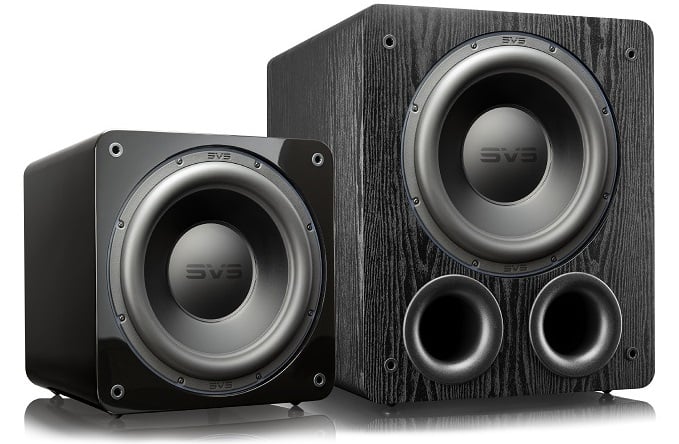

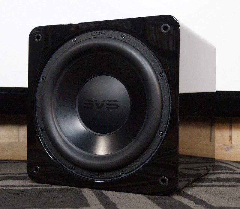

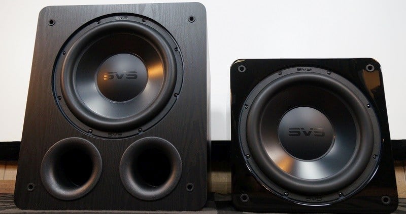

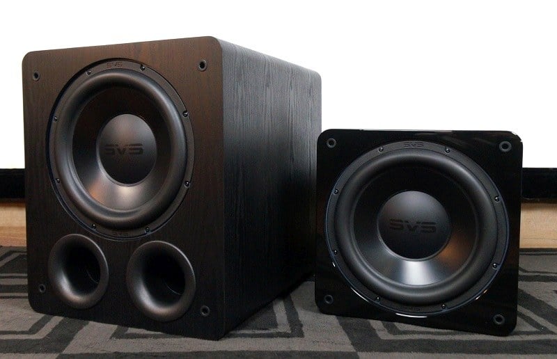

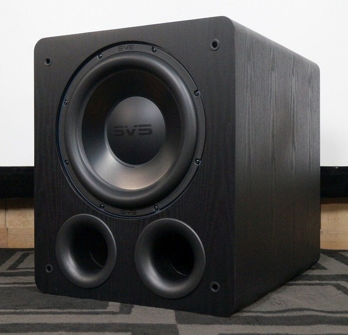

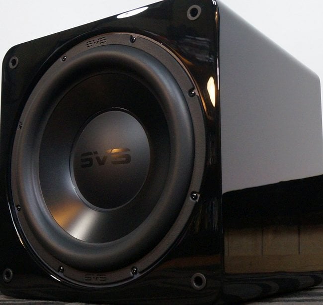

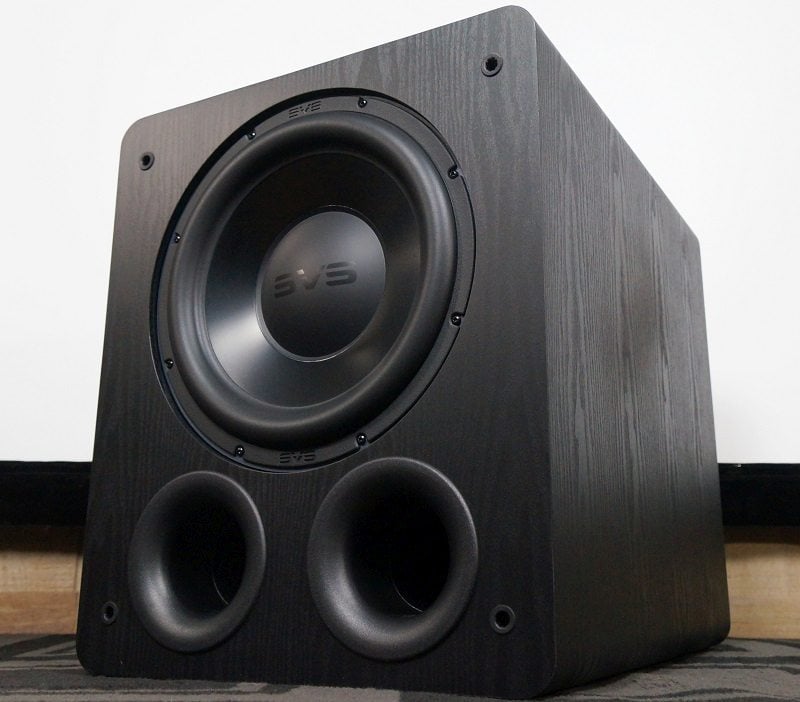

The appearances of the PB-3000 and SB-3000 are two very different stories. Even though they use the same driver, the PB-3000 is large and muscular looking, while the SB-3000 is much more elegant and refined. While this is mostly due to the fact that the PB-3000 is over twice as large as the SB-3000, another major contributing factor to this effect is that the SB-3000 came in a Piano Gloss Black finish whereas the PB-3000 comes in a Black Ash finish. The PB-3000 only comes in Black Ash. The SB-3000 can be had in Black Ash but can be had in Piano Gloss Black for a $100 surcharge. SVS’s gloss black finish is a deep high-gloss that is quite nice and not plasticy, so it is well worth the premium cost in my opinion.
I have always liked the look of SVS’s woofers, and they keep a consistent style throughout their product lines. They always have a soft black texture with the SVS logo printed on the dustcap. I don’t normally like it when any kind of graphic is printed on cones, but SVS gets a pass here since it has always been somewhat understated and tasteful. One new stylistic touch that is not as welcome is the SVS logo is impressed in the gasket piece around the surround at the top and bottom. With ‘SVS’ printed on the dustcap in large font, we do not need the additional reminders that this is an SVS product. I think less is more in terms of logo placement.
The ports on the front of the PB-3000 do add to the brawny look especially with the grille on. SVS’s grilles have always been far more about function than form and that remains true for the 3000 subs. The grilles certainly can be useful, but these subs look better without them, especially the SB-3000. The SB-3000 almost achieves a certain clean perfection. I say almost, because it doesn’t quite achieve perfection on account of the grille guides on the front baffle which do mar an otherwise smooth design. Nonetheless, it is one of the nicest-looking subwoofers I have dealt with to date. It is a gleaming beauty that would not look out of place in luxury spaces (sans grille). My advice to SVS - move to a magnetic grille for the SB-3000. Yes, small magnets would not support as robust grille as the existing one, but think about how much more graceful it would be without the grille guides!
I would sum up these subs’ appearances by using an automotive comparison: the PB-3000 resembles a beefy SUV whereas the SB-3000 resembles a luxury sedan. This seems a fitting analogy not just in aesthetics but also of performance.

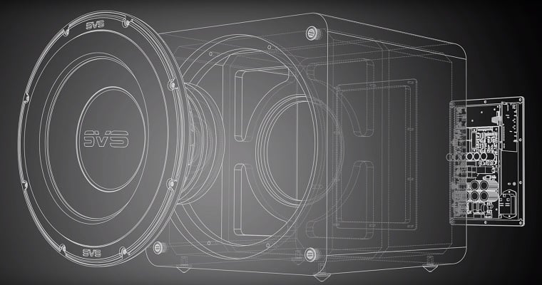

Design Overview
At Audioholics, we often see the question from audio novices of what the difference is between a ported sub and a sealed sub, aside from the obvious size difference. The answer is simple: ported subs tend to have a lot more deep bass output than sealed subs. For those who don’t know, ported subwoofers use the back motion of the rear side of the woofer into the cabinet to resonate the air mass within the port. The air mass inside the port vibrates at precise frequencies from an effect called ‘Helmholtz Resonance.’ This is the same acoustic principle at work when you blow over the top of a bottle or jug and a distinct note is produced. The volume of air inside the cabinet and volume of air inside the ports are critical ingredients to this and govern the sound produced by the port, much like the volume of air inside of a jug and the shape of the opening determines the sound when blown upon. In a sealed subwoofer, the pressure waves created by the motion of the rear side of the cone are simply lost, and, in terms of sound produced per watt, a sealed subwoofer is far less efficient in deep bass ranges.
This difference in deep bass capability will certainly carry between the SB-3000 and PB-3000. The catch is that ported subs need to be substantially larger than sealed to take full advantage of this principle when using the same driver and amplifier. Going back to our analogy of the SB-3000 as a sedan and the PB-3000 as a truck, it is more than just an aesthetic comparison because the PB-3000 can displace a lot more air which means much higher sound pressure levels at low frequencies, so, like the vehicle differences, it has a lot more ‘hauling capacity.‘ One thing to keep in mind is that the output advantages that a ported sub has over a sealed sub are mostly limited to deep bass. Above port resonant frequencies, which is a relatively narrow frequency band, ported subwoofers do not have as much output advantage. We will be able to take a close look at the performance differences in the ‘Measurements and Analysis’ section of this review.

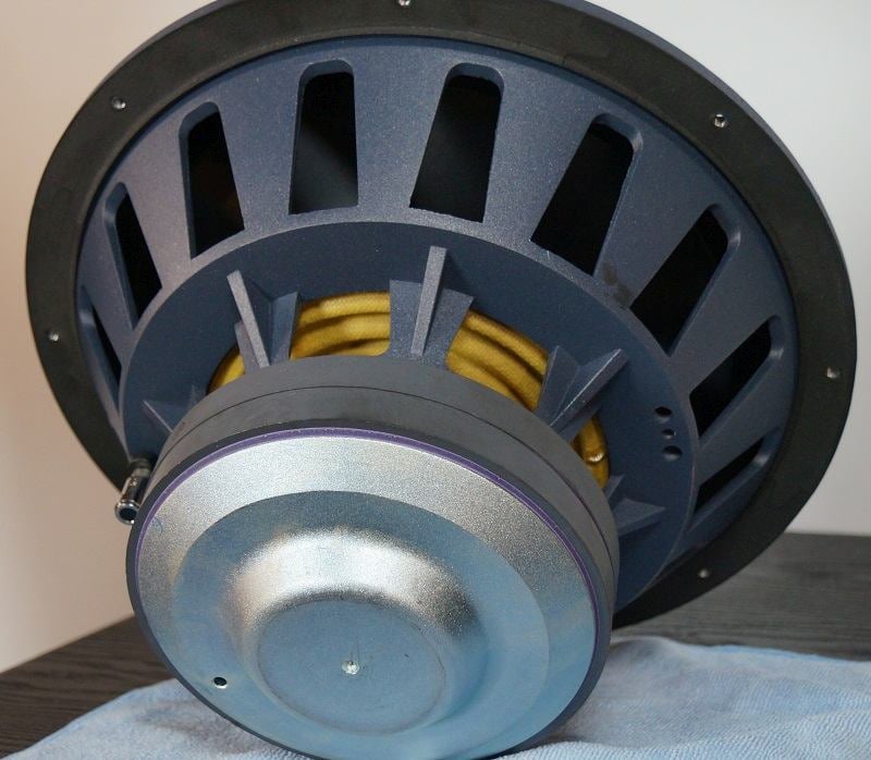

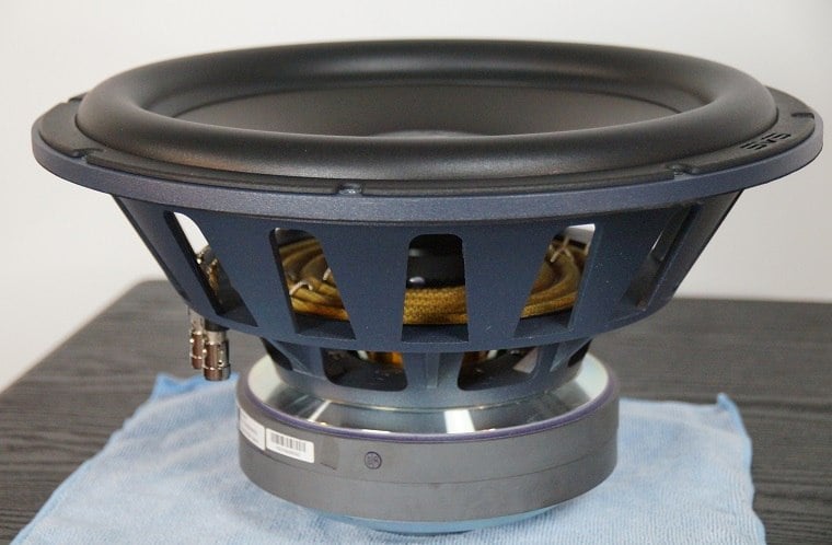

Getting into design specifics of these subs, let’s talk about the driver since they both use the same one, a 13” diameter, high-excursion driver. There is a lot of neat stuff going on with this driver, but one of the most interesting aspects of it is how the voice coil is wound around the former. SVS uses a split-wind voice coil meaning that, instead of the coil being wound in a uniform layering around the former, the coil winding has thicker density outside of its rest position within the ‘gap,’ which is the place where the permanent magnet’s force is focused. If executed properly, this can help maintain more linearity across higher excursions. In a normal uniformly wound coil, the rest position is the point of greatest magnetic strength, and the further that the coil moves away from its rest position, the less magnetic power is exerted upon the moving mass of the driver, so the magnetic strength is always changing depending on the position of the coil. That means that the driver is always losing linear motion control over the cone as excursion increases. A split-winding compensates for that by moving more coil away from the center and toward the edges of the winding, so the magnetic force stays the same so long as there is coil in the gap. The result will be that the cone’s motion is more tightly controlled over a greater range of excursion, and the sub retains accuracy in deeper frequencies and louder levels.
I am told by Ed Mullen, SVS’s Director of Technology that:
“proper execution of a split-wind coil is incredibly difficult and requires complex simulations and very precise machining and manufacturing tolerances. But when done properly, the benefits are a much flatter force/displacement curve and excellent motor strength at/near the excursion limits of the driver, resulting in excellent overall driver linearity.”
One potential trade-off of this winding topology is that since there is less winding density around the rest position, there will be less magnetic force available for low excursion frequencies, and that means the driver will lose sensitivity as frequencies increase. So this type of winding should be very good for deep bass but may sacrifice upper bass performance toward that end. However, one aspect of having less coil in the rest position that could help compensate for the reduced sensitivity at higher frequencies is that there will not be as much inductance occurring around the rest position as there will be around areas of greater coil density. Inductance can have the effect of reducing higher frequency output. Something else that helps to retain balance is that the driver suspension has the most amount of compliance at the rest position. The farther the driver moves in one direction, the lower the compliance (meaning more resistance from the spider and suspension), thereby requiring greater motor force to overcome.

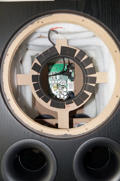

When we take the driver out, we see that it uses a very robust-looking cast aluminum basket and two 7” diameter ferrite magnets, each with a roughly 5/8” thickness. That should make for a very powerful magnetic field, and SVS claims that the motor section of the driver alone weighs almost 18 lbs. Inside the motor, we can see a 2” diameter voice coil. Measuring the driver’s diameter, it comes out to a 13 ⅞” diameter from the frame’s edge. Most manufacturers use distance from frame edge as diameter, and almost all of them would have rounded up to say this is a 14” driver, but SVS has rounded down for some reason. But by most manufacturer’s standards, this would be considered a 14” driver. The 3000s use aluminum cones, and they are a good choice not only good because they are stiff and light but also serve as a heatsink for cooling when the voice coil gets hot, and that can improve thermal compression behavior. This is helped by a thermally conductive polyimide impregnated fiberglass former so that heat is quickly leached off of the voice coil. There is also an aluminum shorting ring in the motor which will help to reduce inductance and lower distortion.

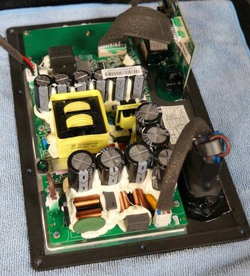

SVS Class D Sledge Amplifier

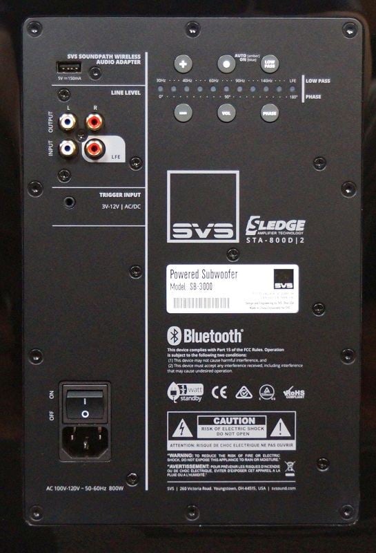

The amplifier uses the same platform as was used in the 4000 and 16-Ultra series but scaled down a bit in power and features. It is rated for 800 watts of continuous power (although we think SVS’s claim of 4,000 watts peak power is a bit hyperbolic). It is the same class-D design with discrete 25-amp MOSFETs and DSP engine running on a 50 MHz Analog Devices Audio DSP chip with 56bit filtering. As with the 4000s and 16-Ultras, the 3000s can be operated by a smartphone app that can control a wide range of functions to an extremely fine degree of adjustability. With SVS’s Subwoofer Control App, the user can control the volume down to a single dB of precision, low-pass filter behavior from 30 Hz to 200 Hz down to individual hertz frequency precision and also with a choice of slopes of 6, 12, 18, and 24 dB/ octave, phase control from 0° to 180° selectable down to individual degrees (or you can just flip the polarity from positive to negative), room gain compensation response curve selectable from 25 Hz, 31 Hz, or 40 Hz with a choice of a 12 or 6 dB/ octave slope (this is very handy for taming low-end boominess for those who get a lot of room gain), and port tuning configurations. One neat thing that is especially easy to use with the SVS app is a 3-band parametric equalizer with which the user can adjust the bass response to their taste. It can also help tame peaks in the response that are produced by room acoustics.
The 3000 subs do not have the front-panel display of the 4000s or 16-Ultras, but they do have a very clean and economic control layout on the amp plate that SVS calls the ‘Intelligent Control Interface’ (ICI). There is a meter that can be switched to indicate volume, phase, and low-pass filter settings, although that seems to be the extent of the onboard controls. For deeper control of settings, users will need the smartphone app.
The cabinet is very stout although not as heavy-duty as the 4000 series and 16-Ultra series cabinets, and that is a good thing in my book. Those enclosures were overbuilt, and that ended up adding a whole lot of extra weight just for effect and not really for any performance gains. The 3000 subs are much more sensibly constructed. The PB-3000 is still a bit heavy at 82 lbs, but it is much easier to move around as opposed to the back-breaking 153 lbs. PB-4000. The PB-3000 is a robust construction using a 1 ½” thick MDF front baffle and ¾” thick side panels and bracing. There is a window brace in the center that helps to support the driver motor and another brace further back that supports the ports. There is an ample amount of stuffing lining the cabinet walls. The ports are quite large with a 19” length and 3 ½” diameter. They are flared at both ends. The SB-3000 has an internal window brace as well. As always, the SVS grilles are very heavy-duty, and SVS consistently provides the most protective subwoofer grilles in the industry. It is a big steel grille that could really protect the driver from a hard kick or some hand-thrown projectile. They don’t look pretty (in my opinion) but they are truly effective at driver protection. The feet are some wide rubber cones that can be used on hard surfaces without worrying about scratching the floor. They may leave a mark if dragged across carpeting though, so make sure that they get some clearance if moving the sub across carpeted flooring.

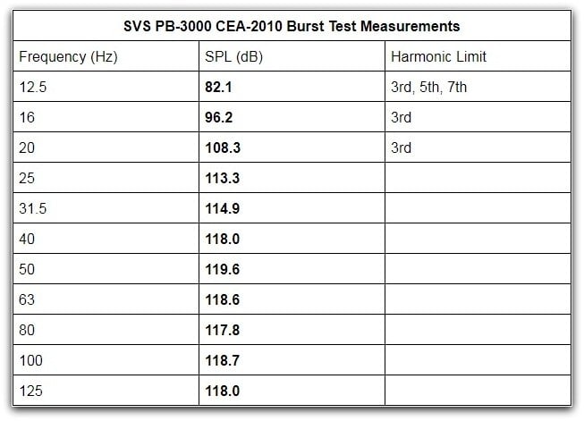

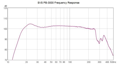

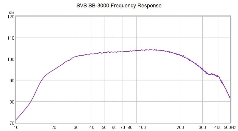

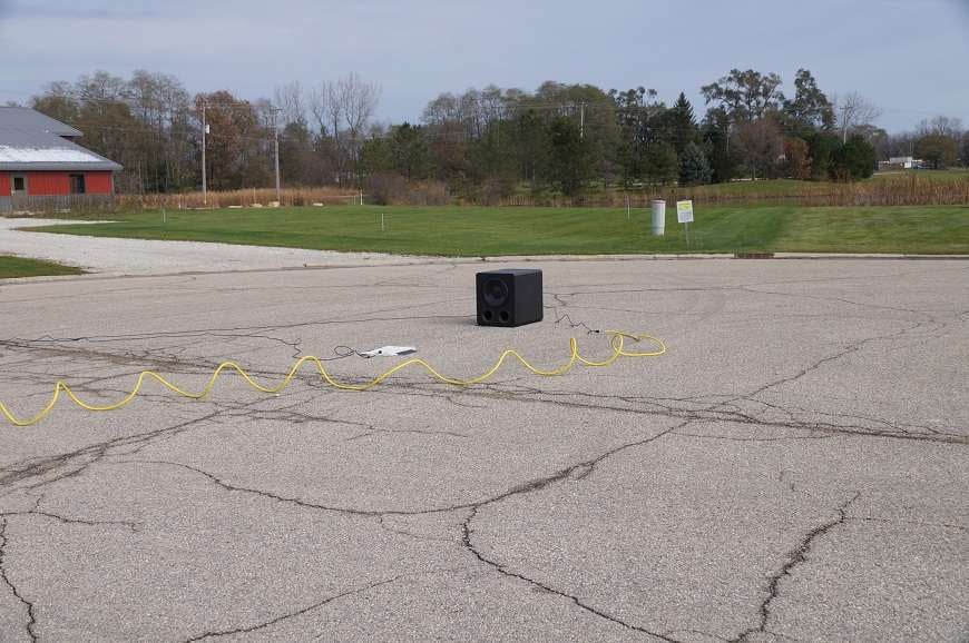

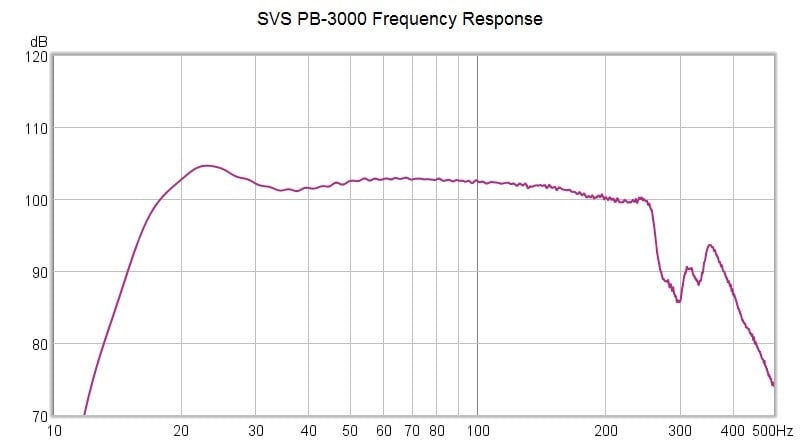

The SVS PB-3000 and SB-3000 were tested using ground plane measurements with the microphone at a 2-meter distance in an open setting with well over 100 feet from the nearest large structure. The subs were tested with woofer facing the microphone. The temperature was recorded at 43 degrees with 58% humidity. The subwoofers’ gain was set to maximum, phase was set to 0, and the low pass filters were left off.
The above graphs show the measured frequency responses for the PB-3000 and SB-3000 subwoofers. Both curves show a very well-controlled and flattish response overall. SVS’s claimed response windows do pan out in our measurements. The PB-3000 does show a small bump around port tuning that might give a bit more weight to effects sounds that take advantage of those deep frequencies. Users who want to taper the low end of the PB-3000 in cases where room gain boosts it too much have a variety of ways to do so, including plugging the ports and setting the PB-3000 to ‘sealed mode,’ using the parametric EQ to reduce that narrow frequency band, or use the ‘room gain compensation’ to reduce the low end altogether. We can see from the above graphs that the SB-3000 does have a high-pass filter which attenuates the response shape below 20 Hz, as the SB-3000 has a steeper slope than the traditional 12dB/octave that one would expect to see in the low end of a sealed subwoofer. In both graphs, it’s nice to see the response extend out to 200 Hz. This isn’t just good for those who like to use higher-than-traditional 80 Hz crossover frequencies, but also makes for better integration with the main speakers because the response needs less work at the crossover by the AVR.

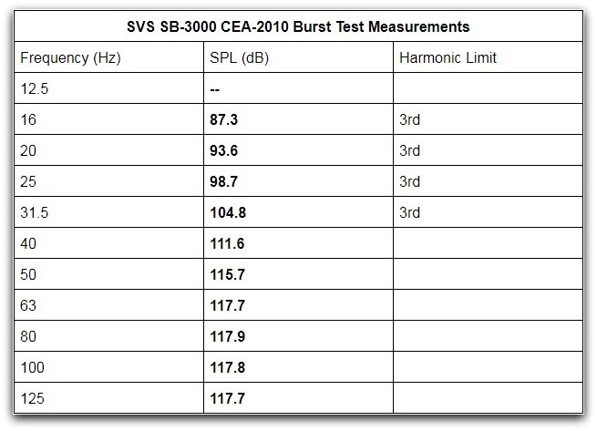

Note: The above CEA-2010 measurements are short-term bursts that show the subwoofer’s clean peak SPL before heavy distortion sets in. Our measurements have been referenced to 2-meter RMS, which is 9 dB down from the standard requirement for the measurements to be shown at 1-meter peak. However most publicly available CEA-2010 measurements are shown at 2-meter RMS, so we followed that convention.
There are a couple of differences between this round of CEA-2010 testing from what we normally do that we should note. Firstly, testing for these subs was conducted in weather that is a fair bit below the specified 65F to 80F degrees mandated by the CEA-2010 protocol. The reality is unless testing is done in such cold weather that the surround becomes very stiff thereby inhibiting excursion more than normal, the results should be very close to values obtained in compliant temperature conditions. Second, due to an interface issue with the pre-amp, CEA-2010 testing was conducted using REW instead of Don Keele’s CEA-2010 testing program written for Igor Pro from Wavemetrics. The two programs can get slightly differing values at times, with REW managing to record somewhat higher values in the low-end in past comparative testing. For the most part, however, the measurements should be very close. Indeed, SVS told us our results are within 1 dB of theirs at all frequencies for both subs except for the 16 Hz measurement of the PB-3000 where they did see a couple of dB more than what we recorded. But one drawback of using REW for CEA-2010 burst testing is that it does not give out distortion numbers as a percentage, and so we do not have the corresponding THD numbers for our burst measurements as we normally would.
Both the PB-3000 and SB-3000 put up some very impressive numbers. As a point of comparison, check out the measurements in our review of the larger and more expensive SVS PB-4000. The PB-3000 is either matching or surpassing the performance of its higher-end sibling at 25 Hz and above. The PB-4000 holds a major advantage at 20 Hz and below, but that range isn’t used nearly as often as 25 hz and above. I think this was a smart move on SVS’s part in the PB-3000’s design. SVS could have made a heavier driver that could dig a bit deeper but that would have incurred a pretty hefty penalty in all other frequencies. That might also have needed a larger cabinet. By giving up on some ultra-deep bass and letting the PB-3000 have a slightly higher tuning point, SVS gets big returns over all of the rest of the range. Yet it still holds very respectable deep bass performance with solid output down below 20 Hz. In fact, for 90% of movie content and 99.9% of music content, I doubt anyone could tell the difference between the PB-3000 and PB-4000 from their sound alone.
The SB-3000 is similarly good for a sealed sub; respectable deep bass output but terrific mid-bass output, especially when one considers its size. For a small sub, the SB-3000 is an absolute humdinger. Its mid-bass burst measurements are more in line with what one would expect to see from a 15” sub, not a 13” sub.

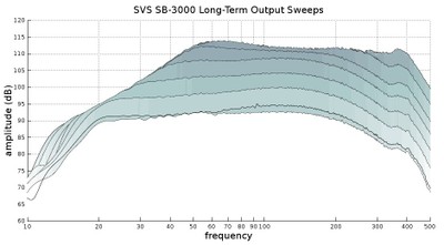

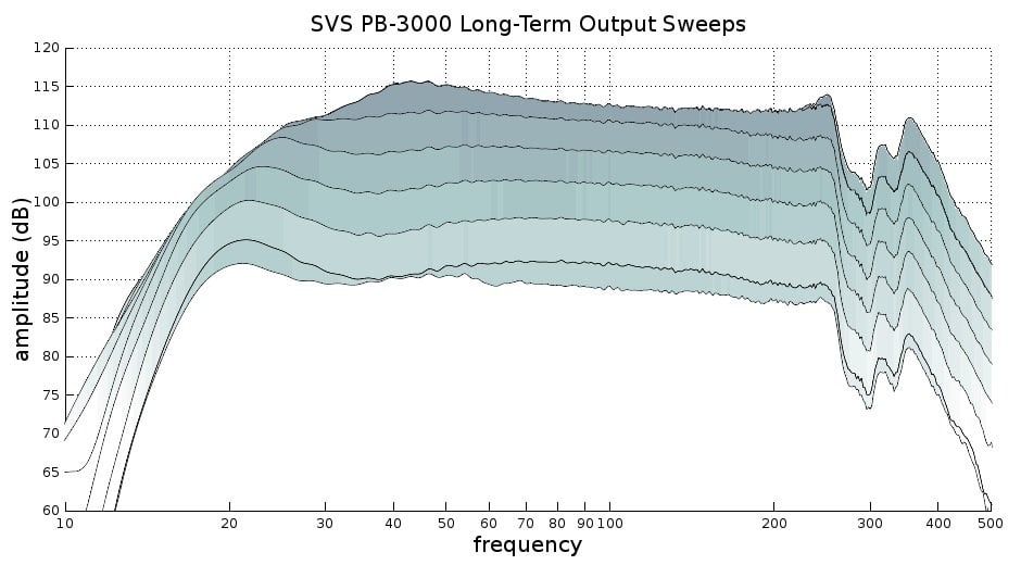

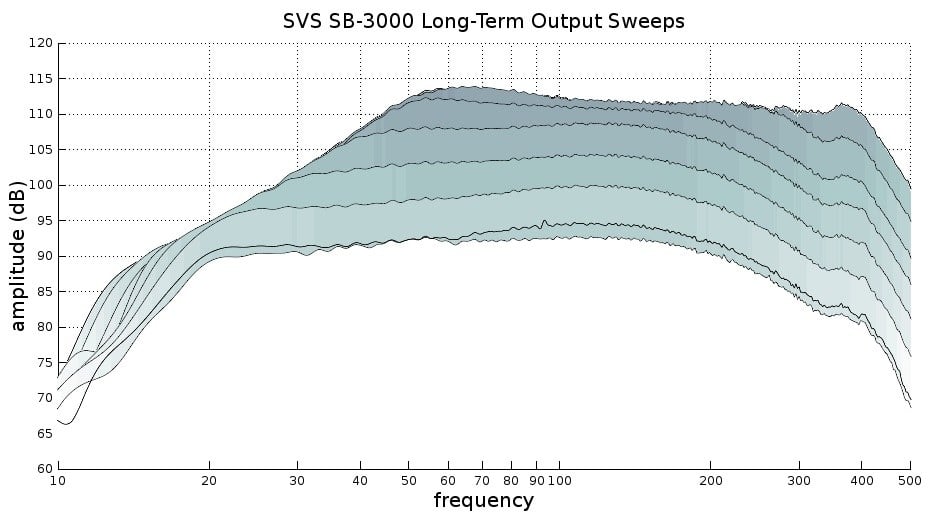

Testing for long-term output compression was done by first conducting a 20-second sweep tone where 50 Hz hit 90 dB with the subwoofer 2 meters from the microphone. We then conducted further 20-second sweeps by raising the gain by 5 dB until no more output could be wrung out of the subwoofer. These tests show us the long-term continuous headroom that the subwoofer is capable of. Both the PB-3000 and SB-3000 have a great deal of headroom in mid-bass frequencies. Again, comparing the PB-3000 to the PB-4000, the PB-3000 gives up very little to its bigger brother except below 30 Hz. Compression around port tuning does put a lower ceiling on deep bass output at higher levels on the PB-3000, but it can still produce over 110 dB continuously at 30 Hz and above, which is a lot of headroom. It even touches 115 dB from 40 to 50 Hz, and that is the range where the lower notes of electronic music hang out, so if you like to give your dubstep tunes some real oomph, the PB-3000 is a sure bet.
The SB-3000 also sports terrific output for music-range bass, although it does compress deep bass above the 95 dB sweep level. The SB-3000’s deep bass headroom is decent from a sealed sub of its size, and it did produce a surprising amount of mid-bass output. For music reproduction, I doubt most people would feel the need for more than one, at least for the purpose of headroom. 110 dB at two meters is fairly loud for bass frequencies, at least for home audio.

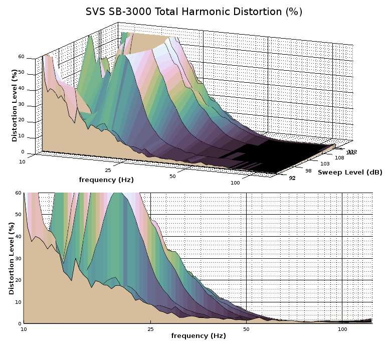

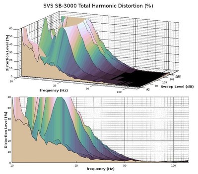

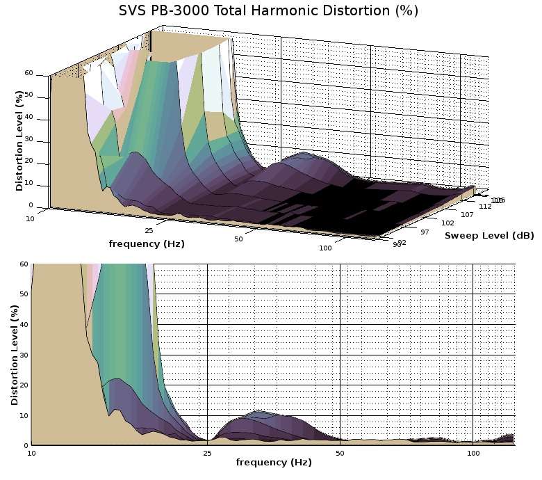

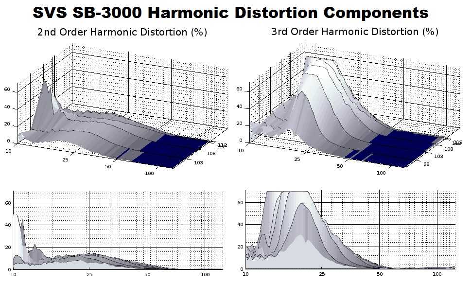

The above graphs show the corresponding total harmonic distortion to the long-term output graphs. Essentially, they depict how linear the subwoofer remains for the corresponding drive level seen in the long-term sweeps. The quantity being measured is how much of the subwoofer’s output is distortion and is shown here as a percentage. Distortion remains very low on the PB-3000 to below 20 Hz. We can see port tuning is almost exactly 20 Hz from the dip in distortion there where the woofer doesn’t undergo much motion. Above that notch, we see a blip centered around 40 Hz that peaks out just above 10% THD, which is unlikely to be audible and only occurs at very high drive levels. At 50 Hz and above, total distortion hovers around 2% at maximum volume, which is vanishingly low. The SB-3000’s distortion levels are low at nominal levels down to 20 Hz, but when it is pushed, distortion will begin to rise on the low-end. Without the assistance of a port, the driver runs into far more stress in deep bass, and we can see the driver being pushed past linear excursion at progressively higher levels below 50 Hz. However, most music content doesn’t dig too much below 50 Hz, especially acoustic recordings, and the SB-3000 can’t be driven into distortion above that region no matter how hard it is cranked. One thing to keep in mind is that while it looks like the SB-3000 is running into major distortion below 30 Hz, its output is also declining, so the large distortion spikes that are seen here occur at much reduced loudness levels. Sub-20 Hz content isn’t really the SB-3000’s wheelhouse, but very few sealed subs are adept in that frequency range, and those that are tend to be much larger.

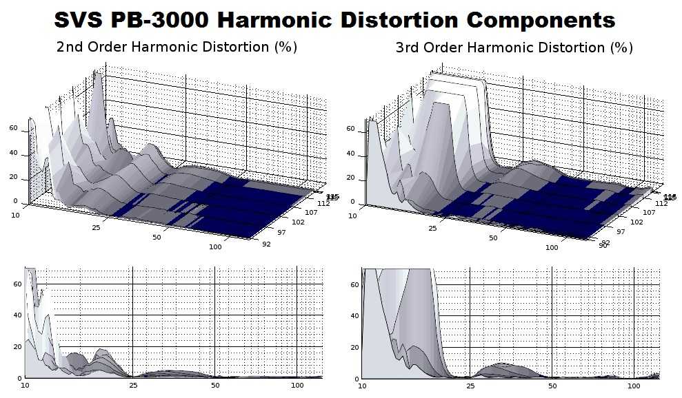

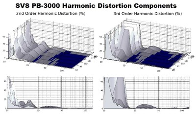

The above graphs depict measurements of the constituent harmonics from the long-term output sweeps and are what the total harmonic distortion measurements are composed of for the 2nd and 3rd harmonics. These individual harmonics can give us a clue as to what might be the cause of some quirk or non-linearity. We are only showing the 2nd and 3rd here because they more or less reflect the higher even-order and odd-order behaviors, although higher-order harmonics are much further down as a percentage of distortion compared to the second and third.
We can see from the harmonic distortion component graphs that the third harmonic is by far the dominant distortion for both the SB-3000 and PB-3000 subwoofers. This shows that the driver has been pretty well balanced so that nothing is restricting a particular direction of travel. One interesting detail that can be seen is an inverse of the second and third harmonics at the port tuning frequency in the PB-3000; this may be because the port is loading the rear side of the woofer more heavily causing a slight imbalance of travel, although it is well below anything that could be picked up by human hearing.

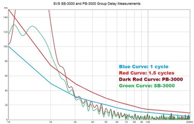

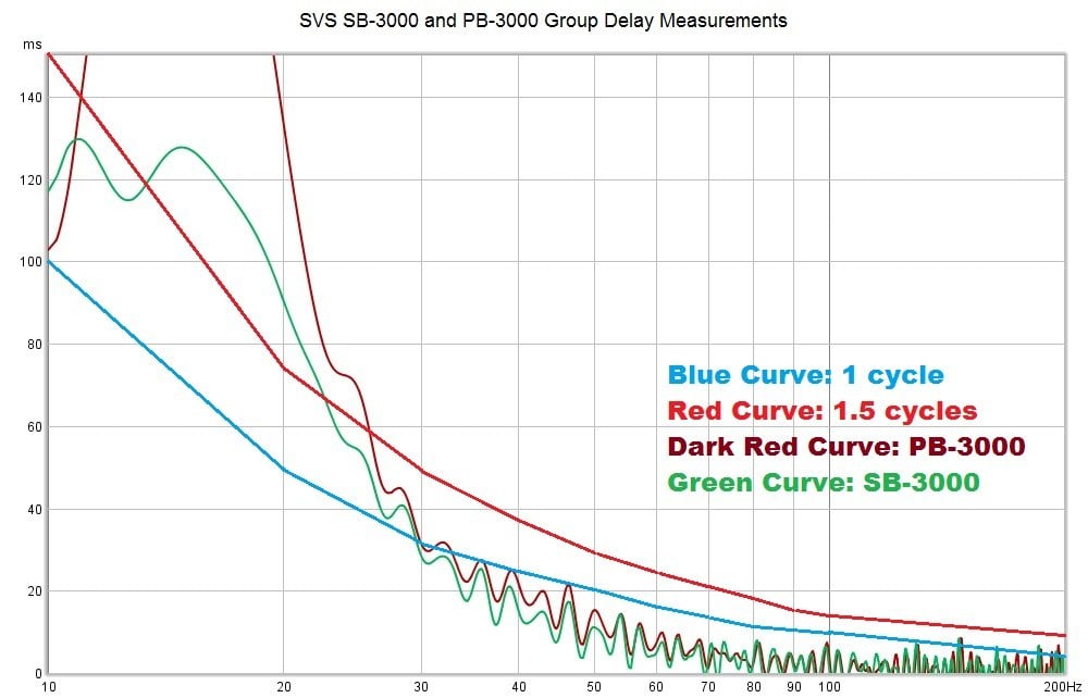

Group delay is the measurement of how much time it takes for individual frequency bands of an input signal to be produced by the speaker. It can indicate that some frequency components are developing slower than others or are taking longer to decay. It is generally thought that 1.5 sound cycles are needed for group delay to be audible at bass frequencies, although there is an argument that group delay should remain under 20 ms to be completely unnoticeable, but that is likely meant for mid and upper bass frequencies. We can see from these measurements that SVS seems to be targeting group delay of less than 1 cycle until very deep bass where larger quantities are permitted but would still likely be inaudible. Below 30 Hz, bass sound becomes too indecipherable for qualities like extra group delay to be audible unless they are massively lagged. One feature we can see is that the SB-3000’s group delay resembles that of a ported subwoofer, and that is due to the high-pass filters that protect the driver from over-excursion. It is relatively high for a sealed subwoofer in the low-end, but that occurs in a region where it wouldn’t be discernible nor is there a lot of output down there anyway. All in all, a good showing in the time domain with nothing of concern.
