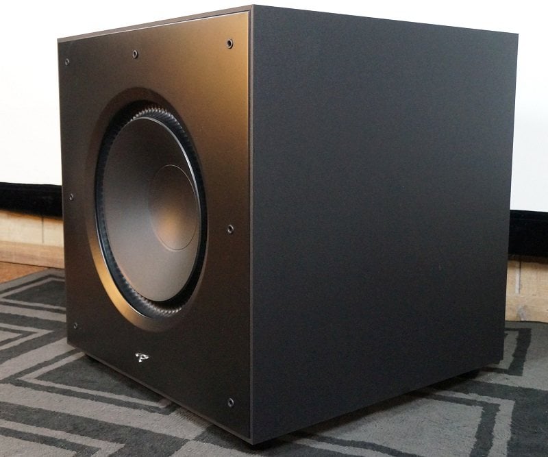

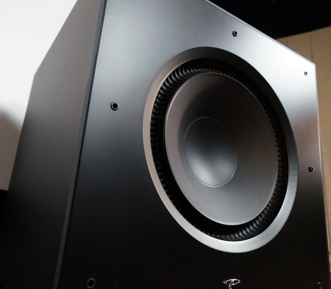

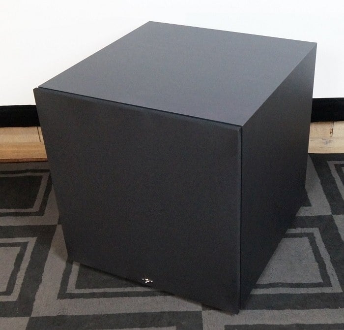

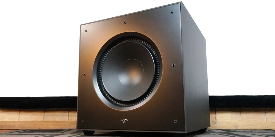

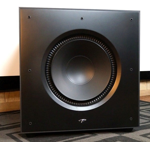

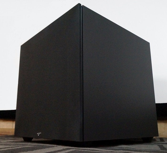

As with the Defiance V12 and X12, the Defiance X15 is a simple cube in shape, but its significantly larger size does leave one with a different aesthetic impression than its smaller siblings. Where the X12 was ‘medium’ sized, the X15 is inarguably large, and its much larger size gives it a certain presence that the 12” Defiance subs just don’t have. Unlike the V12 and X12, the X15 cannot be discreetly tucked away into a corner with hopes that it won’t be noticed, because it is just too big for that. It’s sleek and understated Satin Black finish prevent it from becoming an eyesore, and it is far too visually simple to be considered unattractive, but there is no way for it not to be a significant addition to a typical domestic room. It will join your furniture as a piece of the room, in both footprint and scenery.
The good news is that the X15 looks cool. Its clean and smooth cube shape, slick front baffle finish, and eye-catching cone add up to an artful but reserved aesthetic. With the grille on, it is just a soft-black geometric shape, but without the grille, it is a more interesting sight. The front baffle has an almost metallic sheen that reminds me of brushed aluminum and imparts a sense of weight and solidity. The ribbed surround and inverted dustcap of the cone make it one of the more distinctive and classier-looking woofers in the subwoofer world. It is very modernist: sharp and restrained without being dull. One aspect of its appearance that I would put on my wish list for it is for the grille to use magnetic attachment instead of grille guides so that the front baffle would have an even cleaner look. However, its visual appeal already possesses a lot of simplicity.

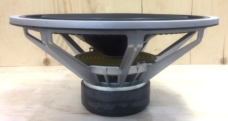

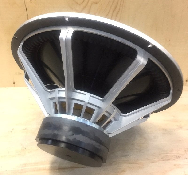

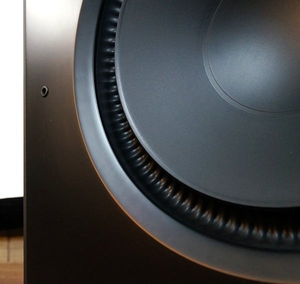

The Defiance X15 driver is much like the Defiance X12 driver, except that it uses a larger diameter cone. The X15 also uses a cast aluminum basket and polypropylene cone, and the motor structure is alike: it uses two 6” diameter, 1” thick magnets. One key difference about the size is that a 15” driver has a much easier time achieving a lower resonant frequency than a 12” driver since there is more room for a larger spider (the spider is the part of the suspension that attaches the voice coil former to the basket). The smaller the spider, the tighter the suspension, and that raises the resonant frequency, so it’s easier to get a loudspeaker driver to play lower frequencies when the spider does not have as much tension. The greater mass of the 15” cone is surely a significant factor here as well.
As with the X12, the X15 uses an inverted ART surround. To quote from the X12 review:
“ART is the name Paradigm has given to their patented surround design that uses a pleated ‘ribbing’ over the length of the surround; it is an acronym which stands for Active Ridge Technology. Supposedly, ART allows for more headroom than conventional half-roll designs. When typical surrounds are stretched at high excursions, particularly in the inward-stroke, deformations can occur from the high tension, and these deformations can cause distortion or even tears in the surround. This ridged surround design by Paradigm supposedly reduces these deformations by directing material stress to points that can better cope with it due to the shape of the surround. Paradigm claims that ART allows 1.5 times the excursion for the same surround roll that results in a 3 dB increase in headroom.”

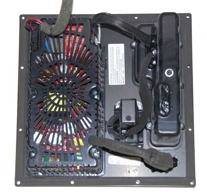

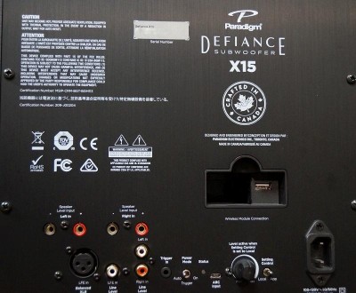

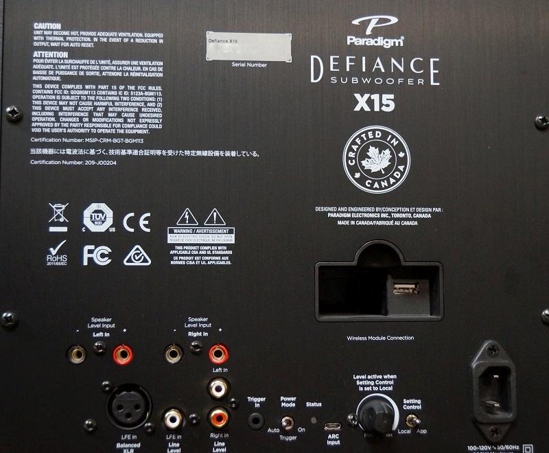

The X15 uses a 900-watt class-D amplifier with a whole slew of inputs that can accommodate a wide range of setups. It has left, right, and LFE RCA inputs, an XLR input, left and right speaker-level inputs, and it also has a slot for an onboard wireless receiver (the receiver/transmitter is sold separately). The only physical control it has is a volume knob, and all other adjustments are done through the Paradigm Subwoofer Control app.

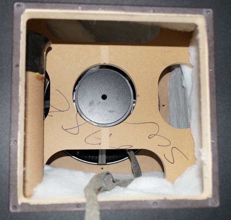

The Defiance X15 uses a
pretty hefty enclosure that constitutes the bulk of its 92 lbs. Side panels and front baffle are made from 1” thick MDF, and there is also a heavy-duty window brace in the cabinet mid-point. There is a generous amount of poly-fiber stuffing lining the sidewalls. The port is 16” long and 4” diameter and is flared on both ends. That may give the X15 a slightly deeper tuning frequency than the X12, which also a 4” diameter port but was only 14” long. One interesting thing we see is that, like the X12, the interior sidewalls of the X15 has a coating of some kind, and this can help the MDF from absorbing moisture from the atmosphere which can alter MDF’s shape and density. The feet are made from a tall plastic base that has a rubber contact with the floor, but Paradigm also provides some optional metal spikes for those who don’t want the rubber to cause streaks or impressions on carpeted surfaces. One thing to note is that the cabinet has pretty hard edges, and this makes for sharp corners. This is a sub that you do not want to fall down against one of its corners. It could leave a nasty gash, and that is something to think about for those looking at an X15 for a household with rambunctious children or someone particularly clumsy.
The overall design suggests a subwoofer that should be very powerful but does give up infrasonic output to achieve loud levels in more audible ranges. That isn’t a bad trade to make providing it can catch most of the deep bass in movie and music content, and we will see if that is the case in our listening and test measurements. The X15’s main competitors are manufacturer-direct brands, which tend to have tuning frequencies below 20 Hz. However, the sensations of sub-20 Hz frequencies tend to be subtle unless it is very high in SPL, and I have seen many people overstate the impact of this frequency range. Paradigm has decided it is more sensible to provide impact where it can be more easily felt rather than lose punch for some ill-defined rumble that is hardly audible. Now, let’s see how well this strategy works in practice by listening to some music and movies…

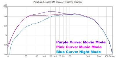

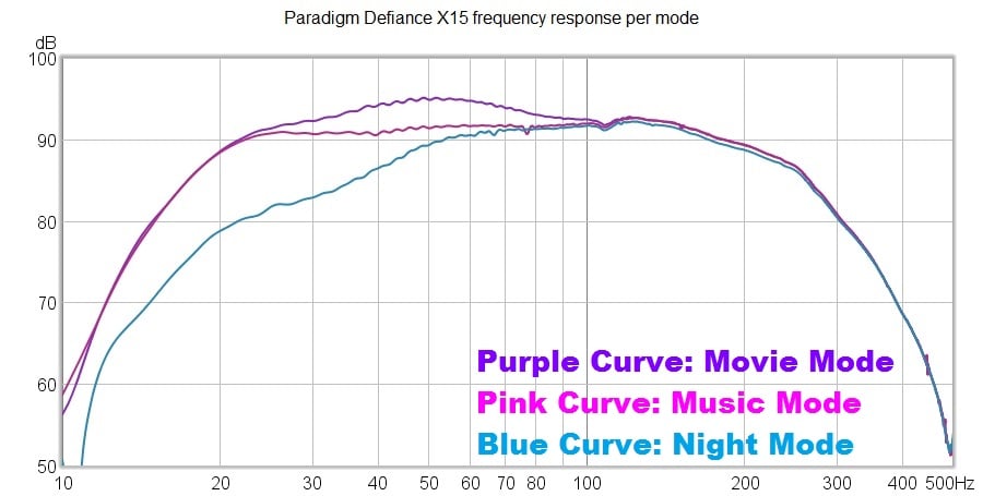

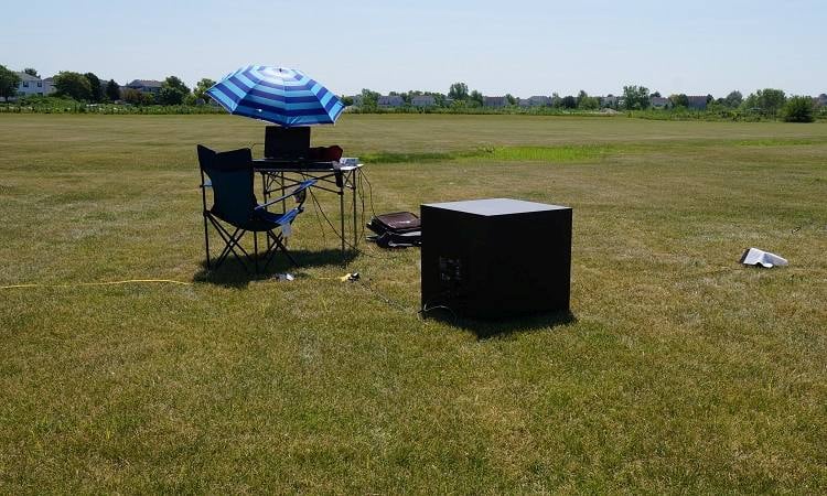

The Paradigm Defiance X15 was tested using ground plane measurements with the microphone at a 2-meter distance in an open setting with well over 100 feet from the nearest large structure. The subs were tested with woofer facing the microphone. The subwoofer’s gain was set to maximum, phase was set to 0, and the low pass filter was left off. The weather was recorded at 75°F and 50% humidity.
The above graph depicts the frequency responses for the Defiance X15 subwoofer for its available modes. Nothing here is new to readers who remember the response shapes on our review of the Defiance V12 and X12. Music Mode has the most neutral response, where Movie Mode has more of a lift centered around 40 Hz. The rise around 40 Hz might help to bring out a bit more oomph in action movies since so much effects content uses that range. Night Mode filters out a lot of the deep bass, which is a good idea for those who want to be considerate to others nearby when using the sub. Deeper frequencies travel further and are less inhibited by obstructions like walls and flooring, so it’s better to just turn that range down rather than turning the sub volume down altogether. Night Mode also does not permit the sub to get louder past a certain point, so it keeps the volume at a tame level no matter what signal is passed on to it. In Music Mode, the X15 is impressively neutral from 25 Hz to 100 Hz with barely a decibel of variation. Paradigm’s specified window of +/-3dB from 18 Hz to 230 Hz is accurate! They could have used +/-1.5dB from 22 Hz to 180 Hz if they wanted a tighter window. I do like to see that upper-frequency extension above 100 Hz for those who want to use a higher crossover frequency than the traditional 80 Hz. A solid response in this upper bass range also means that the sub will play more predictably with the bass management’s filters.

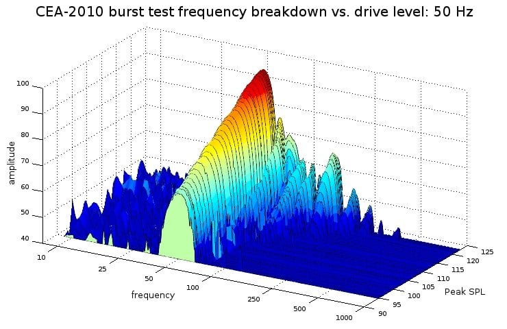

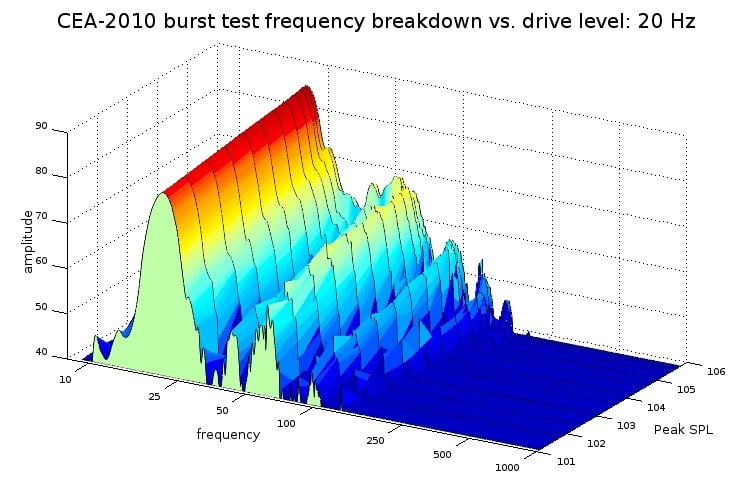

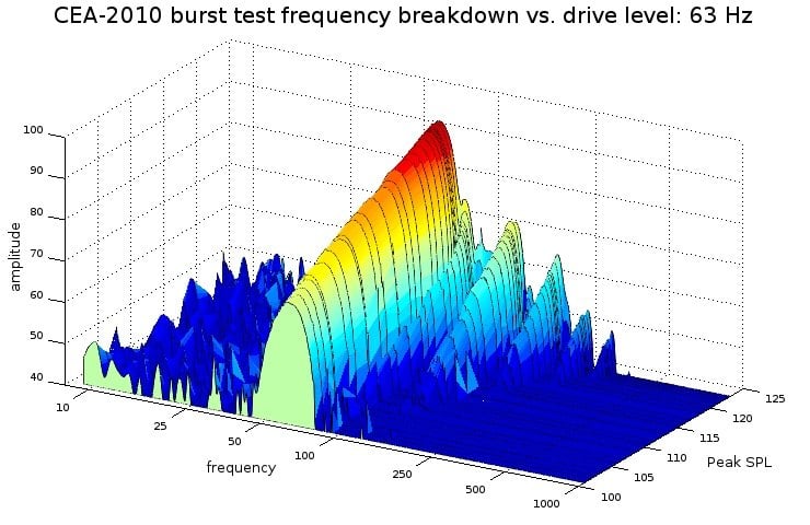

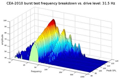

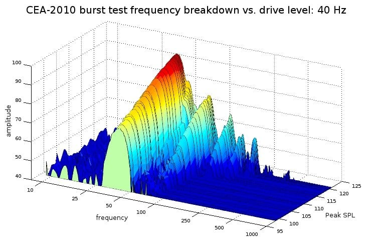

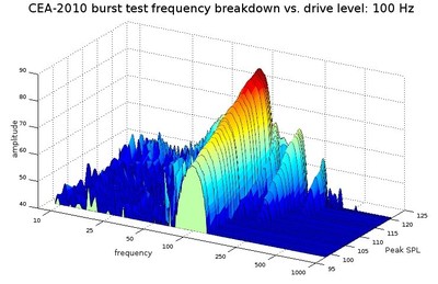

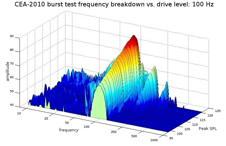

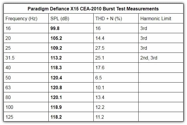

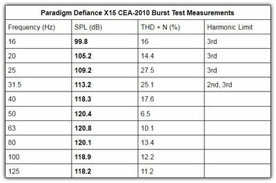

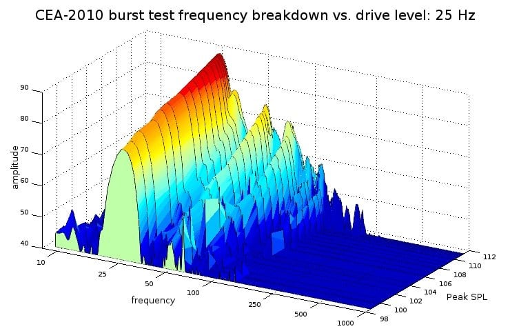

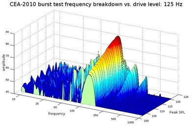

The above CEA-2010 measurements are short-term bursts that show the subwoofer’s clean peak SPL before heavy distortion sets in. Our measurements have been referenced to 2-meter RMS, which is 9 dB down from the standard requirement for the measurements to be shown at 1-meter peak. However most publicly available CEA-2010 measurements are shown at 2-meter RMS, so we followed that convention. The Defiance X15 has very respectable deep bass performance, but its mid-bass burst output is just beastly and has the highest numbers among subs that I have reviewed personally. The X15 punches at 120 dB from 50 Hz to 80 Hz and manages 118 dB at 40 Hz and 100 Hz. That is a tremendous amount of output, and it is no wonder that it could hit so hard in drums and percussion. This is a sub with good deep bass performance for movies but outstanding mid-bass performance for music. If you like your music loud and are looking for something that can keep up with a powerful speaker set, take a long look at the Defiance X15. 120 dB is the kind of output you can feel like a punch in the chest.

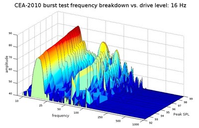

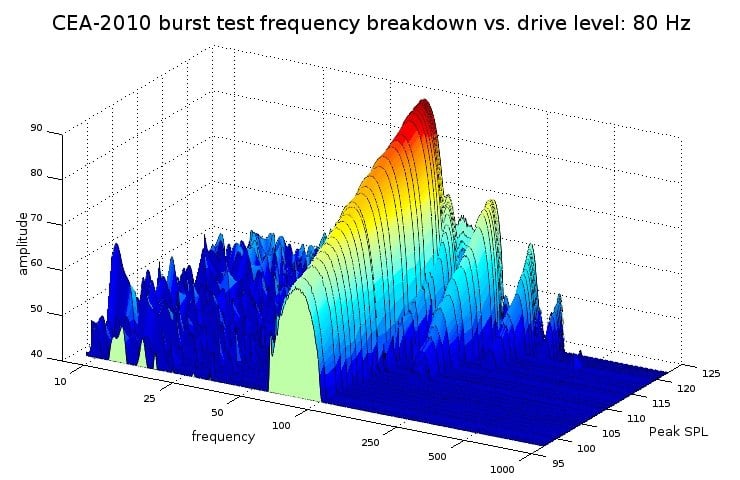

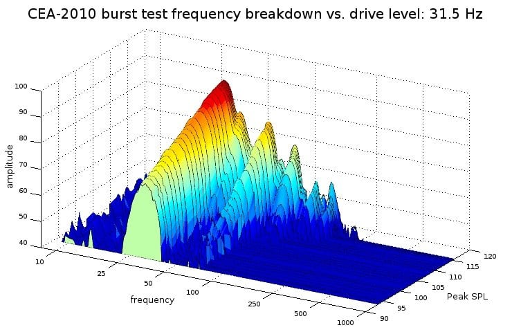

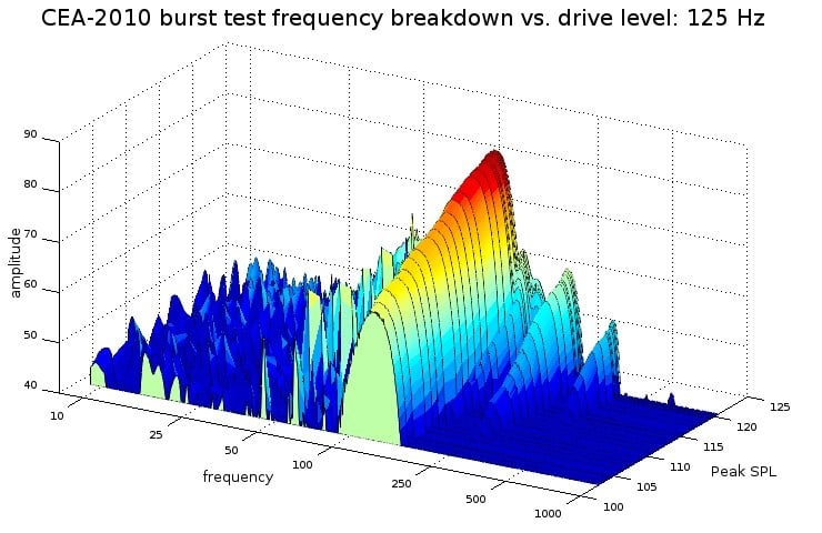

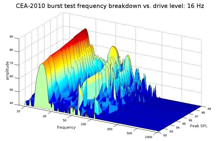

Frequency Breakdown of CEA-2010 Burst Measurements for the Paradigm Defiance X15
The above graphs show the measured frequency spectrum of the increasing CEA-2010 burst tests. Essentially, they depict the behavior of the subwoofer reproducing short burst tones at successively louder levels, with each test tone raised by boosting the input gain by 1 dB until no more output was to be had from the subwoofer. The frequency marked above the graphs note the fundamental tone being tested, and this can also usually (but not always) be discerned in the graph by the horizontal axis frequency point of the “main ridge,” the highest levels on the vertical axis. The noise below the fundamental (that random spikiness to the left of the main ridge) should be ignored. What should be looked at are the smaller ridges to the right of the fundamental; these are the distortion products of the fundamental, and it is here where we see how cleanly the subwoofer handles a given output level. These are mostly harmonics: whole number multiples of the fundamental. More information about the meaning of the data in these graphs can be read in our article on Understanding Subwoofer Review Distortion Measurements.
From these graphs, it can be seen that while the third harmonic was the tripping point for the lower frequency CEA-2010 measurements, it is still outweighed by the second harmonic in nearly every instance. However, even though the second harmonic exists in higher quantities, it may still be much less audible than the third harmonic for two reasons. One reason is that the second harmonic lies precisely at an octave above the fundamental, and many sounds, especially musical instruments, have a similar harmonic structure, so this distortion, if it could be heard at all, may well sound like a natural part of the timbre of an instrument or sonic event. Another reason is that higher frequencies are much more easily masked by lower and frequencies, especially when the upper frequency is close in range to the lower frequency sound, and the second harmonic is much closer to the fundamental test tone than the third harmonic. More information about the audibility of distortion in bass frequencies can be read in our article on The Audibility of Distortion At Bass Frequencies. The most important takeaway from the above graphs is the large difference between the fundamental and distortion products at nominal levels. Distortion does creep up with the sub is approaching its maximum output limits, but at somewhat lower drive levels, distortion products are totally insignificant. And keep in mind that “somewhat lower drive levels” for the Defiance X15 is still very high output compared to many other subs. Halving a 120 dB amplitude level is still 114 dB, which is very loud, and at that level, distortion products are completely inconsequential.

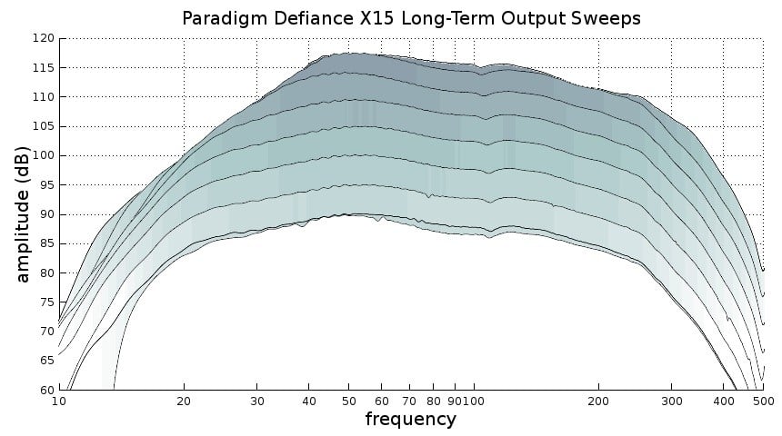

Testing for long-term output compression was done by first conducting a 20-second sweep tone where 50 Hz hit 90 dB with the subwoofer 2 meters from the microphone. We then conduct further 20-second sweeps by raising the gain by 5 dB until no more output could be wrung out of the subwoofer. These tests show us the long-term continuous headroom that the subwoofer is capable of. In the graph for the Defiance X15, we can see the excursion limits of the sub at lower frequencies are not able to keep up with mid-bass frequencies as the drive level is raised. The shape of the compression suggests a limiter to keep the sub from being overdriven. Indeed, I pushed the sub as hard as it could be run, but I was never able to compel it to bottom out or make any other signs of distress. It is bulletproof, and such strong protection means that it knows when to stop pushing the cone. Mid-bass frequencies are not governed as much by excursion, and the X15’s light cone and powerful 900-watt amp give it an enormous quantity of mid-bass headroom. The output at 40 Hz and above is about what one would expect from an 18” woofer rather than a 15” woofer.

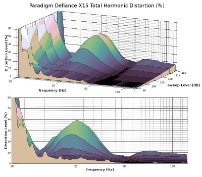

Paradigm Defiance X15 Total Harmonic Distortion per output level

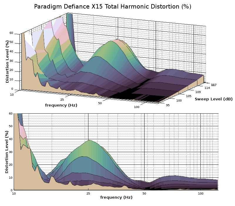

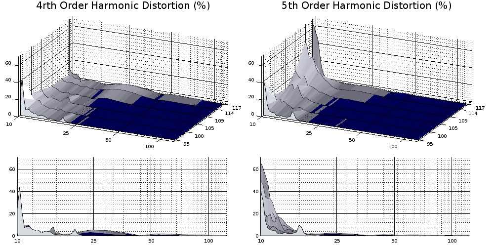

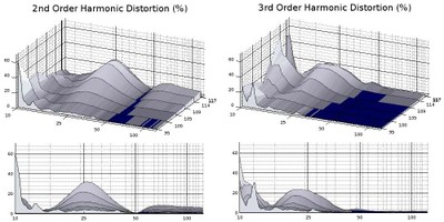

The above graphs show the corresponding total harmonic distortion to the long-term output graphs. Essentially, they depict how linear the subwoofer remains for the corresponding drive level seen in the long-term sweeps. The quantity being measured is how much of the subwoofer’s output is distortion and is shown here as a percentage. We can see that at the highest drive level the Defiance X15 can be pushed into significant distortion quantities centered around 25 Hz in deep bass. It doesn’t have the highest excursion woofer, so that is not surprising. However, a higher excursion woofer would likely not be as capable in mid-bass output. Below that high-level 25 Hz distortion hump, we can see that a high-pass filter is keeping the driver under control and is not permitting much excursion, so distortion is quite low. At nominal levels, distortion is very low, in fact, the jaggedness that can be seen in the lowest sweep level here is from background noise, not the sub itself. At 100 dB and below, the X15 does not reach 10% THD until well under 20 Hz. Mid-bass frequencies are the X15’s strength; above 40 Hz it is barely able to pierce 10% THD even at 115 dB.

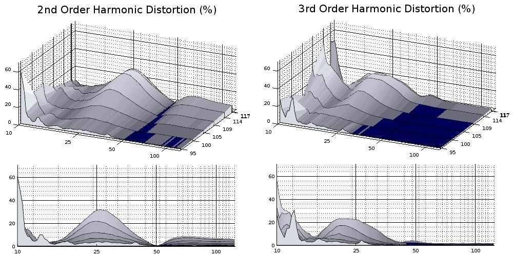

Component Harmonics of the Defiance X15
The above graphs depict measurements of the constituent harmonics from the long-term output sweeps and are what the total harmonic distortion measurements are composed of for the 2nd through 5th harmonics. These individual harmonics can give us a clue as to what might be the cause of some quirk or non-linearity. One thing we can see from the above graphs is that harmonic distortion is comprised almost entirely from 2nd and 3rd harmonics. This is good because the higher harmonics are more audible, and these are the two lowest harmonics. The second harmonic is the largest contributor to distortion, so most of the harmonic distortion of the X15 is comprised of the least audible type. For those interested in music applications, there is very little distortion in music ranges, i.e., 40 Hz and above, and it’s almost entirely 2nd order, so it would be totally inaudible. Distortion does pick up in the 20 Hz range though, and it may not make as much of a difference there to most users since that range is mostly used for effects noises for movie and television sound mixes. If a very loud explosion or an avalanche sound does have some 2nd order distortion, it’s unlikely that the listener would be able to make the distinction.

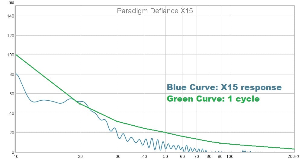

Paradigm Defiance X15 group delay
Group delay is the measurement of how much time it takes for individual frequency bands of an input signal to be produced by the speaker. It can indicate that some frequency components are developing slower than others or are taking longer to decay. It is generally thought that 1.5 sound cycles are needed for group delay to be audible at bass frequencies, although there is an argument that group delay should remain under 20 ms to be completely unnoticeable, but that is likely meant for mid and upper bass frequencies. By even the most conservative standards of audibility, the Defiance X15 doesn’t approach anything even remotely audible in the time domain. By the point that group delay does rise above 20 ms, it is below 30 Hz where it is beyond human ability to discern. Much like the Defiance V12 and X12 that we reviewed, this is excellent performance, some of the best I have seen for a ported subwoofer. There is no overhang or sloppy bass from the X15, and this lack of lagging energy helps explain why percussion sounds were as punchy as I had experienced. The X15 does not allow bass to linger.

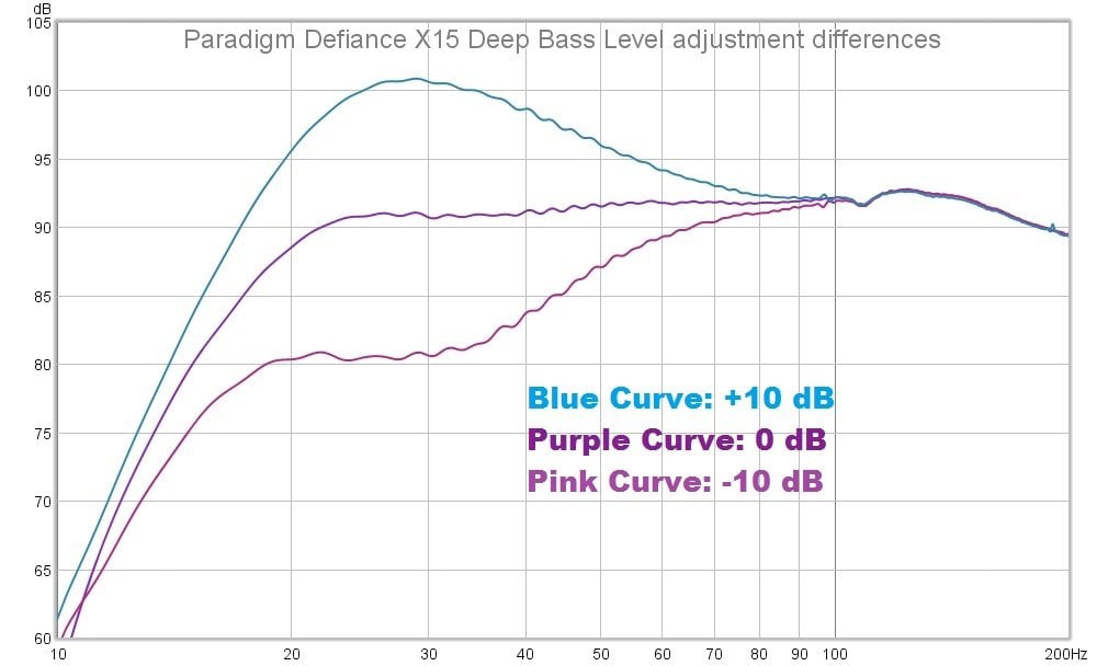

Effects of the ‘Deep Bass Level’ Control settings on the Defiance X15
One of the controls on the Defiance’s subwoofer control app is called the ‘Deep Bass Level,’ and the above graph shows the effects of the extremes of that setting so the range and shape change on the response can be seen. As its name implies, it adjusts the level of deep bass output on the Defiance subwoofers by 1 dB increments out to a +10 dB or -10 dB range. This can be handy for toning down bass in rooms that get a lot of room gain and can consequently end up with a bloated sound from too much deep bass gain. It can also be handy for those who want to spruce up the low-frequency effects sounds on movie night or just like the sound and feel of heavier deep bass. The frequency band most affected by this change lay between 20 Hz and 40 Hz.
