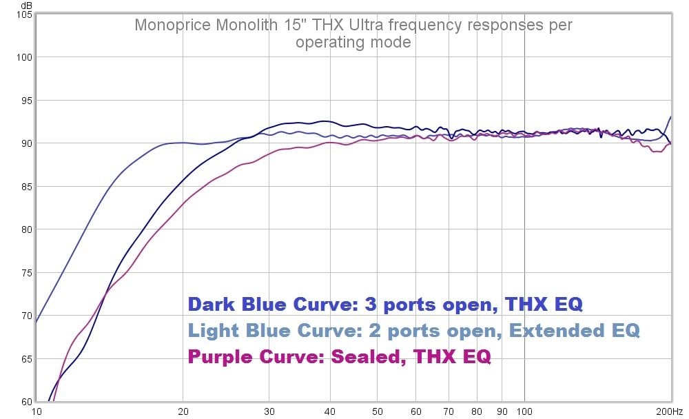

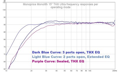

  • Frequency Response (-6dB) Extended EQ Sealed: 15-200Hz
  • Frequency Response (-6dB) Extended EQ Vented (1 port): 14-200Hz
  • Frequency Response (-6dB) Extended EQ Vented (2 ports): 16-200Hz
  • Frequency Response (-6dB) THX EQ Sealed: 23-200Hz
  • Frequency Response (-6dB) THX EQ Vented (1 port): 19-200Hz
  • Frequency Response (-6dB) THX EQ Vented (2 ports): 20-200Hz

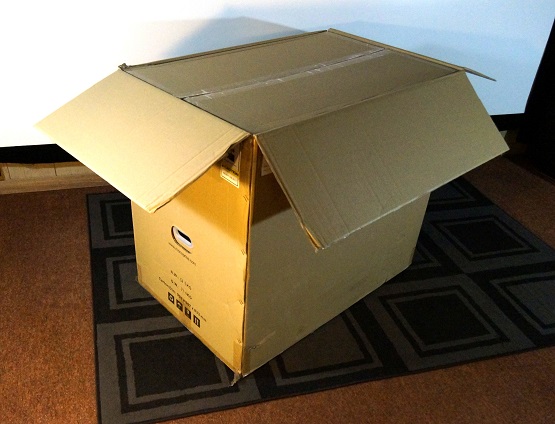

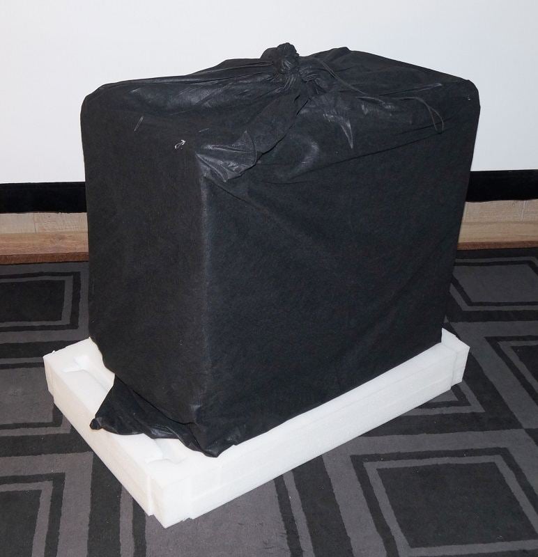

A subwoofer as heavy-duty as the Monolith 15” THX Ultra is going to need some very serious packing to keep it safe in transit. Monoprice provides such packing; they are double-boxed with sturdy grade of cardboard, and both boxes have built-in handles There are large foam blocks capping the top and bottom of the sub and edge-protecting foam pieces to safeguard the side edges. The subwoofer itself is wrapped in a nice drawstring black-cotton bag to protect it against moisture and scuffs. Monoprice has also included two white cotton gloves to handle the 15” THX Ultra, which is nice but a bit overkill, since it doesn’t have the kind of finish that would easily show fingerprints.

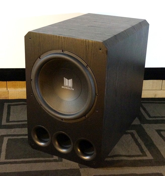

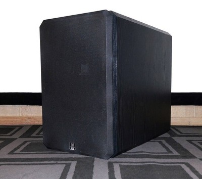

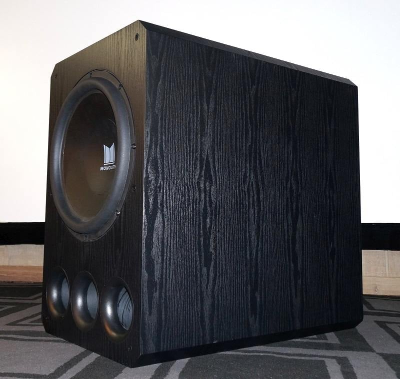

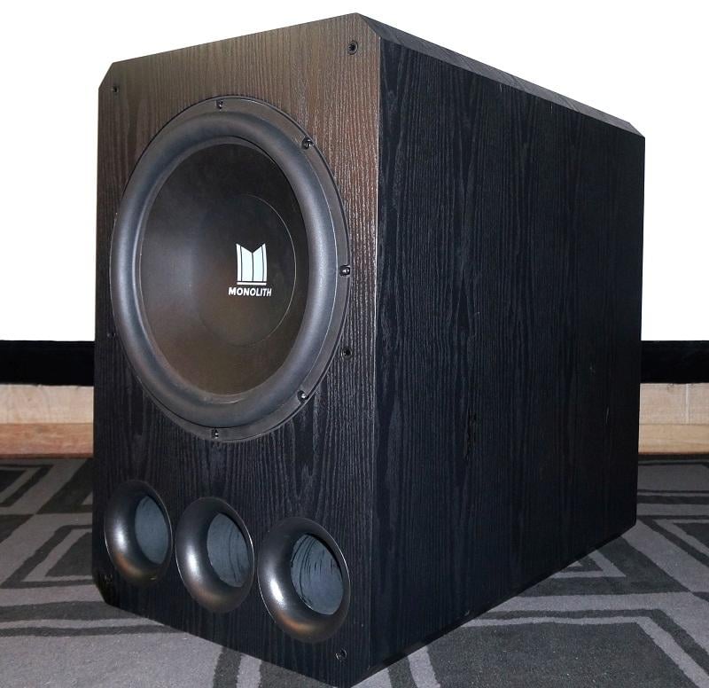

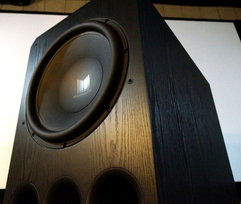

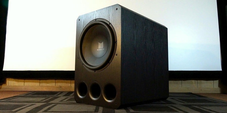

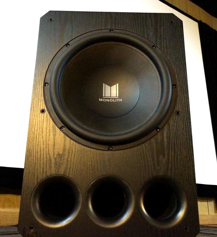

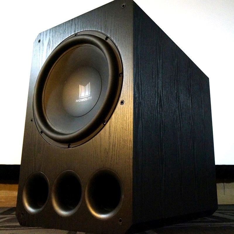

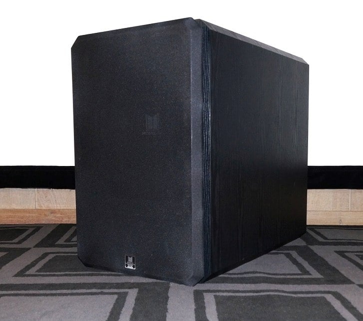

Once out of the drawstring bag, the Monolith 15” THX Ultra reveals itself to be a formidable-looking piece of audio equipment. First of all, it’s big; it is one of the largest single driver 15” subwoofers on the market. Ported subwoofers striving for strong deep-bass output must be physically large by necessity, but they can take a wide range of shapes and aren’t as restricted in that regard. The Monolith 15” THX Ultra has exchanged width for height and is nearly 27” tall. This was a good idea so that it could fit in more locations since height does not increase the footprint of the subwoofer, but it does make it look visually imposing. In fact, the Monolith 15” THX Ultra, more than any other product from the Monolith series, really lives up to its name; it looks monolithic (dictionary definition of Monolith: a singular, massive object).
The Monolith 15” THX U15 upper2.jpgltra is finished in a nice black oak finish, but it isn’t a high-end or luxurious finish. The black oak gives it more personality than plain matte black though. The cabinet is essentially a large block with the lengthwise edges sheared off in a hard bevel. As I said in the review of the Monolith 10” and 12” THX subs, this gives it an almost “muscle car” aesthetic. The beveled edges make it look brawny; rounded edges would have perhaps softened its look and simple square edges would have looked a bit ‘Ikea’ minimalist. Without the grille, this subwoofer is daunting, since that 15” woofer and those three ports look ready for the business of big bass. With the grille on, the Monolith 15” becomes more subdued, but it is still such a big object that, as a big, black, faceless cabinet, it is still a bit intimidating. This is not a unit that will make for a natural fit in every living room. It should not present a problem in a dedicated home theater room, but I can see how some household inhabitants might be put off by its inclusion in a more common living space.

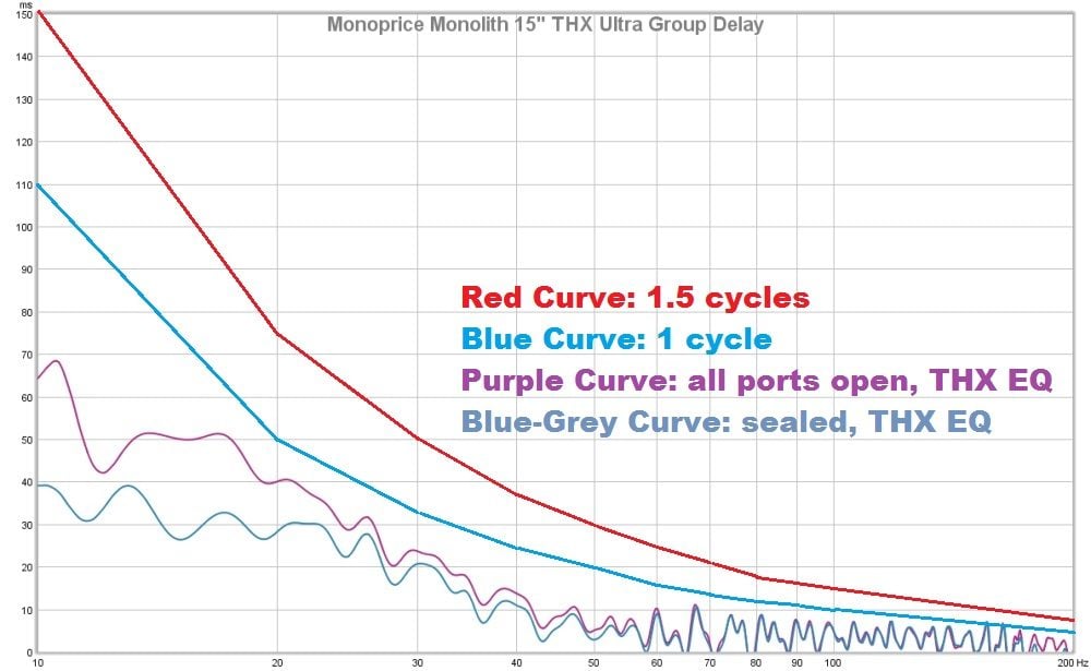

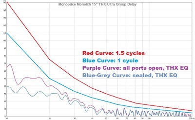

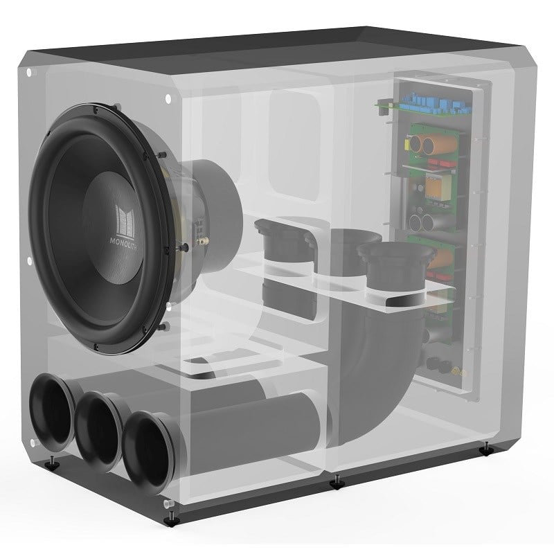

The Monoprice Monolith 15” THX Ultra is a large, variable-tuned, THX-certified subwoofer. For those who don’t know, let’s briefly go over the meaning of these descriptive phrases. “Variable-tuned” means that the subwoofer can be made to change how low in frequency that the sub is able to play by sealing one of its ports. The trade-off for extending the ability to play deeper frequencies is that there will not be quite as much headroom in deep bass frequencies overall. In most variable-tuned subwoofers, the difference is usually a subtle one but still audible and can change the experience of the content. Typically, the difference can be experienced in movies that has significant deep frequency content; the deeper bass can make the scene a bit more immersive. According to Monoprice’s specifications of the different tuning configuration responses, the -6dB point between the ported modes can be switched from 20 Hz to 14 Hz. That might not seem like a lot, but, physically speaking, that is a very substantial difference: over a half-octave, and a 40% greater amount of air displacement.

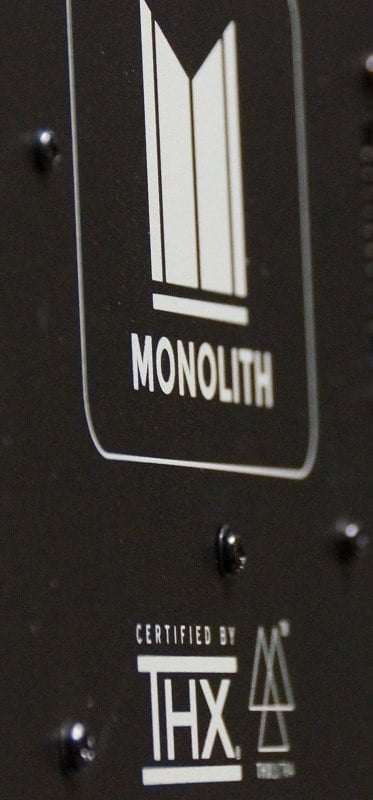

“THX-certified” means that t15 THX logo.jpghis product has been certified by THX Ltd. to meet a minimum standard of quality and behavior that it can be used in a THX environment. That is a bit of a tautology, so let’s expand on what a “THX environment” is a bit further. Here is an aspect of THX certification that is still so widely misunderstood. Many people hold the impression that THX certification for subwoofers and loudspeakers is a performance standard which goes something like: “speaker/subwoofer X is able to achieve a certain SPL level with low distortion.”  That’s true, but there is a lot more to THX certification than that. Yes, a THX certified product has to meet some minimum performance metrics for whatever level of certification it is qualifying for, but THX is more about maintaining control over the reproduction of the content from the mixing stage to the end user’s experience. Maintaining low distortion for a given SPL level in the playback stage is just one part of that. What THX is striving for is that the end user should hear what the production engineers and artists intend for them to hear. They are trying to make it so that whatever is done in the production will have a predictable effect in end use consumption. So the THX badge should be regarded as insurance that, in the right environment and correctly set up, the system will deliver what the artist intends.
The Monolith 15” THX Ultra holds THX’s “Ultra” performance class certification, which means it should be able to help to present a THX experience in a 3,000 cubic foot room with a 12’ viewing distance from the screen. That is a big space to fill, and the laws of physics dictate that a large sub is needed for that task (or at least a whole lot of small subs). The 15” THX Ultra is such a behemoth that, at a glance, it does look like it might be up to the task, but the THX certification is verified proof, so no guessing is needed. However, the 15” THX Ultra is only certified for that level of performance in one of its operating modes: all ports open and EQ switch set to “THX.” It isn’t that other operating modes will perform significantly worse, it’s just that they don’t have very specific behavior needed to act totally predictable by the THX controlling processor otherwise.

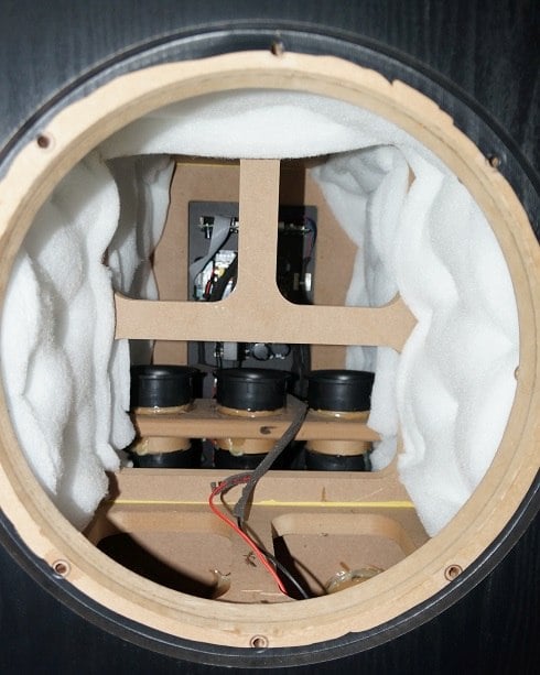

To start the discussion of the components that make up the 15” THX Ultra, we will begin by talking about the massive cabinet.  The Monolith subs use high-density fiberboard (HDF) as opposed to medium-density fiberboard that is the standard for speakers and subs at this price point. Monoprice choose HDF because they claim it makes for a more sonically inert cabinet. The front baffle is 2” thick with the other panels being 1” thick. There is one 1” thick window brace at the midsection of the cabinet, and two perpendicular braces, one of which helps to support the ports. The cabinet walls are lined with stuffing for the sake of damping and isothermal conversion (which helps to effectively make the enclosure volume behave larger than it really is). The 15” THX Ultra uses three 3.5” ports that need to be so long that they make a right turn within the cabinet. This is necessary because long ports are needed for extremely deep bass tuning frequencies, at least if the deep bass is to have loudness on parity with the output produced by the driver directly. This is a large cabinet, and it has to be. As we mentioned before, ported subwoofers that are attempting serious deep bass output must be large by the laws of physics.

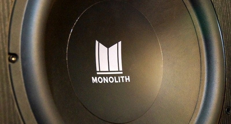

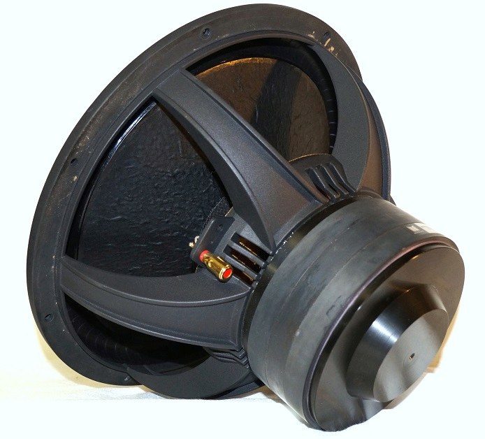

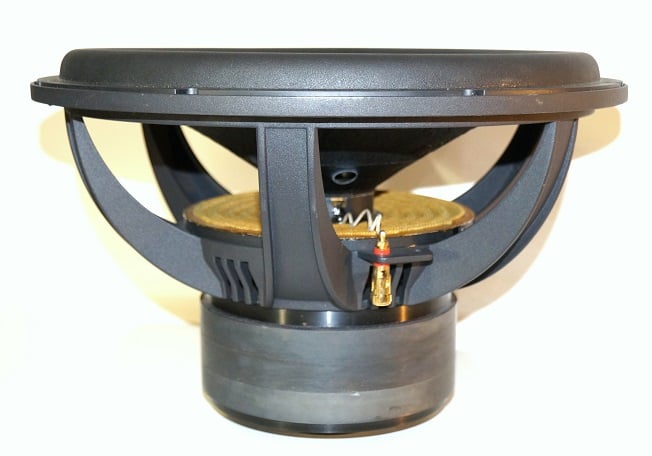

In order to reproduce the bass frequency spectrum in a linear manner, the driver has to be a solid design, and the 15” THX Ultra driver displays unmistakable signs of being such a driver. The cone is a paper/fiber glass composite that combines low weight with very high rigidity. A large rubber surround affixes the cone to a very stout-looking cast-aluminum basket. Monoprice claims that the surround was made from a type of Nitrile Rubber that was formulated after months of modeling for optimal performance. An 8” Nomex spider serves as the other half of the suspension for the moving mass of the driver. The motor system is quite beefy: the permanent magnet is composed of a stack of three 7” diameter, ¾” thick plates. Venting is done through slots underneath the spider. The motor uses two aluminum shorting rings to reduce induction effects thereby lowering even-order harmonic distortion. The backplate is bumped out to allow for larger excursion. All in all, this is an impressive-looking driver that is certainly plausibly believable of being the central engine of a THX Ultra-certified bass system.

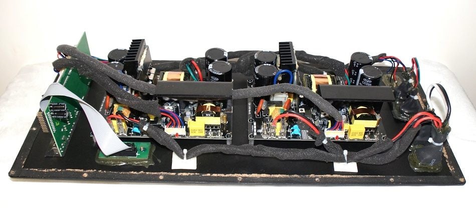

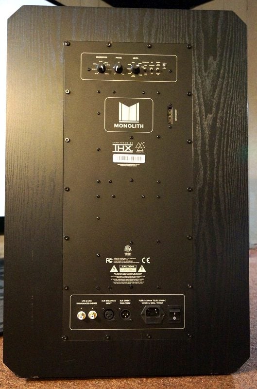

15 amp plate.jpgOf course, a driver can do nothing without current, and Monoprice has supplied the driver with a brute of an amplifier that is specified for 1 kilowatt RMS output. The 15” THX Ultra amplifier looks to be using two of the same class-D modules used in the 10” and 12” Monolith subs in a bridged configuration. Two modules have the added benefit of two power supplies working in unison with the differential amplifier outputs to yield 2X the power, which would ordinarily require a much larger power supply in a single amp configuration. Other than the obvious power doubling, the amplifier now has more energy storage and improved low frequency stability. The amp has fairly basic controls, but there is an EQ switch that can adjust it for the THX mode or the lower extension mode when a port is plugged. There is also a variable phase knob which gives the sub a bit more flexibility when dialing it into a sound system. Connectivity includes a pair of RCA inputs and an XLR input and output. The XLR output can be handy for those who want to run multiple subs without turning the wiring into a spaghetti tangle of cabling, since they can simply daisy-chain subwoofers on a single run of cable. Balanced cabling like XLR do a better job of rejecting noise, and XLR connectors are a much more secure connection than traditional unbalanced connectors as well.
At this point, I do want to voice one small complaint about the design of this subwoofer. This subwoofer is using the same feet as the SVS PB-4000, and, as I noted in that review, they were simply too short to safely be set down when carried with fingers on the bottom of the sub. It can problematic, especially for those with dense carpeting, in that it creates a pinch-point. Like I suggested to SVS, I would encourage Monoprice to look at taller feet that allows for more clearance for fingers.

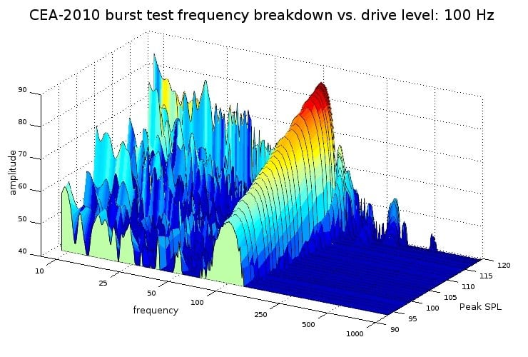

...the Monolith 15” THX remains clean no matter how hard it is pushed.
The best placement for a single sub in my room gives me a relatively flat response for an un-EQ’d single subwoofer, with a window of +/- 4 dB from 25 Hz to 100 Hz with no broad dips in important ranges. This location trades low-end room gain for a relatively flat response, a worthwhile trade for my tastes. The receiver used was a Pioneer Elite SC-55 with a handful of different speakers, and the crossover was used mostly at 80 Hz. Since room acoustics have a huge effect on low frequencies, the way this sub sounds in my room at my listening position is not necessarily going to be the way it sounds anywhere else for anyone else, so readers would do well to keep that in mind, and not just for the subwoofer in this review, but for any subwoofer in any review. Most listening was done with one port sealed in the ‘Extended Mode’ configuration.
