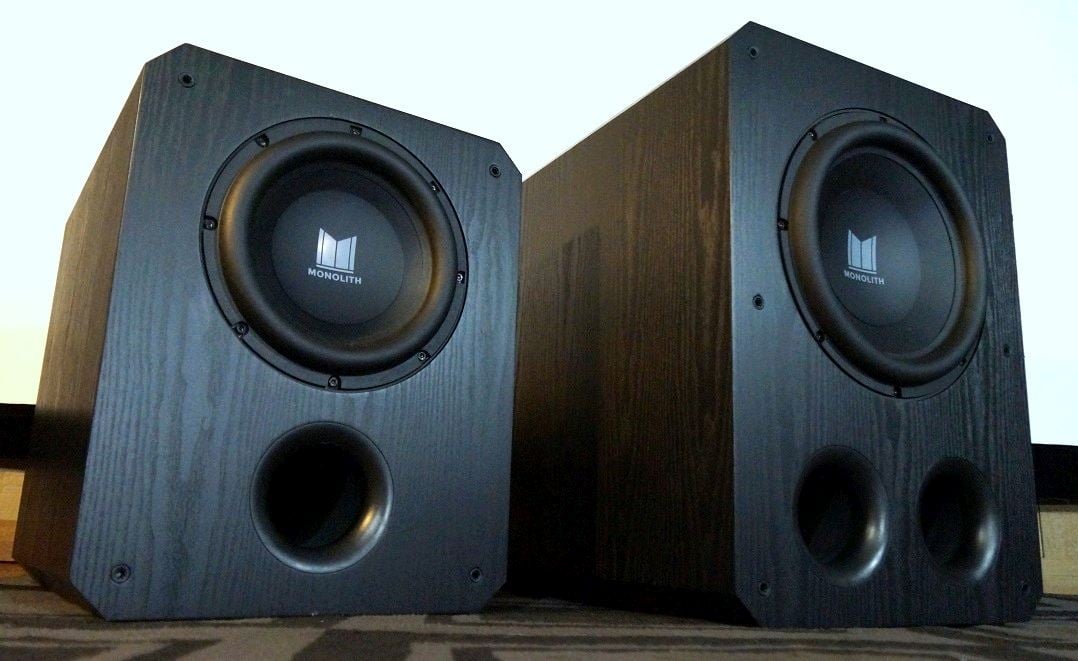

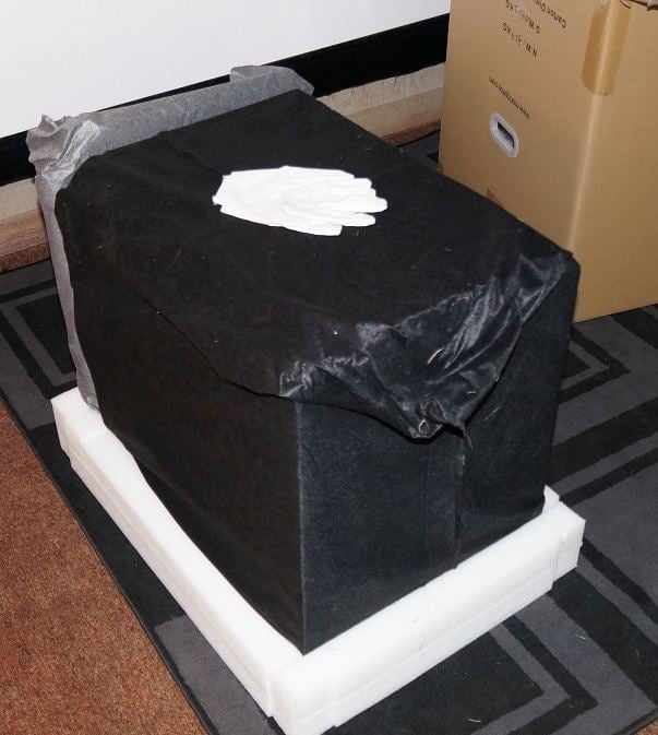

Packing and First Appearance

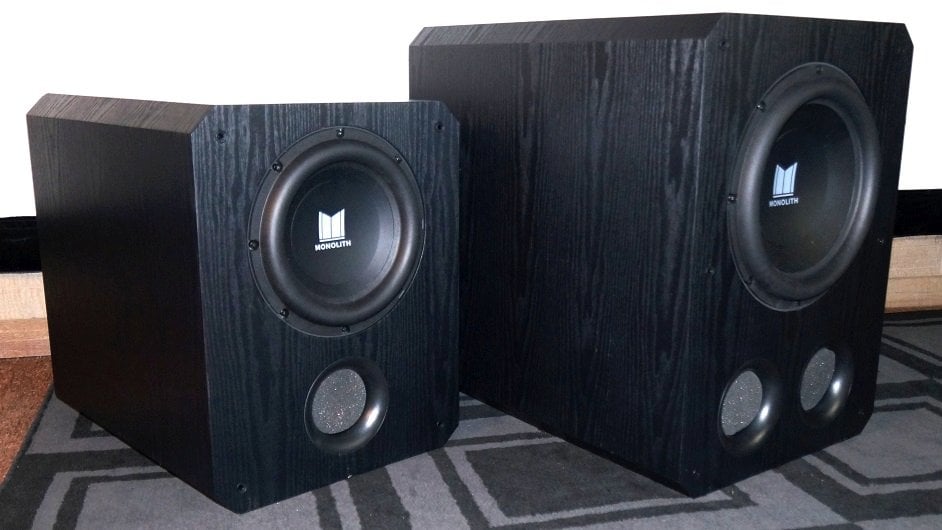

The 10” THX Select and 12” THX Ultra both arrived in large and hefty boxes. Each subwoofer was double boxed with thick polyethylene packing foam blocks protecting the top and bottom of the subs. The subwoofers themselves were covered in a black cotton sack that opened by a drawstring. The cotton sack looks like it would do well in protecting the subwoofers from scuffs and moisture. Enclosed with the subs were white cotton gloves for handling the subwoofers without getting fingerprints on the finish. The gloves are a neat touch, but the fact is that the finish isn’t a glossy kind that fingerprints would be very visible, so I regard the gloves as an unnecessary addition (but not unwelcome). The drawstring bag and gloves do impart the aura that this product is a high-end purchase, and I think their inclusion is as much about presentation as they are about safely protecting the products during shipment. Overall the packing is excellent considering the price, but it also needed to be very good, since these subs are quite heavy for their size.

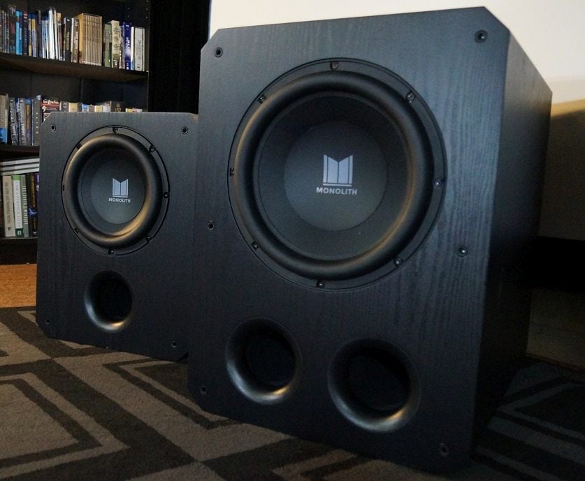

The unpacking process revealed a pair of very robust looking subwoofers. The no-nonsense black ash finish, sharply beveled edges, and beefy woofers give these subs a muscular look, almost reminiscent of a muscle car from the late 60’s. The black-ash vinyl finish is not fancy, but it does the trick and makes the sub look more like piece of furniture than a plain box. The beveled edges assist in this regard and lend the subs more personality. The large, front-firing port and woofer make no apologies for the function of these particular units: they produce bass. These elements of the subwoofer can be hidden with the included grille, but, to me, grilles always rob speakers of their personality. With grille, the subwoofer becomes just a drab black box aside from a small Monolith insignia on the bottom of the grille. Without grille, the beefy-looking woofer is exposed. The woofer has a reassuringly large surround, and the cone has a simple concave shape with a smooth matte black texture and a Monolith logo printed in the center. Beneath the woofer is a large port (or dual ports on the 12” THX Ultra) that looks like it means business. Overall, the Monolith THX subs are not without style, but that style is essentially praising the function of the unit rather than trying to hide it as with so many subwoofer designs.
Design Overview
The first phras
e that comes to mind when trying to explain the design of the Monolith THX subs is “sheer mass.” As mentioned before, these are heavy subwoofers relative to their size. For their cone size, these are easily the heaviest 10” and 12” subwoofers I have had to deal with, at nearly 73 lbs. and 99 lbs. respectively. The 10” THX Select has the weight one would normally expect from a heavy-duty 12” and the 12” THX Ultra has the weight one would normally expect from a stout 15” subwoofer. The weight is mostly a consequence of their enclosure construction, so let’s begin our design overview discussion by describing their cabinets.
Both Monolith subwoofer cabinets are made from high-density fiberboard (HDF) as opposed to the usual medium-density fiberboard (MDF) that most subwoofer cabinets are made from. This is a tougher, heavier, and more durable material, and Monoprice claims it is more sonically inert than medium-density fiberboard (however, some argue that HDF is less absorptive so therefore acoustically inferior to MDF). All paneling on the Monolith THX subs use 1” thick high-density fiberboard except for the front baffle which is 1.5” thick. There are two pieces of 1” thick HDF bracing inside both subwoofers: a vertical window brace and a horizontal piece that holds the ports in place. The grille uses a beefy 1” thick MDF frame for a soft fabric covering and is held on the front baffle by some sturdy pegs. The feet are some small cones with a rubbery covering. The rubbery texture should protect hard floors against scratching from the pointed end of the broadly spiked feet. As heavy as these subwoofers are, you don’t want to drag them across the floor, since the rubber will leave a streak.

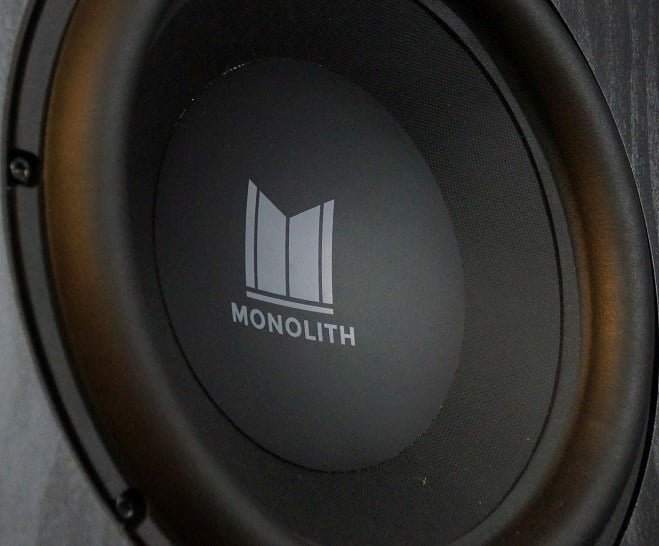

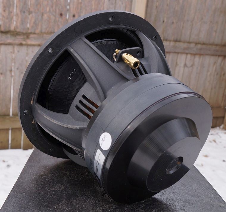

The drivers for both subwoofers share many similarities despite the different cone sizes. Both use a similar motor: two stacked 7” diameter, ¾” thick magnets, 2.5” diameter voice coil, 6.5” spider. That makes for a very brawny motor, especially for a 10” woofer of this price point. The baskets use a sturdy-looking cast aluminum design. Venting is strategically located
on the basket beneath the spider for optimal cooling to the voice coil and also to thwart air compression under the spider so that its linear motion is less inhibited. The back plates are bumped out to allow for a generous amount of throw without bottoming. The drivers for both subwoofers use dual aluminum shorting rings for reduced even-order harmonic distortion. The cone is composed of fiberglass and long fiber pulp, which combined, takes advantage of, “the pulp's superior stiffness with the additional rigidity and lightweight properties of fiberglass, to deliver a driver of massive durability and excursion,” to quote from the monolith product pages. The suspension is composed of the aforementioned 6.5” Nomex spider and a large 1” nitrile rubber surround and looks like it would permit a substantially long excursion.
Monoprice claims 18mm of Xmax for both drivers (Xmax is essentially how far the cone can move in one direction from its rest position in a controlled manner). 18mm is a lot of linear excursion for a 12” or especially a 10” woofer. Monoprice also claims that they both have nearly 80mm or peak-to-peak Xmech, or, to put that in other words, about three inches of excursion that these drivers have in both directions. That is a tremendous amount of throw, and the drivers will have a lot of room to safely play in before they could reach their mechanical limits.

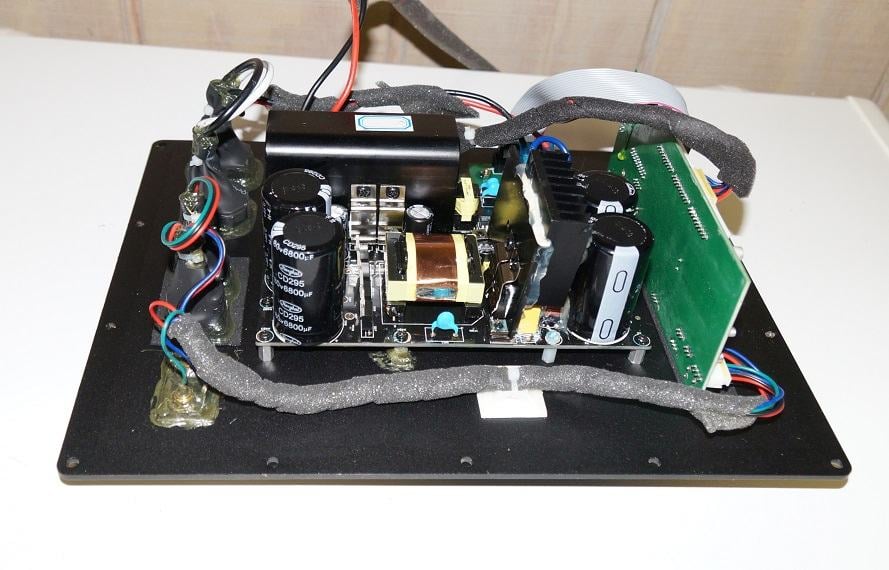

Both the 10” THX Select and 1

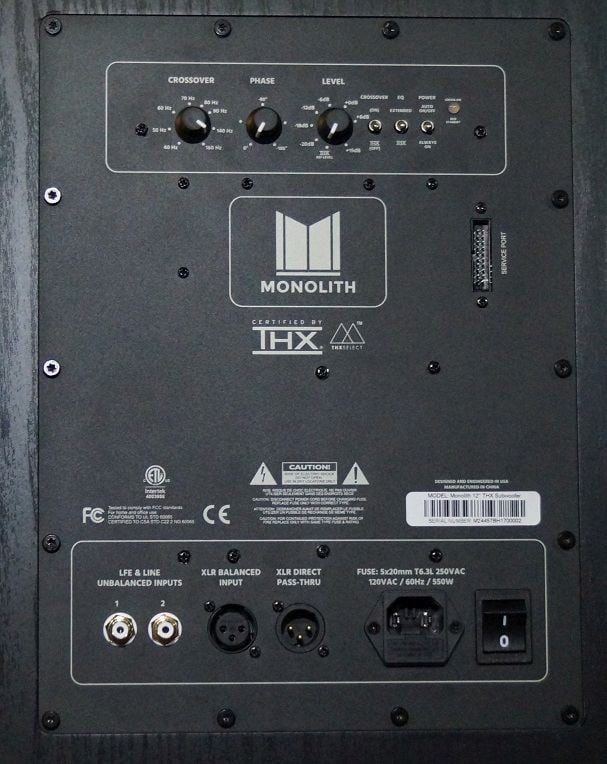

2” THX Ultra use the same 500-watt RMS Class D amplifier. The only difference between them are the internal DSP settings. The amps have dual RCA inputs, and an XLR input and output. Aside from the standard gain knob, crossover switch, and crossover frequency knob, the controls feature a variable phase knob and an EQ switch. The EQ switch can change the mode from either a THX-certified setting or an ‘extended’ mode that permits deeper frequency extension. Examining the inside of the amplifier, we see four hefty capacitors and a DC transformer, along with a heatsink and what looks to be a heatshield that could possibly function also as an EMI shield. To my untrained eye, the build quality looks good: clean, heavy-duty components, with a logical layout. An amplifier with this build quality and feature set strikes me as very good for this price point, especially for the $500 10” THX Select.

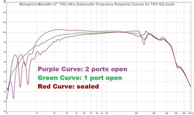

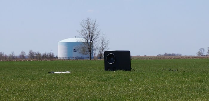

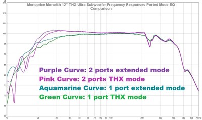

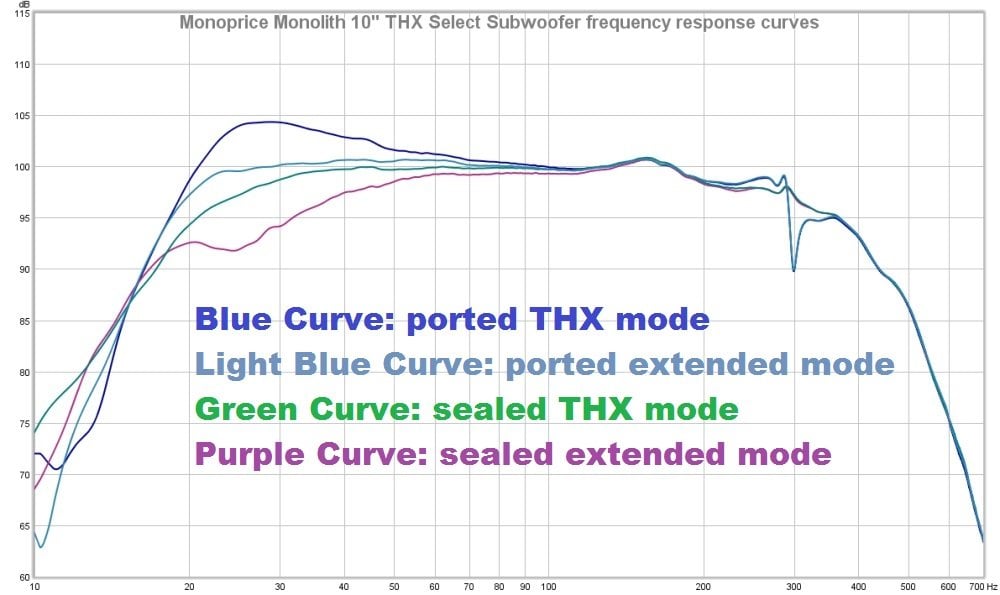

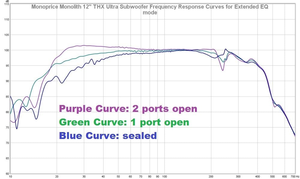

The 10” THX Select and 12” THX Ultra was tested using ground plane measurements with microphone at a 2-meter distance in an open setting with at least 200 feet from the nearest large structure. The sub was tested with woofer and port side facing the microphone. The subwoofer’s gain was set to maximum, phase was set to 0, and the low pass filter was left off. Weather was recorded at 81°F and 35% humidity.

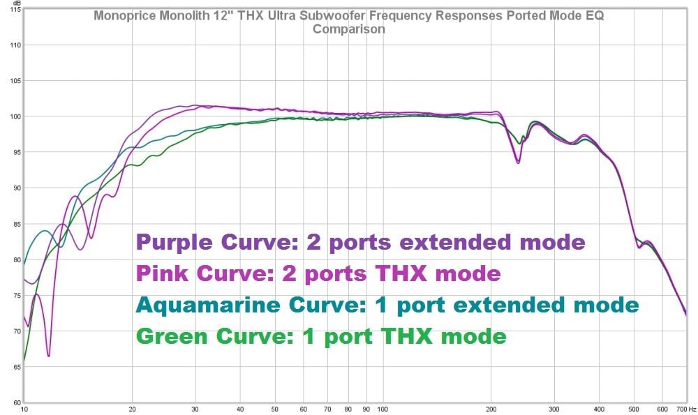

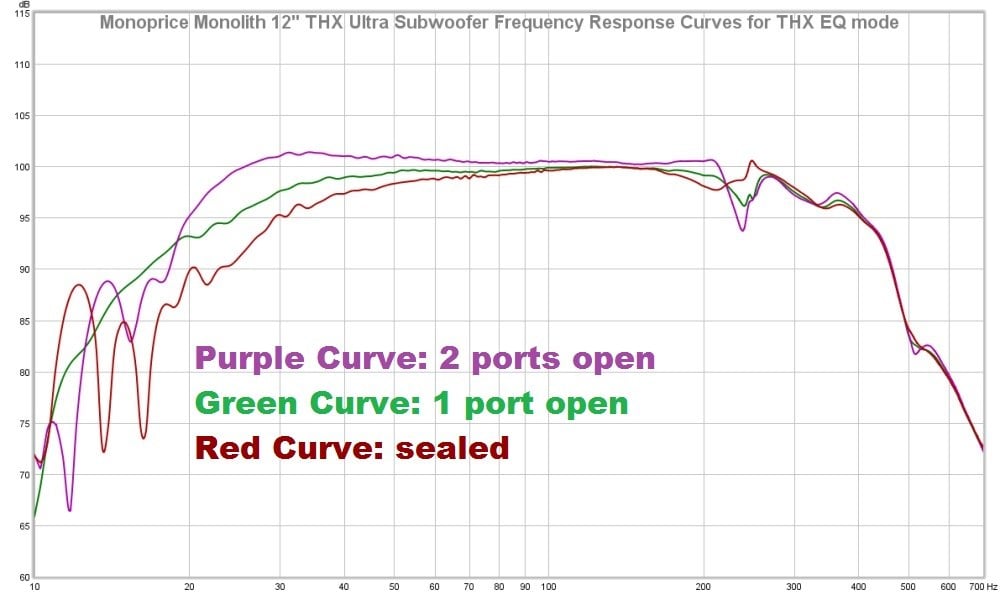

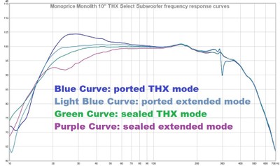

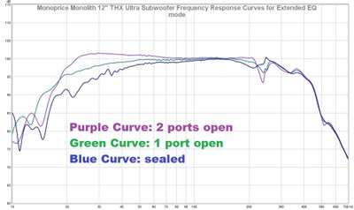

Frequency responses for various configurations of the Monolith THX subwoofers
The above graphs are the base frequency responses for combinations of ported/sealed modes and the EQ switch. Each graph depicts how the EQ switch affects the response for that operating mode of the Monolith THX subwoofers. Any combination of EQ and port configuration yields a very flat response on these subs, with both ports open yielding the most output and one port open producing more output at deeper frequencies. Sealed mode rolls the sub off at a higher frequency but shallower slope. The rockiness in the response at the low end of the graphs for the 12” THX Ultra is not the behavior of the subwoofer itself, it is from environmental noises leaking into the microphone that were not able to be filtered; the subwoofer’s actual response is very smooth. In their ported modes, these subs all have a picture-perfect response from 30 Hz to 200 Hz with usable output all the way up to 400 Hz. Above 400 Hz they all roll off sharply. This subwoofer could easily be used with a 200 Hz crossover point if desired by the user.
The difference between the THX EQ and Extended EQ isn’t huge but it is notable, amounting to a few more dB in the low end in Extended EQ. The difference between port configurations is much more substantial, of course, exchanging output from 20 Hz to 50 Hz for extension below 20 Hz. Sealing the ports throws away a lot of deep bass output, but it might be useful in smaller rooms that incur a lot of low-frequency gain in order to avoid overly boosted deep bass.

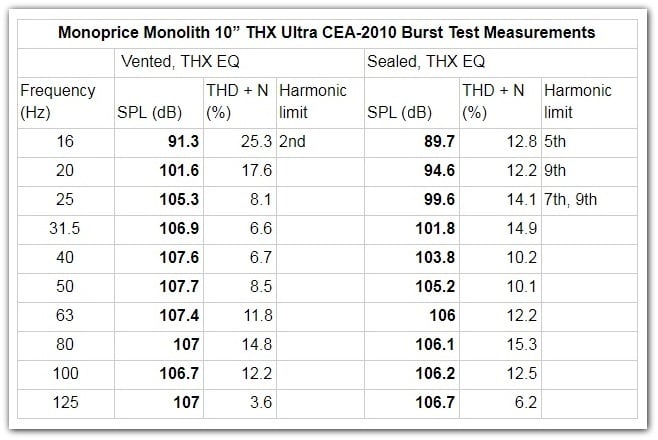

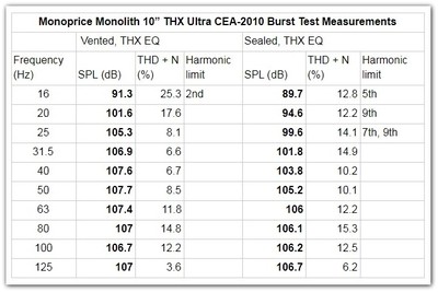

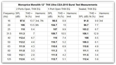

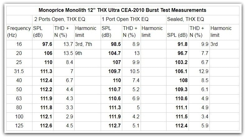

The above CEA-2010 measurements are short-term bursts that show the subwoofer’s clean peak SPL before heavy distortion sets in. Our measurements have been referenced to 2-meter RMS, which is 9 dB down from the standard requirement for the measurements to be shown at 1 meter peak. However most publicly available CEA-2010 measurements are shown at 2-meter RMS, so we followed that convention.
All CEA-2010 measurements shown here were with the Monolith subwoofers used in the THX EQ mode. The subwoofers were also tested in Extended EQ mode, but the differences between the EQ modes were very slight. Extended EQ and THX EQ did not seem to make much difference in this type of testing. The measurements are all quite good for both subs. Both exhibit excellent linearity even when pushed to the edge of their performance as they are in this testing. Their response shape barely changes from nominal levels, and the distortion is mostly very low. Their behavior does not change much regardless of how hard they are being pushed in both linear and nonlinear domains.
The Monolith 10” THX Select does not have a huge amount of midbass output, and that is likely due to the heavier moving mass of the cone and voice coil, but that is a necessary trade-off towards achieving the superb deep bass performance that it produces for its size and price. Its midbass output is commensurate with its deep bass output, whereas most subs at this pricing will have substantially more midbass output than deep bass. Clean, deep bass is more difficult to pull off, and that is what is so impressive about these measurements. The 12” THX Ultra has nearly twice as much headroom across the board than the 10” THX Select, and that is not surprising given the larger driver and enclosure size. As we saw in our review of the Outlaw Audio Ultra-X13, THX Ultra certification of the 12” THX Ultra subwoofer seems to demand total harmonic distortion not be much more than 5% from 30 Hz and above. It looks like the THX Select certification may be a bit more relaxed regarding distortion based on these measurements of the 10” THX Select. It should also be said that the day of testing had a slightly higher noise floor than usual, so if anything, our THD numbers are slightly higher than normal, but we feel comfortable posting these measurements since a lower noise floor wouldn’t have changed the results by a tremendous degree.
It should be noted that the measurements for the sealed operating mode are quite good. Those who are debating whether to get a ported subwoofer or sealed subwoofer have a good example of either with these Monolith subwoofers. The tremendous linear throw of the drivers and powerful amplifier insures good performance with or without the ports. Ports do give them a hefty advantage in deep bass headroom, so that is what I would recommend for most users who purchase either sub.

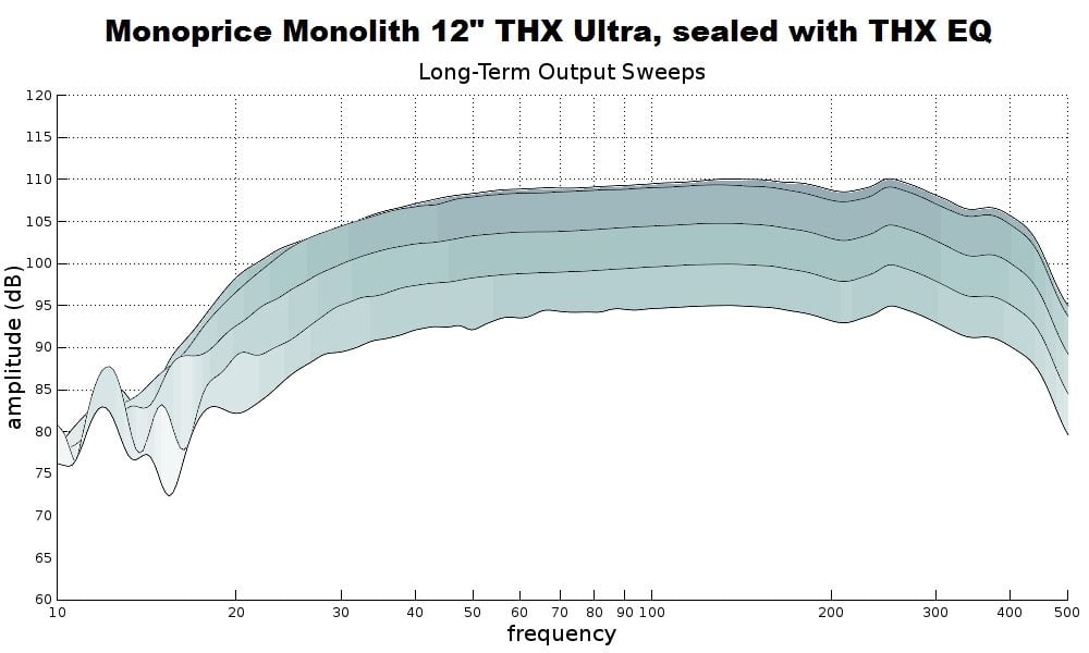

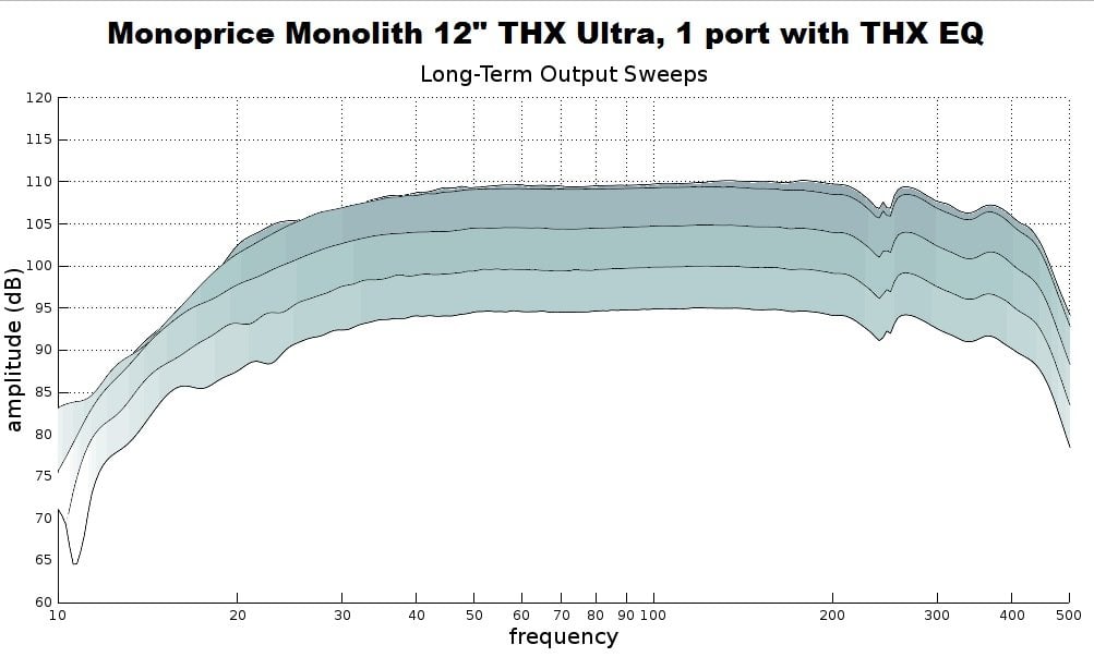

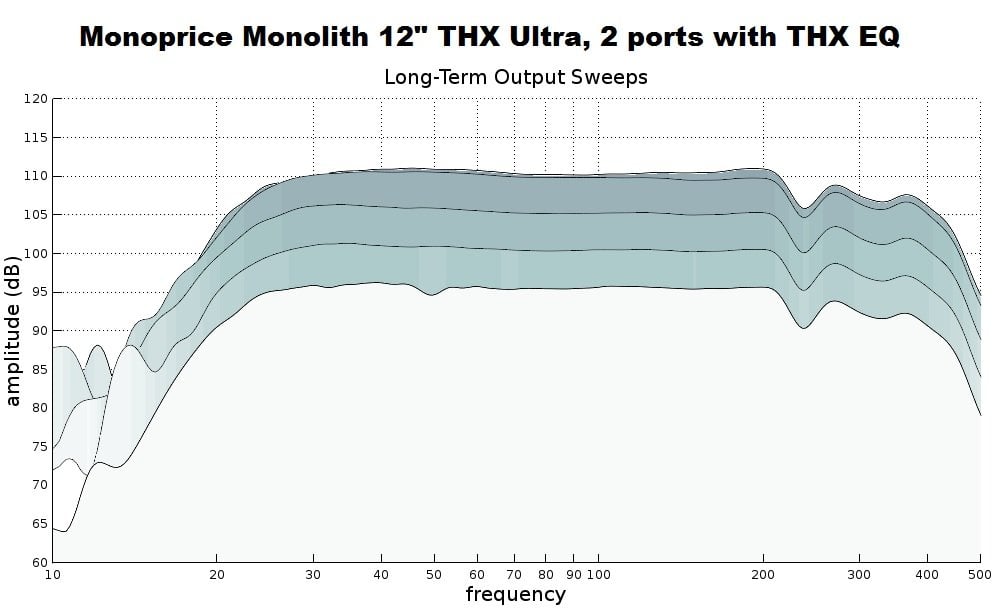

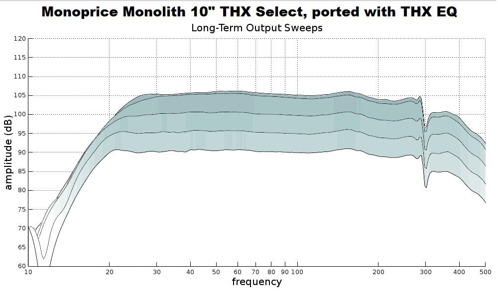

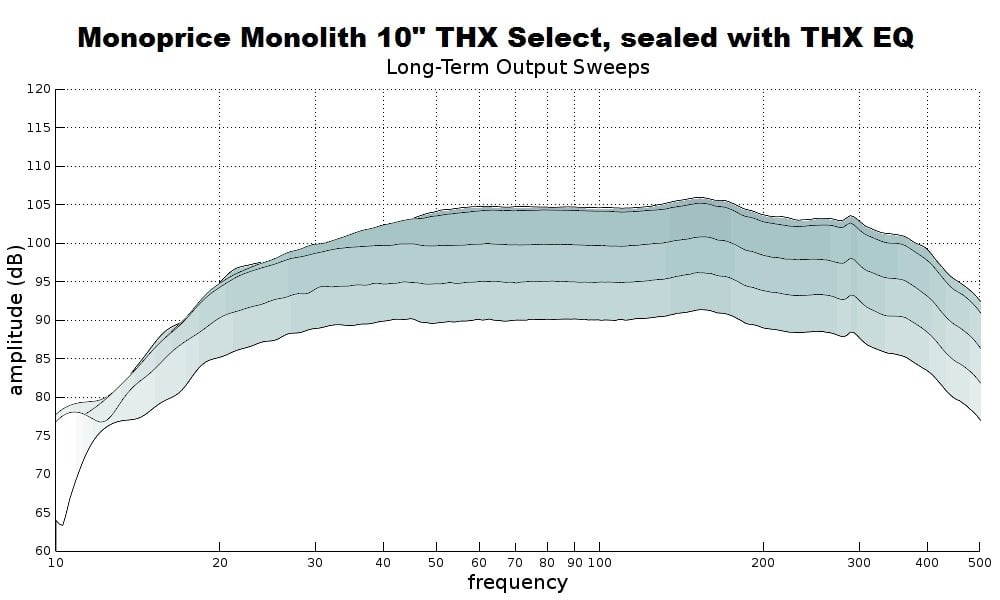

Monoprice Monolith 10” THX Select long-term output compression
Monoprice Monolith 12” THX Select long-term output compression
Testing for long-term output compression was done by first conducting a 20-second sweep tone where 50 Hz hit 90 dB with the subwoofer 2 m from the microphone. We then conduct further 20-second sweeps by raising the gain by 5 dB until no more output could be wrung out of the subwoofer. These tests show us the long-term continuous headroom that these subwoofers can be made to produce. First things first, the compression behavior of these subs are superb. The response shape scarcely changes from low drive levels to high drive levels. This is how you want your subwoofers to behave; there should be little difference in their amplitude response shape regardless of the volume level. Of note, look how beautifully flat the response stays with the 10” THX Select in its ported mode and the 12” THX Ultra in its 2 ported mode- recording those kind of perfect measurements makes my heart flutter. I also ran long-term sweeps of the Monolith subwoofers in the ‘Extended’ EQ setting of these modes, but the differences between the EQ settings was minor in this testing, much like the burst tests.
There is some rockiness in the very low frequencies in these graphs, but that is from gusts of wind; it was a very windy day when I tested these subs, and the microphone’s windscreen does not totally block out wind effects in these ultra-deep frequencies. These subwoofer’s actual deep frequency response is very smooth. These subs are very well behaved at all drive levels.

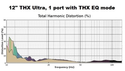

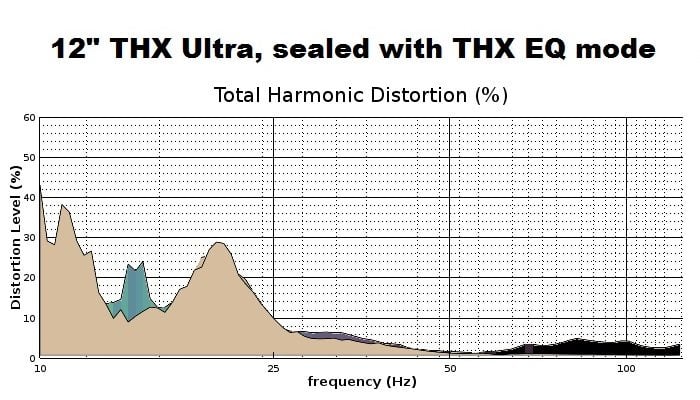

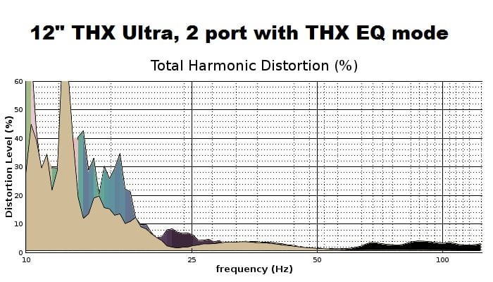

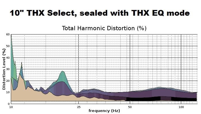

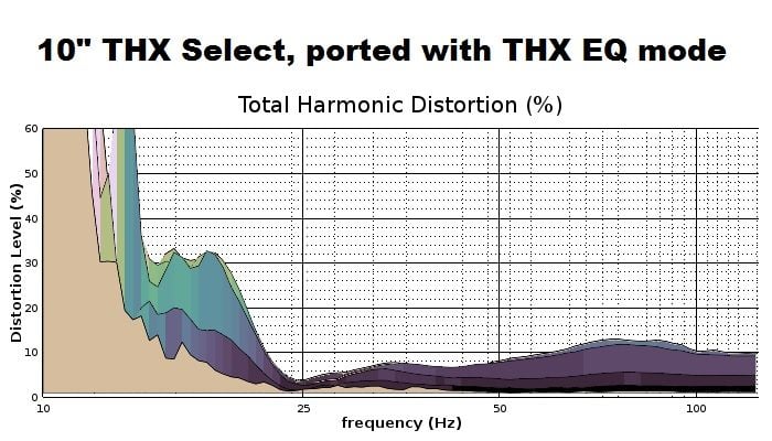

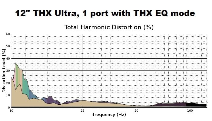

Monoprice Monolith 10” THX Select Total Harmonic Distortion
Monoprice Monolith 12” THX Ultra Total Harmonic Distortion
The above graphs show the corresponding total harmonic distortion to the long-term output graphs. Essentially, they depict how linear the subwoofer remains for the corresponding drive level seen in the long-term sweeps. The quantity being measured is how much of the subwoofer’s output is distortion and is shown here as a percentage. Both Monolith subwoofers sport very good measurements here, but the 12” THX Ultra does better as it mostly isn’t able to exceed 5% THD for the wide majority of its bandwidth at 25 Hz and above. The 10” THX Select looks to be allowed larger percentages of distortion, as it can be pushed to around 10% THD in that same bandwidth. Comparing the 2 port open mode to the 1 port open mode on the 12” THX Ultra might make it appear as though the 1 port mode has much cleaner deep bass output, but it must be remembered that output rolls off sharply where distortion rockets up, so while using 1 port only on the 12” THX Ultra technically grants cleaner deep bass, the distortion in the 2 port configuration will not be heard since there is so little output in that region at all. It should also be remembered the frequency response and output levels for these distortion graphs: the 12” THX Ultra is running at or near 110 dB at 2 meters for this 5% THD level average. That is superbly clean bass for that output level, and this makes the 12” THX Ultra a very high-fidelity subwoofer. The 10” THX Select is up against more trying circumstances due to its smaller cone and enclosure, but it still puts up a good showing by maintaining a 5% or lower THD level until the last few dB of its headroom where THD climbs to 10%.
As with burst testing, the Extended EQ mode changed relatively little in these measurements from the THX EQ mode. The total harmonic distortion in these subs is chiefly composed of third order above the port tuning frequency and second order at and below tuning.

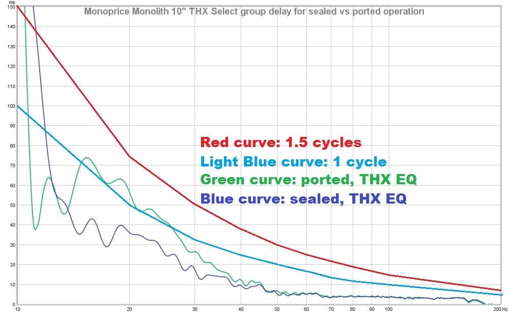

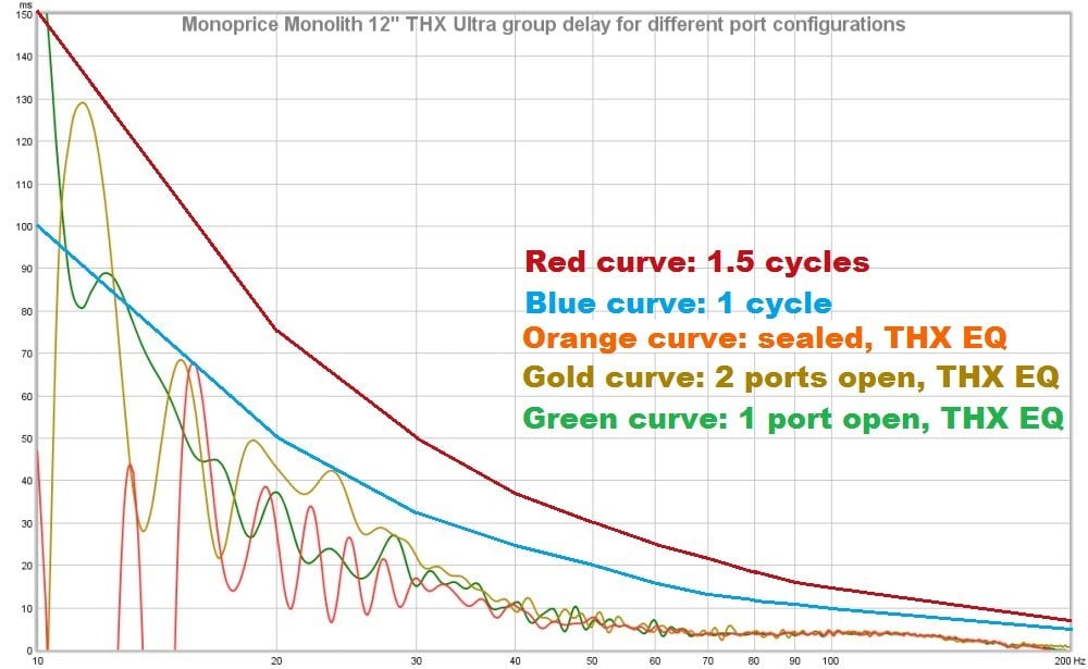

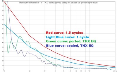

Monoprice Monolith subwoofers’ group delay measurements
Group delay is the measurement of how much time it takes for individual frequency bands of an input signal to be produced by the speaker. It can indicate that some frequency components are developing slower than others or are taking longer to decay. It is generally thought that 1.5 sound cycles are needed for group delay to be audible at bass frequencies, although there is an argument that group delay should remain under 20 ms to be completely unnoticeable, but that is likely meant for mid and upper bass frequencies. Group delay for either sub is superbly controlled, not even rising above 10 ms until it is down to 40 Hz, and mostly staying below 20 ms down to 30 Hz. Below that, the frequencies are too deep for the measured delay to ever be of audible consequence. These graphs tell us that the Monolith THX subwoofers will not have any audible overhang. Owner’s will only have to worry about what the room acoustics will do to the decay of bass sound and have nothing to worry about from the subs themselves.
The Monoprice Monolith 10” THX Select and 12” THX Ultra have similarities but also some significant differences which make it difficult to summarize them together in this combined review. They look the same except for size, use many of the same parts, and have some s
