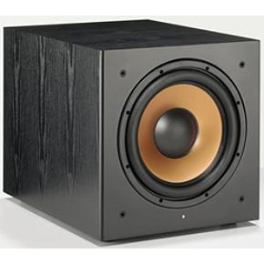

Subwoofer Placement Procedure
  • Connect the "Sub Out" of your Receiver / Preamp Processor using an RCA or XLR cable into the input of your subwoofer. If the sub has a dedicated LFE input, use that one so you can bypass the internal LPF and get better performance from the bass management in your AVR.
  • Place the Subwoofer in the most common location of your listening area. (Usually your couch, chair, or bean bag).
  • Play a bass heavy CD or other format (not 8 track!) that you are familiar with and turn the volume up so that the sub is really working.
  • Now get on your hands and knees and pay homage to the subwoofer (just kidding). Seriously, for the next part of this set-up, prepare to do some crawling (this is the part that could get you committed, but its all worth it!)
Note: The reason why you should crawl is that standing will put you about 5 feet off axis (depending on how tall you are) with the sub and thus will change the characteristics of the sound enough to potentially cause you to place the sub in a non optimal position.
  • Crawl around the listening room and listen for when the sub seems to sound the best. (IE. Listen for depth, loudness, tightness and definition)
  • Mark that magical spot with tape. If that spot isn't convenient, keep crawling and find another location with similarly good results.
  • If possible, place the sub as close to this position(s) as you can. This will ensure you have chosen the best location in the room.
  • Now get off your knees and calibrate your system.
For Example:
  • Adjust crossover point on the sub for optimal blend with main speakers.
  • Adjust gain control of sub to tonally balance your system.
  • Repeat these steps until satisfied.
