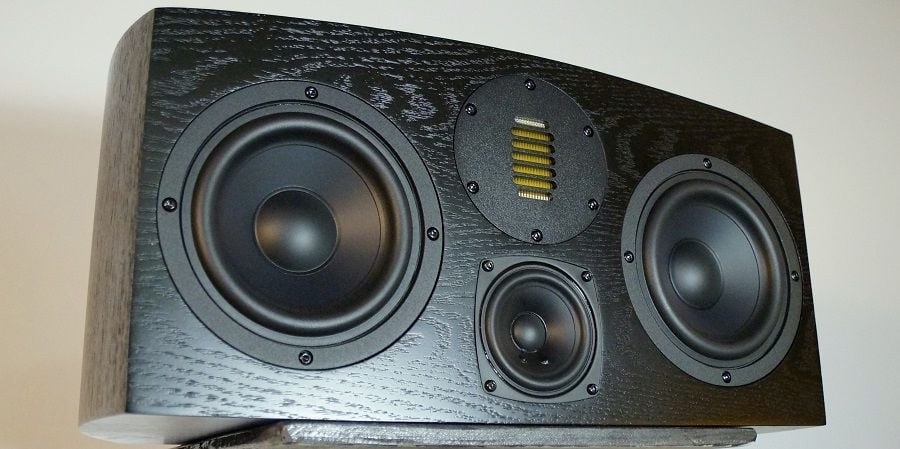

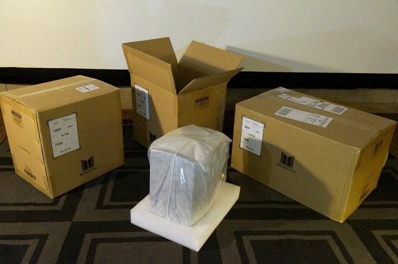

unpackingAnother important difference is that the Air Motion speakers come with a center channel speaker, whereas the K-BAS does not. Obviously, that means unless the user can fit another K-BAS bookshelf speaker in their setup as a center speaker, the Air Motion speaker set should be used for systems with center channels (and no, it is not advisable to use the K-BAS on its side, due to off-axis lobing inherent in all 2-way speaker designs when placed horizontally). But now, setting apart comparisons between the K-BAS and the Air Motion speakers, let’s see what Monoprice has achieved in these modestly sized and inexpensive bookshelf speakers and center channel speaker. The Air Motion speakers arrived at my doorstep with good packing that is sure to protect the speakers from rambunctious shipping with a large foam piece in the top and bottom of a thick cardboard box. Inside the box, the speakers were wrapped in a soft cotton cover underneath a thick plastic bag, in order to protect the speakers from scuffs and moisture. These speakers should be safe from all but the most abusive shipping.

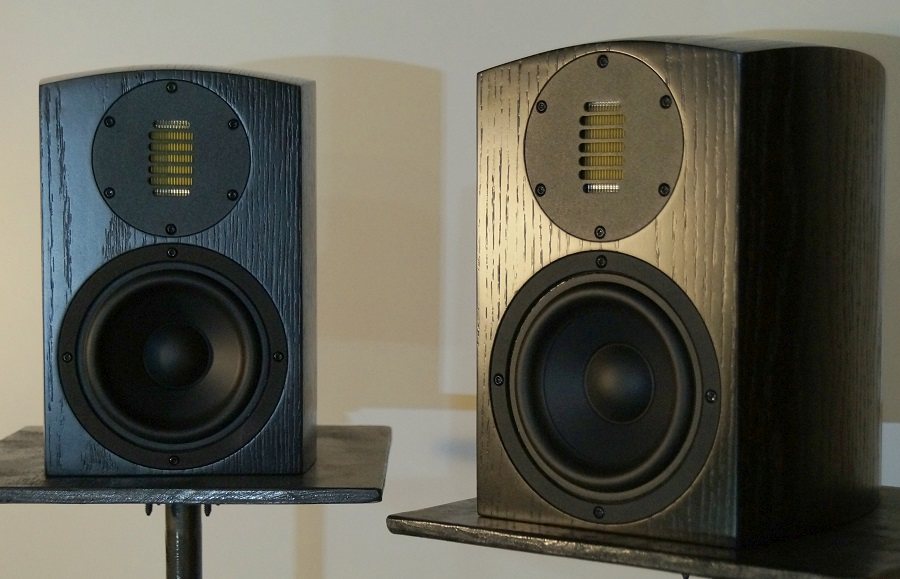

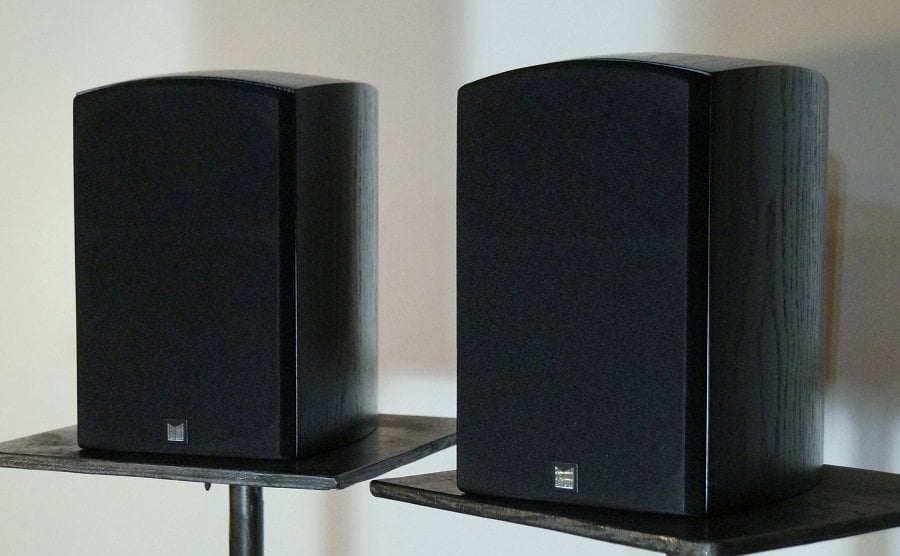

appearance_Pair    appearance_Pair_grilles

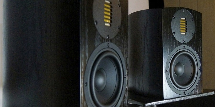

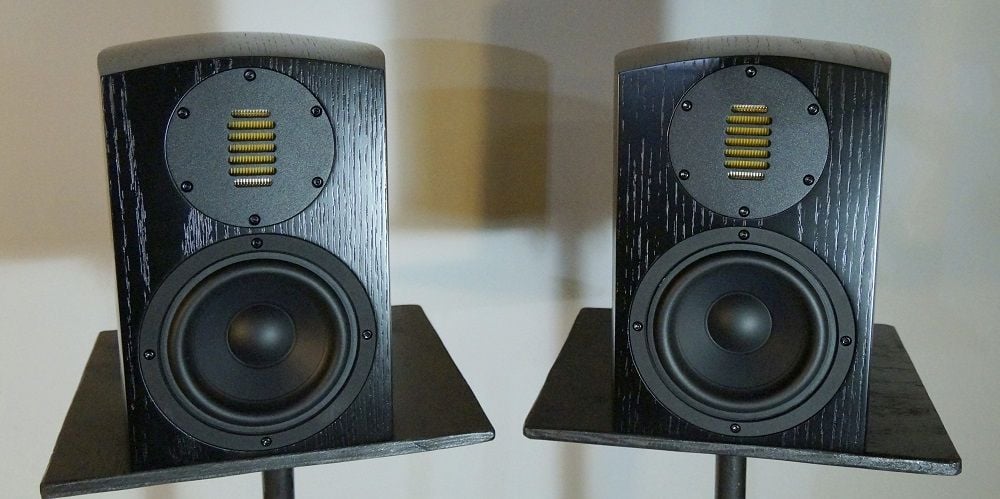

The most distinguishing visual trait of the Air Motion speakers is the curved cabinets, particularly the top. This isn’t something commonly seen at this low price point. That is a classy touch that sets these apart. The use of a real wood Black Oak veneer definitely adds to the aesthetic- a dignified look that would allow the Air Motion speakers to fit in a wide range of decors. With the grille on, they look innocuous- not offensive but nothing that would strike a tremendous amount of interest either. Without the grilles, they have more personality and look more interesting. One nice touch is the use of magnetic grilles so there are no grille guides to mar the appearance of the front baffle of the speaker when used without grilles. The golden yellow of the AMT tweeter also aids in their stately presence. Overall, I think these are some of the best looking bookshelf and center speakers available in their price class.

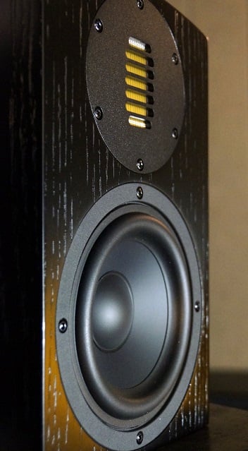

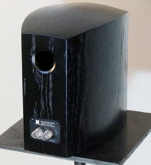

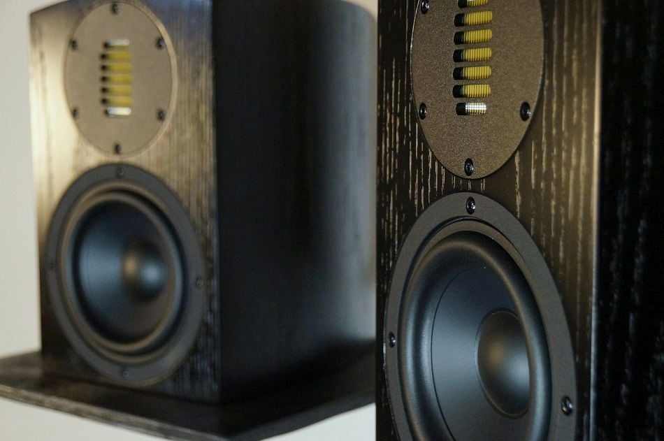

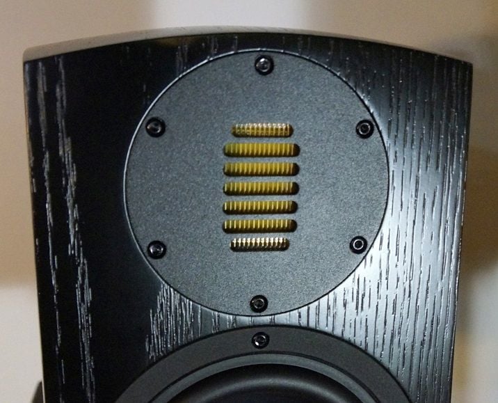

Design_tweeterThe Air Motion Cinema 5 bookshelf speakers are a 2-way design using a 5.25” woofer and an AMT tweeter. It should be said here that this speaker does not use the inverse horn enclosure that the K-BAS does; it is a simple bass reflex design. The AMT tweeter is the Air Motion’s most distinguishing trait from a design perspective, and it is where the Air Motion speakers derive their name, as AMT stands for “Air Motion Transformer”. As opposed to conventional dome tweeters that pistonically oscillates a little dome, AMT tweeters contract and expand the folds of a pleated membrane to produce sound. To explain using an example, imagine the folded surface of a half-closed curtain- then line the interior folds of the curtain with conductive rods on adjacent sides of the folds, and set two powerful magnets on the sides of the curtain. Run some alternating current through the conducting rods and their newfound electromagnetic field will rapidly collapse and expand the folds of the curtain, and, in doing so, squeeze air in and out of the folds thereby creating pressure waves that we experience as sound. See the below illustrations taken from Oskar Heil’s 1976 patent of the AMT transducer, which are cross sections of the ‘folds’ of the tweeter diaphragm, first at rest and then in motion.

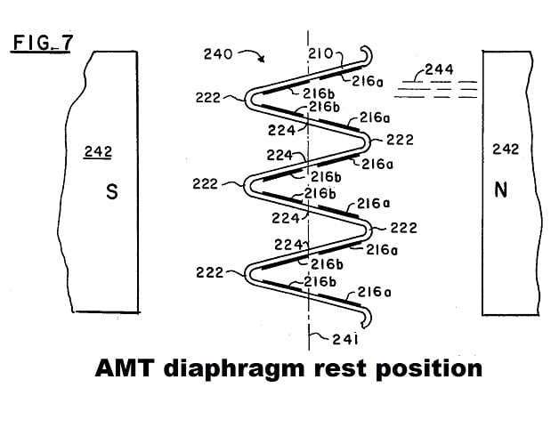

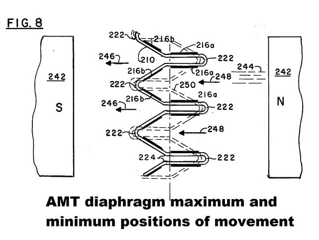

Design_AMT_diagram1     Design_AMT_diagram2
The low mass and large surface area of the AMT tweeter allows for extended frequency response and dynamic range.
AMT tweeters were initially used to great acclaim by the speaker company ESS back in the early 70’s. AMT tweeters have had a comeback in popularity in recent years after having spent decades dormant since ESS’ demise. A major advantage in this design is that since it is the folds of the diaphragm are much deeper than they are wide, air is ejected out much faster speed than the vibration of the diaphragm itself- as much as five times faster. Another advantage is the very light mass of the diaphragm that makes it very easy to move and to change direction since it does not have the momentum of the weight of typical dome tweeters. These elements give AMT tweeters an extended response well into ultrasonic frequency ranges. Also, since AMT tweeters can have a relatively large surface coupled with the air, they can have a very wide dynamic range.

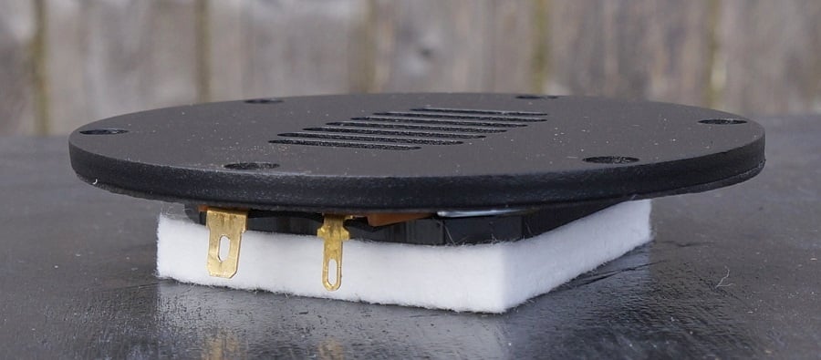

Design_tweeter_side

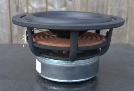

Removing the tweeter, we can see a felt pad on the back that serves the purpose of minimizing backwave pressure from woofers that share the AMT woofersame enclosure. Happily for the Air Motion speakers, that is not needed, since the tweeter is in its own sealed compartment within the cabinet. We are told by Monoprice’s Senior Product Manager that this tweeter can be found on much more expensive speakers.
The 5.25” woofer uses a cone made from New Zealand pulp paper that has longer fibers than ordinary wood pulp. This makes for a lighter and more rigid cone that Monoprice claims will produce clearer mids and tighter bass. Removing the bass driver and examining it closely, we see a cast frame that Monoprice says is made from super low carbon steel. We also see a healthy-sized motor with a vented pole piece and a large spider for a driver of its diameter. We are also told that the motor uses a shorting ring to control inductance, which reduces even-order THD. Altogether, this woofer looks up to the task. This is certainly more than a cheap ‘barely adequate’ woofer, and it shows that Monoprice is serious about making a good speaker.

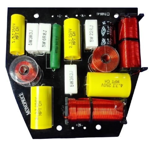

The Air Motion Cinema 5 speakers are crossed over at 2.8 kHz using a first-order crossover for the tweeter and a third-order crossover for the woofer. Monoprice must have a lot of confidence in their tweeter to use a first order filter on it. First-order filters allow the tweeter to playback quite a bit of content under its crossover point, since high-pass slope is a gradual 6 dB per octave.
Design_crossover
The board itself looks reasonably well built, with a handful of inductors, a few decently large capacitors and a slew of resistors. Curiously, the Air Motion Center Channel speaker looks to have a simpler crossover pictured on its product page, even though it is a more complex 3-way design using a second-order Linkwitz-Riley crossover for the tweeter, a second-order bandpass crossover for the mid-range, and a first-order butterworth crossover for the woofers.Design_cabinet

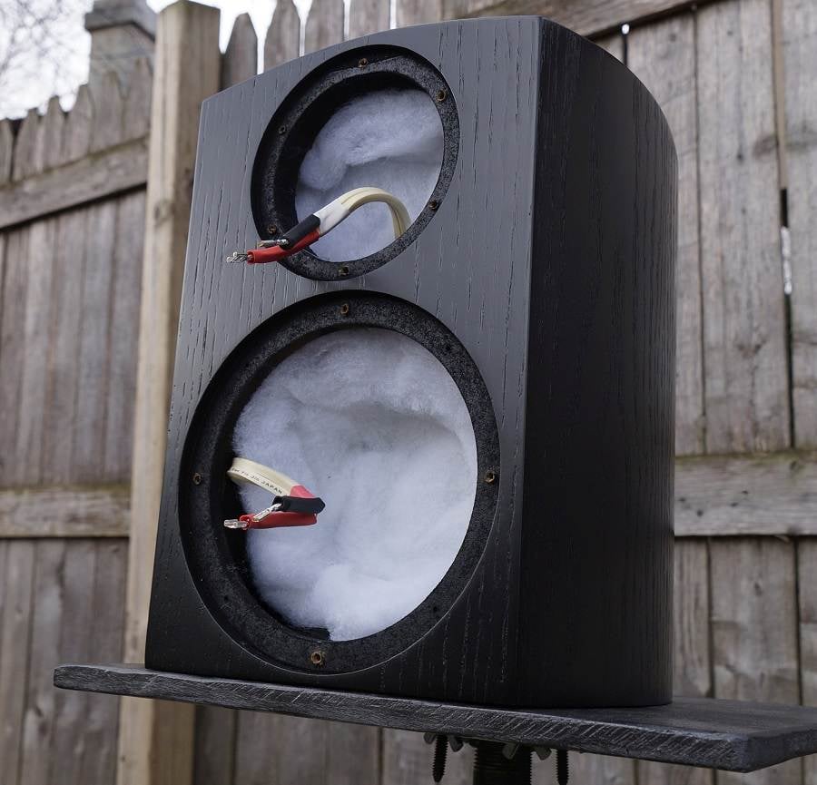

Cabinet construction on the Air Motion speakers looks quite good. The Air Motion speakers are hefty little bookshelf and center speakers, weighing 14.3 and 26.5 lbs respectively. The knock test produces a dulled sound that bodes well for quiet paneling during the speaker’s operation. The cabinet panels are made from high-density fiberboard of a 21 mm thickness (or just over ⅘ inches), however, MDF has greater self-damping and is said to be a superior acoustic material. There is a window brace midway in the speaker between the woofer and tweeter that is also 21 mm HDF. As mentioned before, the tweeter has its own sealed compartment to completely block off backwave pressure from the woofer from interfering with the tweeter’s lateral travel during playback. Furthermore, the curved cabinet of the Air Motion speakers isn’t just for looks; by eschewing flat sidewalls, resonances caused by standing waves inside the cabinets can be reduced, thereby reducing coloration of the sound by lively enclosure panels. On the rear panel of the speaker, we see a 1.5” port and a couple of heavy-duty binding posts attached to a metal plate. With the drivers removed, we can see the cabinet is generously stuffed with Dacron. This abundance of filling is good for reducing mid and high frequency reflections from the back of the box, and it also helps to make the cabinet behave as though it is larger than it really is; this is called isothermal conversion. Isothermal conversion is beneficial to speakers, because a larger cabinet is usually more efficient.

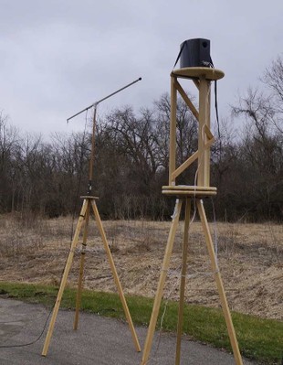

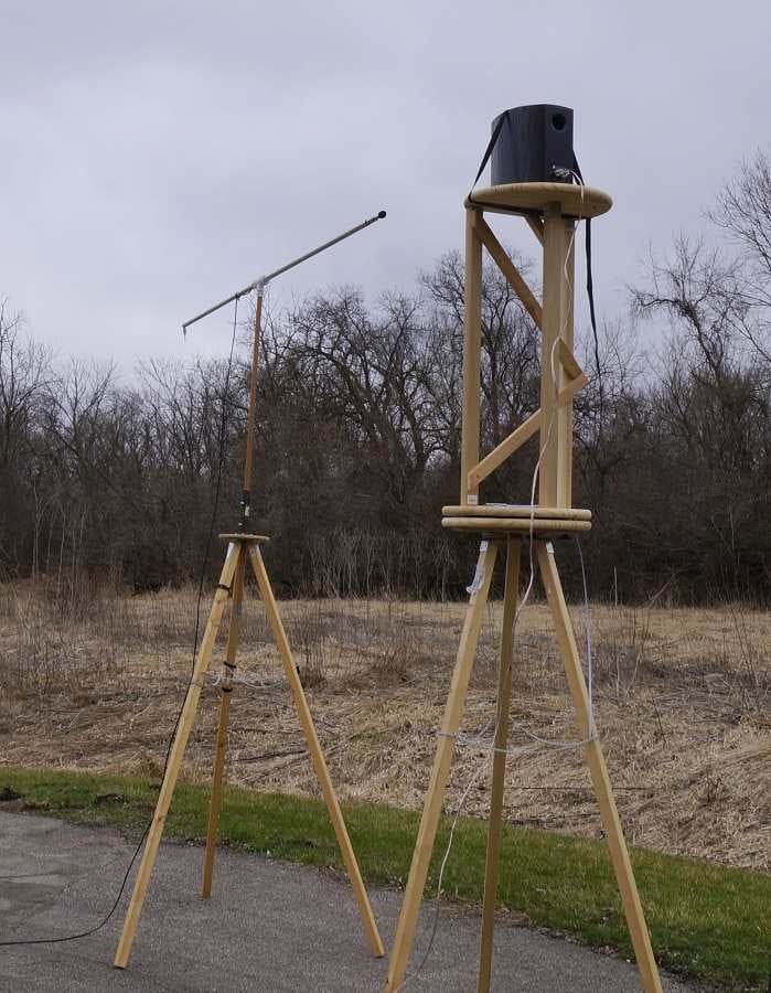

The Monolith Air Motion speakers were measured in free air at a height of approximately 9 feet and gated at 14 ms. At this window gate, some resolution is lost below 140 Hz, and accuracy is completely lost below 70 Hz and so that range should be ignored. The microphone was placed 1 meter away from the speaker at a height level with the tweeter. All measurements are unsmoothed.

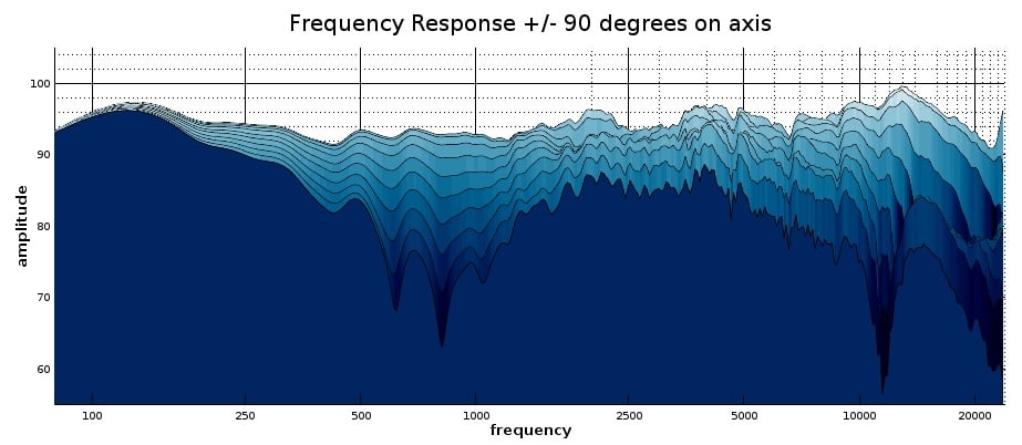

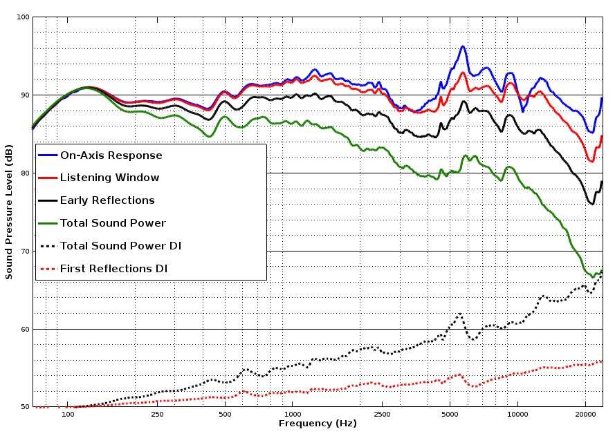

test_response_curves
Monoprice Air Motion Cinema 5 bookshelf speaker response curves
The Air Motion speakers measure well up to 2.5 kHz, but the tweeter shows some spikiness above that point, especially on axis. Off-axis, the tweeter calms down significantly. The spike at 6 kHz suggests that the speaker would have a sibilant character, but in my listening sessions I didn’t hear anything that I would consider to be notably sibilant. It may be that the peak is so narrow that sibilance wouldn’t come out except in particular cases. The dip centered around 3.5 kHz would be more concerning, although that is something an automated room correction equalization routine like Audyssey can help out with, since it occurs all around the speaker’s axis and so is not a diffraction problem. The directivity indexes show that at high treble frequencies, the Air Motion speakers become a very directional speaker, meaning the acoustic energy becomes more focused in front of the speaker instead of widely dispersing. The tweeters higher directivity may be another reason why I didn’t hear it to be especially sibilant, since much of the treble energy was confined to a tighter beam instead of reflecting all over the room. For more information on what all the difference curves mean in this graph, we refer the reader to this Audioholics article: Objective Loudspeaker Measurements to Predict Subjective Preferences.
One feature the Air Motion bookshelf speakers has in common with the K-BAS speaker is that the bass response is relatively flat. Most bookshelf speakers in this range seem to have a mid bass boost, but the Air Motion speakers keep the bass relatively neutral. A flat bass response and a slightly elevated range from 500 Hz to 2.5 kHz would suggest a somewhat more ‘forward’ sounding speaker rather than a laid-back or ‘warm’ speaker. This sound character can bring out a detailed sound but at the risk of being fatiguing over long listening sessions, although I did not find them to be fatiguing myself. All told, I would wish for a flatter response over the entire range, but the flaws that this graph suggest didn’t seem pronounced when I was listening to the speakers themselves.
In investigating the cause of the jagged treble response, we swapped tweeters from the center channel speaker, which measured to have a much tamer response in the 6 kHz to 10 kHz region. The response in the bookshelf speakers remained the same, so it seems that the tweeter itself is not the cause of the problem, or at least is not the sole cause. When we took a measurement with the tweeter disconnected, the problem became apparent; the woofer was clearly running into breakup modes, and the low-pass filter was not sufficiently suppressing the woofer’s misbehavior. We would have thought that since the crossover uses a third-order low-pass slope on the woofer at 2.8 kHz, cone breakup should be significantly reduced in this region. In A/B comparisons with speakers we had on hand that had a more neutral response in this frequency range, the Air Motion speakers were notably ‘edgier’ in character, surely a byproduct of the cone breakup.
It should be noted here that the measurements seen here for both the Air Motion bookshelf speakers and center speaker were performed with the grille off. The grille did not improve matters above 5 kHz, because the grille frame caused some diffraction that led to more jaggedness in the upper frequencies. The Air Motion speakers perform best without the grille on.

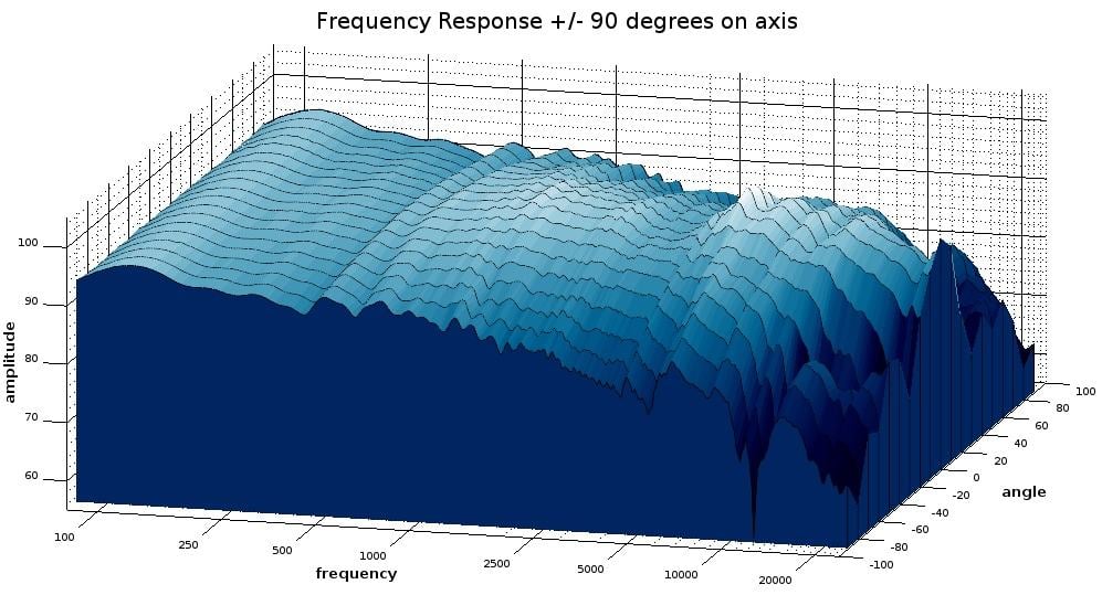

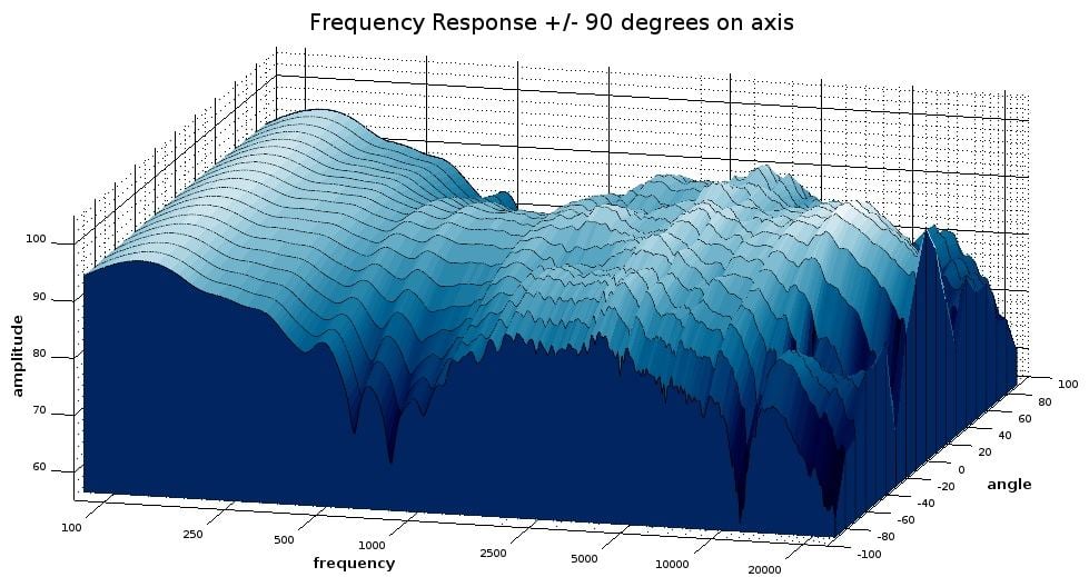

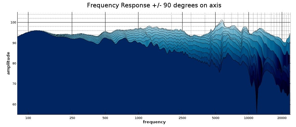

test_horz_response_3D
Monoprice Air Motion Cinema 5 Bookshelf Speakers horizontal frequency response +/-90 degrees from axis: 3D view
test_horz_response_2D
Monoprice Air Motion Cinema 5 Bookshelf Speakers horizontal frequency response +/-90 degrees from axis: 2D view
Looking at the Air Motion’s dispersion graphs in 10-degree increments, we can more explicitly see some off-axis behaviors. We can more clearly see the beaming of the response after 10 kHz. There looks to be a cancellation effect from the tweeter itself off-axis at about 12 kHz, but that is not likely to be audible, so that shouldn’t be a cause for concern. Looking closely, we can see the 20 degree and 30 degree angles lose most of that higher frequency on-axis irregularity. For those who want a less forward sound, they might try aiming the speakers off the listening position outside of a 20-degree angle, whether toed in or toed out. That would go a long way toward reducing any ‘brightness’ of the speaker. The 30-degree response angle looks to be the most linear, at least out to 15 kHz. Dispersion is fairly wide and mostly uniform up to 12 kHz. The Air Motion speakers would offer relatively good coverage over a wide area. This is a speaker that might work well when facing straight ahead as well as toe-in angles aiming at the listening position.

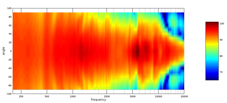

test_polar_map
Monoprice Air Motion Cinema 5 Bookshelf Speakers Polar Map
The above polar map of the horizontal dispersion of the Air Motion speakers depict the same information as the two graphs above it, but tells the story in a different way that can offer further insight regarding its behavior. We can see fairly reasonable dispersion out to 40 degrees, and outside of that the response becomes quite a bit more uneven. As seen on the other horizontal dispersion graphs, 20 degrees to 30 degrees maintains the smoothest response from these angles. As we move up the frequencies, we see a tightening of dispersion until we hit 6 kHz where we encounter a flare up of acoustic energy, which rapidly recedes again after 10 kHz. The 6 kHz irregularity is more evidence of the cone breakup to be certain, but it isn’t so severe as to make the speaker extraordinarily bright. Those who want a bit more high frequency detail would be advised to listen on the direct axis of the Air Motion speakers, but, as mentioned above, those who want a less forward sound would be better off at a 20 to 30 degree angle off direct axis.

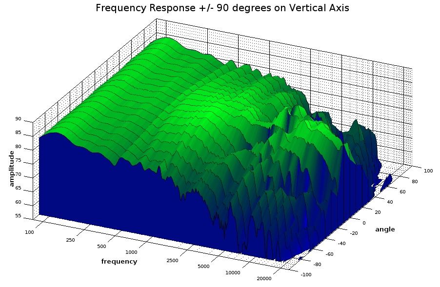

test_vertical_response_3D
Monoprice Air Motion Cinema 5 Bookshelf Speakers vertical frequency response +/-90 degrees from axis: 3D view
The above graph exhibits the Air Motion’s vertical response. This might look rough, but it isn’t nearly as important as the horizontal response. In this graph, we see things are going fine until 3 kHz where lobing nulls are created by the woofer and tweeter cancelling each other out off of the direct axis. Very few speakers with separately placed drivers on a vertical plane (ie. most speakers) have a pretty vertical response off of the direct axis. If we look closely off axis above 6 kHz, we see some comb filtering develop about 60 degrees off axis above 6 kHz. This would be a product of the tweeter itself, perhaps an inherent quality of AMT designs- but this is simply an interesting little artifact in the data, and it will not adversely affect the sound unless the listener is strangely positioned more than 60 degrees above or below the tweeter. The overall message of this graph is that, as with every other conventional speaker, the Air Motion speakers are best listened to at an ear height level with the tweeters.

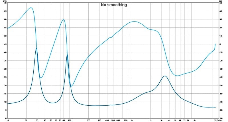

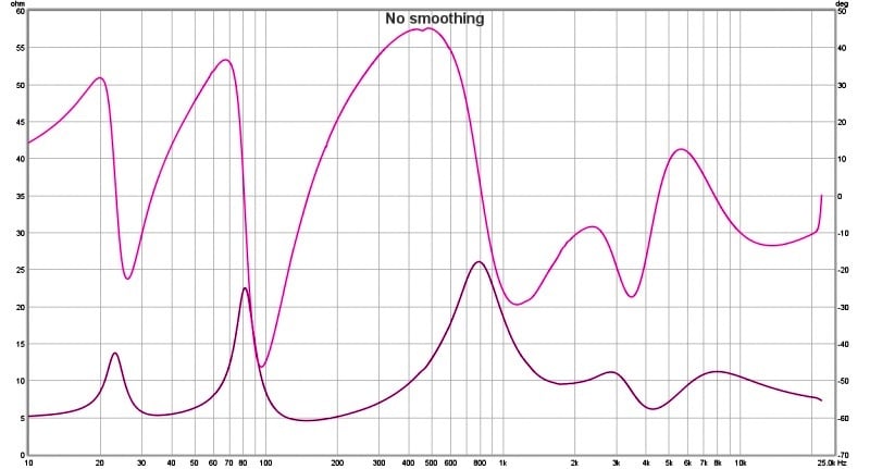

 test_impedance
Monoprice Air Motion Cinema 5 Bookshelf Speakers Electrical Impedance and Phase
The Air Motion Cinema 5 speakers impedance profile shows it to be a very friendly speaker to any amplifier. At no point does the impedance dip below 7 ohms, and all the steep phase angles happen at high impedance points. These speakers do not need a heavy-duty amplifier at all, and even an entry-level AVR could run them easily. The Air Motions easily qualify for the 8-ohm rating they are specified at by the manufacturer. With regards to their sensitivity, I measured them to be 84.9 dB sensitive for 2.83v at 1 meter. They are specified by Monoprice to be 87 dB sensitive, but Monoprice does not say if that is 1 watt or 2.83v or the conditions that sensitivity spec was measured at (ie. in-room or anechoic). 84.9 dB is very typical for this type of design and is not abnormally low. Any conventional AVR or amplifier should be able to drive them to very loud volumes without much problem. By their maximum rated amplification load of 100 watts RMS, they should be able to hit 105 dB, which will be more than loud enough for most people in moderately sized rooms.
