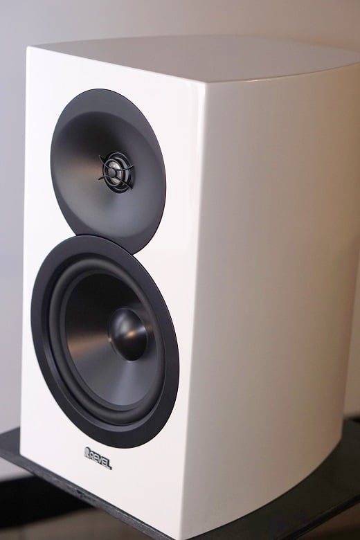

Appearance

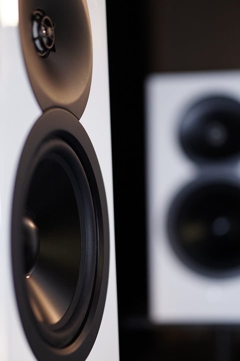

The appearance of the M16 is clean and stylish, alrevel m16c.jpgmost minimalist. The M16 comes in either white or black with a high-gloss finish. A waveguide on the tweeter is cut to form around the gasket of the woofer in a stylized gelling of the drivers, a nice design touch topped off with no visible screws holding in the drivers. Magnetic grilles do away with the need for visible fasteners on the front baffle which further assists its uncluttered appearance. Only a small logo interferes with these clean lines, but not intrusively. A removable logo with a magnetic hold would have been a neat detail. The front of the speaker is nice enough that it would be a shame to use the grille at all; the M16 looks better without the grille.
The curved sides of the cabinet towards the back are a welcome departure from a simple rectangular box endemic of so many bookshelf speakers. The visual simplicity and high-end gloss finish make the M16 a bookshelf speaker that enhances almost any home furnishings. It fits in perfectly with modern decor, especially with the available white finish, but wouldn’t clash at all with a more traditional interior design.
Cabinet Build Quality
The M16 looks nice, but how well is it built? A simple knock on the exterior produces a dull thud that gives a sense of solidity, which is a positive attribute in a speaker. The 16 lbs. heft of the M16 also bodes well for the build quality, and although weight alone does not guarantee a good build quality, heaviness bodes well for a better build quality than a lightweight speaker. A stiff and heavy cabinet is needed in order to reduce resonances which can interfere with the sound that is only supposed to be created by the drivers and port. The cabinet exterior walls are ¾” MDF, and a ½” thick window brace is mounted between the tweeter and woofer sections of the cabinet. Revel’s literature on the M16 boasts of using the ‘Kerf Technique’ to bend the sidewalls using perpendicular slots instead of V-grooved joints, and a layer of fiberboard is used to reinforce the internal slotted wall of the cabinet. Stout five-way binding posts ensure a tight grip on the speaker wire, whether using banana plugs or bare wire tips. Altogether the cabinet construction of the M16 is sensible: robustly built and without the overkill construction of extreme high-end speakers which can often multiply the cost for negligible returns in performance.

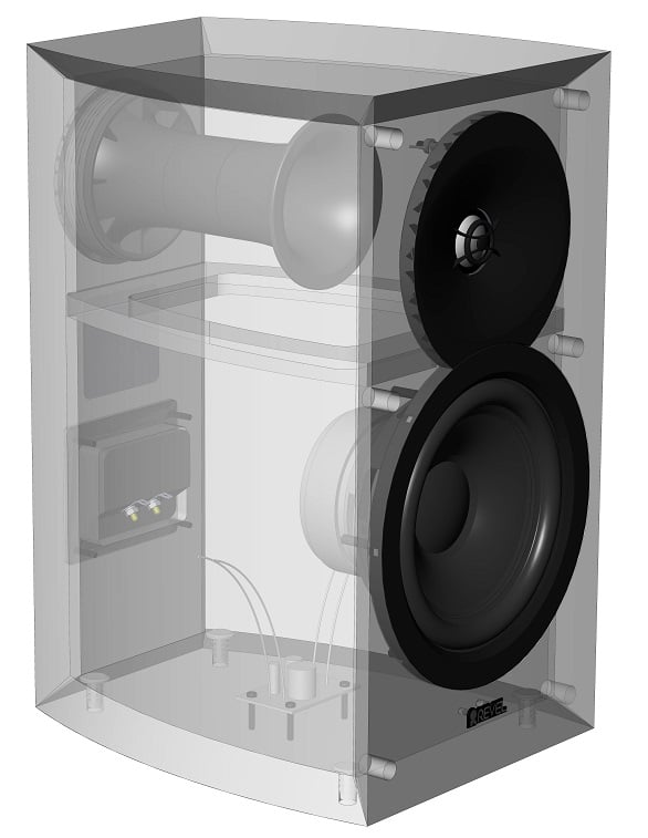

Drivers, Port, and Crossover Overview

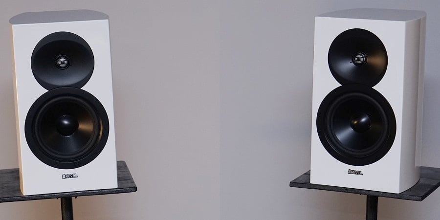

The 1” aluminum drevel m16 d.jpgome tweeter uses a waveguide and an acoustic lens to match the directivity of the woofer in an effort to produce a seamless transition between them. This is in line with the philosophy of many of Harman’s speaker brands, of which Revel is one, that advocates for a uniform off-axis frequency response as well as on-axis response for the best overall soundstage and imaging. The idea behind this design decision is that much of what is normally heard in-room is not direct sound from the speakers to your ears but acoustic reflections off room surfaces and so the off-axis response becomes very important in accurate sound reproduction. The shape and curvature of the waveguide is critical and must be modeled very precisely to match the dispersion pattern of the woofer at the crossover frequency. The waveguide and acoustic lens of the M16 also raises the tweeter sensitivity, especially around the lower frequencies of the tweeter’s band. Boosting sensitivity in this frequency region is a big help, because it is where the tweeter is likely to generate the most distortion, since it is where the tweeter is the most stressed mechanically.
One innovation in the tweeter assembly itself is Revel’s inclusion of a larger than normal cavity behind the magnet assembly which is also vented. This lowers the tweeter’s mechanical resonance down to 800 Hz from the more typical 1,500 Hz, so there is not a trace of that resonance heard at all.
The bass driver’s cone is mM16rear.jpgade of a Micro-Ceramic Composite (MCC), which is an aluminum layer sandwiched between layers of ceramic. Since sound travels differently between the two materials, the cone construction adds substantial damping over conventional cone materials. Another feature of the driver is the use of an extended pole piece in order to create a more uniform magnetic field in the further reaches of the driver’s excursion. This reduces distortion at higher output levels. Klippel analysis is used to optimize the linearity of the bass driver, and substantially improved linear excursion permitted by the driver’s suspension and also the magnetic fields between the voice coil and magnet.
The crossover network is a nine-element, high-order design. One of its features is compensation for the lower frequency free-space to half-space bump that can occur in bookshelf speakers. The crossover frequency occurs at 2.1 kHz, which is a bit lower than normal for this type of bookshelf speaker but is permitted by the tweeter’s back chamber, which lowers its resonance to 800 Hz, and also its waveguide.

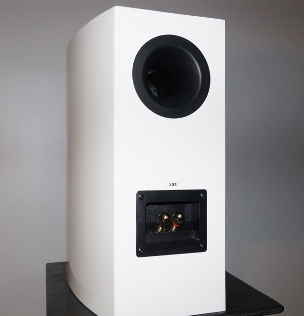

Revel calls the rear-firing port a ‘Constant Pressure Gradient Port’. The idea behind this is that the shape of the interior of the port is such that the change in pressure along the length of the port remains constant. The reasoning for this is at high playback levels ports can produce a noise commonly referred to as ‘chuffing’ when air in the port is pushed too quickly and becomes turbulent. By contouring the port’s shape in a precise way, this turbulence can be reduced by eliminating any points within the port that change the pressure of the air flow.

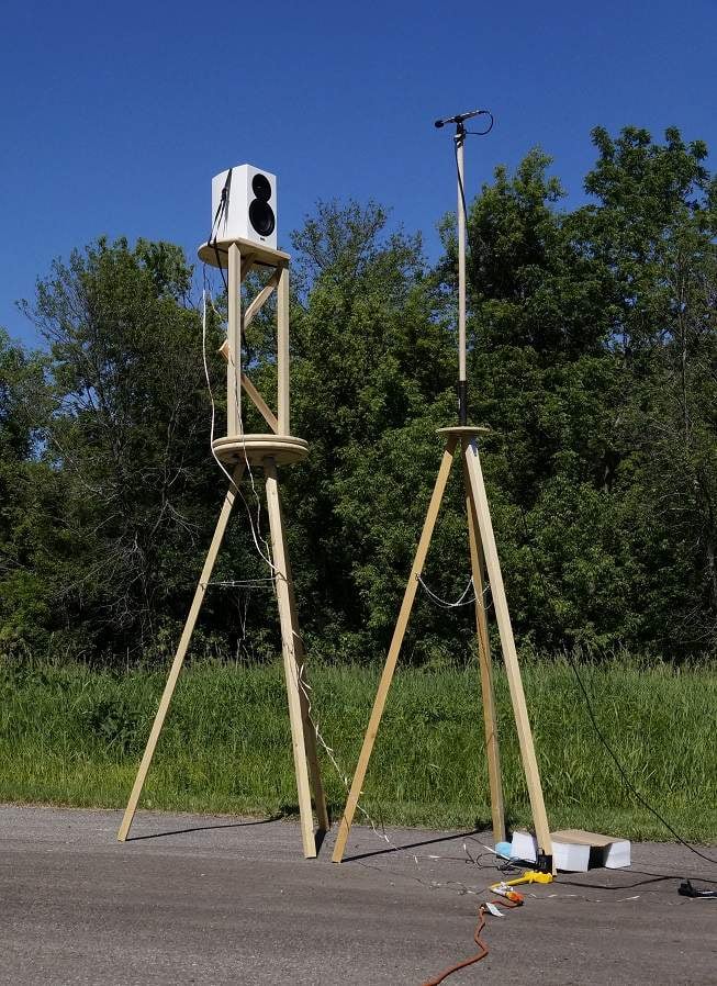

The Revel Concerta2 M16 speakers were measured in free air at a height of approximately 9 feet and gated at 14 ms. At this window gate, some resolution is lost below 140 Hz, and accuracy is almost completely lost below 70 Hz and so that range should be ignored.
Loudspeaker Test Rig to do full 360 degree outdoor measurements with Revel M16

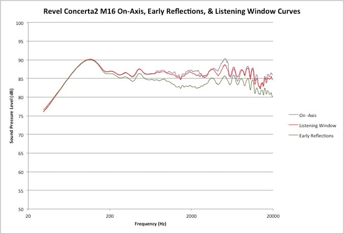

Revel Concerta2 M16 on-axis response, early reflections, and listening window.

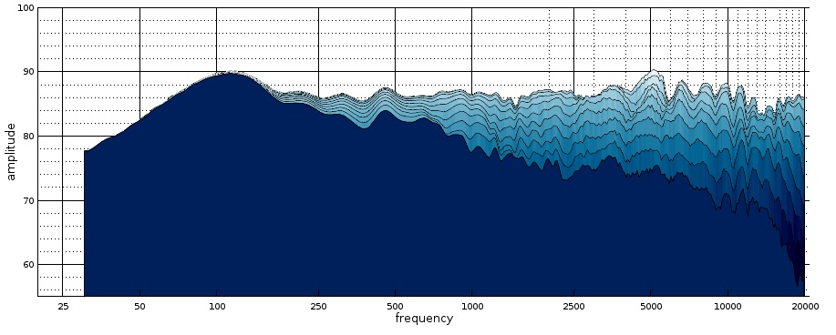

The on-axis response of the M16 speakers is impressively flat for the most part. There is a bit of a bump at 100 Hz, but it is not severe, and since that bump occurs at such a low frequency, any halfway decent room equalization should be able to taper it down for those perfectionists who are worried about it. There are some ripples at 6 kHz and above that are likely anomalies from the microphone stand, and the true response is sure to be flatter than what is depicted in these graphs. The ‘listening window’ curve is an average of the responses out to a 30 degree horizontal angle and 10 degree vertical angle from the speaker’s central axis, and the ‘early reflections’ curve is an average of the angles that are likely to be the first acoustic reflections heard by the listener in a typical room. The significance of the ‘early reflections’ and ‘listening window’ measurements is touched on in Objective Loudspeaker Measurements to Predict Subjective Preferences. The direct axis response and the listening window for the M16s is nearly identical, which indicates this speaker can cover a broad listening area very well.

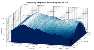

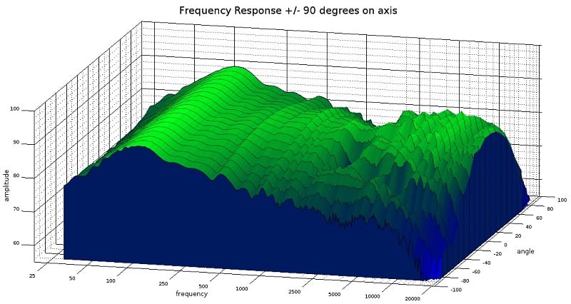

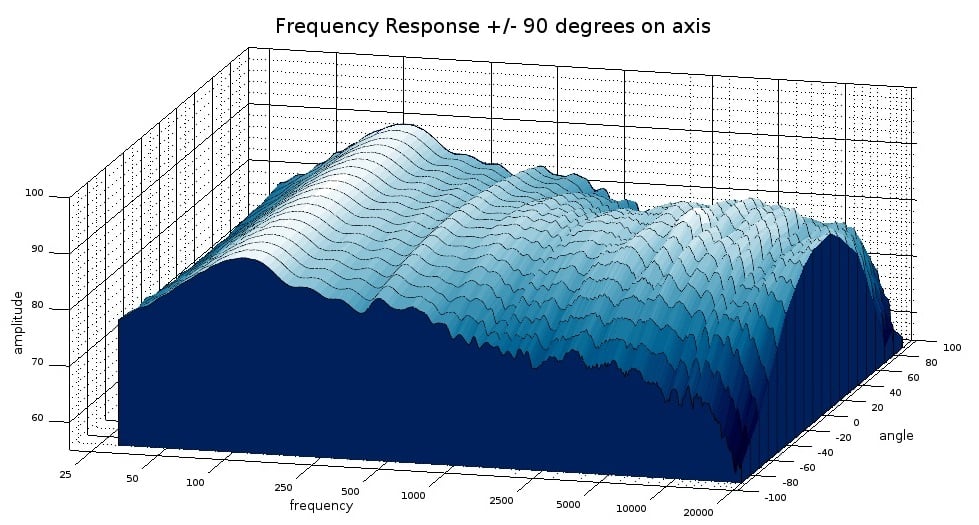

Revel Concerta2 M16 Bookshelf Speakers unsmoothed horizontal frequency response +/-90 degrees from axis: 3D view

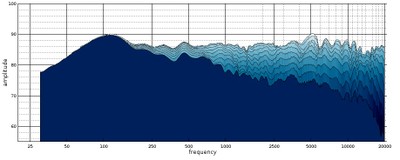

Revel Concerta2 M16 Bookshelf Speakers unsmoothed horizontal frequency response +/-90 degrees: 2D view

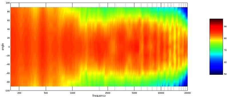

The off-axis response follows the shape of the on-axis response for a highly consistent dispersion pattern. As was mentioned before, this all follows Harman’s (Revel’s parent company) design philosophy, which can be roughly summarized that the most preferred sound by most listeners is a neutral on-axis response, with an off-axis response that does not greatly differ from the on-axis, as the reflected sound from the off-axis acoustic radiation should match the on-axis for the most convincing soundstage. This philosophy is backed by extensive research and is not something that some audiophile just mused one day; here is a white paper by Dr. Floyd Toole that discusses these design principles and some of the research behind it. The M16 exhibits a very good on-axis response and a stellar off-axis response.
Revel Concerta2 M16 Polar Map
The above polar map shows the same data as the graphs above it, but in a different manner. The M16 exhibits very good uniformity out to 50 degrees from the main axis. This is a superb showing and goes a long way toward explaining the M16’s realistic and natural sound. What can be seen here was heard in the listening sessions as the M16’s remarkably lucid soundstage. Among the benefits of this kind of performance is the wider area of coverage for a good sound than what is had with many other speakers. This makes the M16s a great choice for situations that need to accommodate a multitude of listening positions, although there are benefits for a single ‘sweet spot’ listening position as well with this kind of dispersion pattern.

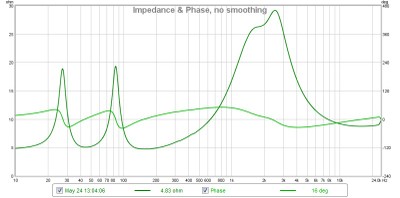

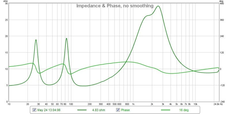

Revel Concerta2 M16 Bookshelf Speaker Electrical Impedance and Phase
Revel specifies the impedance of the M16 speakers at 6 ohms nominal. Looking at our impedance measurement, it would be difficult to dispute that rating. The M16s would not appear to present a fairly easy load for the vast majority amplifiers. A low-quality, entry- level AVR might struggle with the low-impedance valley centered around 150 Hz if cranked at loud volumes for long periods, but most receivers and amplifiers will have no problems with these speakers. All of the steep phase changes happen at high impedances and so are not cause for concern. There is nothing to worry about here unless you have a very badly-engineered amplifier in which case it's time for an upgrade.
Revel specifies sensitivity for the M16s at 86 dB for 2.83v at 1 meter, and our testing showed good agreement, 85.5 dB, which is a typical sensitivity for this type of bookshelf speaker. Again, this isn’t a speaker you want to build a THX-certified dedicated home theater around, but most users will probably never put more than 20 watts through these at which point they would be quite loud. However, if your listening position is going to be a more than 15 feet or so from the speakers, and you like to listen at high volumes, you may want to consider something more powerful or at the very minimum bass manage them by adding a powered subwoofer to increase system efficiency and bass extension.

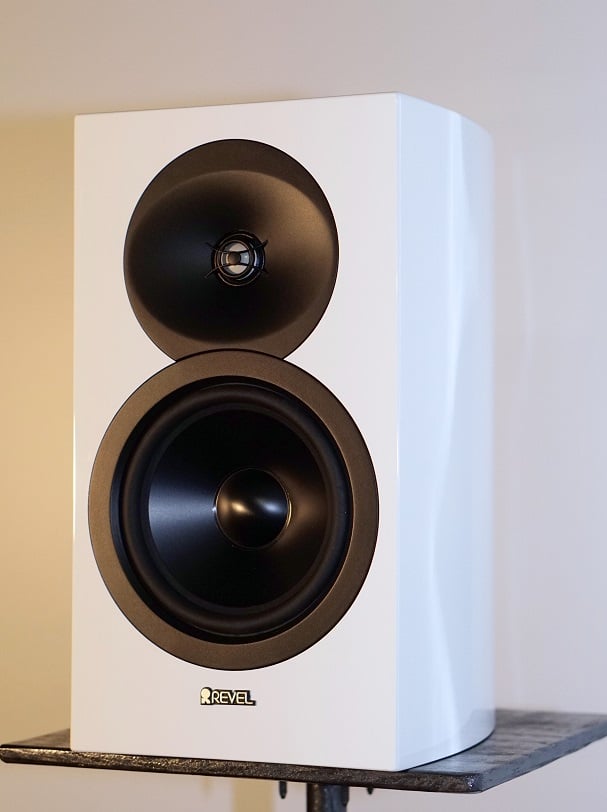

If you have read this review up to this point, you might guess that I liked the M16 bookshelf sperevel m16 b.jpgakers, and you would be correct. The Concerta M16s are a very well-rounded bookshelf speaker, and I have a difficult time finding any serious shortcomings with them when considering their intended application. If I absolutely have to nit pick, if only for the sake of some balance, I might say that some people would like a choice of wood finish instead of only black and white. But, few people could argue that they don’t look nice, so that criticism doesn’t have any real weight. I could point out that their frequency response isn’t perfect, but it is quite linear for the price, and I would be hard-pressed to name something that has a flatter response while keeping such an excellent dispersion for the same money. There may be bookshelf speakers out there that have more revealing treble, or more powerful bass, or exceed it in some other performance metric, but the M16s do a lot well and for a very reasonable price.
The M16s are very attractive speakers, and they are also true high-fidelity speakers as can be seen in our measurements.  At $900 a pair, I consider them a good deal for anyone on the market for a solid set of bookshelf speakers, and if you can get them for less, I would consider that a bargain. I began this review by asking if Revel was justified in bringing the M16s to a crowded market of similar speakers, and I will end it by concluding that, yes, these speakers absolutely deserve serious consideration.
