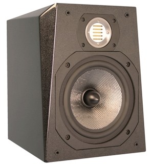

Legacy Studio HD in Black Pearl Finish
Legacy Audio Studio HD in Black Pearl Finish
At less than $1,800 per pair in standard finishes ($1,980 as tested), the more diminutive Studio HD Bookshelf speakers have the quality of cabinet and components that trickle down from Legacy’s higher-end offerings, in a more affordable and compact package.  Though Legacy makes a number of horizontally-oriented center channels, I requested 3 identical Studio HDs for a matching front soundstage in my 5.1 home theater.

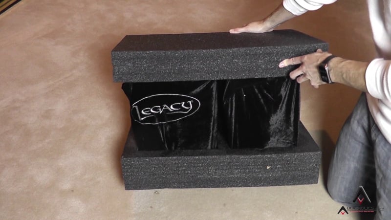

The speakers arrived adequately packaged, in a double-walled-box with reinforced corners.  Shipped via pallet, the speakers arrived safe and sound, with the boxes stapled shut for extra durability.  Foam inserts up to 3” thick held the speakers securely, and black velvet bags shrouded the speakers themselves.  The cloth grills were shipped already attached.
Legacy Studio HD Packing
The Legacy Audio Studio HDs were packing in 3" foam and velvet bags.

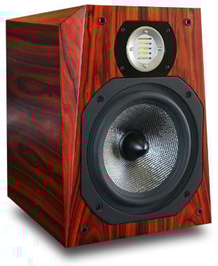

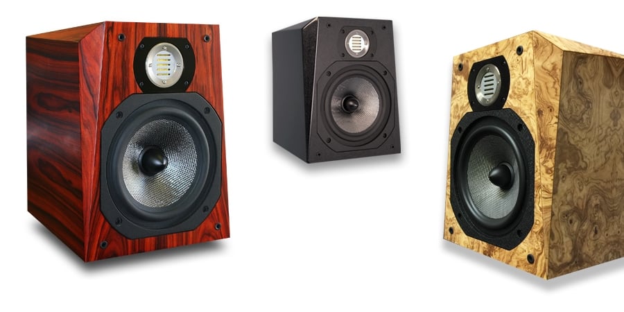

The Studio HDs were finished in “Black Pearl” in a process that takes 14 steps and 3-weeks to cure the finish.  “Black Pearl” could be mistaken for high-gloss piano black from a distance.   From a bit closer, it becomes apparent that it's actually a pearlescent sparkle akin to what you'd find on an award-winning show car.  It’s just enough to provide a little interest and signal that these are not your run-of-the-mill speakers, without drawing too much attention to themselves.  If that doesn't float your boat, you have 10 other options in real wood veneer from Standard Black Oak to some truly ostentatious finishes such as “Exotic Olive Ash Burl” or “Birdseye Maple.”
 Legacy Finishes
Four of the 11 finishes available, from left to right: Natural Cherry, Black Pearl, Olive Ash Burl, and Rosewood

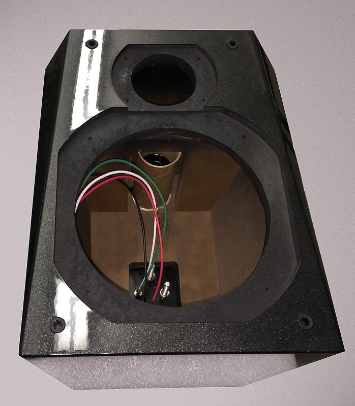

The cabinet itself is crafted of 1” thick MDF which is thicker than any bookshelf speaker I’ve laid hands on, no doubt contributing to the 31 lb weight of each speaker.  These speakers definitely meet our requirements for Identifying Legitimately High End: Cabinets.
Legacy Audio Studio HD Internal
Note the internal bracing, the 1” MDF construction, and the binding posts that will connect directly to the crossover.

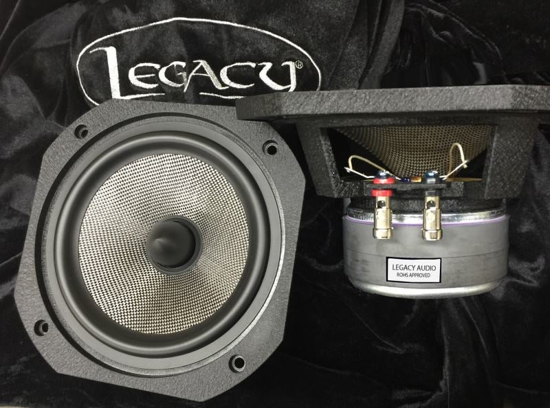

 Legacy Studio HD Woofer
The 8” woofer in the Legacy Studio HD features a double magnet structure and heavy cast frame.
Looking at the driver complement will give you a clue as to where some more of that weight comes from.  The Studio HD features a large 8” woven graphite woofer that is exclusive property of Legacy Audio and features a thick, cast basket.  The woofer is crossed over at 2.8kHz and phase plug is implemented to prevent acoustic interference across the large surface area of the driver.  The tweeter is a metal-encased, 1” AMT, or Air Motion Transformer, which operates like a small accordion squeezing out high frequencies.  The use of AMTs is rare, but growing more common as these tweeters are being recognized for their low distortion characteristics and “speed”, an audiophile term for the time it takes a driver to transition from silence to active and back again to silence making staccato notes really snap and high-frequency detail more realistic.  The Legacy Studio HDs meet our Identifying Legitimately High End Speakers: Drivers.

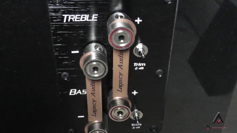

Around the back of the Studio HD, you’ll find 2 pairs of binding posts for bi-amping and a pair of insulated copper jumpers for standard wiring.  The Studio HD is rear-ported for greater bass frequency extension, so you might not want to wall-mount these 31 lb speakers.  You’ll also find a filter switch that shelves high frequencies by -2dB at 10kHz for bright rooms.  Another switch shelves low frequencies by -2dB at 60Hz for placement near boundaries, and raises the impedance for use with budget amplifiers.  Left in the “up/off” position, the Studio HD is anechoically flat across a broad range to an order of +/- 2dB from 41Hz-30kHz, according to the manufacturer specs.  I’ll revisit the audible effect of these switches in the listening section.
Binding posts all start to look alike after a while, but Legacy has gone to lengths to make theirs stand out.  The posts are large enough and spaced wide-enough to accommodate very large wire gauges and the most substantial of spades and rings.  I’ll pick one nit here: the posts have a smooth texture with no ridges or knurling.  This made for a slightly slippery grip when trying to crank them down tight.

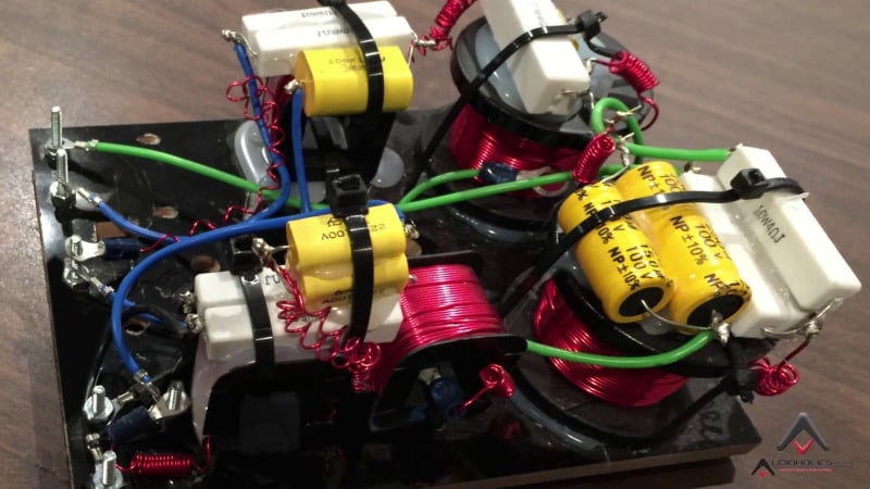

Legacy Studio HD Crossover
The binding posts are also designed to extend all the way through the crossover circuit board for a direct connection to ground and the hand-wired circuit.  In talking crossover design, Bill Dudleston, the President and founder of Legacy Audio, notes the capacitors and resistors are positioned atop the chokes to aid as thermal sinks.  This also allows Legacy to individually adjust the zobel and driver resonance damping circuits, matching the speakers output first to a reference curve, and then to each other in a matched pair (or set of 3, in my case).  Again, these speakers meet our Identifying Legitimately High End Speakers Crossovers.
The process looks like this:  a microphone is placed 1.5 meters away, equidistant to each speaker.  The input to the right speaker is inverted.  This subtractive technique isolates the difference between the loudspeakers, and adjustments are made to minimize the difference.  To be clear: this happens to every, single Legacy speaker.  Where other manufacturers might simply slap together identical components and hope that manufacturing tolerances are tight enough to provide similar performance from unit to unit, Legacy verifies this by instrument and ear for every product sample to ensure consistency.  This hand-tuning of every speaker is, to paraphrase Bill, “where science meets art.”

I did find that I toed-in the Studio HDs far less than my other speakers.  To my ear, the on-axis high-end was a little more pronounced than I preferred.  Here is where I tried out that high-filter switch.  Flipped in the circuit, the reduction in high-frequencies was suitable for restoring balance in a bright, untreated room, or in a smaller room where positioning may not be ideal.  However, in my room, I felt the filter whittled away the lively high-end detail of the Studio HD.  In the end, I much preferred the filter “off” and the speakers with only slight toe-in.  The produced a spacious image with high-frequency sparkle that brought my music to life.

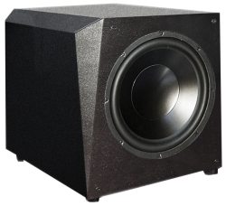

Legacy Metro
Legacy Audio Metro Subwoofer
Don't get me wrong: the Studio HDs are sufficient for most music listening;  however, like any bookshelf speaker, they are best when mated with a subwoofer.  Legacy’s Metro is a perfect aesthetic match for the Studio HD, and would provide true full-range performance.  With a sub filling in the last 2 octaves, and the Legacy carrying the lion’s share of the spectrum with their detail, dynamics, and spaciousness, “Another Country” filled the large room with delicate shakers and percussion, Wilson’s rich vocals, and a bouncing bass-line.

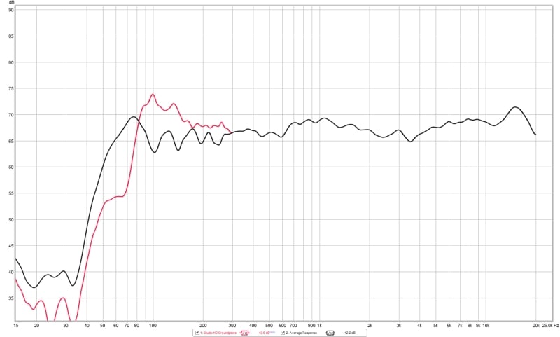

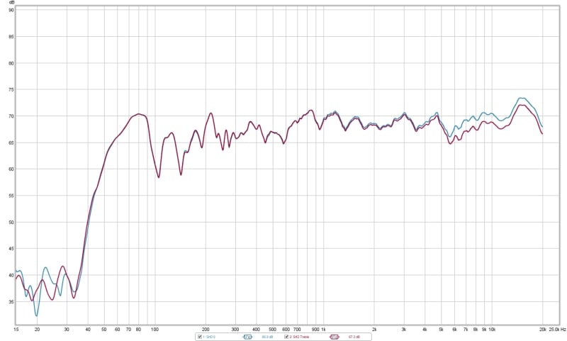

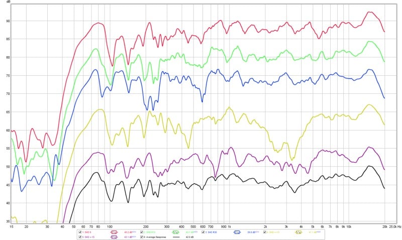

Legacy Audio Studio HD Measurements and Analysis

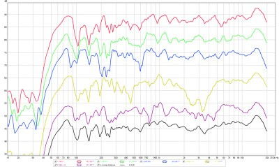

The graph below shows the frequency response of the Legacy Studio HD on-axis (red), 15 (green) and 30 (blue) degree off-axis horizontally, 15 degrees off-axis above (yellow) and below (purple) the tweeter, and an average of these responses (black) at 1 meter, smoothed 1/12 of an octave, and offset for easier viewing.  All measurements were taken in room, so keep in mind that the low-frequency response is affected by room modes.
Listening Window Response
Listening window response of the Legacy Audio Studio HD
And here is the average response spliced at 300Hz with a .5 meter indoor ground-plane measurement for a more accurate picture of the bass response.
 Average and Groundplane
Averaged Listening Window Response (Black) and Indoor .5 meter groundplane (Red)

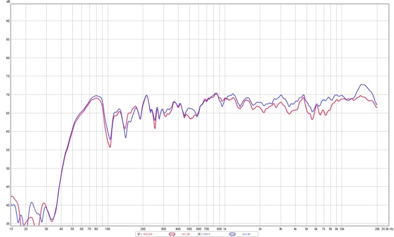

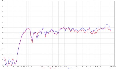

You might notice that slight rise around 15kHz.  All measurements were taken with the grill off, while I did the vast majority of my listening with the grill on.  In the graph below, you can see on-axis measurements with the grill on (red) and off (blue), and how that rise is flattened with the grill in place.
Grill On Off
In-Room Frequency response, on-axis, with the Grill On (Red) vs Grill Off (Blue)

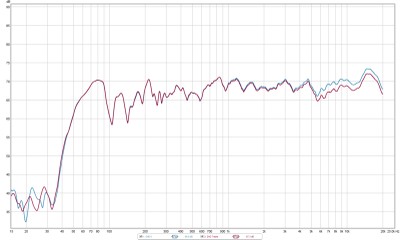

Below is the on-axis response as affected by the Treble Filter Switch.
 Treble Switch
In-Room Frequency response, on-axis, with the Treble Filter In (Red) vs Out (Blue)
The treble filter produced predictable results, dropping the high frequencies centered at 10kHz by about 1.5dB, a little less than spec.
