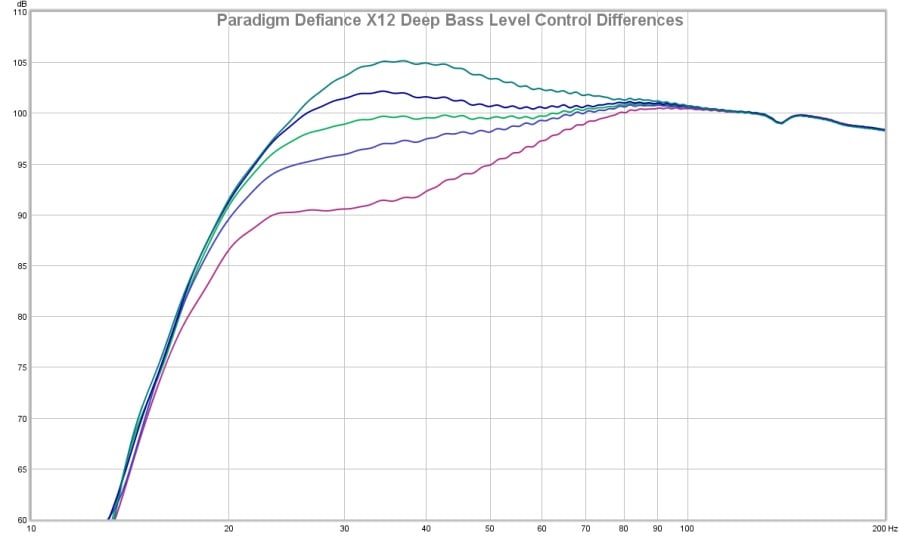

  • Controls (via Bluetooth):
    Level: -40 to 12dB
    Low-Pass Filter (Frequency): 35–120Hz
    Low-Pass Filter (Order): Bypass, Third, Fourth
    Phase: 0–180° (1° Increments)
    Phase (Polarity): Normal, Inverted
    Preset Listening Modes: Music, Night, Movie
    20–30Hz Level: ±10dB
    Anthem Room Correction (ARC): On, Off
    Tone Sweep (20–120Hz): On, Off, Pause (Frequency)

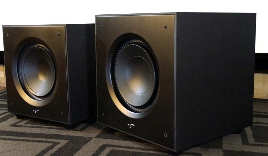

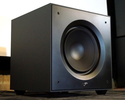

Paradigm Defiance V12 (left subs) and X12 (right subs)

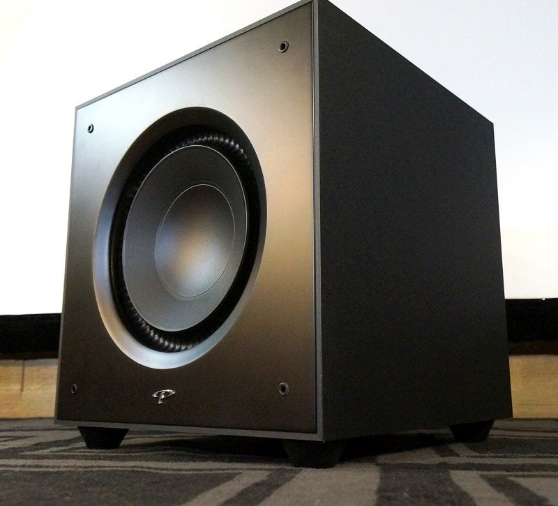

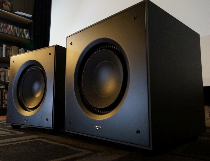

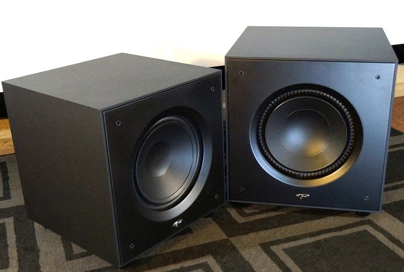

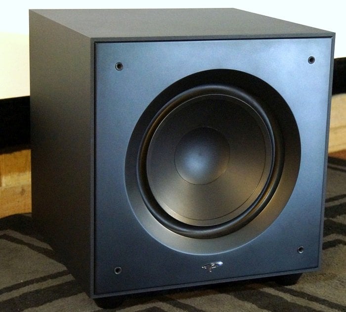

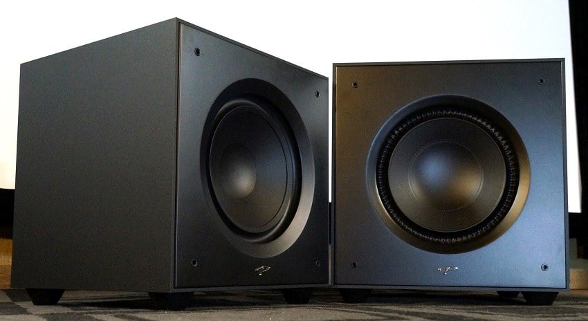

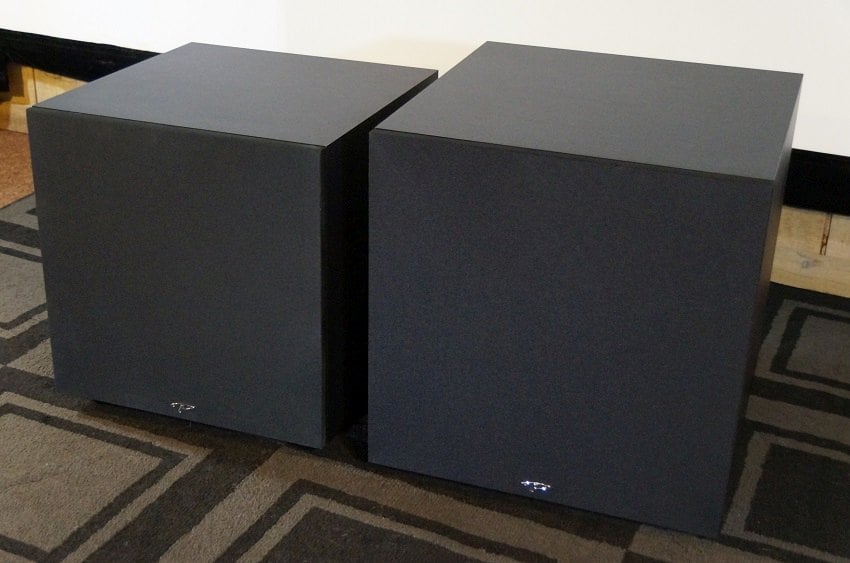

Unpacking the Defiance subs revealed two stylistically minimalist subwoofers that are reminiscent of two recently reviewed subwoofers, the MartinLogan Dynamo 600X and 1600X. The Defiance subwoofers are starkly cube-shaped and devoid of any other particular features outside of their flush-mounted, front-firing woofers. The edge lines are clean and very angular. These enclosures embrace their cube shape rather than trying to soften them by rounding off edges or going for rectangular dimensions. The subwoofers have a satin black finish that is more like a very finely textured black rather than a smooth finish. The front baffle almost looks like a painted aluminum, so it appears to be a bit higher-end than it really is. The drivers for both subwoofers use inverted surrounds, but the X12 surround has a ribbed shape that makes it a bit more visually interesting. Both cones use inverted dustcaps so the woofer appearance is that much cleaner.

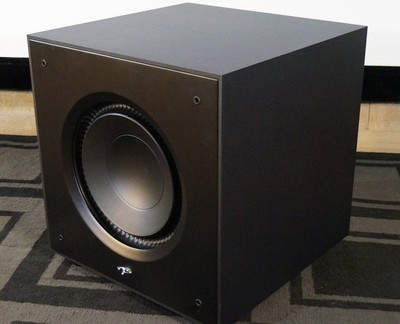

The Defiance subs come with grilles, and the grilles simply hide the drivers and make the sub look more cubish, almost like an abstract building block. If you hate the sight of woofers, these grilles do a great job of masking them. With grilles on, the subwoofers become very simple objects, visually speaking. They become dark cubes with only a small Paradigm ‘P’ insignia at the lower front as their only distinguishing feature. For those who want perfectly flat, featureless surfaces, that insignia looks like it could be easily removed. As always, I prefer the appearance without grilles; these are some nice-looking woofers, in my opinion. Since the appearance of these subwoofers is so simple, they could fit in a wide variety of décors, from traditional to modern. They will not clash with many interior design schemes, and their low-key finish would make them fade into most rooms if tucked somewhere out of the way.
The Defiance subwoofers are stylish without being conspicuous or flamboyant. They are clean-looking and inoffensive, but not uninteresting. Personally, I like the way they look, and I don’t think many people would object to their austere aesthetic.

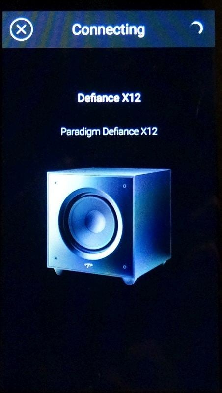

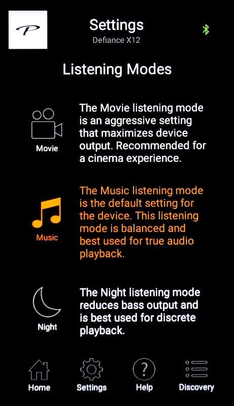

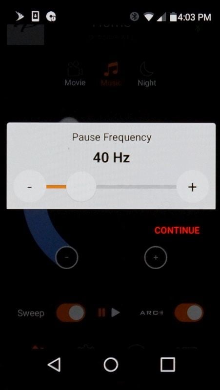

Since much Paradigm app tone sweep.jpgof the software feature set of the Defiance subwoofers is almost exactly the same as the MartinLogan Dynamo subs, I will just copy what I wrote in that review to describe the wireless aspects of the Defiance subs, only changing the brand names of these products: The plate amp for the V12 and X12 have only a volume knob as a physical means of control. Paradigm has allocated all other controls of the Defiance subwoofers to a smartphone app that is compatible with iOS and Android devices. The ‘Paradigm Subwoofer Control App’ has all of the conventional control functionality of regular panel controls and a few neat features that are well outside the ability of typical subwoofers. The Paradigm Subwoofer Control App can control the volume, low-pass filters, phase, low-frequency boost (that can adjust the 20-30 Hz region by ±10 dB) and can access preset listening modes. One unique and useful feature of the Paradigm Subwoofer Control App is the ability to run a tone sweep from 20 Hz to 120 Hz that allows the user to pause and hold the tone at any frequency in this range. This feature allows the user to identify points of audible in-room rattling and vibrations. The Paradigm Subwoofer Control App can control a multitude of subs independently. The App also has helpful explanations for every control, so the user isn’t forced to refer back to the manual to understand every aspect that can be changed.

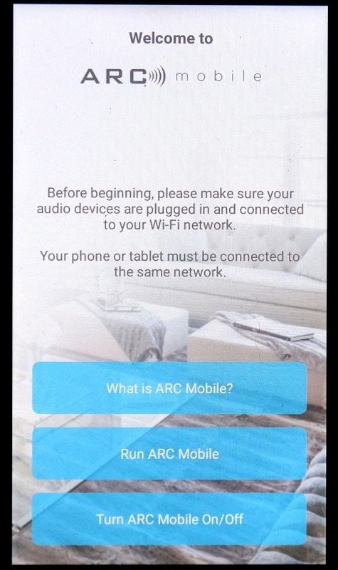

Paradigm app arc intro.jpgAs was mentioned above, the Defiance subs also use Anthem’s ARC Mobile App. Audioholics previewed the Anthem ARC Mobile App with good results. ARC is the highly-regarded room correction equalization software developed by the audio electronics manufacturer Anthem, and the ARC Mobile App brings that equalization functionality to Android and iOS devices. For ARC-enabled speakers such as Paradigm’s new Defiance subwoofers, ARC Mobile uses the microphone of the iOS or Android device to record the in-room frequency response of the subwoofer. ARC’s algorithm then forms a correction curve which is sent to the subwoofer for a more linear and smoother sound at the listening position. Since low-frequencies are the band that is most dramatically affected by room acoustics, this can be particularly helpful in achieving an even, neutral response. The ARC Mobile App makes it simple to EQ troublesome room modes that are the plague of subwoofer frequency bands, and no wired components are needed to use it. One major advantage that the Defiance X12 has over the V12 for ARC control is that the X12 comes with an ARC microphone which is sure to offer a more precise response than a smartphone microphone.

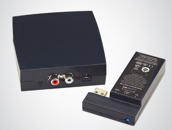

Paradigm wireless transmitter.jpgWe should also talk a bit more about the Defiance wireless signal system. The Defiance WT Wireless Module is sold separately and does away with the need for a physical wire for the signal. Omitting the signal cable can greatly increase the availability of potential placements for the sub, and since the placement of the subwoofer is so critical in getting good sound, this can be a very significant assist in sound quality. The Defiance WT Wireless System uses 2.4 GHz dynamic frequency selection and error correction. The receiver end of the Defiance WT system is powered by the subwoofer itself and so does not need to be plugged into a power outlet. The Defiance WT Wireless Subwoofer System has a 50-foot range, so it should be able to handle any conventional domestic room size without a problem.

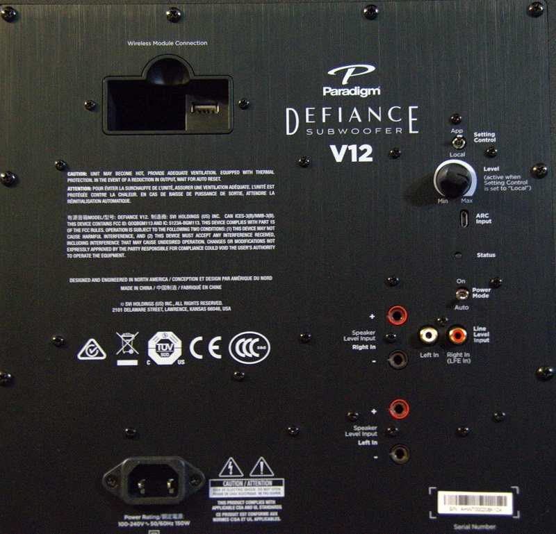

Paradigm Defiance V12 backpanel (left pic) X12 backpanel (right pic)

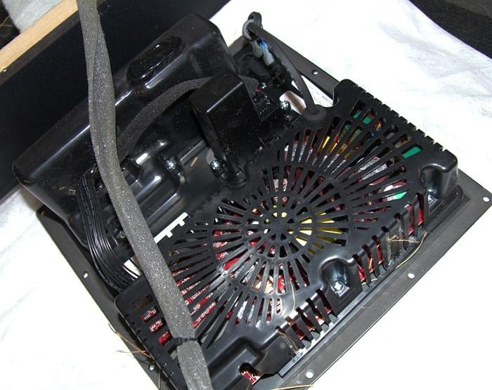

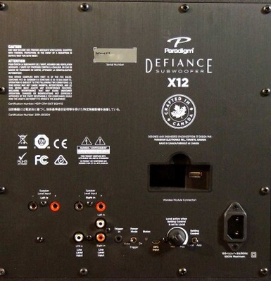

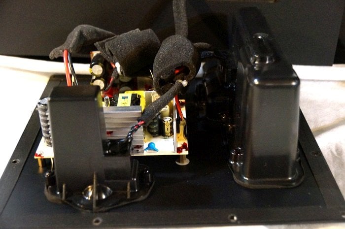

Let’s now discuss the more traditional nuts-and-bolts design aspects of the Defiance subwoofers. We will begin by talking about the amplifier. Both the V12 and X12 plate amps have left/right line-level RCA and speaker level inputs, although the X12 also has as a dedicated LFE input, whereas the LFE input is shared on the right RCA input on the V12. The X12 also has a dedicated 3.5mm trigger input which allows for a dedicated power-on signal from the receiver or preamplifier. The X12 amplifier is a lot more powerful than the V12 amplifier: 650 watts RMS vs. 120 watts RMS respectively. If all other things were equal, that extra power would translate into an approximately 7.3 dB increase in headroom alone, but, as we shall see, all other things are not equal.
Paradigm Defiance V12 amplifier (left) and X12 amplifier (right)

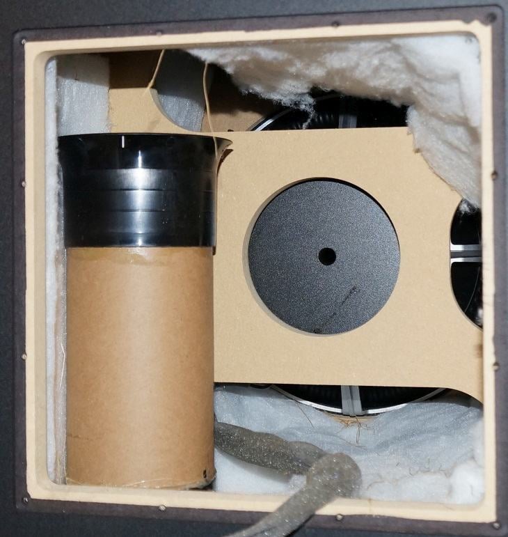

Paradigm Defiance V12 cabinet interior (left) and X12 cabinet interior (right)

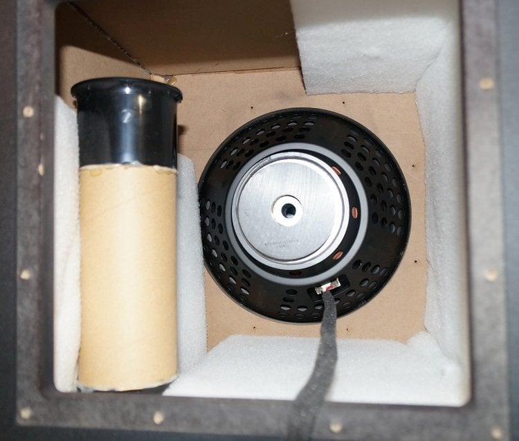

One unequal point between the X12 and V12 is the cabinet size; the X12 has a significantly larger cabinet at 3.8 cubic feet vs the V12’s 2.9 cubic feet. This difference matters. Larger cabinets make for more efficient systems and lower resonant frequencies, and these are always good things for subwoofers. The larger enclosure can accommodate a larger port, and that means more low-frequency output for the same amount of wattage. The X12 takes advantage of the larger enclosure to use a larger 4” diameter, 14” long port versus the V12’s 3” diameter, 12” long port. The X12’s port is heavily flared at both ends too, which should help to reduce turbulence noise (“port chuffing”). The X12 has more internal stuffing, and it also has a windowpane brace. The V12 does not have any internal bracing, but it will not need bracing nearly as much, because it is using a smaller cabinet and a less powerful amplifier and driver, so the enclosure paneling will not be subject to nearly as much internal pressure.
Paradigm Defiance X12 driver (image courtesy of Paradigm)

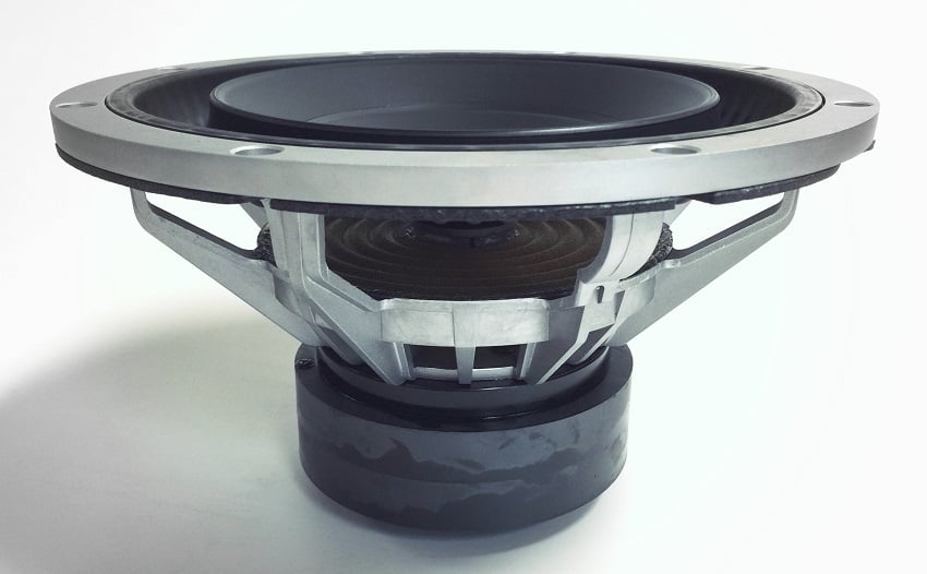

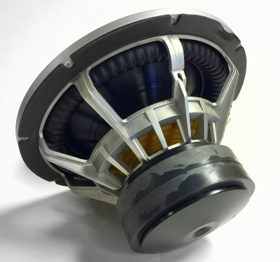

Speaking of the drivers, the X12 driver looks to be much more formidable than the V12. That isn’t to say that the V12 driver looks bad but rather both drivers are commensurate with their price points. The V12 driver uses a stamped steel frame and a single 5” diameter, 1” thick magnet with a 1.5” voice coil whereas the X12 driver uses a cast aluminum basket and two 1” thick magnets with a larger 6” diameter and 2” voice coil. Given the much more powerful amp in the X12, it is safe to assume that it will have a more massive voice coil as well. While the V12 driver looks adequate for the task, the X12 driver appears to be a real powerhouse.

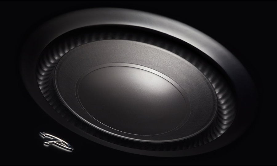

The X12 driver has a ribbed shaping in the surround that Paradigm calls the ‘ART’ surround. ART is the name Paradigm has given to their patented surround design that uses a pleated ‘ribbing’ over the length of the surround; it is an acronym which stands for Active Ridge Surround. Supposedly, ART allows for more headroom than conventional half-roll designs. When typical surrounds are stretched at high excursions, particularly in the inward-stroke, deformations can occur from the high tension, and these deformations can cause distortion or even tears in the surround. This ridged surround design by Paradigm supposedly reduces these deformations by directing material stress to points that can better cope with it due to the shape of the surround. Paradigm claims that ART allows 1.5 times the excursion for the same surround roll that results in a 3 dB increase in headroom.
One slight oddity that we see is the V12 driver has a bucking magnet applied on the back of its motor. Bucking magnets were used to control stray magnetic fields from interfering with exterior objects such as CRT displays and cards with magnetic strips, but they are not often seen used much anymore. When I asked Paradigm about the inclusion of the bucking magnet, they said that they can be used as a cost-effective way of adding more magnetic flux to the motor.

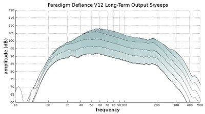

The V12 replayed ‘Dynamis’ shockingly well considering its relatively modest 120-watt amplifier. I wouldn’t have guessed that it could have delivered as much punch as it did, but it brought some real power to the reproduction of ‘Dynamis.’ However, compared to the X12, there was a limit that the V12 was running up against, although it wasn’t obvious when listening to the V12 itself. The X12 was clearly capable of more, but that is no surprise. Cranking the volume on ‘Dynamis’ and running the bass hot on the X12 was an experience that provoked an utterly primal, ‘fight-or-flight’ reaction. This thing was scary for what is essentially an 18” cube, which is not a huge enclosure size for a ported sub. Its size absolutely belies its power. When the kick drums hit, I could feel it impact my entire sofa. In my notes I wrote, “How is a 12” doing this?!” While I had found that the Defiance subs could do delicate and subtle bass on previous albums, ‘Dynamis’ showed me that they could also be ferocious and violent when called upon. These subs might not be the refrigerator-sized monsters that can be had from some internet direct manufacturers, but for deep-digging, bass-heavy electronic music, they are no lightweights. The V12 proved to do good with this type of material, but the X12 was positively stellar.
