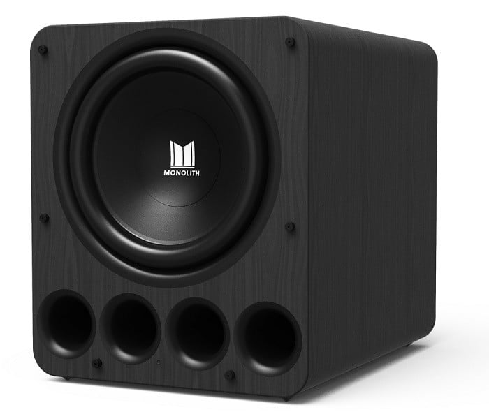

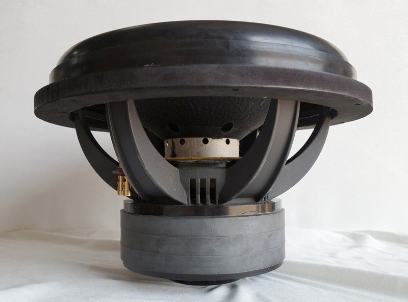

The Monolith 16” THX Ultra shares many of the same characteristics and features as the Monolith 13” THX Ultra, and we have covered that pretty extensively in the 13” THX Ultra review, so we will mostly just touch on the differences. One major difference, as the product name implies, is the cone diameter; the Monolith 16” THX Ultra uses a large 16” cone. Cone diameter is one thing, but without adequate excursion, the largest cones are for naught, and here the 16” cone is backed by a great deal of excursion. This is evidenced by its absolutely massive surround. The motor is largely the same, which is good because the 13” THX Ultra motor was gigantic and should easily be enough to throw around the extra cone mass of the 16” cone. Outside of the larger cone and the measures taken in the surround to accommodate the increased cone diameter, the driver remains very similar to the 13” THX Ultra.

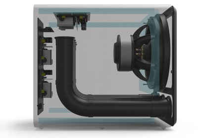

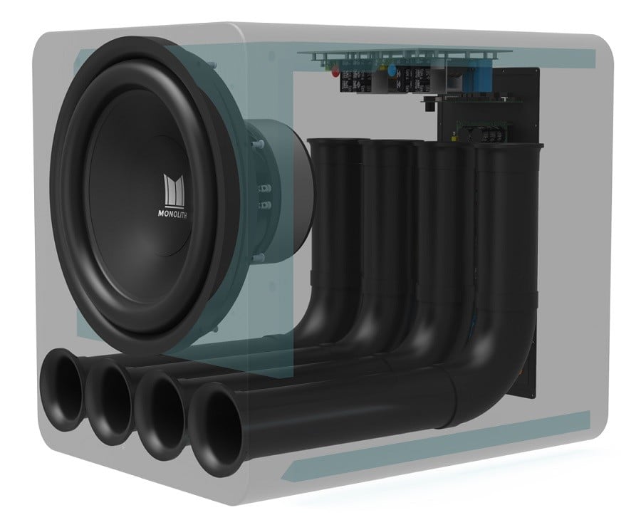

The amplifier is pretty much the same as the 13” THX Ultra as well. Of course, different filters and DSP settings were used to achieve target responses given the larger cone and enclosure, but physically, it’s the same 1,800-watt amp. The enclosure is significantly larger and uses four 3 ¼” diameter ports instead of three. That should give the 16” THX Ultra a significant advantage in port-generated frequencies over the 13” THX Ultra, and the 13” THX Ultra was quite powerful as it was.

Monoprice includes ports plugs for all four ports, and we do show the response for a sealed mode with all ports plugged, but there isn’t much sense in running a huge sub like this in a sealed configuration. Take advantage of this subwoofer’s capability and run it in a ported configuration. All modes stretch to 200Hz without losing any power, so despite the large driver diameter and tremendous excursion ability, the Monolith 16” can still be used to support upper-bass frequencies in systems that have that requirement. The sealed response makes the stretch to above 250Hz without a significant shortfall in the response, and that is because it isn’t seeing the pipe resonance just above 200Hz that occurs with ports open.
It isn’t recommended to run the Monolith 16” with just one or two ports open, and that is not an officially supported operating mode, because the sub wouldn’t have enough port volume to cope with the amount of air being moved. It would be prone to turbulence with only one or two ports open. Theoretically, it would lower the resonant frequency of the ports, but the Extended EQ filter would probably shave off most of the lowered bass extension in that kind of configuration, so there is no advantage to doing that.

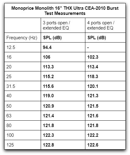

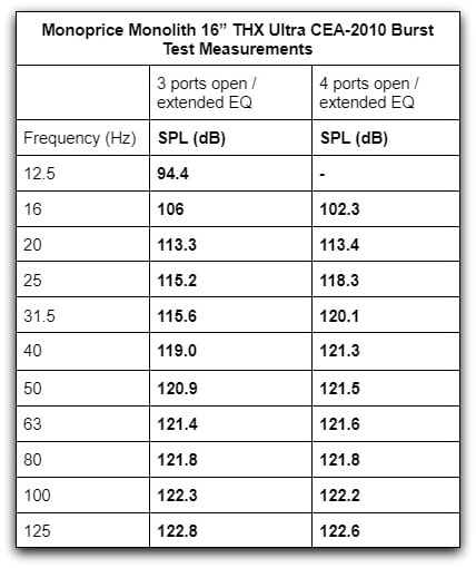

The above CEA-2010 measurements are short-term bursts that show the subwoofer’s clean peak SPL before heavy distortion sets in. Our measurements have been referenced to 2-meter RMS, which is 9 dB down from the standard requirement for the measurements to be shown at 1-meter peak. However most publicly available CEA-2010 measurements are shown at 2-meter RMS, so we followed that convention. The Monolith 16” puts out some monster numbers here, greatly surpassing the 13”. In deep bass at 31Hz and below, the difference is roughly 3dB, but in mid-bass at 50hz and above, the difference seems to average about 4dB. These are huge numbers, and they tell us that the Monolith 16” can produce more than 50% more output than the Monolith 13” while only having a 25% cost increase; this is well worth the premium if you can handle the larger size and weight (this sub is gigantic). Needless to say, the Monolith 16” easily earns our Bassaholic “Extreme” Room Rating, meaning it is sufficient to charge a room of 5,000 cubic feet with powerful reference level bass.

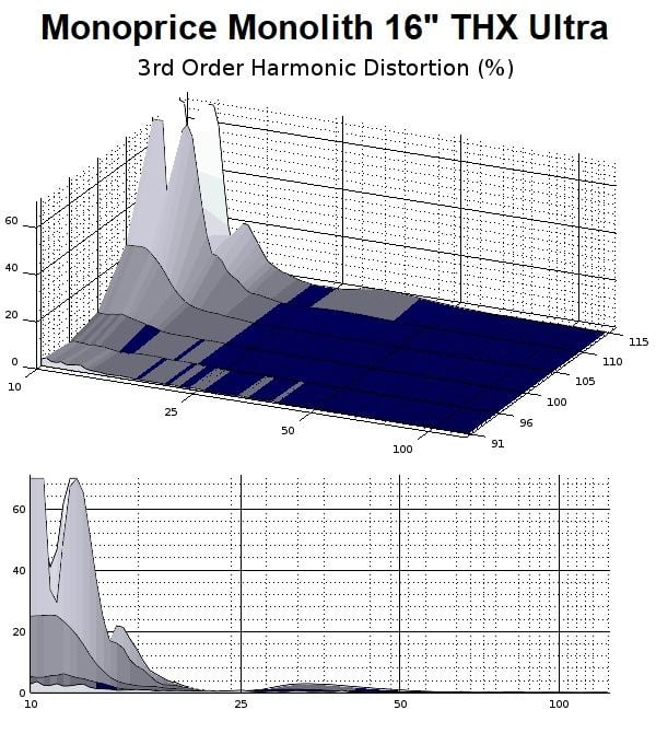

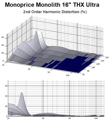

The above graphs show the corresponding total harmonic distortion to the long-term output graphs. Essentially, they depict how linear the subwoofer remains for the corresponding drive level seen in the long-term sweeps. The quantity being measured is how much of the subwoofer’s output is distortion and is shown here as a percentage. This is terrifically clean performance exhibited by the Monoprice 16” and can’t be pushed above 10% THD until well below 20Hz. It can be pushed to extraordinarily loud levels without breaking a sweat. At nominal levels at the 95dB sweep and below, it can barely even reach 2% THD above 20Hz. Here is evidence of superlative engineering; it isn’t too hard to get huge output from an extreme long-throw driver with a large cone, 1,800 watts, and an enormous ported enclosure, but to do so with such a great degree of accuracy is the tricky part. For all the brute force on display, it is not without precise application of power. This isn’t just a fast car in a straight line car; it can corner nicely as well.
The above graphs depict measurements of the constituent harmonics from the long-term output sweeps and are what the total harmonic distortion measurements are composed of for the 2nd and 3rd harmonics. These individual harmonics can give us a clue as to what might be the cause of some quirk or non-linearity. We are only showing the 2nd and 3rd here because they more or less reflect the higher even-order and odd-order behaviors, although higher-order harmonics tend to be much further down as a percentage of distortion compared to the second and third. Since there is not much total harmonic distortion from the Monolith 16”, we don’t see much distortion from either the second or third harmonics, at least until down to 16Hz. However, output is falling rapidly under 16Hz, so there is very little output at all, let alone distortion, and distorted output only occurs at higher drive levels as well. Lots of liner throw given lots of power adds up to lots of clean, undistorted output.

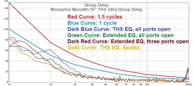

Group delay is the measurement of how much time it takes for individual frequency bands of an input signal to be produced by the speaker. It can indicate that some frequency components are developing slower than others or are taking longer to decay. It is generally thought that 1.5 sound cycles are needed for group delay to be audible at bass frequencies, although there is an argument that group delay should remain under 20 ms to be completely unnoticeable, but that is likely meant for mid and upper bass frequencies. This is an interesting set of results from the Monolith 16”. The results are all very good, and they all manage to stay under 1 cycle, save for the ported THX EQ configuration. This is similar to what we have seen before from Monoprice’s Monolith series; ported subwoofers that somehow keep group delay under 1 cycle! There has to be some kind of DSP trick that manipulates phase to do this. Port output is normally a cycle of phase behind the driver output, and this shows up in group delay measurements similar to what we see in the THX EQ curve, and in most subs, it’s quite a bit higher than even what is shown there. Somehow Monoprice has found a way to keep port output below a one-cycle lag. This is abnormally good among ported subs but par for the course for Monolith’s THX subs. Group delay stays under 10ms above at 40Hz and above where it would be most audible. Delay doesn’t surpass 20ms until below 30Hz, not including the ported THX EQ configuration. This is better time-domain performance than many sealed subs I have tested!
