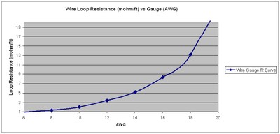

American wire gauge (AWG) is a system of numerical designations of wire diameters where the thicker and less resistive the wire is, the lower the gauge number. More often than not, we’ve seen Audiophiles choose a higher gauge esoteric wire over a lower gauge generic zip cord cable simply because they were sold some marketing nonsense from the exotic cable vendor that their wire will yield higher dynamics and better Mojo from your system than standard generic cable. Don't believe me? Check out some of the "midpriced" speaker cables from the likes of Audioquest and Nordost as example and you will see they are anywhere from 16-18AWG. This is much higher resistance than cheap 12AWG zip cord cables you can buy at a local hardware store. To see this graphically, note the resistance vs gauge table below.
Gauge vs Resistance
Loop Resistance vs Gauge (AWG)
 ..the dominant metric of concern is DC resistance in speaker cables.
Only the truth will set you free, so its time to clear your head of marketing slogans and get a good dose of reality about the single most important aspect of speaker cables – RESISTANCE. Anytime you are driving power into a low impedance load such as a loudspeaker, the dominant metric of concern is DC resistance (measure of restriction of conductivity in a circuit). Certainly there are secondary concerns which are also important such as inductance, and capacitance. But, as we’ve proven in our various cable articles and reviews, if you cannot first select a cable with low enough DC resistance, the losses will be so great between the amplifier and loudspeaker that all other cable parameters will become a wash. This article will focus solely on cable resistance and will serve as a guide for choosing the right wire gauge (AWG) for your installation to ensure you realize the maximum potential of your setup.

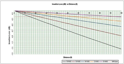

In order to minimize the potential of audibility here, I have established a guideline of the maximum acceptable degree of insertion loss that a cable should present to the system so that when a real world amplifier and loudspeaker are connected, the cable resistance will have a negligible contribution to the overall system response. I plotted the Insertion Loss (dB) vs Distance (ft) for various cable gauges from 18AWG to 10AWG using an 8 ohm speaker load.
If you are truly concerned with top notch fidelity, then:
ILoss < -0.2 dB
(this is a very conservative estimate as the threshold of audibility is often cited at +-1dB)
Insertion Loss vs Distance
Figure 1. Insertion Loss vs Distance for Various AWG Cables
As you can see in the graph, once your distances exceed about 10 feet, you should consider speaker wire 16AWG or lower. If you are using a loudspeaker that is rated at 4 ohms, the critical distance becomes about half that. It is really important to use thicker wire for long cable runs, especially when driving a lot of power into low impedance loudspeaker systems.
