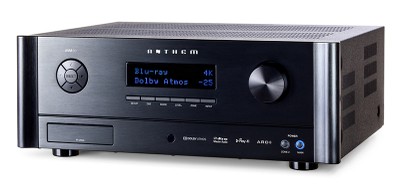

Anthem AVM 60 Introduction & Features
If someone were to write the history of high-end home theater, Anthem’s preamp-processor line would surely merit a spotlight. Anthem’s pre-pros are legendary. Their build quality, sound, upgradability, and of course heralded ARC room correction are just some of the factors that have made Anthem’s product line a huge success over the years.
Anthem AVM60 11.2CH AV Processor YouTube Review
When new technologies have come about, however, high-end boutique brands like Anthem usually aren’t the first ones out the door with new products. So when HDMI 2.0, HDCP 2.2, Dolby Atmos, and DTS:X hit the scene, it wasn’t necessarily a surprise that Anthem was holding fast to its long-in-the-tooth AVM 50v 3D pre-pro. While there were rumors and rumblings about an AVM 60 for years, there was nothing concrete… until now.
Anthem’s AVM 60 is by all accounts the long-awaited successor to the acclaimed AVM 50v 3D pre-pro and it checks off nearly all the essential boxes. On-board HDMI 2.0a with HDCP 2.2, HDR, and BT.2020 are all standard.

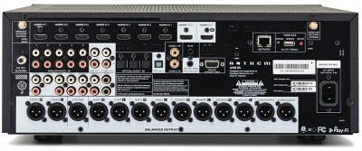

Anthem AVM 60 Rear View
Rear view of the Anthem AVM 60.
The rear panel layout is identical to the current MRX x20 models. Instead of speaker binding posts, the AVM 60 has balanced outputs. Say bye bye to AM radio, multiple trigger outputs, component video output, and balanced analog inputs.For the first time, the AVM 60 brings standby HDMI bypass. You designate which HDMI input (including last used) functions as the bypass via the unit’s menu. Unlike the AVM 50v models, the AVM 60 eschews any on-board video scaling or processing.

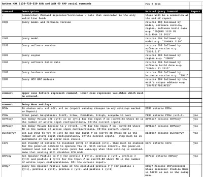

Serial Commands
The AVM 60 has an extensive IP and RS-232 command set that is fully documented in a downloadable Excel file from Anthem's web site.
This reality simply means that with the AVM 60, you’ll need to push some of this functionality over to your home automation system, (assuming you have one). With the AVM 60’s rich IP and RS-232 command set you can accomplish seemingly any task easily. You can download an Excel file from Anthem’s site that that outlines every command you can call on the AVM 60. I’ve written some custom installation scripts using the RS-232 command set on the AVM 50 platform and was very happy to see that I had the same detailed control with the AVM 60.

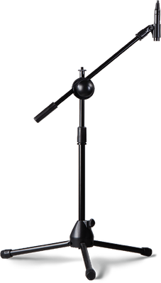

Basic setup was very straightforward. The ARC-2 room correction system comes with a high quality calibrated microphone and a real microphone stand—not the cheap cardboard garbage you get with other systems. My only constructive observation about the AVM 60’s microphone stand is that even though it’s light, it is a bit short. I suggest making the modest investment in a longer boom arm to fit the stand to make all your calculations easier to do.
ARC microphone stand

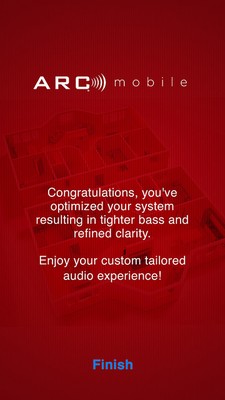

I ran ARC 2 from a Mac running Bootcamp and Windows 10. I also played with ARC using the iOS app. Because Anthem didn’t have the calibrated microphone for iOS devices available yet, I didn’t use the ARC App’’s measurements for any critical listening.
I initially had a few issues with ARC-2. Every time I would run ARC-2, I would always get an error indicating there was too much background noise (even when there wasn’t any). No matter what I did and no matter what physical location I was in, I always got the same error immediately when trying to run ARC for an initial sweep. Pressing the “Try Again” button got things working every time without any errors and the results were always superb. I contacted Anthem about this issue and the most recent software update should fix that minor annoyance.
Small bug notwithstanding, ARC-2 is incredibly fast, accurate, and yields some of the best sonic results I’ve heard in my room. There’s just no other way to say it.

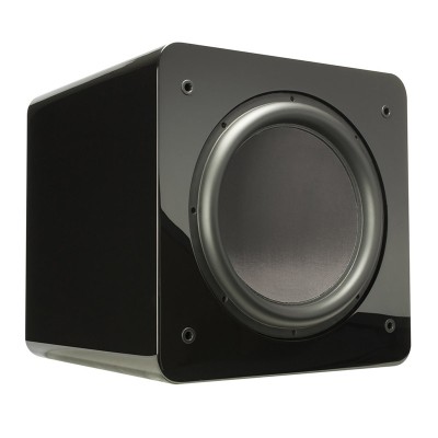

SVS SB13-Ultra Subwoofer
We tested the Anthem AVM 60's multi-sub support and ARC's ability to calibrate multiple subs with dual SVS SB13-Ultra subwoofers.  The results were stunning.
Why are multiple subwoofers important (if not essential)? The reason is simple: Multiple subwoofers produce a smoother in-room frequency response than just one subwoofer alone.  You don’t add more subs just to get stronger bass.  You add more subs to better quality bass.  It’s not just our opinion, its a fact proven by research. We have written several articles on both the benefits of multiple subwoofers and placement locations for multiple subs here on Audioholics that you can reference. You can  also check out our Audioholics multliple subwoofer setup guide here.
Oh, and speaking of multiple subwoofers, ARC measures them correctly. The sonic results? Simply stellar.
So many room correction systems don’t get multi-sub calibration right.  That’s right, most room calibration systems handle multiple subs incorrectly. They calibrate each sub individually. That’s flat out wrong. While this approach may seem logical to the average consumer, room correction should calibrate the sum of all subs playing in room and only then apply EQ to the combined, average curve.  This is the only way to do multiple subwoofer EQ correctly and thanks to our advocacy here at Audioholics some very well known Room EQ solutions have changed how they approach multiple sub EQ. Kudos to Anthem. They have been doing multiple sub EQ correctly from day one.

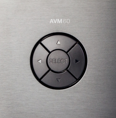

Inputs Go Virtual
There are no source input buttons on either the chassis’ face or the remote control. Every input is virtual. To select the input you want, you need to scroll through them one at a time (the sole exception to this rule is if you use Anthem’s iOS app or IP or RS-232 commands). This took some getting used to, but you have a seemingly infinite number of inputs at your fingertips.
AVM 60 Input Selection
There are no physical input buttons on the AVM 60. You scroll through the virtual inputs you create either from the unit's front panel or from the backlit remote control
As you’d expect in a high-end pre-pro, every input is assignable.  You can assign any HDMI input, digital input, or analog input to a source. You can even have analog inputs as fallbacks should there be no digital signal. You can even have two or more inputs be exactly the same with the only difference being the the ARC speaker profile. You could therefore have one input designated as “Blu-ray with screen up” and another as “Blu-ray with screen down” and apply a difference ARC profile to each. While custom installers will perform these tweaks for affluent clients, it’s important to highlight these granular features for the enthusiast crowd too.

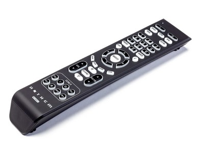

Anthem AVM 60 backlit remote control
Anthem's back-lit IR remote control for the AVM 60 offers a clean layout and easy access to basic functions.

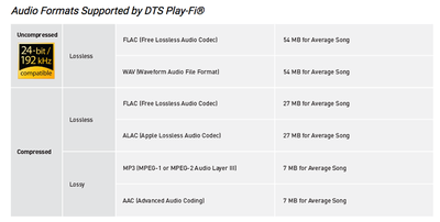

DTS Play-Fi hi-res music file support
DTS Play-Fi supports most of today's most popular compressed and uncompressed hi-res music file formats and traditional lossless music formats.
