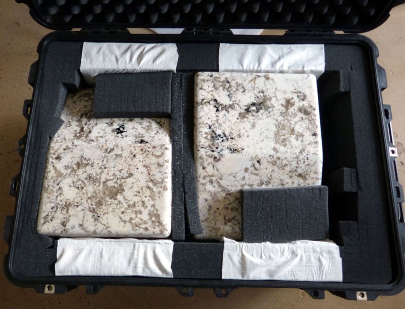

The
Status Voce Fina speaker showed up in a giant thick hard plastic case that
looked like it was suitable to hold a nuclear weapon. All that was missing were
the launch codes. This thing came with
rollers for easy maneuverabside.JPGility because it certainly wasn’t manageable for
lifting. Unfortunately since I received
a prototype pair for review, not all of the details were carefully worked out
on the packaging. The speakers didn’t have
quite enough padding on the inside of the casing and were mishandled during
transit. One of the speakers slapped
hard against the other causing the cabinet to crack down the backside. I didn’t want to wait for Status to make up a
new set for review so I sealed the crack with duct tape and ran a leakage test
to ensure everything was airtight before proceeding with the review.

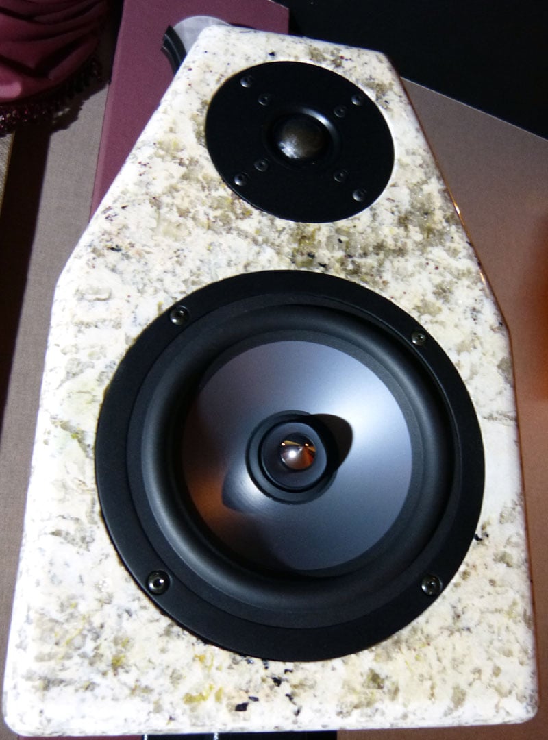

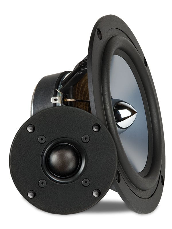

The Beryllium-Aluminum Driver
The newly developed RBH proprietary 6½” Beryllium/Aluminum phase plug driver is used on this speaker system and the flagship 8T Tower. The driver basket is a high quality cast aluminum. Employing Beryllium improves on aluminum by offering a stiffer, lighter-weight cone with a less pronounced breakup mode that is shifted further beyond the bandwidth in which the driver is being used. Energy storage is reduced and stiffness is increased compared to the conventional aluminum cone, resulting in less cone flexing under stress. The Beryllium alloy cone also produces a more linear transition in the stopband for smoother integration between the drivers. The phase plug reduces moving mass and on-axis beaming and also serves as a heat sink and, to a smaller extent, offers venting for the voice coil. There is also a rubber stopper affixed to the cone to further reduce air turbulence through the gap. A lot of engineering went into this driver, which was thoroughly vetted originally on the Status 8T Tower and now on this speaker system too.
Status Acoustics 6.5" Beryllium-Aluminum Phase Plug Driver

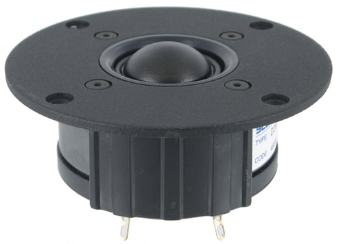

The Tweeter ScanSpeak 9500
While the
flagship Status 8T tower employs the new Scan-Speak Illuminator Model
6640 tweeter, RBH instead chose to stick with the classic 9500 as they felt it
was a better match for the design goals of this two-way bookshelf speaker.
I simply love the ScanSpeak 9500 tweeter that most upper echelon RBH products have been using for well over a decade now. It has high power handling, a low resonant frequency (550Hz) and superb off axis response. This yields a smoother, more open and airy sound quality with less compression compared to lesser design dome tweeters. Because of a longer rear chamber, the ScanSpeak driver can play much lower than pretty much any 1” dome tweeter on the market. This takes the stress off of a midrange driver to produce frequencies it really can’t do effectively.
Status uses nothing but the best inductors, high tolerance resistors and film caps in their crossovers. Their crossovers are designed to ensure optimal performance of each driver within its audible bandwidth, guaranteeing proper phase and frequency response of the speaker system. This is the same crossover design from their legendary Decimo speaker that this system now replaces. (Note the custom-built air core Inductors, film caps, and ceramic resistors)
All of the cables are 14AWG twisted pair to minimize signal loss and reduce crosstalk. Note the inductors are spaced apart to minimize magnetic coupling as per our Inductor Crosstalk Basics article.
I was curious to know why RBH Sound continues to use a 2.7kHz crossover frequency on this speaker design considering the tweeter has a very low Fs of 550Hz meaning it could be crossed over as low as 2kHz without any issues.
Editorial Note About Tweeter Crossover Point by Shane Rich, Technical Director of RBH Sound
I generally don’t like crossing over a tweeter lower than 2,700Hz or a minimum of 2,500Hz for several reasons. First, is that power handling and output power (SPL) of the tweeter before onset of distortion is often limited to a less than ideal level at lower frequencies even if the Fs of the tweeter is more than an octave lower. In the case of a smaller two-way speaker it may not be as critical, but personally don’t like crossing over in the 1-2kHz range because I think the ear is more sensitive to “picking up” crossovers in that region. I also like to base the crossover frequency (at least with our metal cone drivers) on where the stop band begins with the midrange. I find we get better integration that way with the tweeter. Not every speaker system works best that way, but it seems to be ideal with our drivers. Also, remember that our 6.5” driver has an effective radiating diameter of 5” so the frequency that corresponds to a 5” wavelength is about 2,700Hz . The polar response of the speaker will speak for itself as you saw in your measurements.

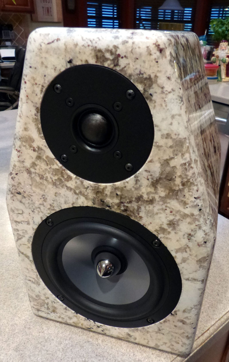

The Status Acoustics Voce Fina cabinet is so stunning it would make all but the most high-end kitchen countertops envious. Seriously, these things are a work of art. They demand attention and should be proudly displayed in even the most elegant of rooms. I can’t imagine anyone not regarding them as a piece of furniture. With that, I don’t believe you will find any furniture that offers this level of sound quality.
Status
Voce Fina Front View (left pic) and back view (right pic)

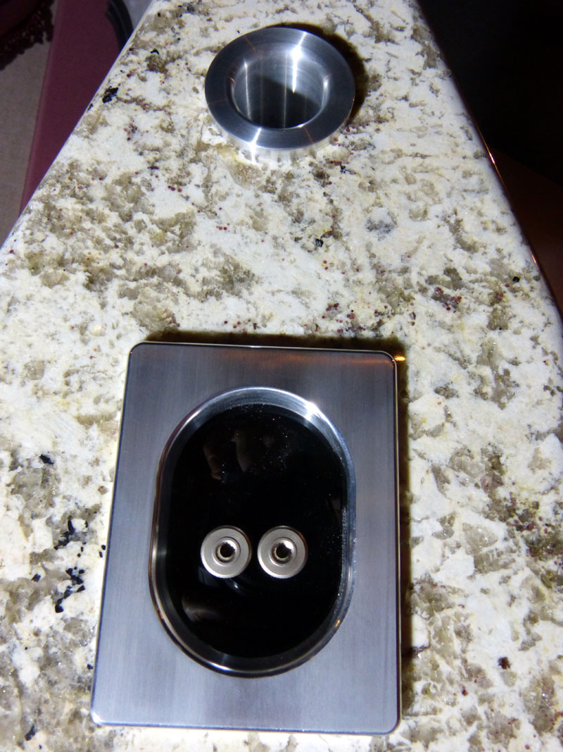

The back of the Status Voce Fina speaker is almost as impressive as the front. I say almost because you don’t get to see the gorgeous drivers from the backside. Instead, you get a look at the machined aluminum port and speaker terminal cup, which I must say are the sexiest I’ve seen. The Status Voce Fina come as single wired but you can special order them with two pairs of binding posts if you care to bi-wire or bi-amp. Looking closer at the speaker terminal cup black background seems a bit pedestrian for such a posh product. I really wish they would have embossed the word Status Acoustics on it for a bit more flare.

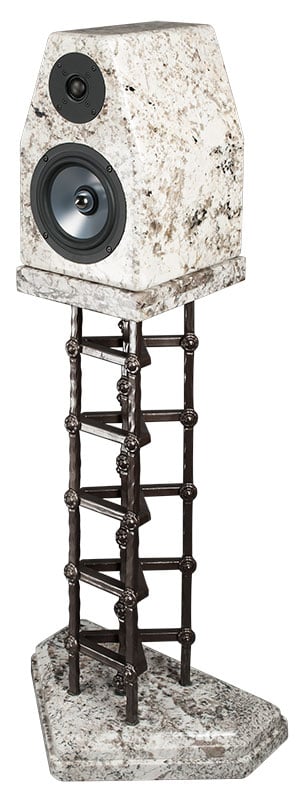

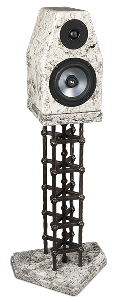

placed on my 30” sand filled Plateau stands though RBH offers matching granite
stands for a $3k premium. Personally if
you’re going to shell out $12k/pair for speakers, you might as well just spend
the extra cash and get the matching stands.
Look at how stunning they are and I think you will agree. Whatever stands you chose, it’s important to
properly mount these speakers on a sturdy stand that can accommodate the almost
53lbs heft of these speakers. If you go
with the matching granite stands be prepared for some heavy lifting as the
speaker + stand combo weigh a whopping 120lbs.

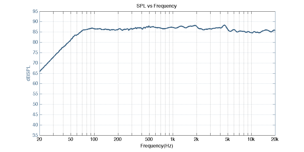

Status Voce Fina On-Axis Frequency Response
The on-axis frequency response was conducted with the measurement microphone at 1 meter with a 2.83V excitation signal. Audioholics measures sensitivity as the average sound pressure level (SPL) from 300 to 3kHz. The Audioholics rated sensitivity for the Status loudspeaker is an average 87.6dB. Given the close distance the measurements were taken at, the on-axis frequency response of this loudspeaker was highly dependent on microphone placement. If the microphone was placed at the same height or above the tweeter a narrow but relatively deep null centered between 4kHz and 5kHz appeared. Moving the microphone to between the tweeter and woofer reduced this issue in the response. This measurement anomaly wasn’t as pronounced on the Status Decimo speaker since the woofer/tweeter were placed closer together.
The measurement technique used above involves removing all of the effects of a room. The in-room bass response of the Status Granite loudspeaker with room gain should provide good bass response into the low 40Hz range.
Editorial Note About Measurement Dips by Steve Feinstein
The frequency response dips measured here are pretty typical. There is always an axis that produces the max SPL without interference. The dips are simply from off-axis phase cancellations between the drivers. This is the same thing that’s at work in a center-channel speaker with horizontally-arrayed drivers, except that the dips are now side-to-side, not up and down.
Most of this “problem” disappears in the far/reverberant field, where first-arrival is not as important as total radiated energy.

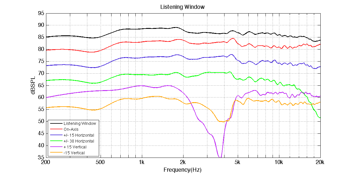

Status Voce Fina Listening Window
The listening window response for the Status Voce Fina loudspeaker was conducted with a 2.83V input signal at 1 meter from 7 locations. The measurement provides a picture of how the loudspeaker performs from seating locations that are not directly on axis with the speaker. The top curve is the average of the other positions and provides an average of how the speaker performs throughout the listening area. The listening window measurement is pretty uniform on the horizontal axis. When moving 15 degrees above or below the speaker, large nulls appear between 2kHz and 5kHz though they weren’t audible during listening tests with normal program material.

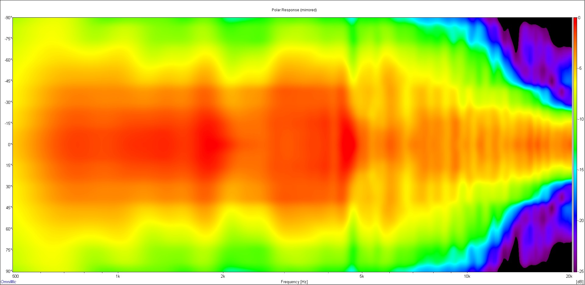

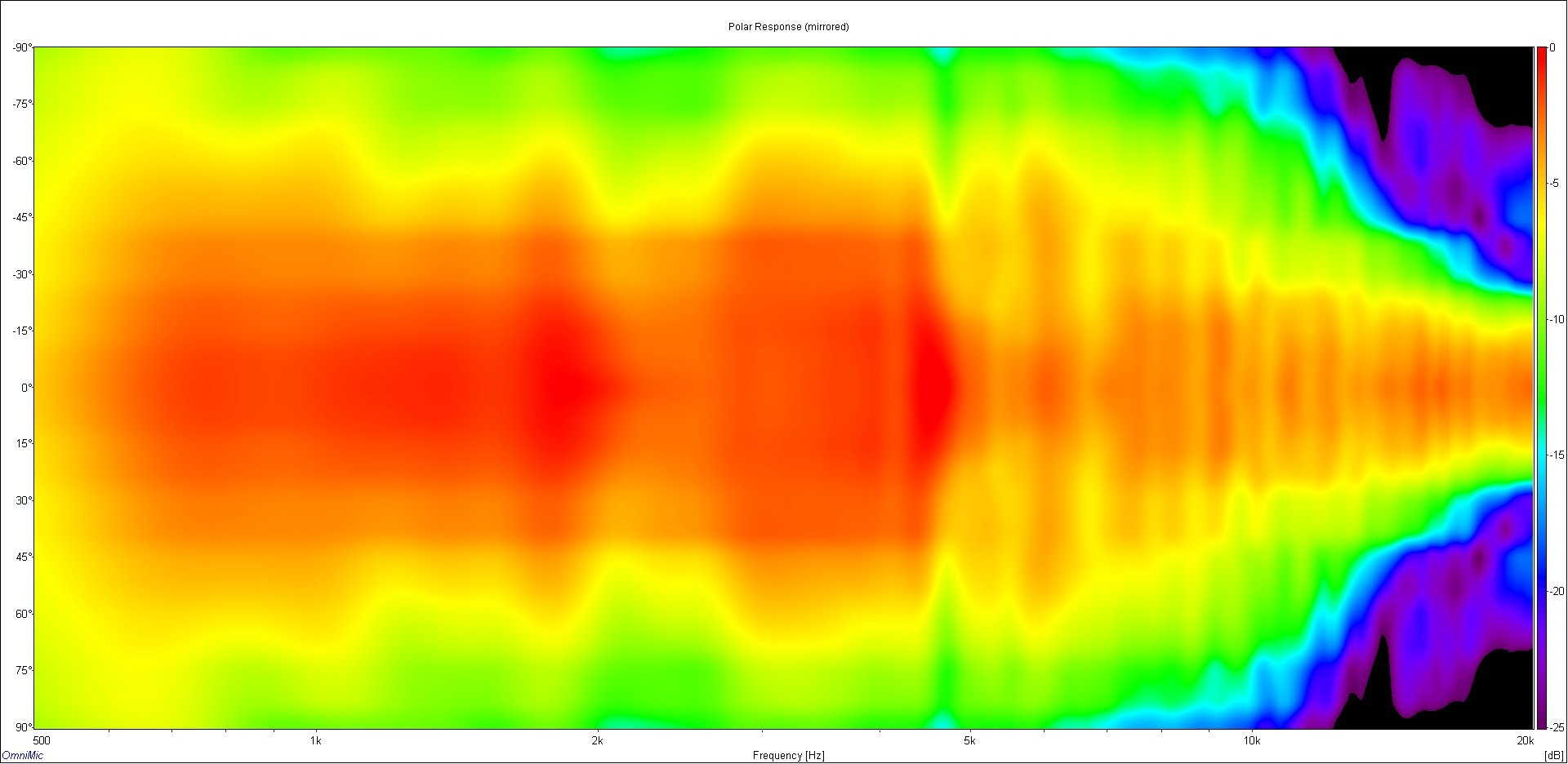

Status Voce Fina Polar Response
The polar response graph shows how a loudspeaker performs at various seating positions in a room. The polar response graph above is generated by measuring a loudspeaker at 7.5-degree intervals around a circle between the tweeter and woofer from 1 meter. The Status Granite loudspeaker has the most uniform polar response I have ever measured. This means as you move to different seating positions off axis, the characteristic of the sound does not drastically change. Even at 30 degrees off-axis, the frequency response is relatively linear. The polar response graph usually makes the mid-woofer to tweeter crossover point obvious as the dispersion characteristics of each driver is typically different. The dispersion characteristics of the Status Granite appear nearly perfectly matched. This pays huge dividends when the speaker is placed in a room that is less than perfect.

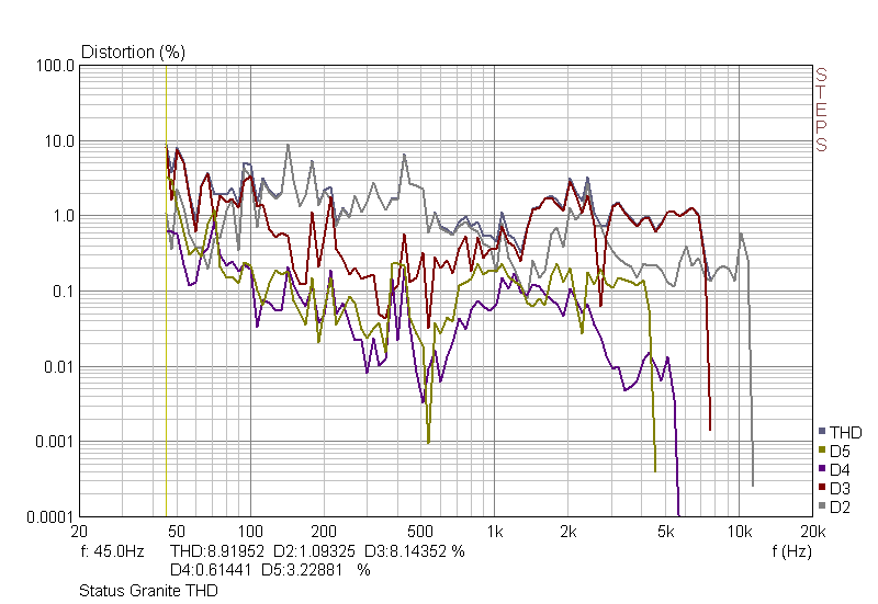

Status Voce Fina Harmonic Distortion
The harmonic distortion graph was generated using a 90dB stepped sinusoid sweep measured at 1 meter. This test is the last test run on a loudspeaker since it really tortures loudspeakers. Since this is a single 6.5” beryllium low frequency driver, the test was run from 45Hz to 20kHz. From 45Hz to approximately 90Hz, substantial air turbulence was clearly audible from the leaky phase plug to cone interface. While this may or may not be audible during normal playback, it is something that definitely is noticeable during testing. The harmonic distortion measurement is average, even compared to some less expensive but well engineered loudspeakers. The audibility of harmonic distortion is a topic of ongoing debate.
Editorial Note about Distortion Audibility by Steve Feinstein
THD tends to be relatively inaudible at higher levels in the bass, but easily audible at less than 1% in the midrange. There’s a big difference between distortion being “audible” and being “objectionable,” however. Much of that has to do with lower-order vs. higher-order spectral content. 2nd-order THD is rarely bothersome, but 5th-order THD or IM vs. THD is harsh.

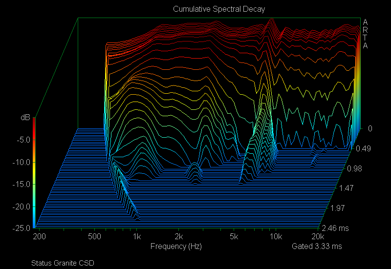

Status Voce Fina Cumulative Spectral Decay
Cumulative spectral decay is derived from the impulse response measurement made with a 90dB excitation signal at 1 meter. The cumulative spectral decay shows how sound at various frequencies dies out as a function of time. It is important to note that the left most ridge is not valid and is a product of the measurement technique. The CSD for the Status Granite is excellent. The ridge protruding between 4kHz and 5kHz is oddly the same place that we have vertical off axis issues. However, the ridge dies out very quickly and definitely will not contribute to any sort of ringing.

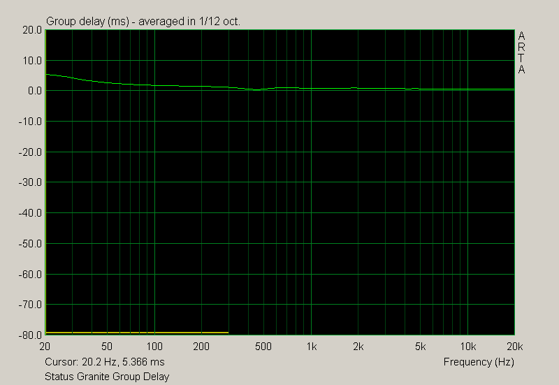

Status Voce Fina Group Delay
The group delay graph shows the rate of change of the slope of a loudspeaker’s phase. As a rule of thumb, values below 1.6ms in the mid to high frequencies will likely not affect perception of sound quality. Increasing group delay in the low frequencies is not as objectionable as it is in the mid to high frequency ranges.
