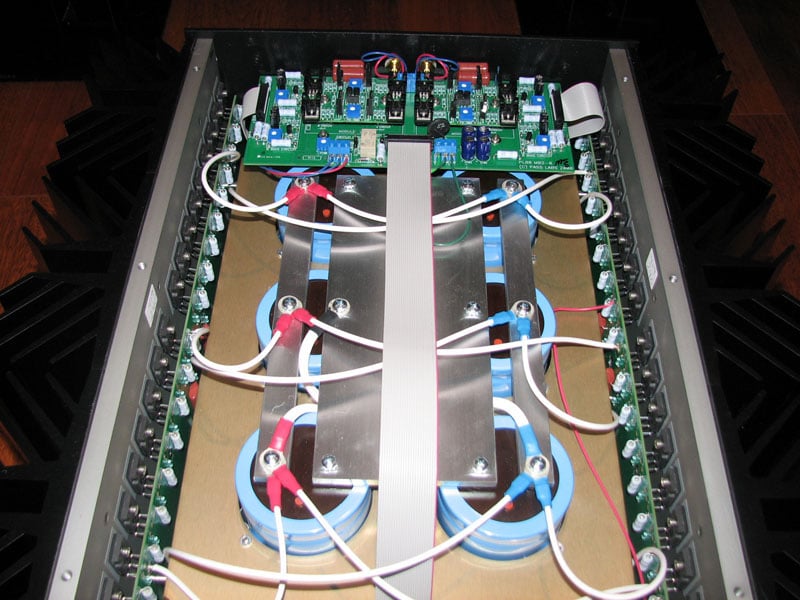

Pass Labs X350.5 Top View
Removing the top plate, a peek inside the X350.5 amplifier showed it to be a work of beautiful art. The capacitors are connected via sheets of metal which serve as low electrical resistance connection points and heatsinks to keep them cool even during high amplifier output conditions. The six (6) very large 25,000uF / 75V power supply capacitors are connected in parallel, yielding a total capacitance 150,000uF. Pass Labs’ literature states a max voltage output of 76V, but that’s not the actual rail voltage. The rails are actually +-55V which yields almost a 20V margin for the capacitors. This ensures longevity in the capacitors by not running them steady state at their max allowable voltage limits.
The power transformer is a hefty1.5kVA toroid, which is not visible from this picture as it’s mounted at the bottom of the chassis underneath the heatsink flanking the power supply capacitors. Each channel has 36 output devices (18 on top as pictured and 18 on the bottom). The output stage is fully differential, which if properly implemented can be a huge advantage for noise immunity and distortion reduction. Only the very best amplifiers are fully differential from input to output and the Pass Labs is in good company here.
The X350.5 amplifier is CE certified, meaning it meets or exceeds all safety standards for domestic and international markets. The X350.5 is not user selectable for 120V/220V operation like some amplifiers we’ve tested.

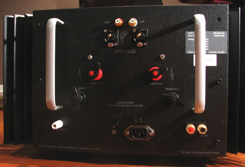

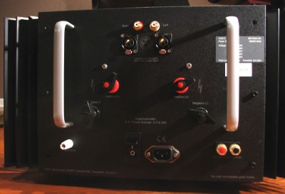

Pass Labs X350.5 Back View
The Pass Labs X350.5 has quite a striking rear end. It’s equipped with two large handles for “easier” transportation of this anvil-sized amplifier. The X350.5 has both balanced and unbalanced input connections, a detachable power cord, and ground and trigger connections. The balanced/unbalanced input connections aren’t switchable so be careful about accidentally using both input types simultaneously. The balanced connections come with a shorting plug installed for this very purpose and to also minimize noise pick up of the unused input connections.
There is only one set of speaker terminals on the X350.5 and they only accept spades (no bare wire and no bananas). This means you can’t bi-wire or run two pairs of speakers simultaneously unless you construct a breakout cable to do so. I am not a fan of spade terminations as they can be dislodged with a minor jostle even when twisted down. It was difficult to get my Kimber 8TC cables tightened down while twisting the lugs as they rubbed against the terminations. I would have preferred conventional 5-way binding posts, but Pass Labs claims they use this connection scheme for safety purposes. I don’t get this since they could have still used binding posts affixed to plastic standoffs to prevent arching like high power amplifiers produced by other manufacturers often do.

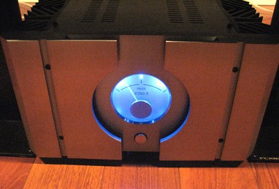

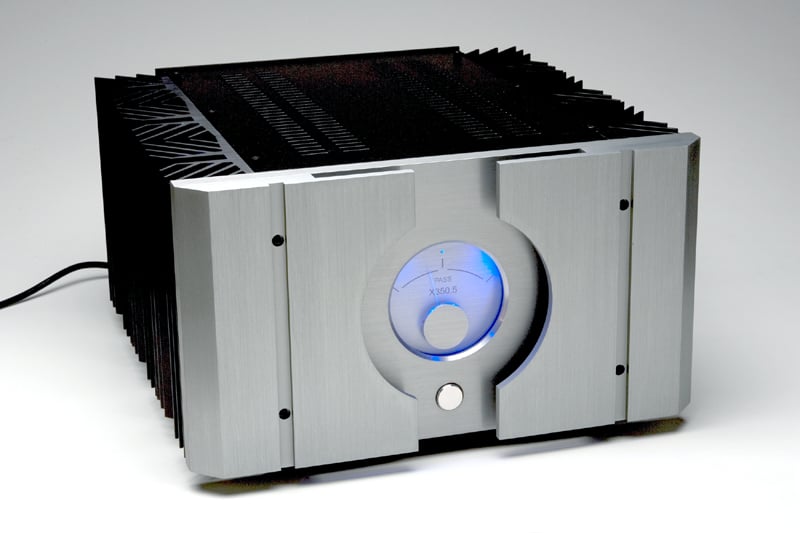

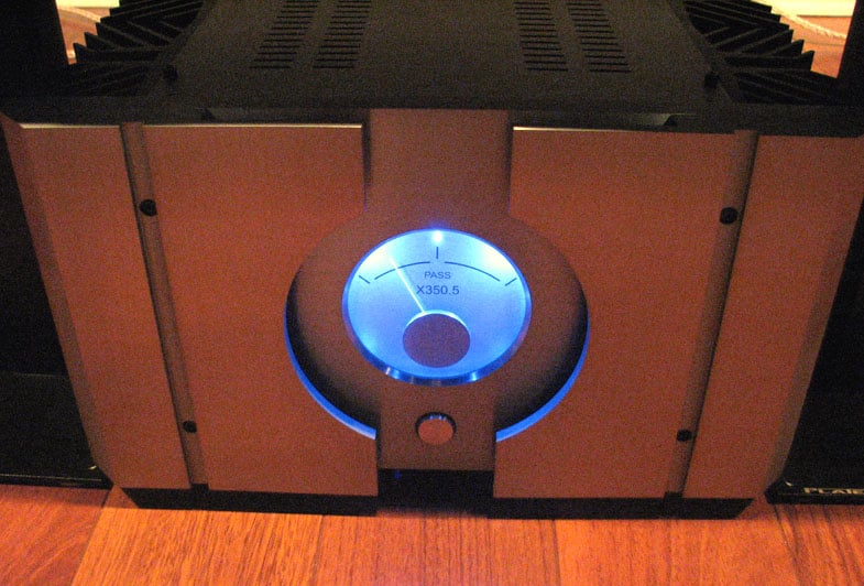

Pass Labs X350.5 Front View
Perhaps the most striking feature to the Pass Labs X350.5 is the large round blue backlit meter that actually tracks current consumption instead of power. The sculpted aluminum faceplate is simply stunning and is instantly noticed by visitors when they enter the room. Both sides of the amp are completely flanked with extruded heatsinks that serve their purpose to draw off heat from the output devices but also give it that badass look. I have to admit I found myself quite infatuated with the blue hue of the front panel glass on this amplifier during my extensive listening sessions.

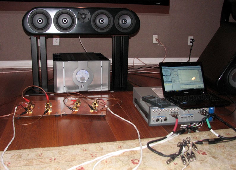

Pass Labs X350.5 Stereo Amplifier Power and Distortion Measurements
All measurements were conducted using our Audio Precision APx585 8 Channel HDMI Audio Analyzer following our rigid Amplifier Measurement Test Protocol.

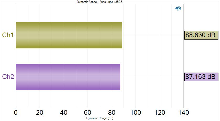

Signal to Noise Ratio
Pass Labs X350.5 SNR @ 1 watt (A-weighted)
The X350.5 exhibited a very good low noise floor. At 1 watt, I measured 88dB (A-weighted). At rated power (350 watts), I measured 113dB.

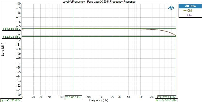

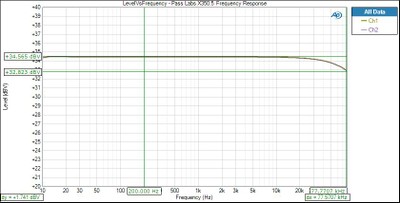

Frequency Response
Pass Labs X350.5 Frequency Response @ Full Rated Power
The Pass Labs X350.5 exhibited ruler flat bandwidth from 10Hz to 40kHz with a gradual roll-off of about -2dB at 80kHz. Pass Lab’s claims a bandwidth of 1.5Hz to 100kHz but doesn’t specify a tolerance. This sweep was taken at 358 watts at full bandwidth from 10Hz to 80kHz with both channels driven. Lesser designed amplifiers would shut down or not be able to deliver such a ruler flat response at this power level. Frequency response linearity between both channels at 1 watt and full rated power was +/-0.06dB for 8 ohm loads and +/-0.08 dB for 4 ohm loads from 20Hz to 20kHz for 8 ohm loads, which is superb. This indicates very tight tolerances in parts selection and excellent overall engineering. Because of this incredible linearity, I found the continuous full power bandwidth measurements tracked very closely with the 1kHz sweep power tests and thus only reported power figures for those test results.

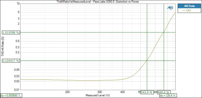

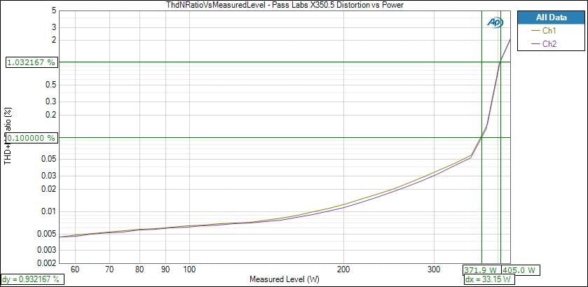

1kHz Power Sweep vs. Distortion (1kHz PSweep) - popularized by the print magazines, this is an instantaneous power vs. distortion test at 1kHz. The problem with this test is it often masks slew-related and/or frequency response problems some amplifiers exhibit at the frequency extremes, and thus inflates the measured power results. It does provide an instant gratification number for consumers to argue over on the forums, so we are now incorporating this test to please the masses.

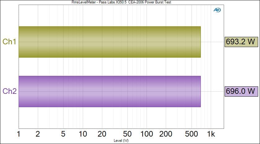

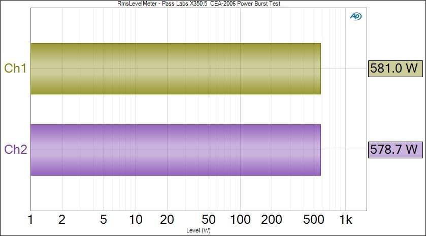

Dynamic PWR - 1kHz CEA-2006 Burst Method testing. This is a dynamic power measurement adopted from the car industry similar to IHF method only a bit more difficult for an amplifier and more representative of real musical content.

Labs X350.5 Power vs Distortion Sweep Test 1kH
2CH Driven, 8 ohms (top pic); 1CH Driven, 4
ohms (bottom pic)
Pass
Labs X350.5 Dynamic Power Test (1kHz)
Top Pic: 2CH
driven, 8 ohms; Bottom Pic: 2CH driven,
4 ohms
# of CH | Test Type | Power | Load | THD + N |
1 | 1kHz Psweep | 440 watts | 8 ohms | 0.1% |
1 | 1khz PSweep | 480 watts | 8 ohms | 1% |
2 | 1kHz Psweep | 372 watts | 8 ohms | 0.1% |
2 | 1kHz Psweep | 405 watts | 8 ohms | 1% |
1 | 1kHz Psweep | 550 watts | 4 ohms | 0.1% |
1 | 1kHz Psweep | 675 watts | 4 ohms | 1% |
2 | 1kHz Psweep | 490 watts | 4 ohms | 0.1% |
2 | 1kHz Psweep | 550 watts | 4 ohms | 1% |
1 | Dynamic PWR | 595 watts | 8 ohms | 1% |
2 | Dynamic PWR | 580 watts | 8 ohms | 1% |
1 | Dynamic PWR | 700 watts | 4 ohms | 1% |
2 | Dynamic PWR | 695 watts | 4 ohms | 1% |

Pass Labs rates the X350.5 as follows:
- 350 watts @ 8 ohms; 1 kHz, 1% THD + N
- 700watts @ 4-ohm , 1kHz, 1% THD + N
Note: Pass Labs doesn't specify the number of channels driven for their power spec.

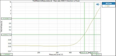

8 ohm Power Results:
My measurements revealed that the X350.5 is a true powerhouse that lives up to the somewhat vague published power figures Pass Labs specifies for this amplifier. This was especially true with 8 ohm loads as the X350.5 exhibited over +2dB of dynamic headroom into 8 ohm loads over the manufacturer’s 350wpc spec.
As previously stated, X350.5 produced virtually identical full power bandwidth and 1kHz power sweep tests indicating that the power supply and output devices were robust enough to deliver full rated power at any audio frequency, not just a sweet spot. This is just one of many hallmarks indicating the X350.5 is a seriously great amplifier.
4 ohm Power Test Results:
Even though I was running a dedicated 20A line, it was slightly hindering the accuracy of my power vs. distortion measurements into 4 ohm loads (both channels driven) as the line voltage sagged since we don’t use a VARIAC to hold line voltage constant. Think about it, 120V * 20A = 2400 watts / 0.5% (typical Class AB efficiency) and you’re left with only 1200 watts or 600wpc which is right about where the limitations of my power testing was occurring. Of course the amplifier’s max power consumption is rated for 1800 watts so it’s unclear just how much more power the X350.5 would have delivered into 4 ohm loads even under ideal bench test conditions.
Although the amp was showing 1% distortion driven at full power into 4 ohms, the analog waveform was still very smooth and unclipped. The dynamic power results were only marginally better into 4 ohms than they were in 8 ohms. I suspect the power into 4 ohm loads was somewhat limited by the transformer since it was optimized to drive 8 ohm loads. I would have liked to see a large KVA transformer on this amplifier given the caliber of this product. At these power levels, most people probably wouldn’t miss any additional juice. The X350.5 could drive virtually any speaker load. I didn’t need these test results to be convinced after just a few short listening sessions powering my new Status Acoustics 8T reference speakers.

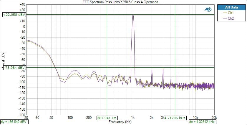

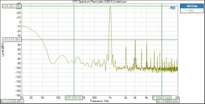

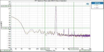

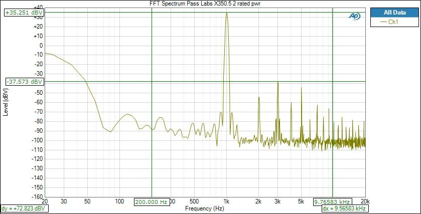

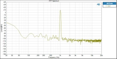

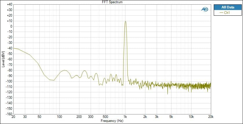

FFT Distortion Analysis
Pass Labs X350.5 FFT Distortion Analysis @ 1 watt
I ran FFT distortion plots at 1 watt (top pic) and full rated power (bottom pic) to determine how clean this amplifier really is. At 1 watt, the spectral distortion was below the noise floor of my measurement equipment which is another way of saying “awesome”!
Pass Labs X350.5 FFT Distortion Analysis @ 20 watts
In fact, the measured distortion spectra were excellent for the entire Class A operation of this amplifier (up to 40 watts peak). You can see how down in the mud the distortion components are (-96dB for the 3rd harmonic below the fundamental).
Pass Labs X350.5 FFT Distortion Analysis @ 420 watts
At 420 watts, 8 ohms (which is above the 350wpc power rating) the X350.5 displayed a not so pretty distortion harmonic spectrum. I observed the 3rd harmonic (35.251 + 37.57) dBV being 72.8dB down from the fundamental. This unusually high distortion product is likely somewhat a deliberate result of employing minimal feedback in this amplifier design. The results looked better at rated power but still not stellar from an FFT distortion measurement standpoint. Despite this, the amp sounded fantastic at all power levels. It just goes to show measurements and real world listening experiences rarely line up as one expects.

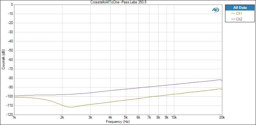

Crosstalk
Pass Labs X350.5 Crosstalk vs Frequency at full rated power
The sweep tests I ran on the X350.5 produced excellent results being less than 100dB at 1kHz and 80dB at 20kHz. I consider anything less than -40dB @ 10kHz acceptable and anything less than -80dB to be superb. The X350.5 met the superb minimum requirement at 20kHz no less. Pass Labs did their homework with respect to board layout and component isolation to ensure minimal crosstalk which also assures excellent stereo separation.
