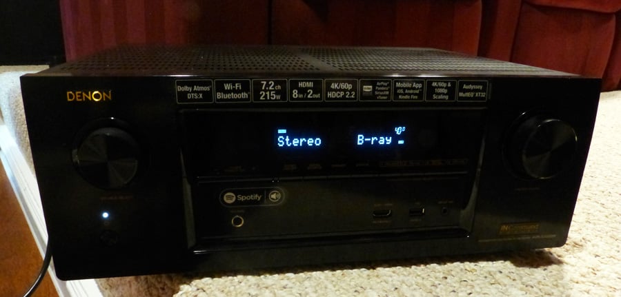

Build Quality and Features
The AVR-X3300W build quality is what you'd expect in a $1k Atmos AV receiver. Everything is kind of tightly crammed in but also well laid out. Denon doesn't claim a monobloc construction in this receiver like you get in the 6300H or 7200WA models, but they still employ discrete dual output devices sharing a large common heatsink and power supply. I was unable to view the capacitor bank so I can’t comment on their values.
The AVR-X3300W comes armed with the latest in HDMI and HDCP 2.2 compatibility including 4K Ultra HD 60Hz video, 4:4:4 Pure Color sub-sampling, High Dynamic Range (HDR) and 21:9 video, 3D, and BT.2020 pass-through support on each of the eight inputs and dual outputs. In addition, the video processor can also upscale digital SD and HD video to 4K Ultra HD. Denon has told me a firmware update this summer is coming to support Dolby Vision and HLG so don't worry about obsolescence just yet.
Certified by the Imaging Science Foundation (ISF), the AVR-X3300W features a full suite of video calibration controls (for use by an ISF technician), along with ISF Day and ISF Night video modes.

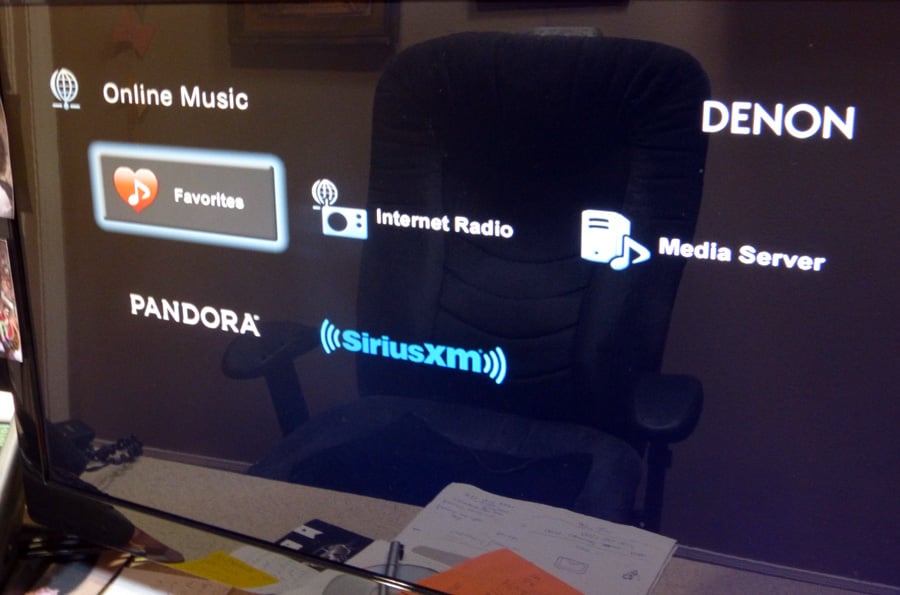

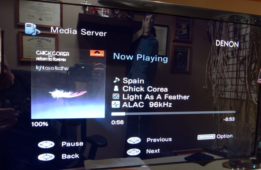

Within minutes, I was able to stream music from my network drive with full album artwork displayed on the App and the OSD of the receiver. You can even stream audio to a second zone if you want by either assigning unused amps from the receiver or adding external amplification. The AVR-X3300W has a Zone 2 DAC and supports HDMI, Digital in and Network sources into Zone 2. This feature was non-existent on older AV receivers at this price point just a few years ago. This receiver has it where it counts when it comes to getting audio off virtually any device wirelessly, but Yamaha currently has the edge when it comes to music management thanks to its inclusion of MusicCAST on the RX-A860.

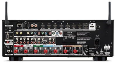

The Denon AVR-X3300W sports composite and component video connections for legacy devices and also has eight HDMI inputs; and 2 outputs (one for zone 2). The Zone 2 HDMI output can support a separate simultaneous discrete source, which is a really cool feature uncommon at this price point.

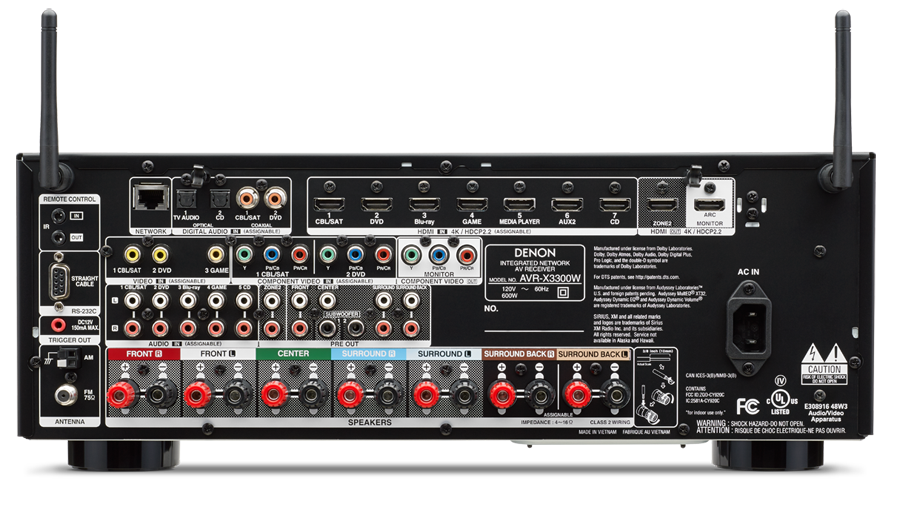

Denon AVR-X3300W Backpanel View
The dual subwoofer output connections are independent, meaning you have full delay and trim adjustability for each of the outputs. This is very rare at this price point and a nice feature for those running dual subwoofers wanting more adjustability options. You can connect up to seven speakers for a 7.1 or 5.2.2 speaker layout or divert two of the channels to Zone 2 function.

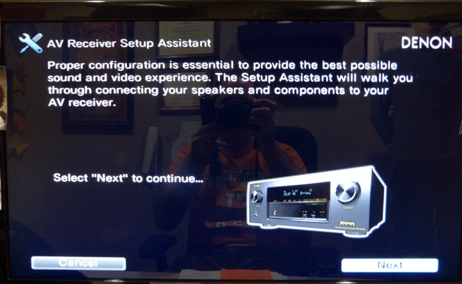

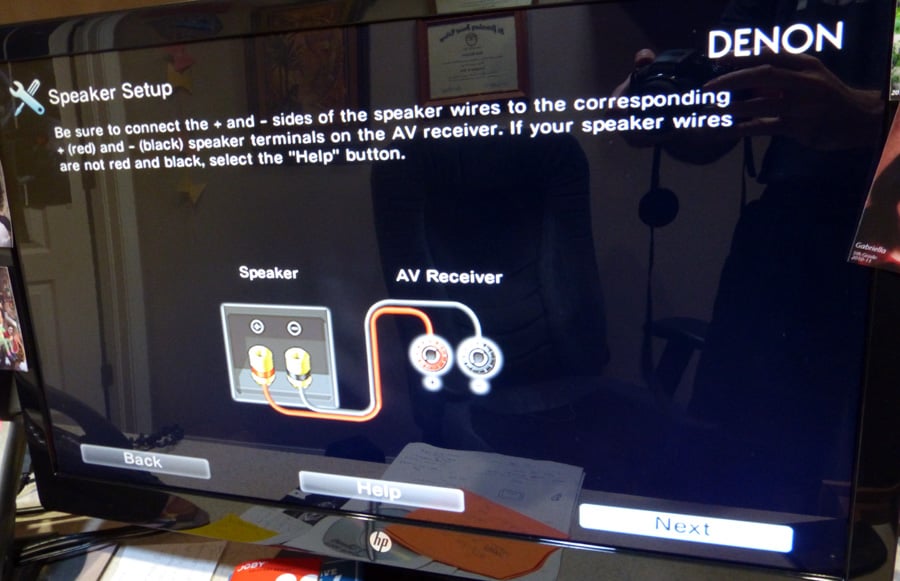

Denon AVR-X3300W A/V Receiver Menu System & Set Up

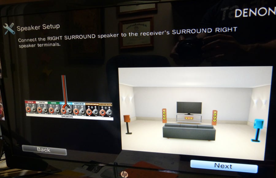

Denon Receiver Setup Assist
Denon has put forth quiet an effort to make the setup of their receivers easy for the layman. Upon initial power up you are asked a series of questions pertaining to your speaker layout, size, etc so the AVR-X3300W can properly configure them. You can then use the included microphone to have Audyssey equalize and set the delays and levels of all of your speakers.
Denon AVR-X3300W offers 0.5dB channel adjustments and 0.1ft trim increments.

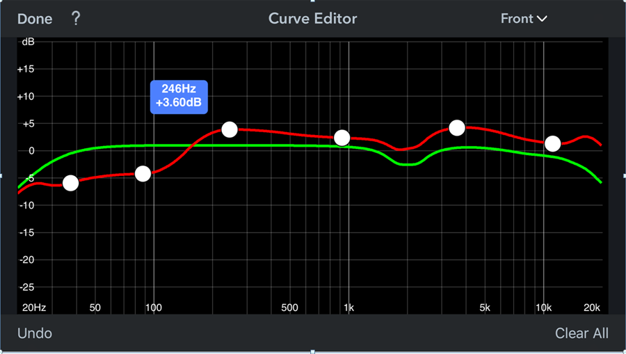

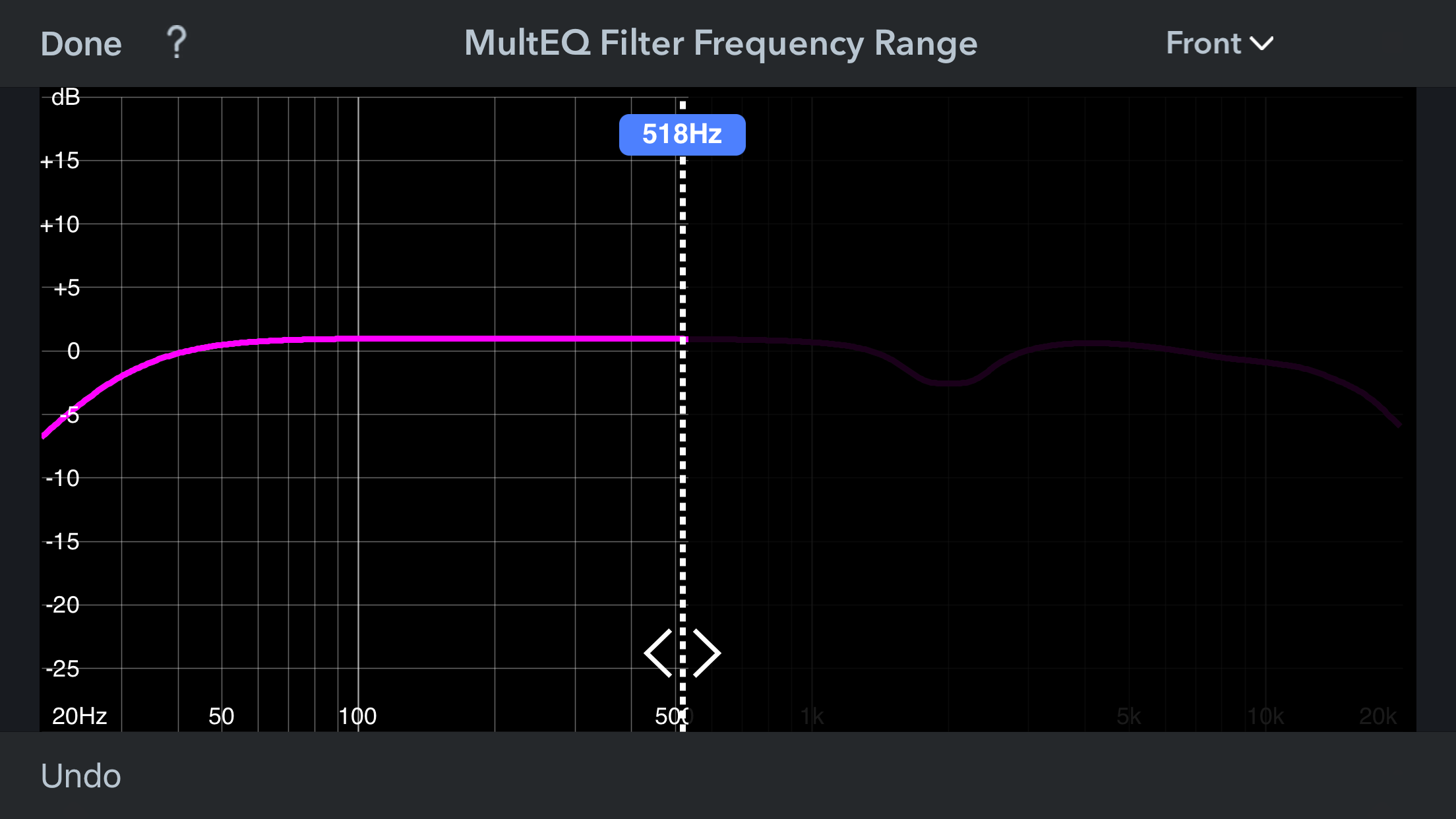

Audyssey Editor App & Manual EQ
In most situations, I usually use the auto-EQ system to configure delay and level for the speakers and then disable the EQ because it usually does more harm than good. This is because the prospect of full range EQ is a nebulous goal at best since the EQ system has no way of distinguishing between the loudspeaker response and effect of the room has on the speaker above bass frequencies (> 300Hz) so it tries to correct it as a system, which can muck things up. Thankfully the folks at D&M listened to consumer feedback and worked on an App exclusive to Denon and Marantz that allows the end user to limit and adjust the EQ after the calibration is run. This is all done via your smartphone and it's very slick and worth the $20 it will cost you in your App store. In fact, it has me on the fence about eventually trading in my venerable Denon AVP-A1HDCI for a new flagship Marantz Atmos Pre/Pro that will offer this feature.
Audyssey EQ Editor App - screenshot taking from mobile device
Note how the correction is limited to 500Hz (bottom pic)
This app allows users to:
- View the Audyssey MultEQ speaker detection results, to check and modify the configuration, and adjust for any unusual speaker set-up
- View before and after results of the Audyssey calibration, making it easy to identify room problems and see just what changes the system is making
- Edit the Audyssey target curve for each channel pair to suit individual tastes
- Adjust the overall EQ frequency roll-off for each channel pair
- Switch between two high-frequency roll-off target curves
- Enable/Disable midrange compensation to make the sound brighter or smoother, perhaps making dialogue even clearer or taming those hard-edged soundtracks
- Gives the home theater enthusiast even greater control over the performance of their surround sound system
- Save calibration results for ‘piece of mind’, ready for instant re-loading should one ever need to reset their system
Editorial Note on Audyssey App Testing:
Unfortunately during the time this review was being written, the Audyssey App was not available. We will be testing this feature extensively in future Denon/Marantz products and will report on it then.

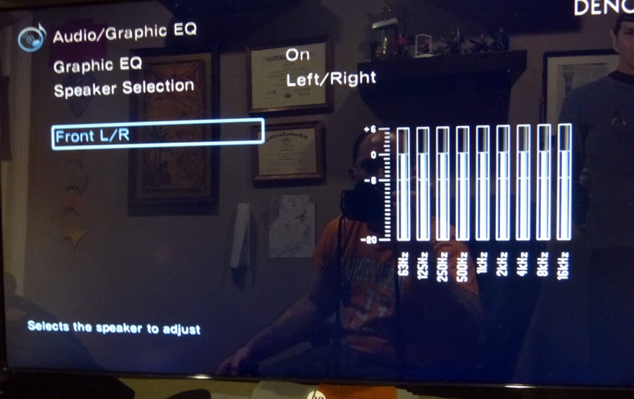

For those that want to fine tune the equalization of their system, Denon offers a manual 9-band graphic EQ for each channel. This is really archaic and I wish Denon would update it to a PEQ (Parametric EQ) to allow for variable frequency and Q control. Imagine how slick that would be if they did this via their smartphone App. Then you could fine-tune the bass in your system without ever having to run Auto-EQ at all. Yamaha has this on their AVENTAGE AV receivers with adjustability down to 15Hz. Come on Denon!
Denon AVR-X3300W GEQ - Please Denon Update to a PEQ

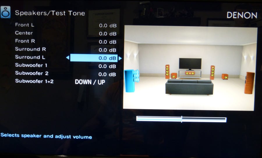

Denon AVR-X3300W Bass Management OSD

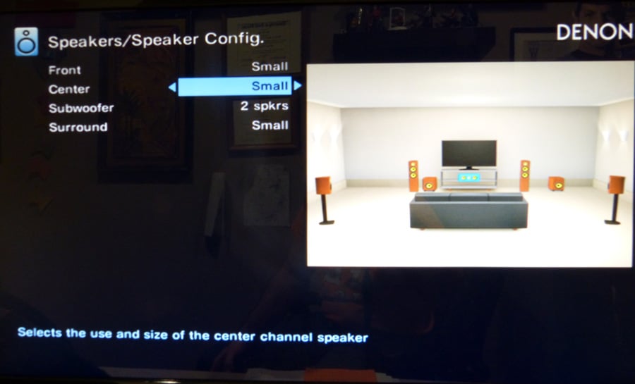

Speaker Set-Up & Bass Management

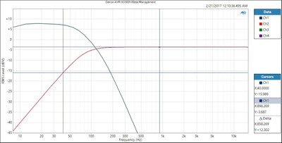

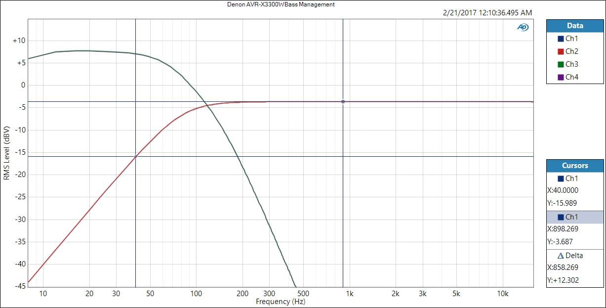

Denon has always offered excellent bass management on all of their AV receivers, and the AVR-X3300W is no exception. As mentioned earlier, it offers dual independent subwoofer outputs and has a separate setting for LFE crossover, which we usually recommend leaving at 120Hz to not truncate the LFE soundtrack of Blu-ray or DVD mixes which can have content above 80Hz that would otherwise be lost if you set the LFE crossover lower. You can have independent crossover settings per channel groupings.
Using our Audio Precision APx585 8-channel HDMI Audio Analyzer, I measured the HPF and LPF responses of the bass management circuits and observed a 20dB/oct slope of the LPF and 12dB/oct slope of the HPF at the selected crossover frequency. Normally I'd like to see a 24dB/oct slope of the LPF like you see on THX certified products, but the slightly more shallow slope probably won't make much of an audible difference in a practical sense.

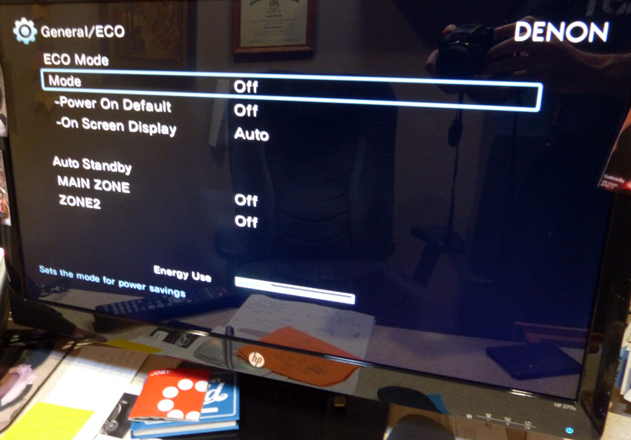

Denon AVR-X3330W Eco Mode - NEVER Engage!
Eco Mode - Avoid like the Plague!
As much as I am in favor of conserving resources and reducing my carbon footprint on this planet, running Eco mode on your AV receiver isn't going to slow the rising ocean levels or lower the acidity of our oceans. Instead, it's going to starve your speakers of power. With Eco mode engaged, it limited power on the bench to 20 watts/ch no matter how many channels were driven. This is worse than the dreaded 4-ohm impedance switch many receiver companies are using today. Make triple sure you NEVER set this receiver to Eco if you plan on using the internal amplifiers. I'd go so far as to omit the button from the remote control in case someone accidentally hits it and engages that mode.Caution: No matter how tempted you may be to do so, DO NOT change the default "8 ohm min" impedance setting of ANY AV receiver. All this does is starve your speakers of power, simply so Denon could get 4-ohm certification (at a reduced power level) without making the receiver get too hot during their power tests.
For more information, see: Setting the AV Receiver Impedance Switch

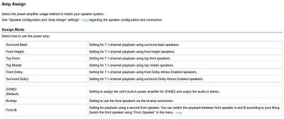

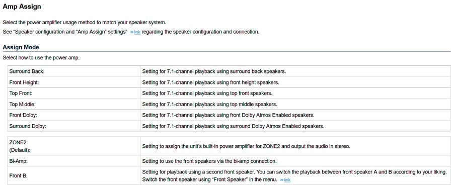

Power Amplifier Assignability
Denon offers flexible amplifier management that will accommodate virtually anything you want to do with its seven internal amplifiers, including running a 5.1.2 Atmos setup, a 7.1 conventional surround setup, 5.1 in the main zone and two speakers to zone 2 or bi-amp for the main zone. We don't recommend bi-amping with this receiver since its modest power supply won't really gain you much driving a pair of power-hungry bi-ampable towers. Instead, consider using the preamp outputs and external amplification if you want more power.
Unfortunately Denon did NOT include an extra set of speaker terminals like Yamaha did with the RX-A860 and Onkyo/Pioneer did on their similarly priced models. so the user could automatically switch between height/back channels or zone2 speakers. Thus, you need to decide during install which route you want to go, or add an external 2CH amp if you want both. That's an unfortunate oversight on Denon's part but gives them something to "upgrade" for their next generation product.
Denon AVR-X3300W Speaker Assignability Chart

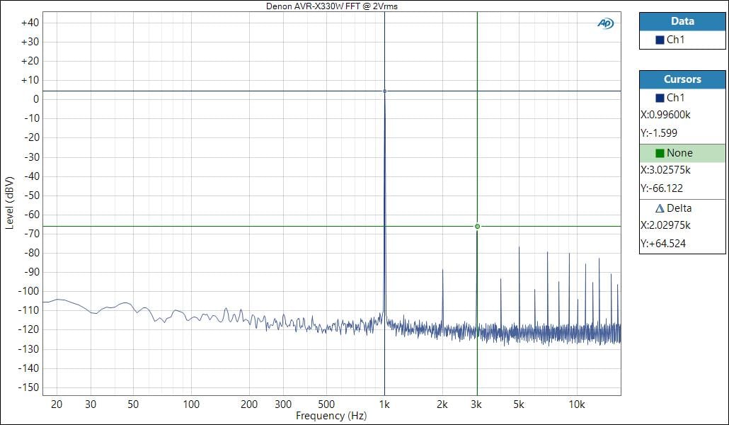

One thing I really love about Denon receivers is they NEVER skimp on their preamp out circuits. Like past models, the AVR-X3300W had an ample amount of drive. I measured a whopping 4.5Vrms unclipped output, which is more than double the voltage needed to make virtually any amplifier reach full rated power. Yamaha please pay attention and step your game up particularly with your AV receivers in this price range that clip above 1.6Vrms. A preamp output of less than 2Vrms is unacceptable in my book.
At 1Vrms, the FFT of the AVR-X3300W pre-out was squeaky clean, with the 2nd-order distortion 97dB below the fundamental. That is an excellent result and well below audibility. At 2Vrms, things got a little grainer with odd order harmonics dominating. I suspect the Marantz doppelganger for this model (SR5011) has a cleaner preamp output stage so you may want to go that route if you plan on using your AVR primarily as a preamp/processor.
Denon AVR-X3300W Preamp Out FFT Distortion Analysis @ 2Vrms

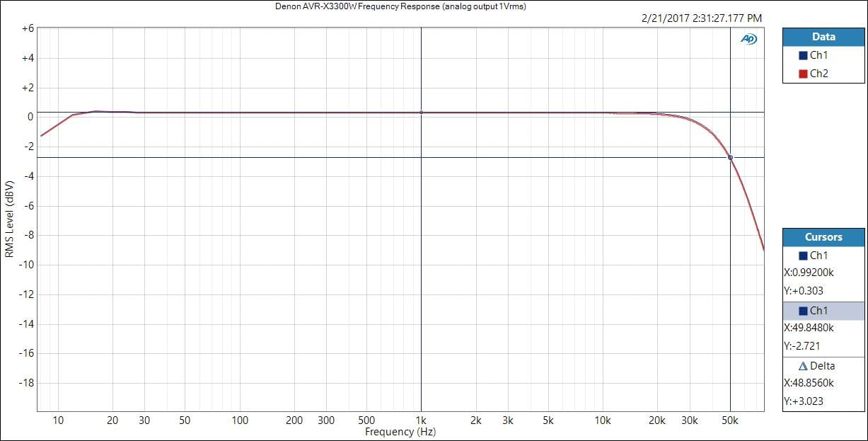

Denon AVR-X3300W Frequency Response - Pure Direct
Frequency Response was ruler flat from 20Hz to 20kHz with about -1.5dB at 8Hz and -3dB at 50kHz. This is not quite as wide bandwidth as the RX-A860 but still good enough for dogs not to complain.

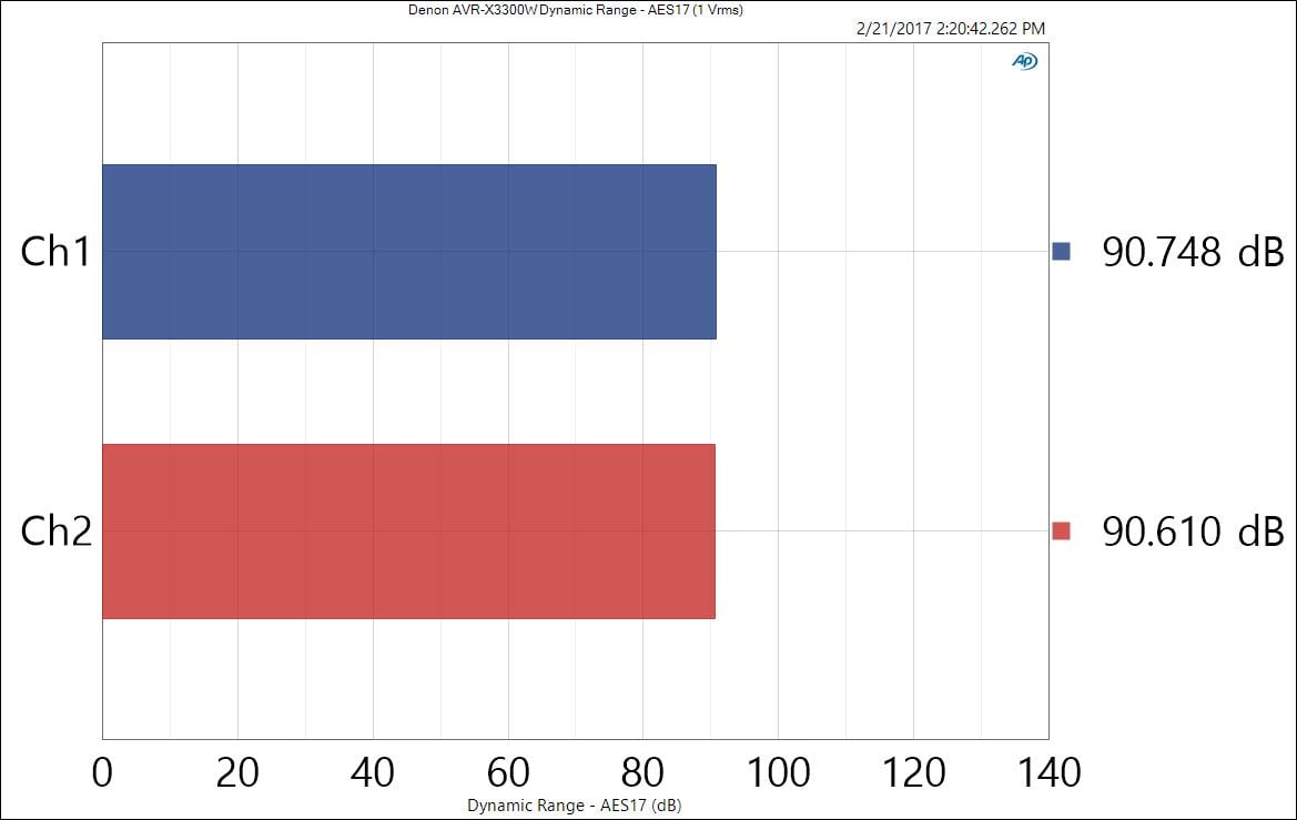

Denon AVR-X3300W Signal to Noise Ratio (1Vrms) - Pure Direct
The AVR-X3300W preamp output exhibited a low noise floor (90dB) unweighted with 100mV input drive.

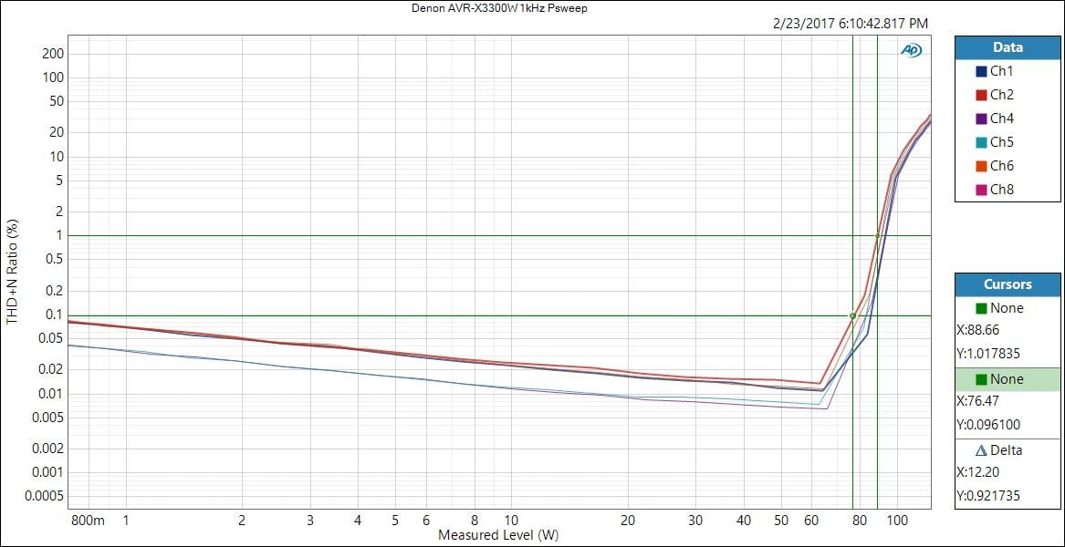

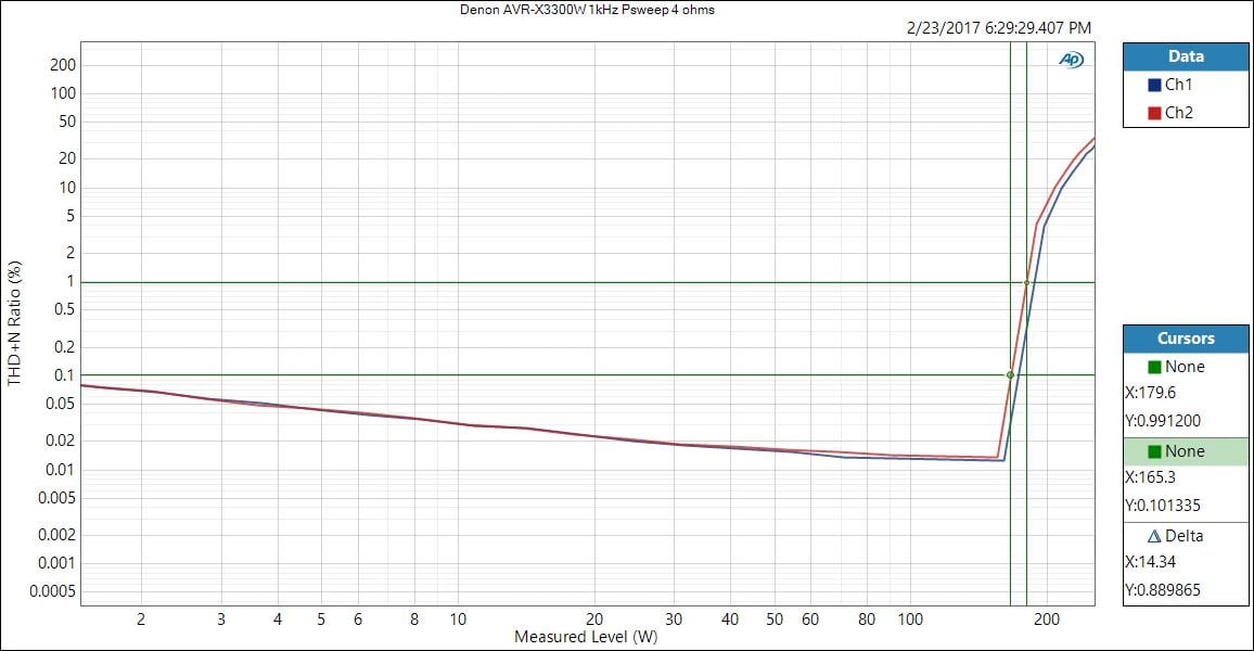

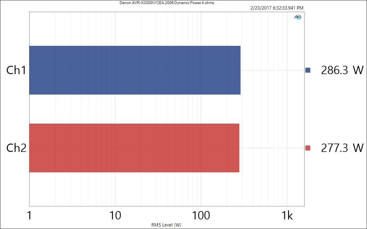

Power Measurements

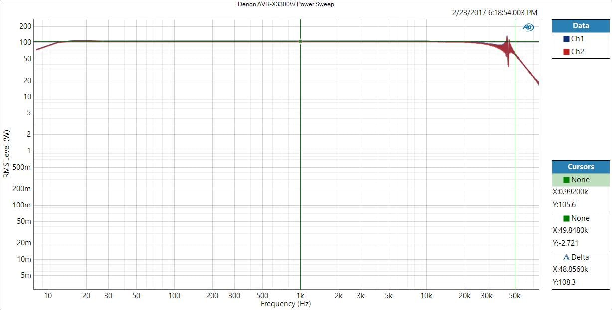

Using our Audio Precision APx585 8-channel HDMI analyzer, we conducted a full barrage of multi-channel amplifier tests on Denon AVR-X3300W per our Amplifier Measurement Protocol. We tested power using three methods all of which were taken at < 0.1% THD + N:
- Continuous Full Power Bandwidth (CFP-BW) from 20Hz to 20Khz into 8 and 4-ohm loads (up to two-channels)
- 1kHz Power Sweep vs Distortion (1kHz PSweep) - popularized by the print magazines, this is an instantaneous power vs. distortion test at 1kHz. The problem with this test is it often masks slew-related and or frequency response problems some amplifiers exhibit at the frequency extremes, and thus inflates the measured power results. It does provide an instant gratification # for consumers to argue over on the forums so we are now incorporating this test to please the masses.
- Dynamic PWR - 1kHz CEA-2006 Burst Method testing. This is a dynamic power measurement adopted from the car industry similar to IHF method only a bit more difficult for an amplifier and more representative of real musical content.
Keep in mind most review publications don't do continuous power measurements and they usually publish power measurements into clipping at 1% THD + N. Our measurements are very conservative as we use a dedicated 20A line with no Variac to regulate line voltage. We constantly monitor the line to ensure it never drops more than 2Vrms from nominal, which in our case was 120Vrms.
For more info on amplifier measurements, see: The All Channels Driven (ACD) Test

| 1 | 1kHz Psweep | 182 watts | 4-ohms | 1% |
| 1 | 1kHz Psweep | 163 watts | 4-ohms | 0.1% |
| 5 | 1kHz Psweep | 37 watts | 8-ohms | 1% |
| 5 | 1kHz Psweep | 35 watts | 8-ohms | 0.1% |

| 2 | Dynamic PWR | 255 watts | 4-ohms | 1% |

* only if Eco mode turned off. Sometimes the internal limiter tripped and reduced power to 85 watts/ch on the bench.
The Denon AVR-X3300W handedly outperformed the Yamaha RX-A860, but to Yamaha's defense, the RX-A860 retails for $100 less, which makes a world of difference in low-margin high-volume mass produced products like this. I do think most of the power differences between these two products have more to do with Yamaha's excessive nanny controls to protect the amp than the Denon actually having that much bigger of a power supply.
The AVR-X3300W offered respectable output into 8 ohm and 4 ohm loads. At times, their limiter circuit did interfere with my bench tests, even when Eco mode was turned off. I'm not sure it if was overly touchy or if it was an intermittent software glitch but I did inform Denon about this.
That said, > 80 watts/ch with 5 channels driven is quite respectable for a "does everything" Atmos/DTS:X receiver at this price point.
Denon AVR-X3300W CFP-BW (2CH) Power Test - 8 ohms
With two channels driven, the AVR-X3300W delivered its rated 105 watts/ch power for full bandwidth 20Hz to 20kHz.
Denon AVR-X3300W 1kHz ACD (5CH) Power Test - 8 ohms
With just two channels driven, the AVR-X3300W produced impressive 1kHz power tests that exceeded its 105 watts/ch rating. With five channels driven, the Denon held up pretty well delivering 88 watts/ch (1% THD+N) with 5 channels driven.
Denon AVR-X3300W 1kHz (2CH) Power Test - 4 ohms
Unlike the Yamaha RX-A860, which just didn't behave well with 4 ohm loads, the Denon AVR-X3300W didn't have a problem. It was able to output almost 180 watts/ch with 2 channels driven at 1% THD+N.
Denon AVR-X3300W Dynamic Power Test (1kHz) 2CH Driven, 4-ohms @ 1% THD+N
The AVR-X3300W performed well for CEA 2006 short dynamic burst tests that didn't trip the internal current limiting circuits. It was able to muster over 200 watts/ch into 8-ohm loads and over 300 watts/ch into 4-ohm loads. The AVR-X3300W offered very respectable continuous and dynamic power reserves for its product/price category.

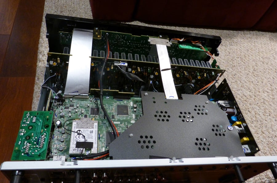

When I first took delivery of the Denon AVR-X3300W AV receiver, I was
skeptical. It wasn't as ruggedly built
as other units I'm accustomed to seeing from the brand at this price point for prior
models. But, that's an industry-wide problem these days due to cramming more
features at the expense of diminished power supply and build quality. Despite
this, the AVR-X3300W delivered solid performance in every measurable category

with their App which allows the end user to edit and/or restrict Audyssey room correction via their smartphone. This could prove to
be an invaluable tool to consumers and installers alike, one that makes their
