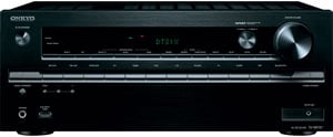

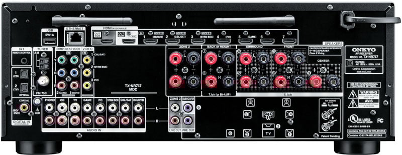

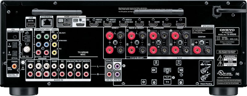

Onkyo TX-NR646 (left) and TX-NR747 (right)
