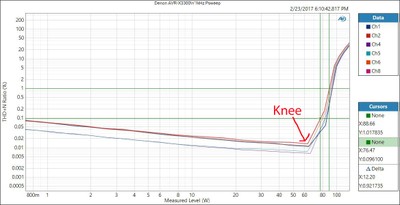

Power vs Distortion Graph for Denon AVR-X3300W AV Receiver
It's important to understand how to read a power vs distortion graph when assessing amplifier power. The region where the lines are horizontal represents clean (unclipped) amplifier power. As the traces begin to go vertical, distortion goes up dramatically and anything to the right of the vertical lines represents gross distortion. With just two channels driven, the AVR-X3300W exceeded its 105 watts/ch rating. But with five channels driven, the receiver was unable to deliver rated power though it still managed an impressive 88 watts/ch (1% THD+N).
When you see AV recevier companies rating power at 1% or 10% THD, just realize they are rating power out of the linear operating portion (horizontal line) of the power vs distortion curve and are either doing it at the knee or where distortion dominates and increases exponentially as it goes up vertically on the curve.

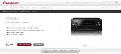

It started with Onkyo, but others followed suit shortly after. Instead of rating at 8 ohms, 2 channels driven at a low distortion level, they started rating power with only 1 channel driven, at 6 ohms, at near clipped distortion levels. The reality of the situation is rating only 1 channel driven isn't very realistic of how a consumer uses an amplifier or receiver since both channels typically draw nearly the same power simultaneously with stereo program material. Also, rating an amplifier at say 0.1% THD+N vs 10% THD+N represents very different behavior of that amplifier. The 0.1% case is arguably an inaudible amount of distortion while the 10% case is not only visible on an Oscilloscope as a clipped wave form but is also very audible. It's at the point where the amplifier can no longer supply additional voltage and instead is turning a sine wave into a square wave with very high audible 2nd order harmonics and potentially damaging signal to the loudspeakers tweeters. Again this is power rated on the vertical trace in the power vs distortion curve previously mentioned.
This allowed the manufacturer to inflate power claims by a good 35-40%, which looks impressive to the uninitiated. More power must be better right? Sadly, most casual shoppers don't realize what's going on and come home with a much less powerful product than they thought they’d purchased.
When the first generation Atmos receivers popped up, some manufacturers were only listing the 1-channel power measurement. After we called them out on it, they all changed their websites in unison to list both ratings methods (1 channel, 1kHz @ 6 ohms clipped, 2 channels 1kHz per FTC). Though, the FTC states full power bandwidth must be specified, not just one discrete frequency (1kHz).
For an expanded discussion on this topic, read: Power Manipulation in Dolby Atmos AV Receivers
Onkyo TX-RZ3100 & Pioneer SC-LX901
MSRP: $3,099 & $3,000, respectively
Onkyo and Pioneer Both Showcasing inflated 1CH power rating above the 2CH FTC Rating

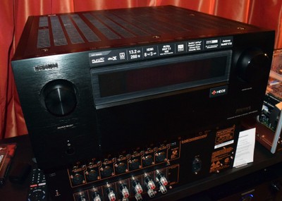

Still, some manufacturers are a bit craftier and stamp a power sticker on the front panel of their receivers. Take for example the new Denon AVR-X8500H 13.2 channel flagship receiver. That 260-watt sticker on the front panel looks impressive. Denon got this magic number by rating only 1 channel driven, at 6-ohms and 10% THD+N (hard clipping). This is a completely ludicrous way of rating power, similar to peak power rating that FTC Rule 46 CFR 432 warned against. The AVR-X8500H is already a very powerful receiver when honestly rated at 150 watts/ch with 2 channels driven. It's doubtful most consumers plopping down $4k on an AV receiver wouldn't at least be aware the 260-watt rating is inflated, so why bother if it only serves to cause doubt among your core customers?
Denon AVR-X8500H 13.2CH AV Receiver with 260 watt front panel sticker
MSRP: $1,999

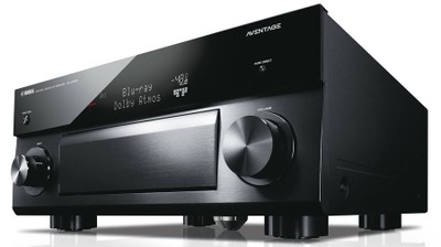

Yamaha does similar with their JEITA power rating (1kHz, 1 channel, 8 ohms, 10% THD), but at least they don't slap a sticker on the front panel. They also disclose 2 channel power at 1kHz and full bandwidth with specified 8-ohm load impedance and distortion levels. However, not too many years ago, they used to give you a summed power rating of all channels (i.e. 100 wpc x 7 = 700 watts), despite the fact that the receiver was incapable of delivering that power with all channels driven. At least they've moved away from that rating style in their more recent product releases from what we've seen.
Yamaha RX-A3070 Power Ratings various methods with 2CH ratings shown first

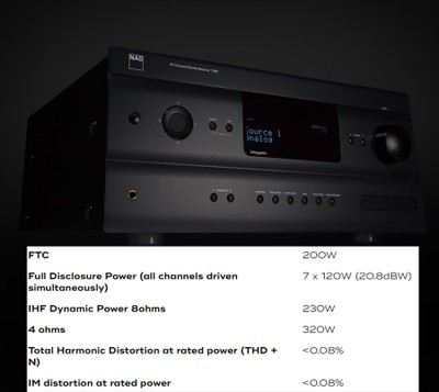

NAD T787 Receiver
MSRP: $2,500
NAD T787 7CH Receiver is ONLY major brand rating ACD Power
Now in comparison, look how NAD rates their AV receivers. Full disclosure of power per FTC for ALL channels driven. They are stating rated power more honestly at 120 watts/ch x 7 then you're getting with the examples above with only 1 or 2 channels driven at 6 ohms, 1kHz and high distortion. Sure, the number doesn't look as impressive, but it's real. Bravo!

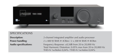

Here is an example of a very expensive two-channel integrated amplifier from a company named Lyngdorf. Their 2 x 400 watt (4 ohms) and 2 x 200 watt (8 ohms) power ratings look impressive upon first glance. But, when you look closer, they don't disclose bandwidth or distortion at full power but instead, only at 1 watt. For a product of this caliber, that's simply unacceptable especially when many of their competitors still using Class AB amplifier topologies give full disclosure of power. It is possible that this product can deliver full rated power at full bandwidth with both channels driven. But, you'd never know it from their poor specsmanship.

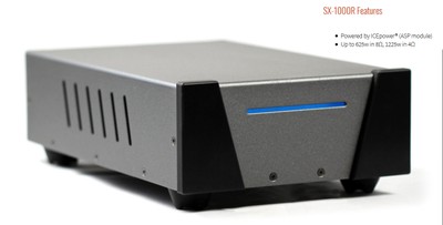

The next example can be seen from a company called Wyred4Sound. Their SX-1000R Monobloc retails for $1,799/ea and is rated for 625 watts into 8 ohms, and an impressive 1225 watts into 4 ohms. Again, no specifications for distortion or bandwidth are given.
Wyred4Sound SX-1000R Monobloc Amplifier
These may be great products and I'm not debating their fidelity. However, the manufacturers should be embarrassed to offer so few objective performance metrics. As Dr. Floyd Toole says, "You usually get more useful information from the sidewall of a tire than you do from loudspeaker manufacturer specifications...." I'm going to extend the usefulness of that phrase to how Class D amplifiers are being specified and sadly how the FTC is letting this go under the radar.

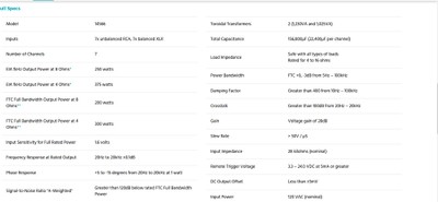

Monoprice Monolith-7 Specifications
Yet when we look at relatively inexpensive amplifier from Monoprice ($1,799 for 200 wpc x 7), full disclosure of power is given for ALL channels driven per FTC testing protocol. In fact, their website even shows full test data from the same Audio Precision audio analyzers we use for our product reviews! It makes you wonder just how many of these "high end" amplifier companies have access to this type of test gear or if they're just taking amplifier modules from chip vendors and just stuffing them into a box and hoping for the best.

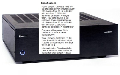

Outlaw Model 5000 5CH Amplifier
If you take a look at every amplifier Outlaw Audio sells, they too give full disclosure of power. In fact, we measured this very amplifier and it exceeded the 120 watts x 5 ACD. How is it possible that a company can offer so much transparency on such an inexpensive product while another manufacturer of a product costing 10 times the amount cannot? Incidentally, both examples disclosing full power are classic AB linear amplifier designs. Again, we typically see the lack of specifications on Class D power amplifiers and hope this article exposes that deficiency in order to nudge manufacturers to be more forthcoming with their power specifications.
