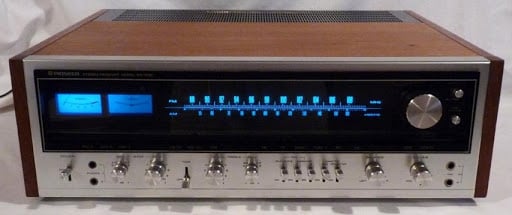

In 1974 the first consumer amplifier rating system was developed by the FTC to protect consumers from false claims in what had become a wave of new audio products hitting the market. The Amplifier Rule armed consumers with a universal rating system measured in “continuous" watts per channel rather than the much shorter and less meaningful "peak" or other instantaneous measurements that were in wide use at the time. The Rule also required manufacturers to measure maximum power output with both stereo channels operating simultaneously into 8 Ohms over a stated frequency range (not just at 1 kHz), and to disclose maximum Total Harmonic Distortion ("THD") at the rated power! The Rule was designed to let anyone easily compare differences in amplifier power, and allow them to better match amplifier power with speaker’s requirements with some semblance of confidence that they were getting what they paid for.
Although some might not agree with all of its provisions, I think we can all agree that it was a step in the right direction toward consumer protection given the pre-1974 wild west of dubious and fantastic claims made about the power of amps and receivers. A standard measurement was needed then, and the need continues today.
Market Reaction
Manufacturers are always incentivized to rate their systems with ever higher watt-per-channel ratings seemingly to project better value and performance to their customers. All things considered, “100-watts-per-channel” is an arbitrary target that has become a gold standard mainstream consumer amplifier power. The FTC’s goal with amplifier ratings was, as it remains, a way of ensuring we the consumer are getting what we believe we’re paying for. After the new rating system requirement was placed on new products in 1974, the very first “100 watt-per-channel” receivers began hitting the market. A “watts-per-channel” war of escalation ensued between popular manufacturers of the day like Pioneer, Marantz and Kenwood in what would go on to be remembered as the golden age in hi-fi and audio.

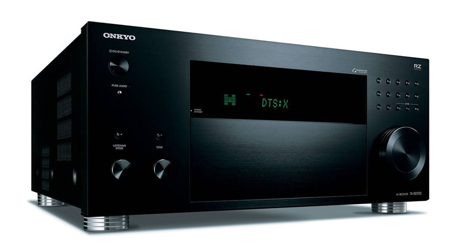

When the rule took effect in 1974, there were virtually no amplifiers with more than two channels, and the rule was designed primarily to govern stereo amplifier power ratings. Although the FTC has updated the Rule in certain areas, it chose not to expand the Rule to include a new testing procedure for rating the increasingly popular multichannel home theater receivers and amplifiers, which may provide seven or more discrete channels of power to several speakers using new surround formats like Dolby Atmos or DTS:X. However, the Commission has stated that the most prominent power rating for these amplifiers must be the FTC rating for stereo operation. Manufacturers can make additional claims for multichannel operation, but the consumer must be able to see how much continuous power an amplifier can produce with two channels operating simultaneously. The Commission has never enforced this requirement, or any part of the Rule for that matter. Many manufacturers have taken advantage of this vacuum by publishing a confusing array of unrealistic power claims. Some go so far as to slap a sticker on the front panel with an inflated power figure that's based on only one-channel driven at 6-ohms and 10% THD. For this problem, Audioholics has suggested a relatively simple, real world multi-channel rating system to give consumers a better idea of the power output when more than two available channels are driven simultaneously.

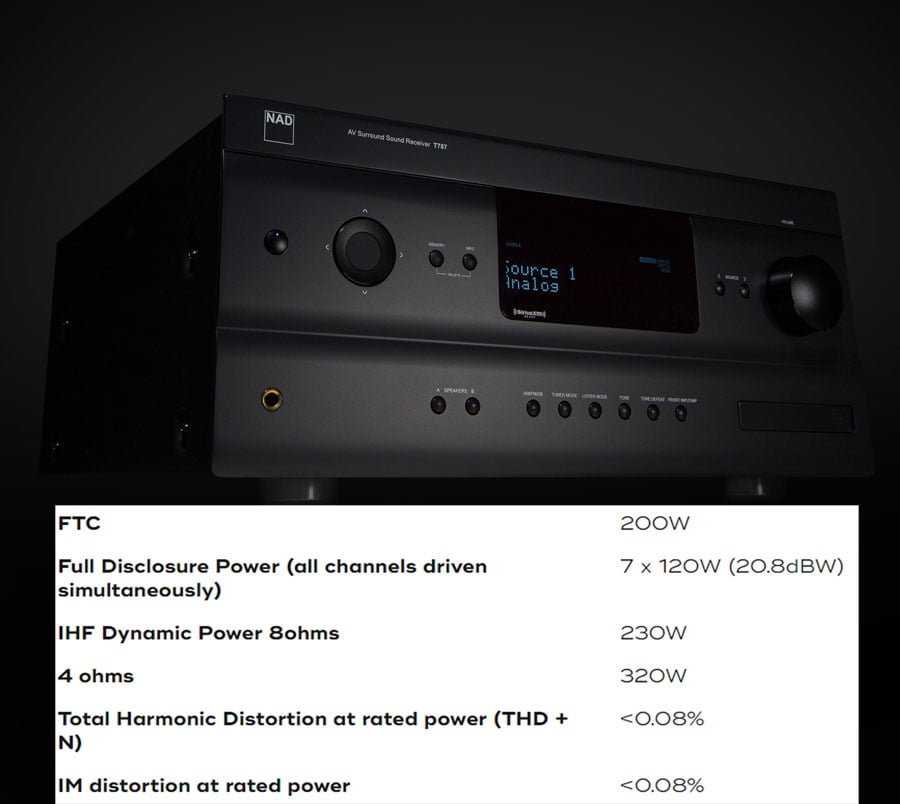

NAD T787 7CH Receiver is ONLY major brand rating ACD Power

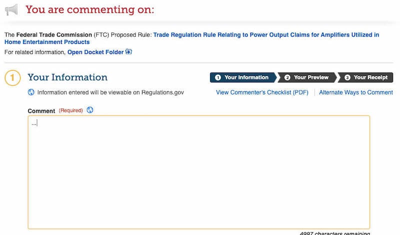

Visit the FTC’s "Trade Regulation Rule..." page (linked again below) then access public comments page (shown above) by clicking "Comment Now!" button in the upper-right of the page. Feel free copy and paste the following comment and let regulators know that consumers would benefit from the following refinement in the amplifier rule.
“I wish the FTC to save and enforce the Amplifier Rule but also amend the rule for today’s multi-channel amplifier products with the following measurement:
3CH driven, full power bandwidth, 8 ohms, at specified % THD+N (max 0.1% THD+N) with remaining channels driven at 1/8th power.”
Click here to leave your comment by February 16th, 2021: Trade Regulation Rule Relating to Power Output Claims for Amplifiers Utilized in Home Entertainment Products
