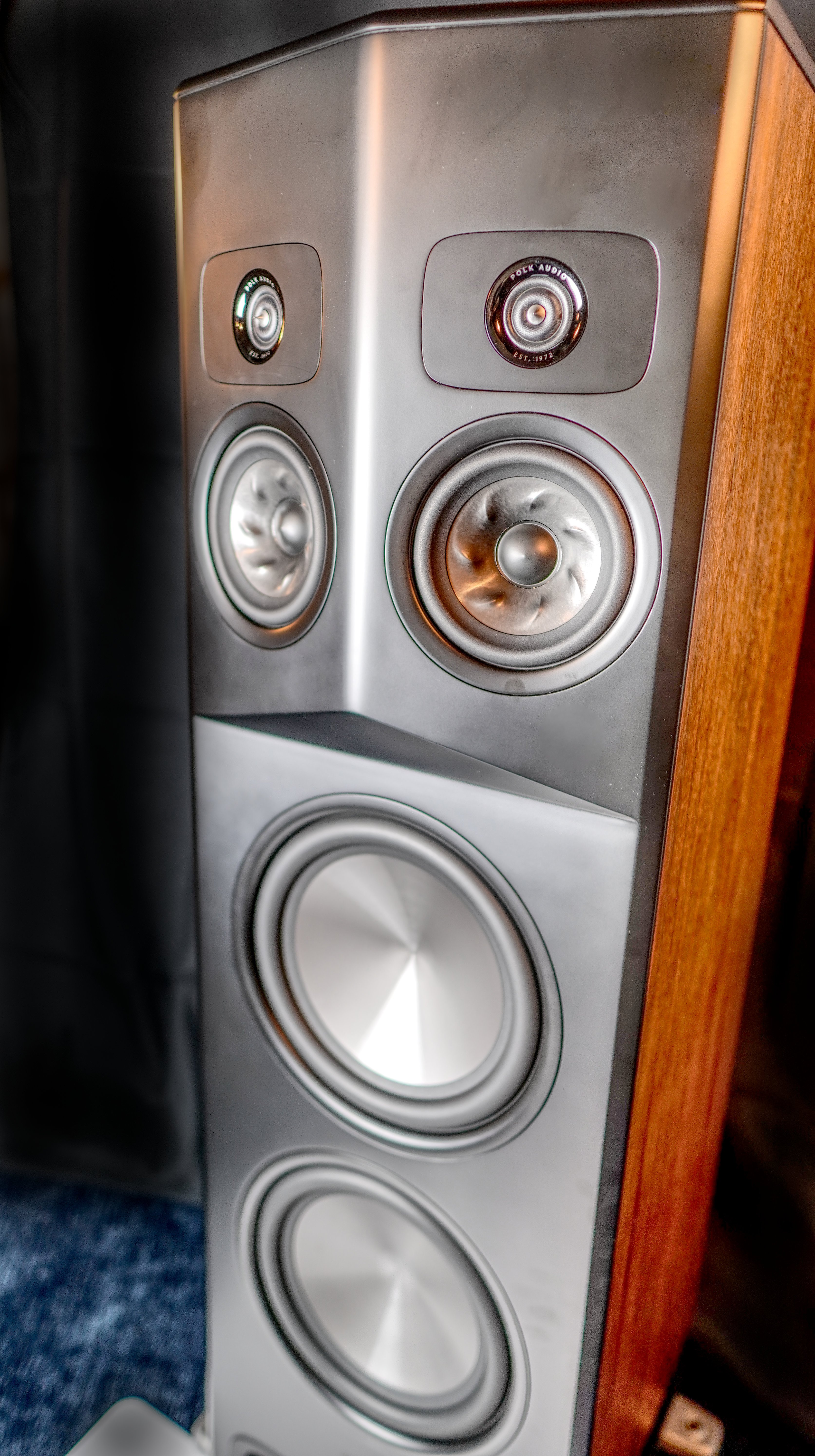

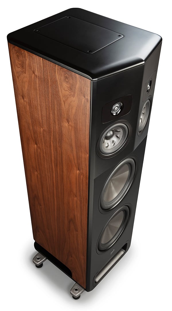

Packing and Appearance
The L800s
were very well packed. They were double-boxed with thick polyethylene foam
blocks giving them a good distance from the box walls. They were wrapped in a
soft fabric bag to protect them from slight scuffs or scratches with an outer
plastic back to protect them from moisture. With 150 lbs. shipping weight per
speaker, unboxing them was an elaborate ritual unto itself as we demonstrated
in our L800
Unboxing YouTube video. Once unpacked, we were met with a
speaker with formidable presence (a fancy way of saying it’s a big ‘un). Polk
has taken strong measures to make them as visually palatable as possible, and I
think they do look pretty cool, but they are so large that they certainly
wouldn’t be acceptable for everyone.
I should say here that when I say they look cool, I don’t mean to say they look elegant or gorgeous, which I don’t think they do. I think they look interesting and somewhat bold. Polk has tried to temper this with some rather traditional finish options where the user can have walnut side panels with a satin black front baffle or black ash side panels with a gloss black front baffle. These finishes are very nice and I would say furniture grade. They need to be furniture grade since the L800s are so large that they do have the presence of furniture. Without grilles, all of the drivers on the front baffle, especially across the SDA array, make the L800s look a bit busy compared to most speakers. The two 10” bass drivers give it a very beefy and capable appearance, and the SDA array makes it look like it could really rock the house, although, as we will discuss below, the outer set of drivers are there to eliminate sound, not add sound.
Polk Audio L800 Unboxing Overview
The grilles do a great job of muting the busy facade of the front baffle and make the L800s look rather stoic. They are magnetically attached, so there are no visible grille guides on the front baffle. One nice touch of visual flair is the dividing angle front baffle of the SDA array that the grilles carry all the way down the speaker. This slight wedge shape of the front baffle is not there for stylistic reasons, but rather practical concerns that I will explain later. However, I think it is the key ingredient in the neat look of these speakers. While this is an overall angular speaker, there are no hard edges since all of the edges have a slight rounding, and that certainly helps the L800s to look less aggressive than they could have, and that adds a touch of class to what might otherwise have been a bit more brutish appearance.

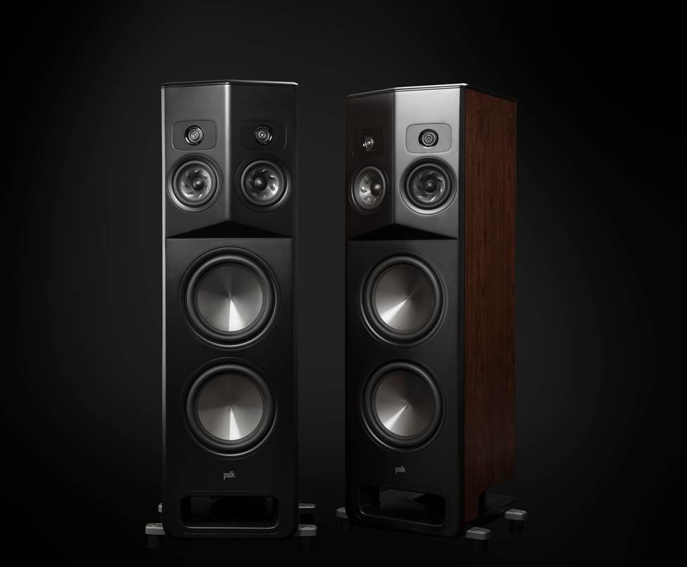

Design Analysis
The L800 has
a lot going on. Even setting aside the SDA technology, there is much to
distinguish it from other speakers in its class. In discussion with the L800’s
engineering staff, I was told that the L800 was first designed to be the best
speaker they know how to make. The SDA technology was then layered onto that
speaker. Let’s talk about some of the more normal features that it employs to
improve performance before we get into the SDA stuff. Its base design is a
three-way tower speaker using 10” bass drivers, 5.25” midrange drivers, and 1”
ring radiator tweeters. The drivers that it uses are all new and custom made
for the Legend series. For a detailed discussion of these elements, let’s start

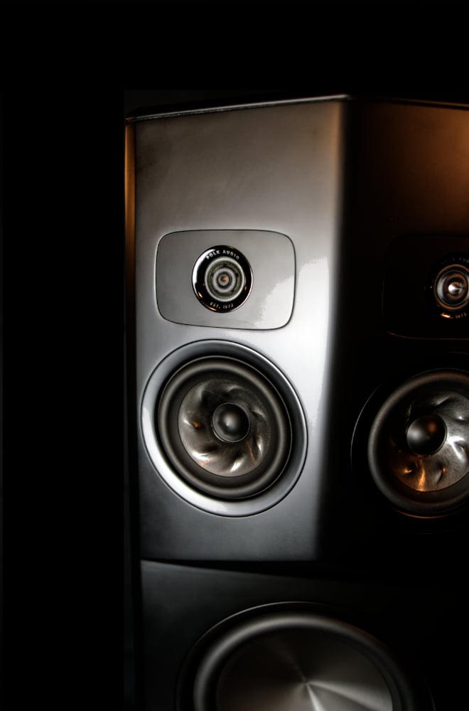

at the top with the ring radiating tweeter. Polk has been using ring radiator
tweeters for decades, and this iteration of their ring radiators, which they
call the ‘Pinnacle Ring Radiator,’ is their most refined version yet of this
tweeter type. Why go with a ring radiator and not the usual dome tweeter? I
will quote from Audioholic’s review of the Legend L200 and L400
which uses these same components:
The way ring radiators work is that instead of having the voice coil former affixed to a dome as in traditional dome tweeters, the voice coil former is simply connected to two large soft ringed suspension pieces: an outer ring and an inner ring. The inner ring is connected to a stationary rod in the center that also holds that needle-looking phase plug. Whereas in normal dome tweeters, the acoustic radiating surface is the dome, in a ring radiator, the acoustic radiating surface is these two large suspension rings. Normally the suspension bits in drivers are used merely to hold an acoustic radiating surface in a manner where it only has one plane of travel, back and forth.
One of the advantages of ring radiators is that ‘break-up’ modes are pushed out to much higher frequencies versus typical dome tweeters. ‘Break-up’ modes are where the radiating surface, whether that be a dome, cone, or plane, loses its shape from playing frequencies so high that it bends only part of the surface instead of the entire surface. It can really hurt the sound quality from any speaker where it is not controlled. Another advantage is that ring radiators can easily play to ultrasonic frequencies since the soft suspension piece being driven is usually much lighter than traditional dome materials.
The midrange driver was also nicely explained in article:
...the midrange driver is a unique design in the Legend series. The cone is made out of foamed polymer and is peculiarly shaped such that Polk calls it the ‘Turbine Cone.’ The cone has seven fin-type protrusions that form a vortex pattern hence the name ‘turbine.’ The shape and number of these fins are claimed to make the cone stiffer which can drive break-up modes higher in frequency where they will be easier to filter out by the crossover circuit.

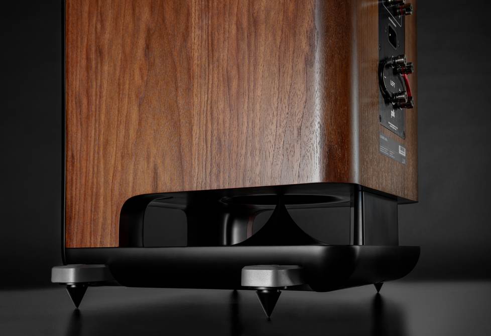

more serious bass drivers. For the lowest octave, these bass drivers charge a

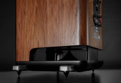

bottom-mounted port that Polk calls the ‘Power Port.’ Again, taking from the
description from our previous Legend review:
“The idea behind the Power Port is that it preserves the laminar flow of air within the port by controlling its contact with the environment from a flared cone piece that is mounted over the port opening. This should protect against port turbulence at higher drive levels better than traditional port designs.”
For the L800, Polk calls the crossover design the ‘Orth’ crossover circuit, naming it after the lead designer at Polk, Scott Orth. The Orth crossover is not a crossover type so much as it is a set of guidelines that Mr. Orth likes to use in crossover design that is recounted in the design analysis section of the above-quoted L200/L400 review. The L800 crosses the bass drivers over to the midrange driver at 370Hz and goes from midrange driver to tweeter at 2.8kHz. The exact slope is not provided, but is said to be around 3rd order on the midrange and tweeter. Crossover parts were also not easily accessible, but it is my understanding that they are good quality for the money rather than cost no object. The crossover circuit would have to be very elaborate for a speaker of this complexity. The L800s have dual binding posts for bi-amping or bi-wiring options (we regard bi-wiring as ineffectual and don’t encourage it). While bi-amping is normally an excessive and unneeded feature on many loudspeakers meant for home audio, that is not the case for the L800s. With a specified 87dB sensitivity, these are not extraordinarily sensitive speakers, yet they can take a lot of power on account of the dual 10” bass drivers. Users could bi-amp these speakers and run the bass driver section on a really beefy amplifier, and the L800 can actually take advantage of that power unlike so many other home audio loudspeakers.
The cabinet is very stout with a network of internal bracing that includes a sealed compartment for the midrange drivers. There is a removable plate at the top which gives users the option to install an up-firing Atmos module. We didn’t receive an Atmos module, which must be purchased separately by users, and so we will not be covering that aspect of the L800, except to say that it looks like it could work somewhat better than most Atmos modules by virtue of being sunk in the cabinet so that less of the sound from the speaker will hit the user directly. Ideally, users will only want reflected sound to reach their ears from Atmos modules, not direct sound. The grilles are touted to be acoustically transparent by Polk. While no grille is truly acoustically transparent, the L800 grilles look like their acoustic effects would be insignificant for practical purposes given the minimal frame. Users have the option of using either spiked feet for carpeted surfaces or rubber feet for hard flooring. The 5-way binding posts are solid and high-quality. They use a wire jumper instead of a chunk of sheet metal like most other speakers. The overall build quality is very good, as one would expect from a loudspeaker at this price point.

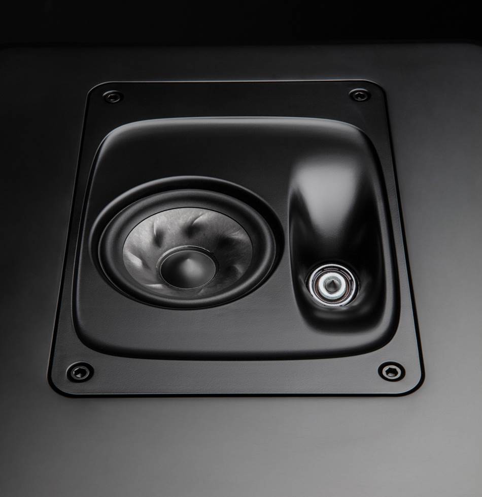

To put it simply, the SDA technology eliminates or reduces sound reaching the listener’s ear from the opposing side speaker, so that, for example, sound from the left speaker is not heard by the right ear. This improves the imaging ability of the sound system. To go into more detail, we are going to get a bit technical.
The above-mentioned effect of sound from one of the stereo channels reaching the opposite-side ear is called inter-aural crosstalk. In theory, you would want sound from the left speaker to only reach the left ear and right speaker to only reach the right ear. Inter-aural crosstalk is a distortion that “smears” the imaging in the sense that it makes the speakers themselves more localizable and thus restricts the sound image between the speakers. Headphones have no inter-aural crosstalk and so the headphones themselves can’t be localized, and this is why headphones have large spacious images. However the headphone sound is stuck inside the listeners head (a lack of externalization) and doesn’t sound very realistic. The reason for that is the sound from headphones bypasses many of the acoustic effects of our head, ears, and body. In addition, headphone sound doesn’t change with respect to head movement. Only extremely sophisticated headphone systems can overcome these flaws, and presently those only reside in laboratories (though are becoming increasingly common in less costly products).
At this point, we might ask how much of a problem is inter-aural crosstalk in reality? Many of us have experienced great imaging from speakers that don’t have SDA technology, so how much of a difference has inter-aural crosstalk been shown to make? Of course, a lot of research has gone into recreating a soundscape more accurately, and one of the problems with 2-channel systems is that they contain various “distortions” that prevent the proper illusion. The biggest “distortion” preventing a 3D presentation of the soundscape is that the way in which the actual sound object is reproduced is not realistic, and one example is that the sound object is a virtual object created by a pair of speakers which radiate sound differently from how that actual sound object would. That radiation problem causes crosstalk between the ears and as such, you get a smeared reproduction of the sound object. In practice, we are used to this and it doesn’t destroy the effect, but that doesn’t mean it’s realistic or accurate.
There have been various measures over the past decades to reduce inter-aural crosstalk. Crosstalk cancellation and stereo expanders were popular in the 80’s, but many found the effect artificial (in reality, the effect is “more” realistic, but often introduced its own distortions). A problem with most of those crosstalk cancellers is that it requires a narrow listening window in order to hear the effect to its best advantage. One experiment, by Timothy Brock and Don Keele, eliminated inter-aural crosstalk by simply using a physical barrier that extended from between the speakers to the listener’s head. They note that this creates very realistic imaging which expands over a full 90 degrees, yet the speakers were very close together while still achieving a massive soundstage that is far beyond the confines of the speaker locations.
Crosstalk cancellation solutions have often been problematic in that they required unacceptable compromises in listening (sitting in only one perfect spot, large added barriers in a room, added sound colorations, etc.) The key is to understand that the love affair with crosstalk cancellation is not that it was a neat effect, but rather it was a search for more realistic imaging; what many call a fun effect is actually more realistic. The problem is that we aren’t all that bothered by the distortion since we are used to hearing reproduced sound that way, so we often perceive normal speakers as being “more” natural. It is only more natural in the sense that it is naturally what a pair of speakers does and is thus what we are used to. It is not more natural in the sense of how we locate real objects in space.
Polk’s Stereo Dimensional Array (SDA) addresses a real problem but may not be one that bothers many. The advantage of the SDA approach is that it does not lock you into a small optimal listening window. You can still move your head around and hear the effect. Furthermore, at the right listening distance, multiple listeners can enjoy the benefits without much loss of fidelity. The negative is that, like other systems, it does introduce a small but noticeable timbre distortion.
SDA is a kind of analog acoustic crosstalk cancellation. It uses speaker drivers placed precisely the distance between the average human ears on each cabinet to achieve crosstalk cancellation. The outer midrange driver and tweeter of each L800 speaker produces an inverted signal of the opposite speaker. This is an attempt to cancel out the sound of one of the speakers from reaching the opposite side ear. The cancellation method is similar to how active noise cancelling headphones work; generating a sound of the same amplitude but opposite phase negates the original sound. Polk’s new “Pro SDA” updates the original SDA by incorporating improvements including headshadow response, which allows the SDA cross-talk cancellation to be expanded into the treble region without serious interference problems. The Pro improvement adds a 15-degree baffle angle which helps narrow the speaker overall while also building in the toe angle needed for best sound. The new technology does a better job matching the true interaural crosstalk distortion created with most speakers and thus more completely cancels it.
Many will ask why this SDA technology is needed. After all, if we listen to an instrument in a room, do not both ears hear that instrument, regardless of its placement? Is this really a distortion we should be concerned with? Keep in mind, first, not everyone agrees this is the right solution to the problem it is trying to solve. Inter-aural crosstalk cancellation helps a speaker act more like a headphone allowing for the accurate reproduction of binaural recordings. It works well with normal recordings as well, but with diminished effect. The purpose is to more accurately recreate the original sense of space in the recording. The crosstalk distortion tends to diminish our sense of space we hear from the recording and rely more on the room’s ability to reproduce that sense of space. While some will argue this is a solution in search of a problem, others will argue it is solving a very important problem impacting the realistic reproduction of sound. What do I think? Decide for yourself after hearing them setup right.

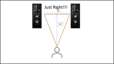

Setting up the L800

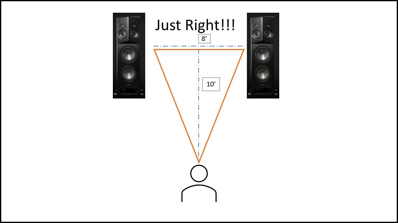

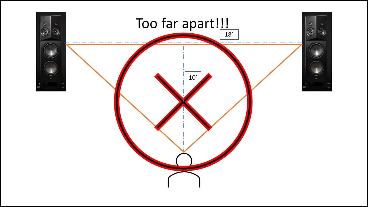

The L800s are an unusual speaker and so setting them
up is also a bit unusual. Whereas many speakers are recommended to have the
listener position form an equilateral triangle with the left and right
speakers, the L800s work best when they are positioned much closer together
than typical placements, so the speakers should be much closer together than
you are from them. As an example, for a listening distance of 8’, a speaker
spacing distance of 5’-6’ works best. For a distance of 10’, 7’-8’ apart might

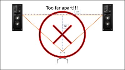

make the most sense. A certain minimum distance apart, say 4’-5’ seemed
necessary, but placing the speakers farther apart did not widen the image, it
simply ruined it. If you're able to listen at more than 10’-12’ back from the
speakers, it may still make sense to try the speakers at a narrow 6’ to 8’
apart, and you might find the 6’ distance still sounds best. Moving the
speakers farther apart, when at a sufficiently far listening distance,
increases the optimal listening window and allows more people to enjoy good sound.
However, the key is sufficient listening distance. While 8’ apart is enough to
allow 3 people across to enjoy the imaging, you would need to be about 10’ to
12’ back at a minimum for this to work well.

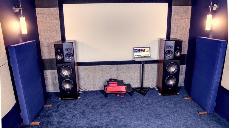

The near wall placement and close
distance apart makes these ideal speakers for many people’s homes where the
speakers can be placed on either side of a TV pushed against a wall. This
normally degrades imaging for normal speakers, but with the Polk L800s, it is
ideal. They will recreate a giant image that extends beyond the walls of the
room even in this placement (in fact, because of this placement). If the
speakers are pushed too far apart, the image shrinks, and the inter-aural
crosstalk cancelation is diminished. This near-wall placement also helps to
reinforce low frequencies through boundary gain which strengthens bass.

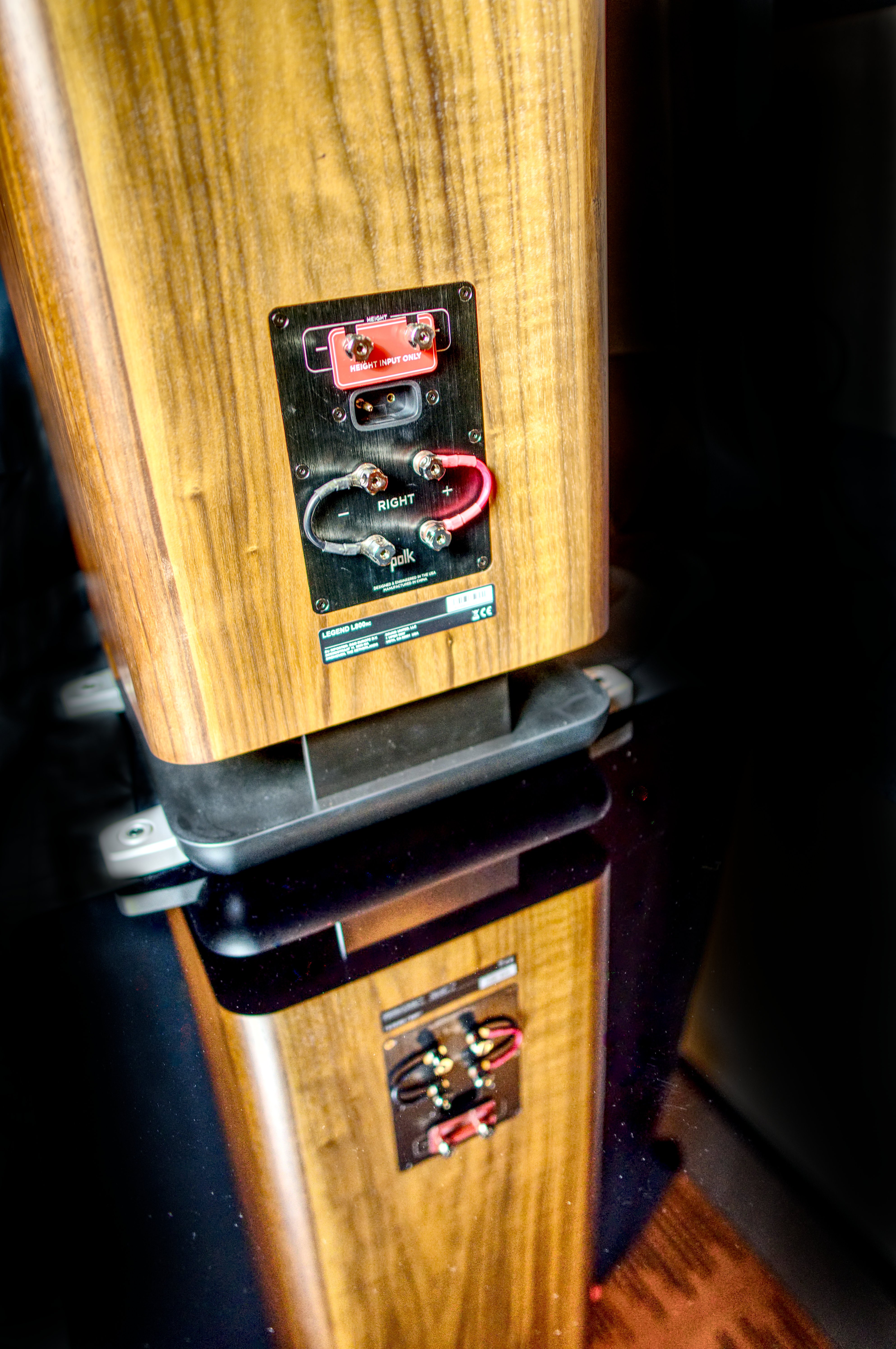

The SDA speakers require sound from each speaker to be sent to the other speaker 180 degrees out of phase, and this is done via what Polk calls an ‘umbilical’ cord. Polk includes two umbilical cords that are each 12’ long. They can be connected together for a 24’ length which can be useful in case you need to route the cables around something. The cable is quite substantial and reminds me of those high-end audio cables with oversized jackets. The umbilical cords are probably better than they needed to be. The have a proprietary connect that utilizes a banana plug and jack on each side. This would be difficult to DIY, so the factory cable is necessary.
One important set up point is that differential output amplifiers will not work as well with the SDA technology. The SDA feed comes from the positive leg of the speaker inputs. With single-ended amplifiers, that gives all of the difference signal, but with a differential amp, you only get half of the difference signal. We tested both and found better sound with single-ended amplifiers. Most modern Class D amplifiers have differential outputs and won’t work well, such as the Cherry Megachino I tried, the Hypex based amplifiers (including Marantz’s own Reference PM-10), various NAD amplifiers, etc. Most amplifiers in general are single-ended output so finding a good amplifier that works is not a big problem. The best way to tell is to look at the back of the amplifier and see if it notes that the negative terminal of the amplifier cannot be connected to ground or if it is referred to as a balanced output or differential output amplifier. If all else fails, ask the manufacturer.
When the L800s were used in my room (11’ wide), we found the best sound was achieved using a lot of early reflection absorption. It seems the inter-aural crosstalk cancelation was negatively impacted by sidewall reflections. We confirmed this using binaural recordings. It suggests that if the speakers are within 3’ of the sidewalls, it may make good sense to add a lot of sidewall absorption. This can be achieved with purpose made acoustic panels, but thick curtains would do a similar job. Crosstalk cancelation happens over a limited and mostly mid to high frequency bandwidth.

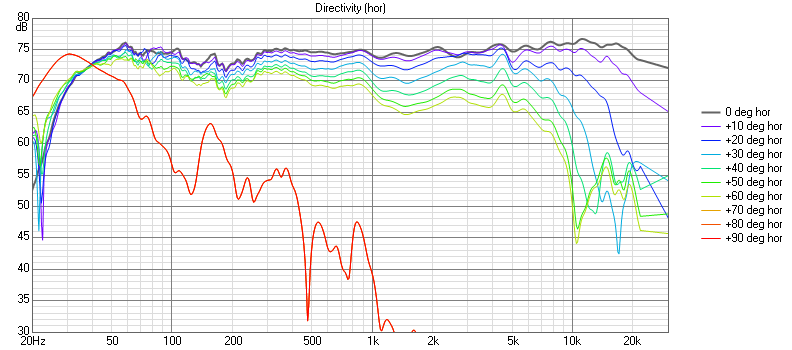

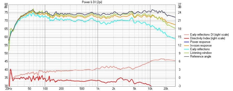

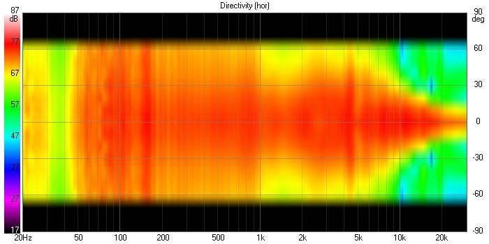

The L800 is such an eccentric speaker that it cannot be measured as a normal speaker would. Instead I employed a nearfield splicing method consistent with how Stereophile’s John Atkinson measures speakers. Due to the size of the speaker and size of the room I had to measure within, I was only able to measure out to 60 degrees on the horizontal axis. My results were shared with Polk’s engineers and Polks own internal measurements were shared back with me. Results were found to have a very high degree of agreement.
To measure the L800, I placed it on a 1’ stand on top of a lazy susan like device. The speaker was measured at a distance of 1 meter (with a conformation of response at 2 meters to ensure nearfield). It was measured in 5 degree increments out to 90 degrees, but I only kept those measurements not corrupted by reflections beyond use. Farfield measurements were windowed to remove reflections. Woofer and port were measured in the nearfield, and the woofer was also measured groundplane. Data was processed within VituixCad2 for display.
The above graph shows the direct-axis frequency response and other curves that describe the speaker’s amplitude response in a number of ways. For more information about the meaning of these curves, please refer to our article Understanding Loudspeaker Measurements Part 1. The L800s can be seen to have a very linear response and maintain a tight window from 40Hz to 20kHz. These are very accurate speakers. From these curves, we can see that the L800 has a very wide dispersion out to 5kHz and then begins to narrow a bit from there. At 10kHz and above, the dispersion becomes very narrow; this is not unexpected given what we have seen from the Legend series ring radiator tweeters in our L200/L400 review. The L800s are best listened to on-axis so that the tweeter faces the listener. Those who are sensitive to high frequencies can simply listen at a slight off-axis angle to shear off exposure to treble output.
The above graphs depict the L800’s direct-axis and horizontal dispersion out to a 60-degree angle in five-degree increments. Information on how to interpret these graphs can be read in Understanding Loudspeaker Review Measurements Part II. These measurements show a speaker with very good if slightly idiosyncratic performance. The response is mostly flat and neutral on-axis. The speaker shows a slight rise, characteristic of all Legend series speakers, in the treble. However, as had already been noted, the tweeter beams noticeably off-axis in the high treble band, so the listening window maintains a neutral balance. The rise is also not that aggressive, being only a few dB’s as you reach toward 10khz. Again, we see that this is an accurate loudspeaker, if perhaps a tad forward due to the very slight treble rise. For those who want a warmer sound as well as the SDA imaging, it would only take a light touch of equalization to get there.
Note: All measurements were taken with the SDA drivers disconnected. Measuring the speaker with SDA active is very difficult to do accurately. While I did measure it this way, the manufacturer had concern that this approach was not accurately reflecting the response of the speaker.
The above polar map graphs show the same information that the preceding graphs do but depict it in a way that can offer new insight regarding these speakers’ behavior. Instead of using individual raised lines to illustrate amplitude, these polar maps use color to portray amplitude, and this allows the use of a purely angle/frequency axis perspective. The advantage of these graphs is they can let us see broader trends of the speaker’s behavior more easily. For more information about the meaning of these graphs, we again refer the reader to Understanding Loudspeaker Review Measurements Part II.
Here we can see that the bass to midrange dispersion of the L800 extends out to the 60 degrees that we were able to measure. We get a better look at the beaming that occurs at 5kHz and above. If you want to be met with the full range of treble out to 20kHz, you will need to be listening on-axis with maybe a +/-10 degree tolerance. The good news is that there is not much content in that extreme upper band between 15kHz and 20kHz, so even if you aren’t listening in that window, you won’t be missing much. That assumes that the listener can hear frequencies that high. Most older adults in industrialized countries have some level of high frequency hearing loss, especially in men older than 50, so there is a good chance that the reader will have trouble hearing anything in that frequency band anyway. Response issues in the high treble range of 15kHz to 20kHz is rarely of any audible consequence.
