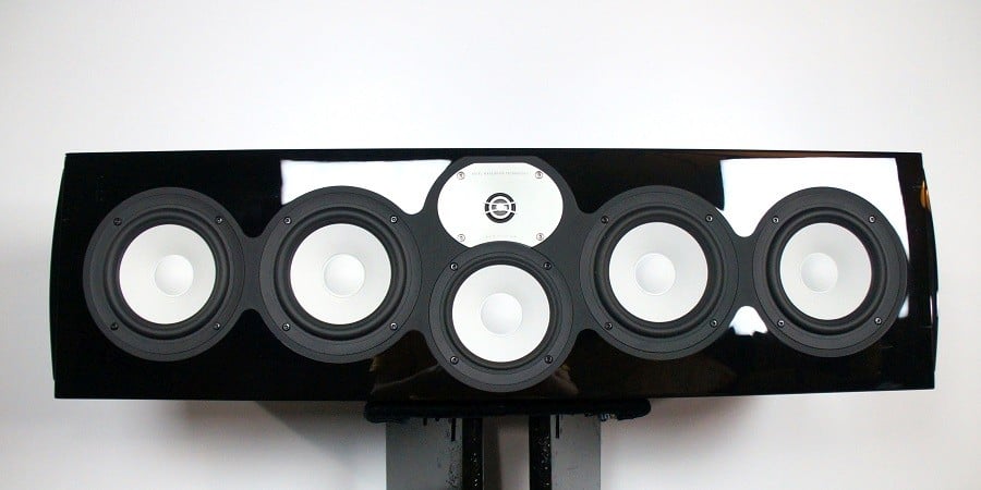

The C426Be interests us because the specs for it suggests that it is doing everything right for a center speaker. It uses a three-way design where the midrange driver has crossed over at a low enough frequency to the bass drivers that there should not be many if any lobing artifacts in the horizontal plane, which is a problem with so many center speaker designs. We will get into this more in the design analysis section of this review, but the driver layout and crossover frequencies suggest a highly-optimized design that avoids many of the traditional pitfalls of conventional center speaker designs. Given what we know of center speaker design attributes, the C426Be could be an extremely good center speaker, but that still remains to be seen when we do our listening tests and objective measurements. With that being said, now take a closer look at the F226Be and C426Be speakers to see if they keep the promises made by their design…

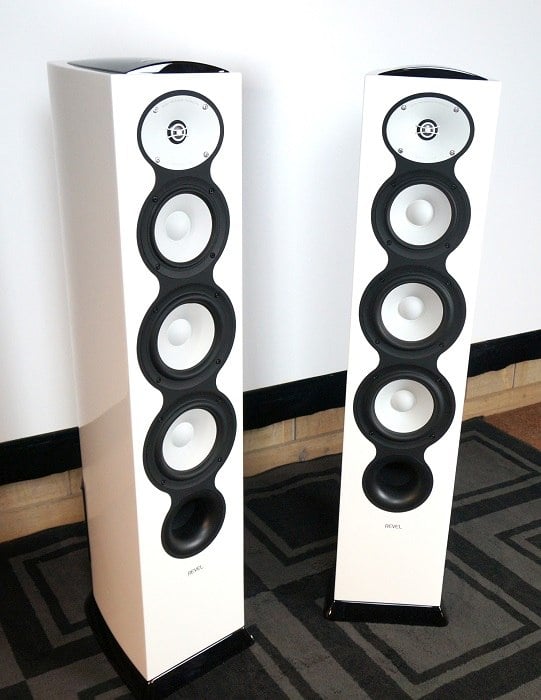

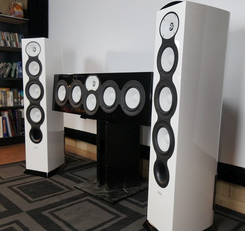

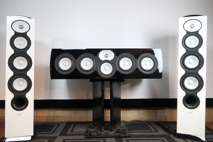

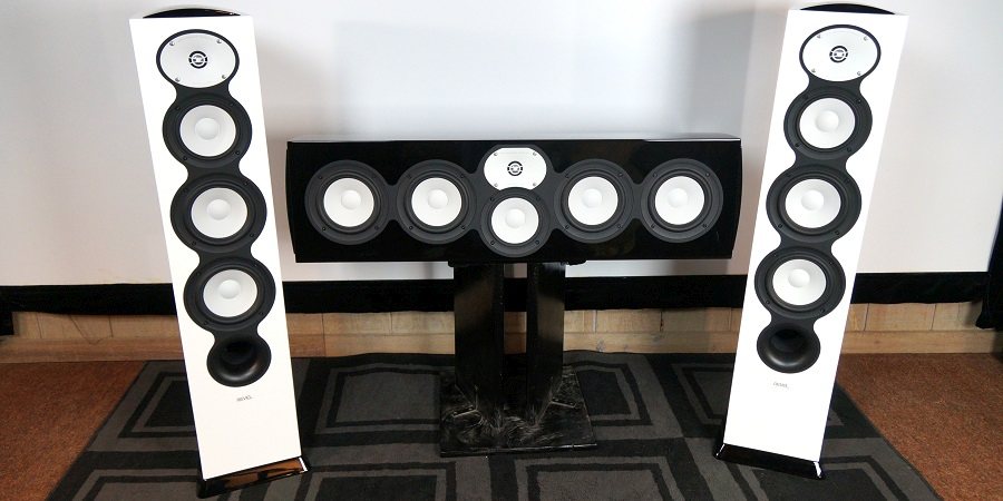

Performa logo.jpgAs with the M126Be speakers, the F226Be and C426Be are very attractive speakers. The only people who would think they are ugly are those who just hate the appearance of speakers, period. I received gloss white F226Be speakers and a gloss black C426Be center, but the PerformaBe speakers can also be had in metallic silver and Walnut as well. The gloss finish on the PerformaBe speakers is pristine. While the speakers I received wasn’t quite a matched set, the way in which they mismatched played very nicely off of each other. The white cones are surrounded by black trim, with the rest of the speaker having a solid color gloss. The cabinets are gracefully curved and end in a rounding in the back. The F226Be speakers have a high-gloss ‘top cap’ on them that, as I had said about the M126Be speakers, gives them an almost automotive styling. The center has these ‘top cap’ pieces mounted on its sides. Everything on these speakers has a gleaming polish except for the cones and trim around the drivers.
 Revel F226Be Towers & C426Be Center Channel Speakers (no grilles left pic; grilles on right pic)

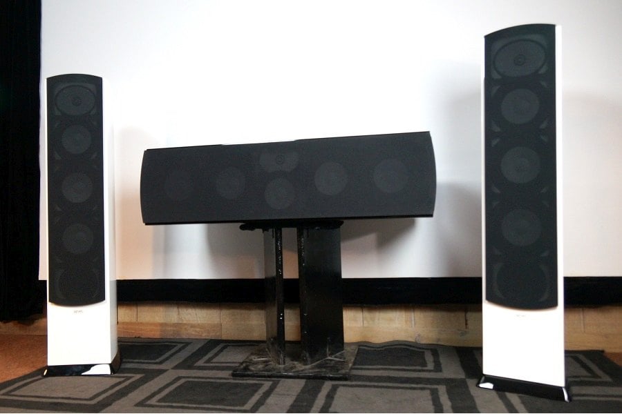

If the whiteness of the drivers is too aesthetically loud for some folks, they can just use the grilles to blank out the front baffle. The grilles attach magnetically, so there are no grille guides to blemish the front baffle. These speakers look so much better without the grilles though, in my opinion. The grilles should only be used to protect the drivers in situations where children (or clueless adults) could potentially push in the dustcaps of the cones. One unavoidable visual aspect of the C426Be is that it is a big center speaker. At nearly 40” wide, it is just about as wide as many tower speakers are tall. It isn’t likely to fit in the shelving slots of many entertainment centers (however if you intend to place a speaker of this caliber in a location as bad as an entertainment center shelf slot, shame on you!). Potential buyers will want to be sure that the C426Be’s size can be accommodated.
The F226Be and C426Be speakers are expensive speakers, and they look like it. Let’s now take a look at the design to see if the level of engineering matches the price as well as the aesthetics…

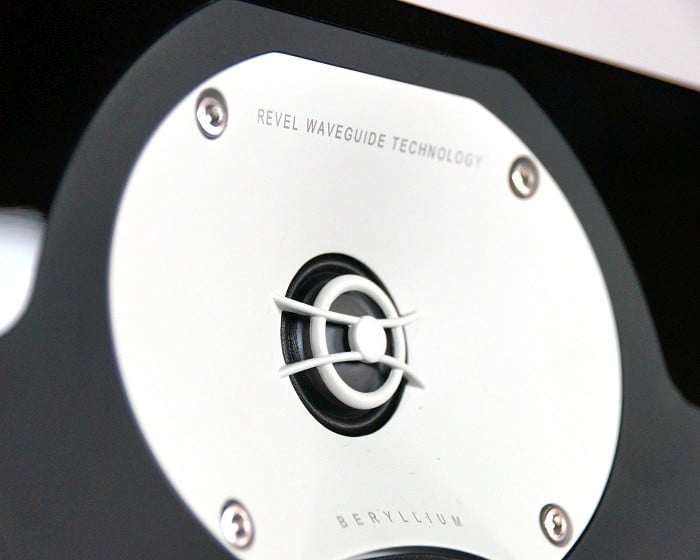

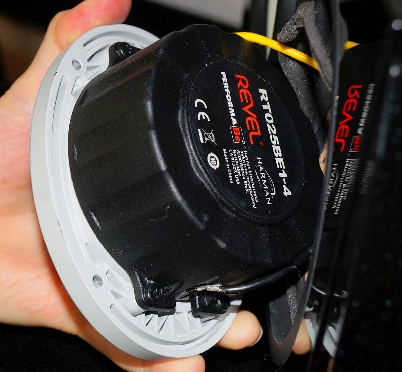

The use of beryllium for the tweeter diaphragm is heavily touted as a selling point by Revel. Revel’s desire to bank on their use of Beryllium likely comes from the fact that it is quite expensive to use, but it does have ideal properties for use as a tweeter dome.
To quote from our review of the M126Be which uses the same tweeter and waveguide:
This is on account of its low weight combined with its very high stiffness; this Audioholics article on how to identify high fidelity loudspeakers discusses the matter of diaphragm composition and Beryllium’s advantages. It is three times stiffer than conventional diaphragm materials such as aluminum but exhibits three times the damping and is only half the weight. The reason why it isn’t more widely used is expense: I am told that an aluminum dome normally costs under 25 cents whereas a Beryllium dome costs over 30 dollars (and that's not counting the motor structure or other parts of the driver itself). The Beryllium tweeter is mounted in Revel’s latest generation waveguide so that directivity is better controlled than previous Revel waveguides. When we remove the tweeter driver from the cabinet, it is absolutely massive and is by far the largest tweeter motor I have personally seen to date. Part of the reason why it is so large is because of the two 3 ⅓” ceramic magnets which give the tweeter a major boost in sensitivity. Ceramic magnets also have the advantage of better heat dissipation over the Neodymium magnets that most tweeters use.
One of the reasons why Beryllium is so expensive is that it is a highly toxic material to manufacture with, although the end result as a tweeter diaphragm is not dangerous (so long as you don’t eat your tweeter or vaporize it and breath in the fumes). Many special measures must be taken in order to safely process it, and these extra measures are a major contributing factor in their cost.

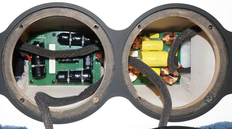

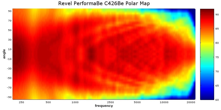

The bass drivers are low-pass filtered at 260Hz on the F226Be and 210Hz on the C426Be, and both filters use 3rd-order slopes. The midrange drivers crossover to the tweeter at 2.1kHz with a 2nd-order slope on both speakers. The F226Be tweeter uses a 3rd-order high-pass filter while the C426Be uses a 2nd-order high-pass filter. Taking a look at the F226Be crossover circuit, we can see it is a fairly extensive piece with 18 elements altogether, with some large iron-core inductors and electrolytic capacitors in the bass driver’s filter, and a slew of air-core inductors, resistors, and polypropylene film capacitors in the midrange and tweeter’s circuit. The crossover in the C426Be was partially obscured by stuffing but looked to be a similarly formidable affair. Both speakers have dual binding posts for those who want to bi-wire or bi-amp the midrange/tweeter and bass driver separately.

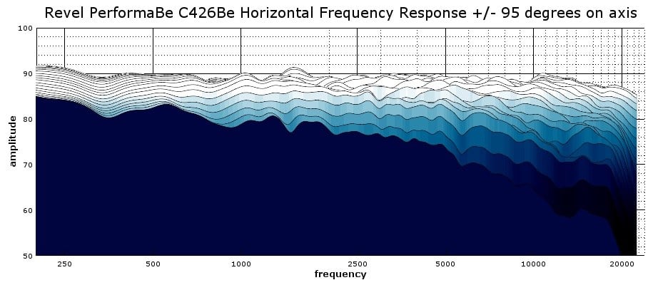

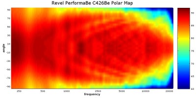

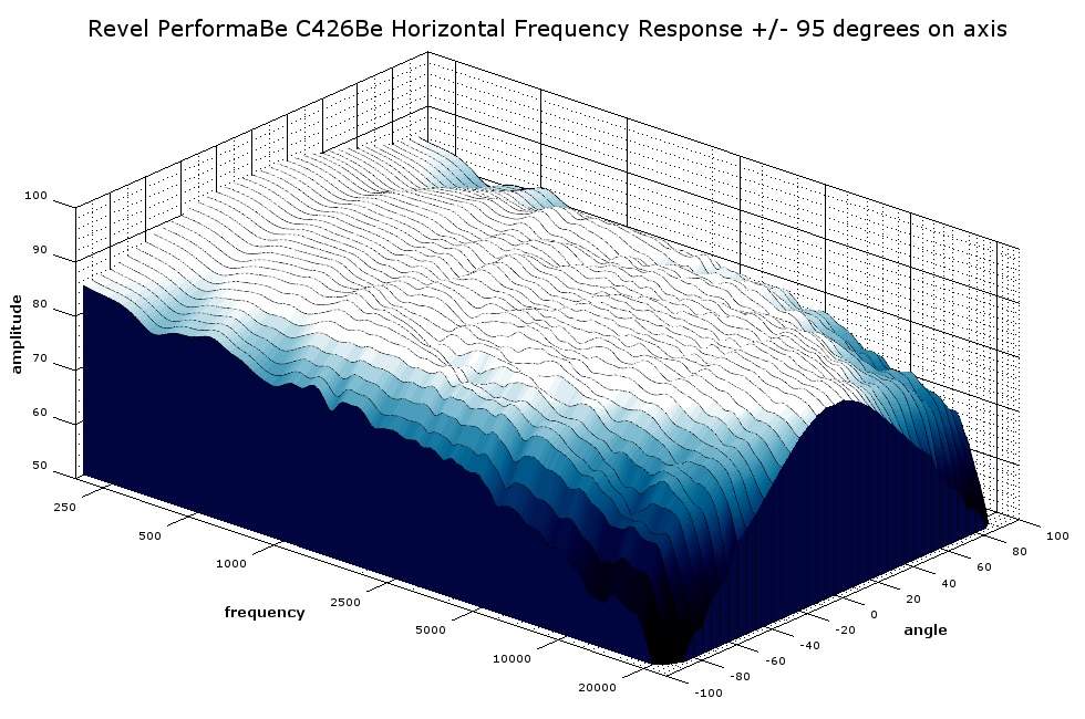

The low crossover frequency on the bass drivers in the C426Be could be a real advantage in horizontal directivity control in that speaker. Normally when drivers are mounted horizontally, they can end up creating cancellation nulls off-axis, and that isn’t a beneficial attribute in a center speaker even though so many centers end up doing just that. It could be a real problem with a speaker with four drivers mounted in a horizontal plane, but Revel significantly restricts their bandwidth to lower frequencies. When the spacing of points of acoustic emission (in our case, bass drivers) is less than the distance of the wavelength that they produce, they act as a single source of acoustic emission and will not interfere with each other. The 210Hz low-pass frequency has a wavelength of 64 inches which is longer than the width of the entire speaker, and the aggressive 3rd-order slope of the filter should dramatically reduce acoustic radiation from the bass drivers above their crossover frequency, so the C426Be speaker should be free of off-axis nulls that plague so many center speakers. For those who want to dig deeper into this subject, see our previous articles dealing with center speaker design: Vertical vs Horizontal Center Speaker Designs and Center Speaker Design Additional Considerations. We will see how well Revel’s efforts to maintain horizontal directivity work when we get to the measurements section.

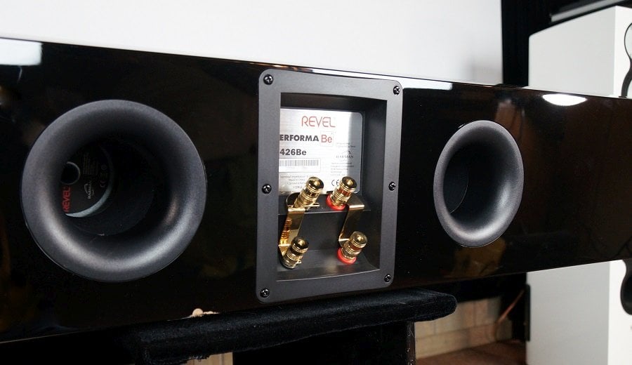

The cabinets are made from ¾” MDF. The midrange driver in both speakers is housed in a compartment that is internally sealed from the rest of the enclosure so that the backwave radiation of the bass drivers do not affect it. The midrange driver compartment as well as two window braces help to strengthen the enclosure. The C426Be is chocked full of acoustic stuffing throughout while the F226Be has bunched up acoustic stuffing in the top and bottom of the enclosure. One interesting detail is that the shape of the waveguide in the C426Be has been altered to accommodate closer spacing to the midrange driver. This helps to reduce the cabinet height as well as lessens the off-axis crossover cancellation lobe on the vertical axis. The front-firing port on the F226Be has a somewhat short 5 ½” length with a 2 ¾” diameter and is heavily flared on both ends. The C426Be has two rear-mounted ports with 8” lengths and 2 ¾” diameters. Both speakers come with port plugs for those who want to seal the ports for reduced bass output and extension. The F226Be comes with spiked feet that can be installed for those who don’t want the cabinet base itself resting on a surface. The C426Be has feet of differing heights that can be used to adjust the angle of the speaker.
As we can see from this analysis, there is some serious engineering put into these speakers, which is what one would hope for in speakers of their pricing. Let’s now give them a listen to hear how all of this sophisticated design adds up in practice…
