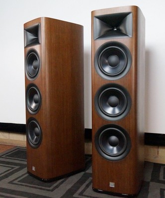

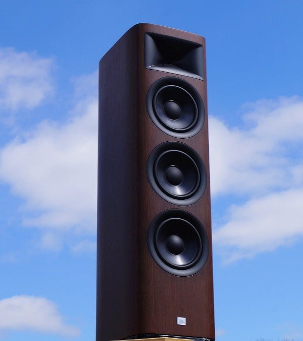

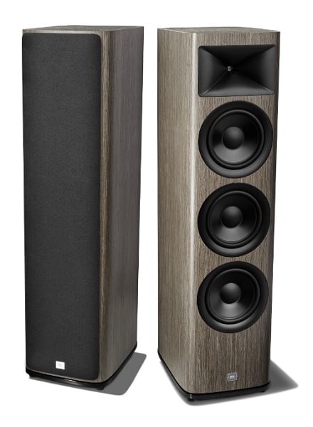

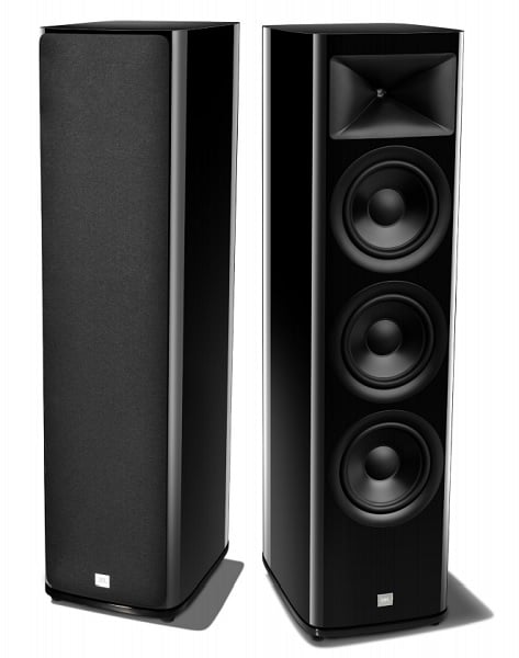

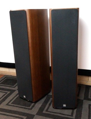

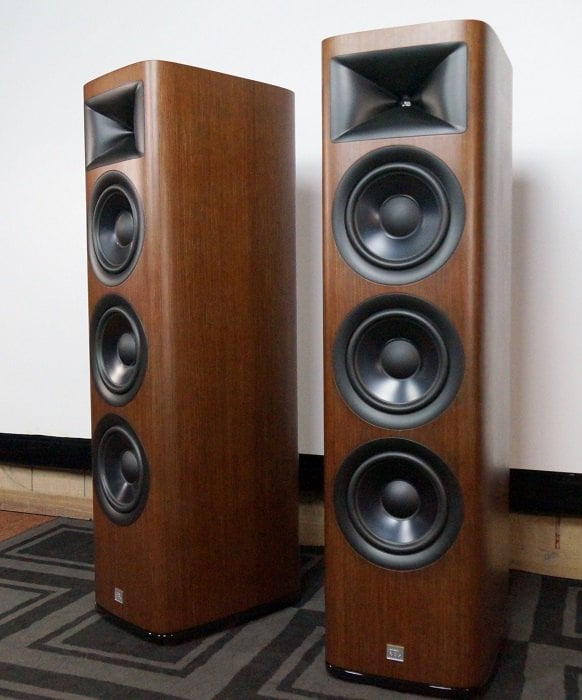

The JBL HDI-3800 are not small loudspeakers. They will have a visual presence in-room, and so the question becomes, how well do they fit in? One aspect that weighs heavily in their favor is the furniture-grade finish. The review sample sent to us came in satin-walnut that has been stained for a more reddish color. This is a real wood veneer so, in my opinion, it would fit in with other furniture, even if the furniture is higher-end. All of the vertical edges of the cabinet have been rounded to soften its shape and make it seem a bit more ‘furniture-esque.’ The three large black woofers and the horn are very prominent, so as loudspeakers go, it isn’t going to be mistaken for anything else, although the drivers can be hidden behind a magnetically-attached grille. The grilles do a good job of hiding the drivers and are a great solution for those who don’t like the utilitarian appearance of naked drivers. The grilles do make the speaker look a bit monolithic, but that may be particular to the 3800s given how large they are. The base has a gloss black trim that adds a slightly regal touch.

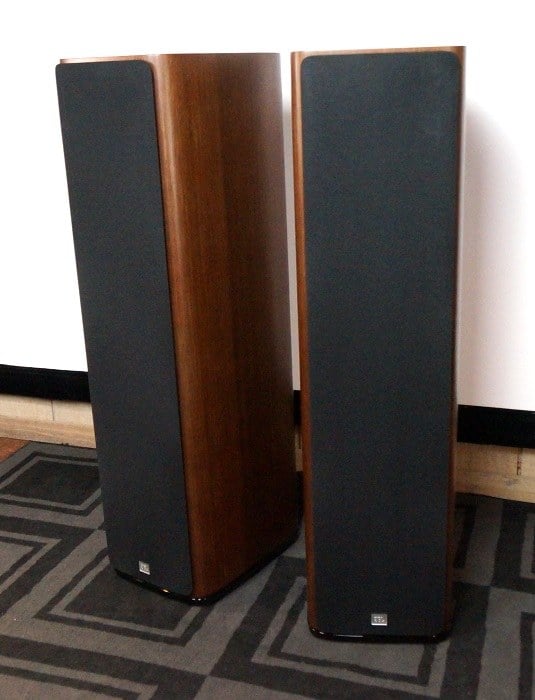

As drivers go, the ones used in the HDI series are pretty nice looking. They all have the same black color and soft reflectivity from trim ring to dustcap, so the appearance is simple and uniform, tweeter horn included. The relatively organic shape of the inner horn helps to keep things aesthetically gentler than if there were any sharp angles. The only hard edge that occurs in the HDI-3800 is the flat top. The speaker is so solid that if one wanted, they could use the top as a surface to place something like a figurine. (But please—no drink glasses! We don’t want any of those circular watermarks!)
The simple shape of the HDI-3800s means that a lot of the weight of their aesthetics rests on the finish. The good news is that they can be had in three different finishes that can accommodate different interior decors. The satin walnut is a good fit for traditional decors, but there is a high-gloss black that would make a better fit for modern interior design. There is also a grey oak wood veneer that would mate well with a room of a different color scheme than the reddish walnut could clash with. The overall design is rather conservative and not aesthetically loud, so the HDI-3800s shouldn’t be that attention-grabbing in a larger room. They aren’t really meant for small rooms anyway. I think the 3800s look nice and shouldn’t present a problem for anyone except those who just don’t like the visual presence of any speakers (such people deserve pity, not scorn).

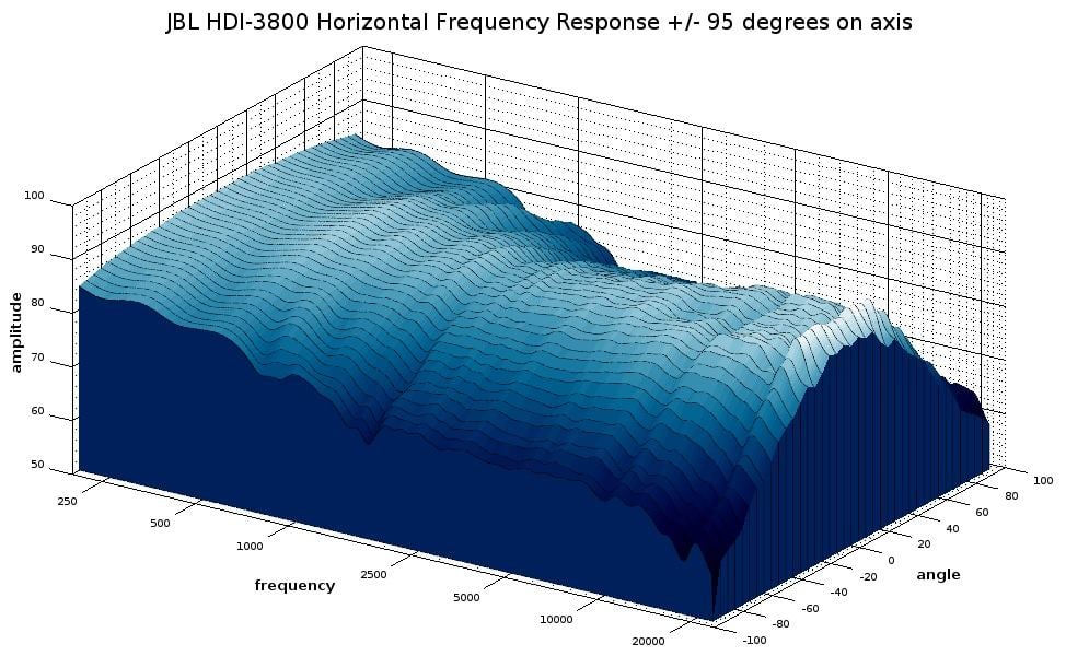

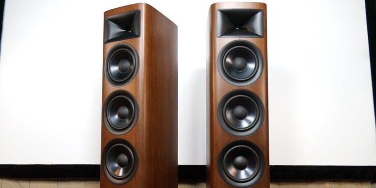

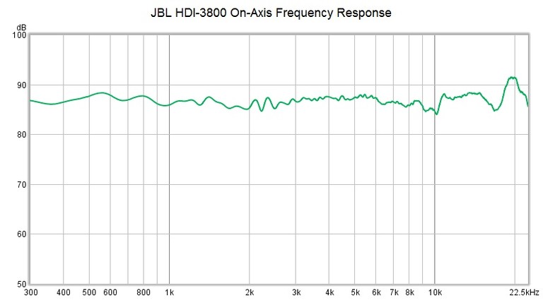

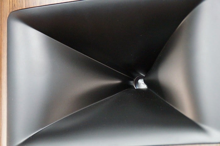

AHDI waveguide.jpgt a glance, the JBL HDI-3800s are large floor-standing speakers with three 8” woofers and a horn-loaded tweeter. That is a lot of muscle on display for a home audio speaker, but there is a lot more to the HDI-3800s than just muscle. These are very sophisticated loudspeakers that benefit from the latest advances coming out of the R&D at Harman International, JBL’s parent company. As anyone with even a slight familiarity with the loudspeaker industry knows, Harman is one of the leading companies in the realm of speaker design and technology, so a brand new high-end speaker that capitalizes on Harman’s research is bound to have some cutting-edge technology in it.

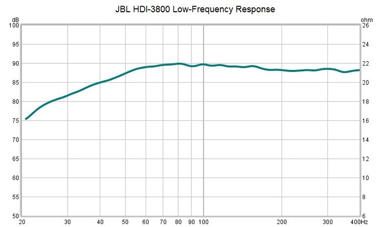

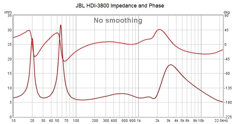

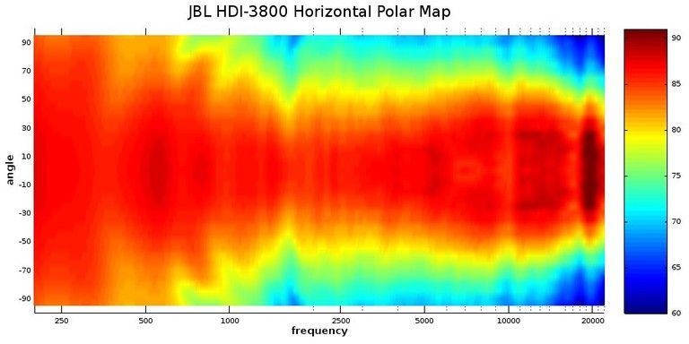

Let’s begin our discussion of the HDI-3800’s design by talking about the tweeter. The HDI-3800 tweeter is a 1” compression driver using a ring-shaped diaphragm made out of a polymer called ‘Teonex,’ which is lightweight yet strong and heat-resistant. JBL calls this patented tweeter the 2410H-2 and says that it is derived from the ‘D2’ series of compression drivers that can be found in the high-end of JBL’s commercial and home loudspeakers. This tweeter is loaded into a horn that JBL calls the High-Definition Imaging Waveguide that is based on a waveguide design which was first seen in the ground-breaking JBL M2 Monitor. This HDI waveguide, the namesake of this speaker line, is a very sophisticated design created with help from Finite Element Analysis that tries to control directivity over a very large swath of the frequency band as well as keeping diffraction to a minimum. This is not an easy feat, and the number of waveguide geometries that do this well is few, but this waveguide is one of them. It has been shown that the diffraction in suboptimal waveguides can end up sounding like a type of distortion that can add ‘harshness’ to sound and is likely one of the reasons that horn-loaded speakers have gained a reputation for being somewhat abrasive sounding.
The three 8” woofer cones aHDI gloss black.jpgre made from a material that JBL calls ‘Advanced Aluminum Matrix Cones’ which is really just a hard-anodized aluminum cone. The hard anodization process improves its damping by producing a thin coat of ceramic on the exterior of the cone. The motor section uses 1.5” coils in a ‘symmetric field motor’ design along with a ‘flux stabilization ring’ and a copper shorting ring. The ‘symmetric field motor’ is where the pole piece geometry has been optimized by finite element analysis for more linear travel in both directions of the cone’s movement. The shorting ring reduces induction in the motor, which makes for a flatter response over a wider bandwidth and also a reduction in odd-order harmonic distortion. Copper is a bit better than aluminum as a shorting ring material, although most driver motors use aluminum for cost reasons, so we can see that JBL is pulling out a lot of stops in order to create a high-performance speaker. I didn’t know what the ‘flux stabilization ring’ was, so I asked JBL about that. JBL explained that the flux stabilization ring is a shorting ring that stabilizes the magnetic field created by the motor magnet from modulations due to the opposition field generated from the voice coil’s movement. These higher-excursion woofers use a cast basket for a more stable structure than would be had with a stamped steel basket of less expensive designs. I wasn’t able to get a close look at the bare drivers since a trim ring covers the frame screws, and I wasn’t sure I could remove the trim ring without damaging it.
The HDI-3800s are ‘2.5-way’ designs. That means the three woofers all share the same low-frequency playback range, but only one of the woofers is also given midrange duty as well, and the only real crossover frequency occurs between that woofer/midrange and the tweeter. The lower two woofers play up to 800 Hz, but the uppermost woofer plays up to 1.8 kHz where it hands over playback to the tweeter. The high-pass filter to the tweeter uses a 3rd-order slope while the low-pass going from the wide-range woofer uses a fourth-order slope, and the two lower woofers are low-pass filtered by a 2nd-order slope. The advantage of this 2.5-way design is low-frequency headroom is increased with the additional woofer. Another advantage of a 2.5-way speaker is the gain in efficiency in low frequencies that can help compensate for baffle step loss. One potential disadvantage versus a full 3-way design is that the woofer given the larger bandwidth would technically have as much intermodulation distortion as a 2-way design as opposed to the lower quantities that a dedicated midrange driver would see, but that would only be a concern for poorly-engineered drivers that would be extremely unlikely in the case of these JBL drivers.

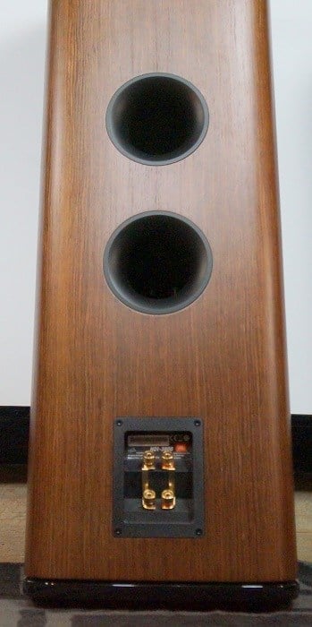

HDI rear2.jpgThe cabinet is heavy-duty with 1” thick MDF front and back panels and ¾” MDF side-panels. There is a network of windowpane braces lining the interior along with a generous amount of acoustic stuffing that looks like polyfill. An informal knock test indicates fairly inert sidewall panels. The feet are some rubbery wide-tipped cones, so these will not scratch hard floor surfaces. There are two 3” diameter rear-firing ports that have computer-optimized flaring. That is more port area than what most home audio subwoofers have, so the HDI-3800’s should be capable of some very powerful bass around port tuning. There are two sets of binding posts for those who want to bi-wire or bi-amp their speakers. The upper binding posts power the tweeter while the lower binding posts power the woofers. Normally I say that bi-amping home audio speakers is a waste of time, but the woofer section on these speakers is so beefy that an additional amp with some real muscle can help to drive these to their full potential in some cases. I am sure the woofer section of these speakers can handle a lot of power.
The JBL HDI-3800s are not inexpensive, but you do get a lot of speaker for the money. The parts quality and engineering are serious, and there isn’t any indication of corner-cutting in the design or construction. However, an analysis of the components and design are one thing, but how they actually sound is another thing entirely. Let’s now give them a listen to see if the sound is as good as the engineering suggests…
