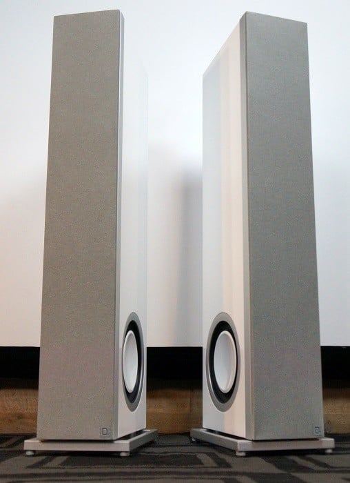

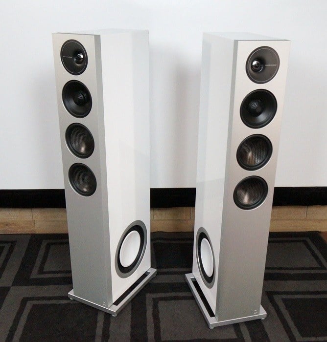

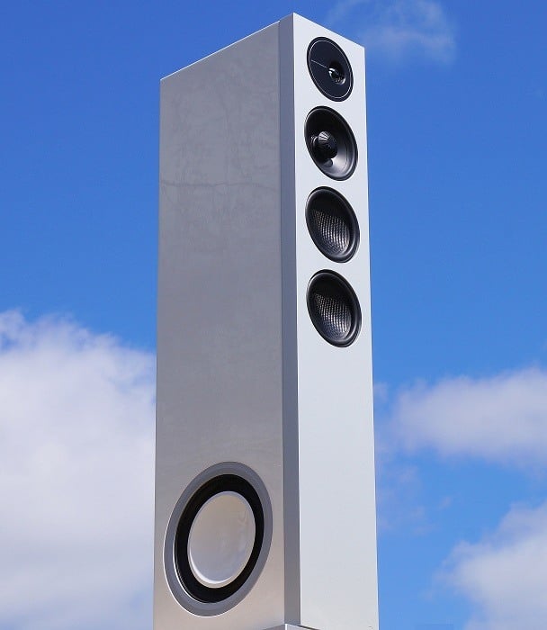

Let’s focus on the Demand D15 itself for a moment. At $3,400 a pair, they certainly are not cheap but nor are they extravagantly expensive either. It’s a simpler loudspeaker design than Definitive Technology’s other floor-standing speakers, and if this simplicity is an exchange of complexity for higher quality, that can be a welcome trade. This is not to say that the design is simple, and we will get into the various aspects of its construction in our ‘design analysis’ section, but it is a lot more of a traditional loudspeaker than the BP-9000s. There are a lot of traditional floor-standing loudspeakers in its price range, however, so what does the Demand D15 do to separate itself from the rest? Let’s find out…
Appearance

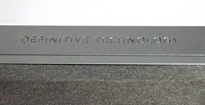

Upon arrival, the D15 speakers do need a slight amount of assembly by screwing in a metal plinth to the bottom and screwing feet into the plinth, but that is easy and takes less than 5 minutes. Following directions on the box, this should be done before unpacking the speakers. Unboxing the D15’s reveals them to be a strikingly modern design. The boxiness of the cabinet is not at all softened by corner rounding, and, in fact, the design embraces it with hard right angles at all corners. This is an effort to contrast the many circles of the drivers that are emphasized with black cones against the light aluminum front baffle. The all-aluminum front baffle provides a very attractive and high-end element to the appearance, and, to be honest, I am surprised to find something like that in a speaker at a price this low. While the industrial design here is striking, I don’t think it is ‘loud’ in that it will become the center of attention in most rooms. For those who want a tamer appearance, the grille hides the front baffle with a light-silver fabric and gives the speaker a much more minimalist look. The grille uses magnetic adhesion, so it has no grille guides to interrupt the smooth appearance of the front baffle. With the gloss white finish (a gloss black finish can also be had), the grille’d D15 is so minimal that it looks almost like a piece of abstract art. Normally, I think grilles make the speakers just look dull, but that is not the case here. Strangely, there are few images of the D15’s with the grille on posted to Definitive Technology’s product page.

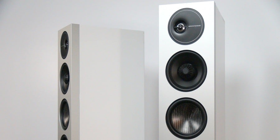

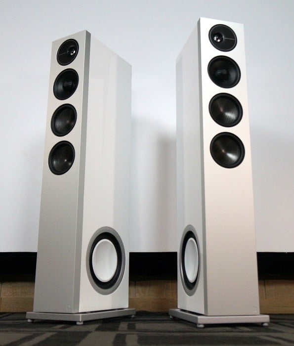

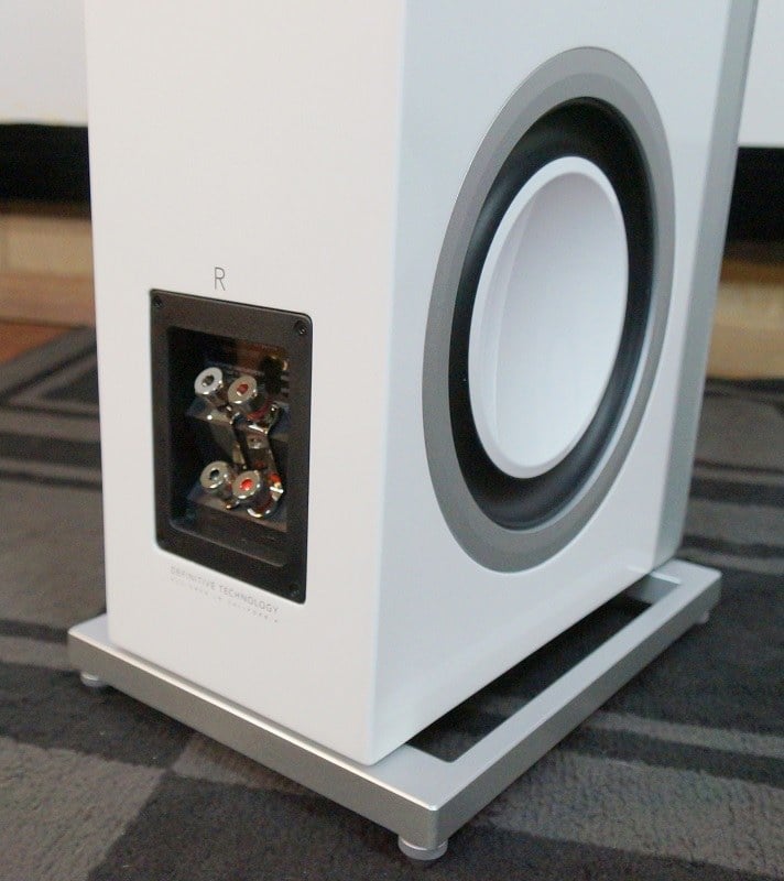

There are 8” passive radiators on both sides of the speaker that have a gloss white cone and are easily the nicest-looking passive radiators I have ever seen. The tweeter is an aluminum dome that is partly obscured by a phase lens and has a mirror-image offset in a large black faceplate. It almost resembles an eye that is looking off to the side. The midrange driver has a large phase plug that Definitive Technology has used in past designs. I have never cared for the way it looks in the past, but somehow it isn’t as visually obtrusive here. The bass drivers have a sleek-looking carbon fiber cone. Altogether, I think it's an interesting looking speaker with or without the grille. I am guessing that even people who normally object to the appearance of speakers will get along with these when the grille is in place. In the Gloss White finish, they would fit right in any brightly colored decor. All-in-all, the Demand D15 speakers look quite nice.

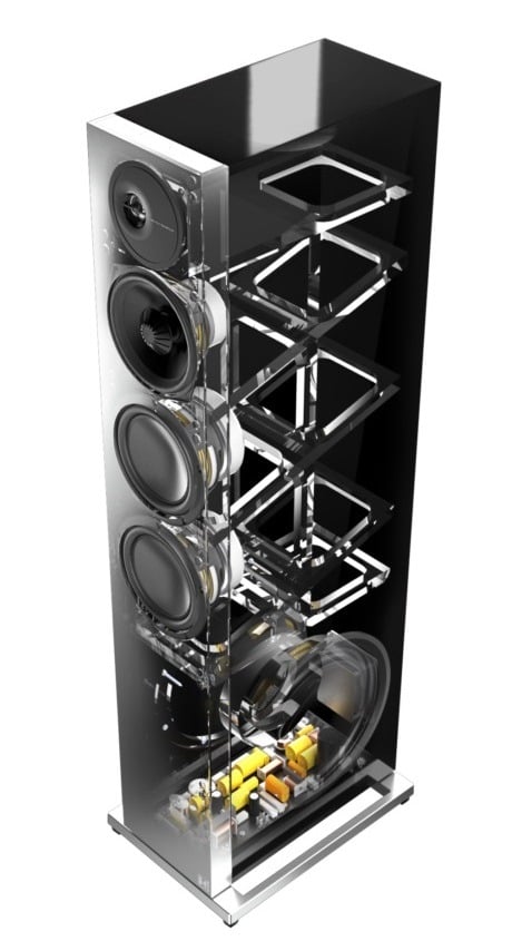

The Definitive Technology Demand D15 loudspeakers are a three-way floor-standing design that uses passive radiators to augment low frequencies. In such broad strokes, that isn’t a particularly unusual design, but there are a host of design innovations that do set the D15s apart from other tower speakers in its class.

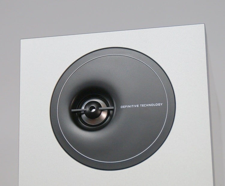

Let’s begin our discussion starting from the top and going down, so let’s talk about the tweeters. The D15 tweeters use a 1” aluminum dome mounted in a shallow waveguide. The aluminum of the tweeter dome is annealed, which means it has been softened by bringing the aluminum close to its melting point and then allowing it to cool slowly. This process dissolves the crystalline structure of the metal, and, in its recrystallization, it becomes softer. In its softer state, it has increased the damping which can tame break-up modes in higher frequencies. It should make for a smoother sound, especially with those people who are sensitive to higher treble frequencies. There is a plastic piece with partly covers the front of the tweeter that is a phase lens that Definitive technology calls the ‘20/20 Wave Alignment Lens.’ Its purpose is to block sound from the tip of the tweeter dome from interfering with sound emanating from the sides. It could also serve as protection for the fragile diaphragm of the tweeter dome.

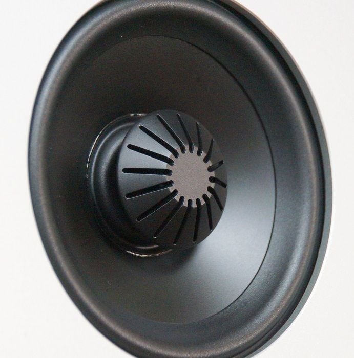

The midrange driver is a 5.25” polypropylene design that is quite unique to Definitive Technology that they call the ‘BDSS Woofer,’ which stands for ‘Balanced Double Surround System.’ It gets that name because the cone uses two surrounds: one surround on the outer edge of the cone and one in the inner edge that attaches it to the phase plug. Definitive Technology claims that this double surround system allows greater linear excursion. In theory, it should be possible that two surrounds could provide a more controlled excursion from the suspension components, although I can’t imagine that would provide a huge increase in excursion. This particular midrange phase plug is also something only seen in Definitive Technology loudspeakers, and they call it the ‘Linear Response Waveguide.’ It’s the largest phase plug I have seen, and that is probably why Definitive Technology calls it a waveguide, although it certainly does not function as a traditional waveguide. It looks to me like it just does what normal phase plugs do which is blocking wavefronts from the different areas of the cone from colliding and interfering with each other. It just does it a lot more than normal phase plugs.

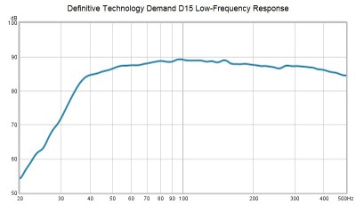

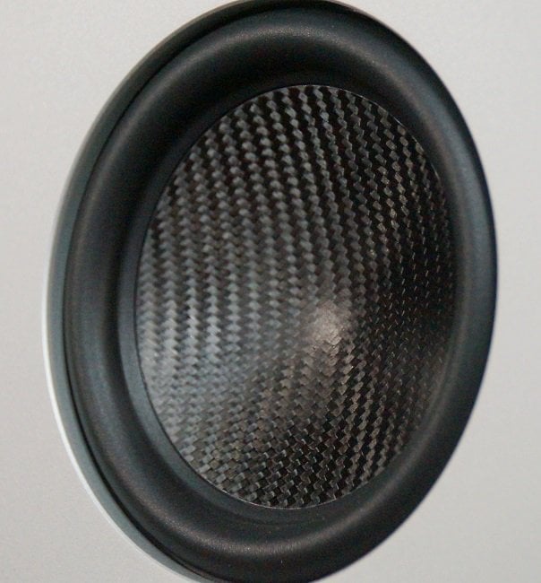

For the bass drivers, the D15 uses two 5.25” carbon-fiber cones. They look nice and have a beefy surround and so they should be quite capable in bass frequencies. They are also used to power the two 8” passive radiators on the sidD17_Render.jpge of the speaker. Definitive Technology claims a lower -3dB limit of 48 Hz for the D15, so these radiators should be very competent down to 50 Hz at least.  I wasn’t able to get a close look at the bare drivers since a trim ring covers the frame screws, and removing the trim ring can be a bit risky since it is glued on.
The crossover circuit is a pretty formidable piece that uses a multitude of higher-quality components such as metal-film capacitors and air-core inductors. There is a second-order acoustical crossover between the bass driver and midrange driver at 450 Hz and a third-order crossover between the midrange and tweeter at 2.5 kHz. The D15 has two sets of five-way nickel-plated binding posts for those who want to bi-wire or bi-amp the speakers. This is a feature that most upscale speakers are supposed to have but in reality, it is not very useful. The advantages of bi-wiring or bi-amping a speaker like this are negligible and not worth the potential for problems that can occur for those who attempt those types of connections.

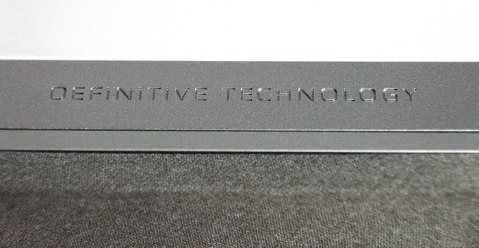

All of this technology is set in a very slick MDF cabinet with the aforementioned aluminum front baffle that is 6mm thick. The side panels and bracing are all 18mm with the bracing designed and positioned with FEA analysis for optimal stiffness of the cabinet. The midrange is enclosed within its own heavily-damped compartment in the cabinet so that back waves from the bass drivers do not affect the cone position. A good amount of polyfill stuffing is placed in the cabinet for internal damping. The speaker is set on a square aluminum bass with the choice of spiked feet or rubber feet. The cabinet feels solid and inert.

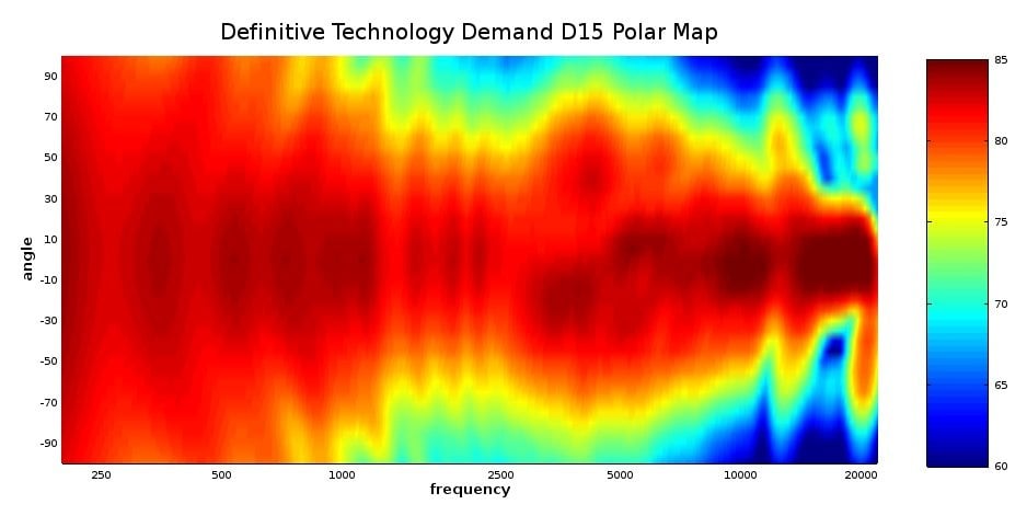

The Demand D15 speakers look like a well-designed and competent loudspeaker, but, as with any high-end loudspeaker, its objective is ultimately to sound good. Let’s finally give it a listen to see how it achieves that goal...
Listening Sessions
In my 24’ by 13’ (approximately) listening room, I set up the speakers with stand-off distances between the back wall and sidewall, and equal distance between speakers and listening position. The speakers were set up to face the listening position directly. Listening distance from the speakers was about 9 feet. Amplification and processing were handled by a Pioneer Elite SC-55. No room correction equalization was used. Subwoofers were used for some content that contained deep bass frequencies.
