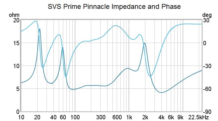

  • Not an 8-ohm speaker as advertised

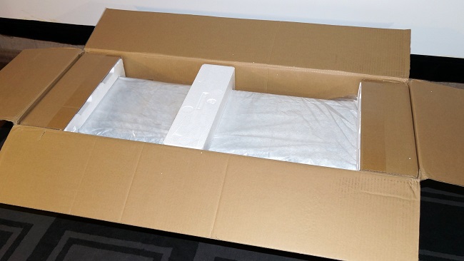

The Prime Pinnacle speakers arrived at my home in a sturdy box with styrofoam pieces protecting the top, bottom, and middle. In my experience, styrofoam isn’t a great packing material, but SVS has encased the end pieces in cardboard that can hold them together if they do break. That should help, but the use of polyethylene foam would offer better protection against harsh shipping. The speakers were wrapped in a soft cotton bag that protects it from scuffs and scratches, and an outer plastic bag that protects it from moisture.

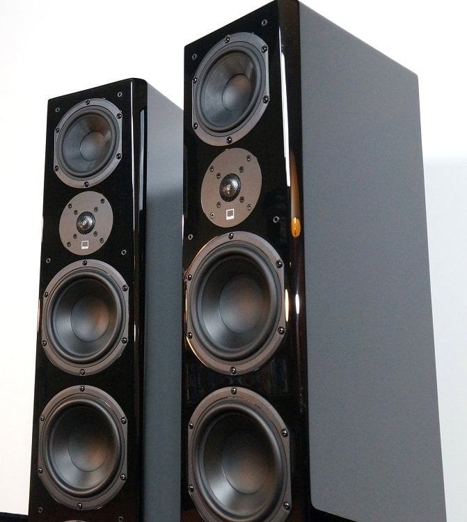

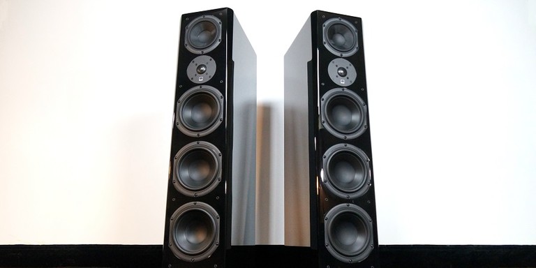

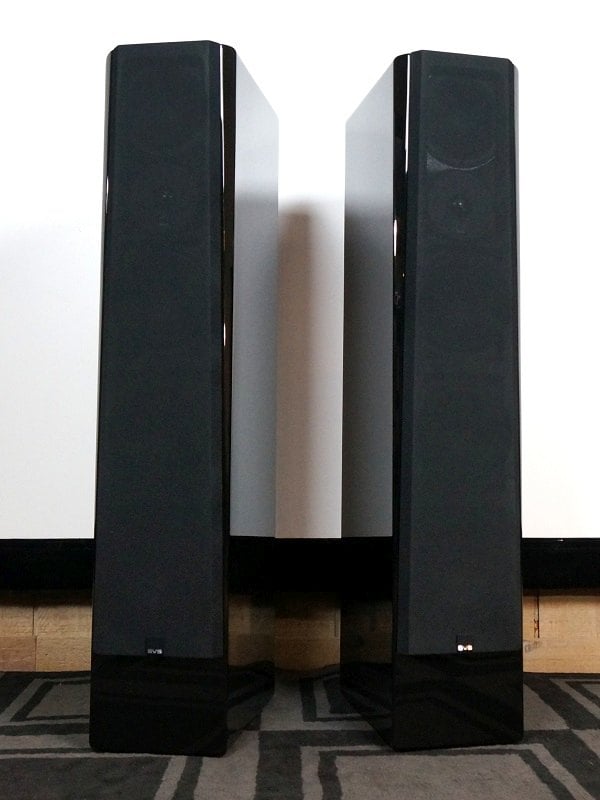

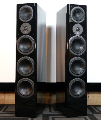

Once out of their packing, the Prime Pinnacle speakers are revealed to be attractive in an understated way. I received the Prime Pinnacles in the gloss black finish, which, in my opinion, looks much nicer and more high-end than the black ash finish. For a modest $200/pair upcharge for the gloss black, it is a no-brainer. The gloss black looks far more luxurious and is well worth the extra cost. The only reason I can think of not to get gloss black is if the speaker is going to be placed near a projection screen where the light reflections from the shiny finish can degrade image quality.
With the grilles on, the Prime Pinnacles have an austere handsomeness that looks quite formal. The grilles hide their features and give them a stoic, almost solemn appearance. Their appearance with grille reminds me of a cenotaph or obelisk in that, aside from the small ‘SVS’ badge at the bottom of the grille, they bear a monolithic quality. I much prefer them without the grilles. With all of their drivers exposed, they look more like a sound system that is ready for action. The midrange, tweeter, and three woofers are practically begging to make some noise. The inverted dustcaps, smooth polypropylene woofer cones, and silky glass-fiber midrange cone nicely compliment the clean, lustrous cabinetry. There is a slight beveling that increases with the height of the cabinet that adds a distinctive stylish touch. These speakers look nice without being flashy or showy. It is a restrained sense of style that seems like something BMW might make if they made speakers.

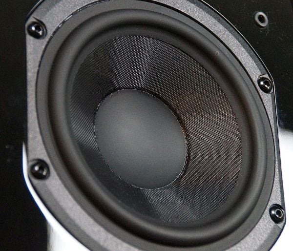

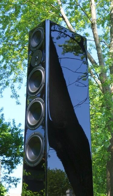

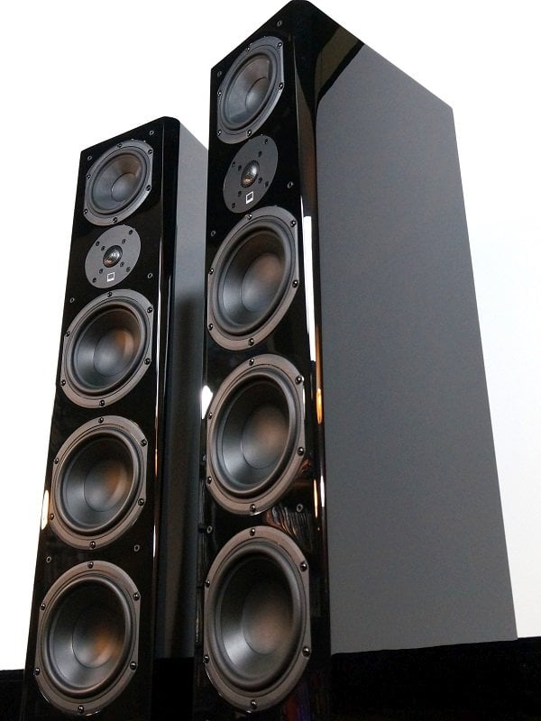

The Prime Pinnacle speakers are a fairly heavy-duty three-way floor-standing speaker. At first glance, the Prime Pinnacle speakers look like a beefier larger version of the Prime Towers, but there is a lot more to them than that. Sure, they are significantly more powerful than the Prime Towers, but the differences are as much qualitative as they are quantitative. To start with, Prime Pinnacles use a different midrange cone than the Prime Towers. The Prime Pinnacle midrange cone is made from glass fiber much like the midrange cones found in the higher-end SVS Ultra towers, whereas the Prime Towers use a polypropylene midrange cone. Glass-fiber is a lighter, stiffer material that enables the midrange to behave better over a wider range of frequencies. Its larger cone diameter should allow it a wider dynamic range as well.

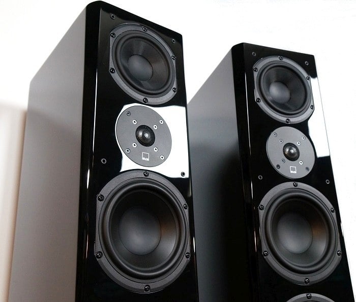

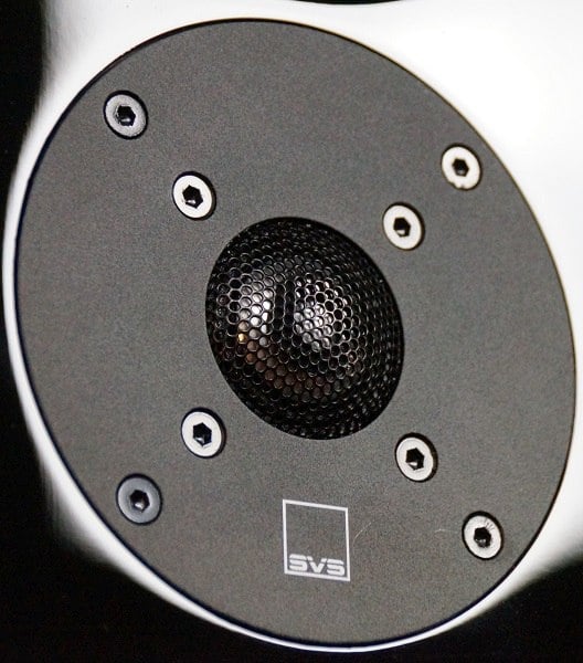

The tweeter uses a 1” aluminum dome and a chunky iron ferrite magnet instead of the usual neodymium magnets for the motor. It has a metal lattice over the dome to protect it from being poked or pushed in. SVS has intelligently placed the tweeter above the bass drivers but below the midrange so that it is set at a height closer to the ear level of typical listening positions. I have had many three-way floor-standing speakers come around lately that have placed the tweeter at the top of the driver stack which elevates it relatively high compared to the normal ear-level listening height, so SVS’s choice of tweeter placement is welcome here. The tweeter and bass drivers are the same as used in the rest of the Prime series. The bass drivers use a polypropylene cone and a cast-ABS fiberglass basket with a hefty ¾” thick x 4” diameter magnet. The midrange also uses a cast-ABS fiberglass basket and a good-sized magnet. The midrange and bass drivers use shorting rings which should extend their frequency ranges while lowering 2nd-order harmonic distortion.

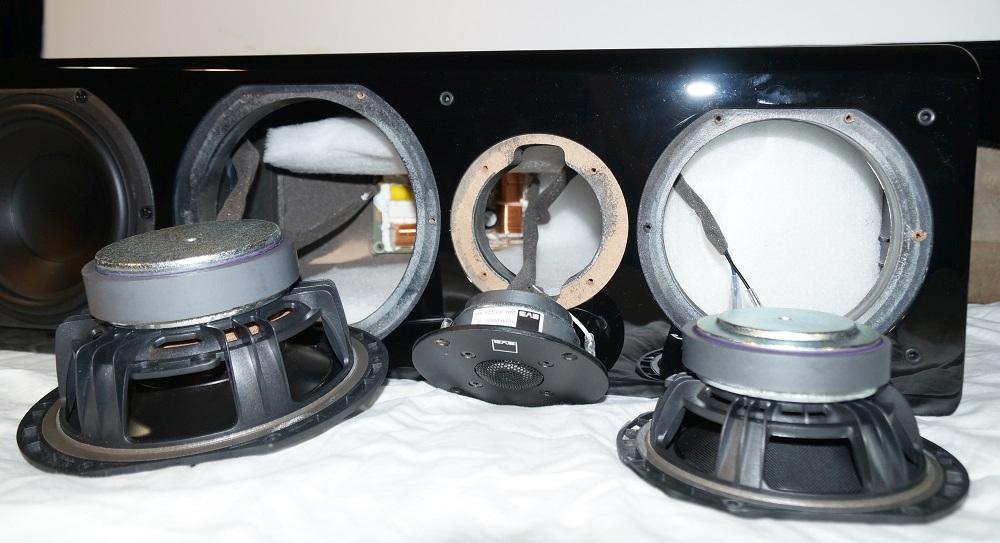

What has to be the most distinctipinnacle port diagram re.jpgve design trait about the Prime Pinnacle is the way it places the bass drivers into their own individual compartments. Many higher-end speakers isolate the driver classes into their own separate compartment so that the backwave pressure created by the rear side of the cone does not impact the cones of other drivers. The Prime Pinnacle does this too, by placing the midrange driver into its own sealed compartment. But what the Prime Pinnacle does that is unique is giving each bass driver its own ported compartment. Furthermore, each compartment has a different port tuning frequency. That means that there are three different ports with their own enclosure space, and each of them is being loaded slightly differently. That kind of layout allows a great deal of freedom for the designer to shape the bass response to any kind of curve that they could want.
In addition to the advantages in low-frequency performance, the compartmentalization of the bass drivers and midrange driver also serves as a very rigid bracing system. The cabinet construction of the Prime Pinnacle as a whole is very good. Construction is MDF with an inch thick front baffle and ¾” thick side-walls and internal walls. Much of the interior surfaces are covered with an acoustic stuffing. The chamfered edges of the front baffle should help reduce diffraction as well as adding a touch of style. The grille frames are on the thick side, so these speakers are likely to perform best without the grilles. The feet are some rubbery cone-shaped things that look as if they are intended to damp cabinet vibrations from being transmitted to the floor. Outriggers or a plinth might have offered more stability, but the Prime Pinnacle seems to have a good footing, and its hidden feet is more in keeping with its austere styling. Speaker wire is connected to five-way binding posts within a terminal cup, and there is no option for bi-amping or bi-wiring, which is a good thing in my opinion.

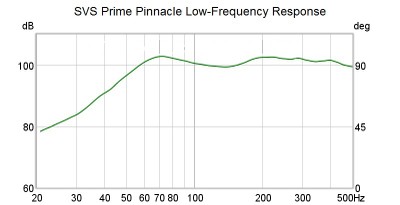

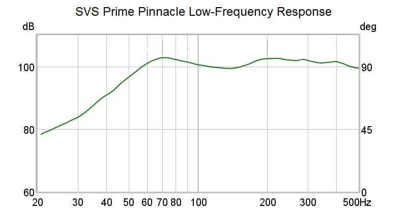

The crossover circuit rests on two different printed circuit boards, with the low-pasPrime Pinnacle pair7.jpgs filter for the bass drivers assembled on a board that is mounted in the middle bass driver chamber, and the filters for the midrange and tweeter on a board mounted in the upper chamber. The Prime Pinnacle crossover circuit is pretty serious with a very stout capacitor and two large iron-core inductors on the lower board, and a gob of similarly beefy capacitors, resistors, and inductors in the upper board. They add up to a 12dB/octave slopes on both the bass driver to midrange crossover and midrange to tweeter crossover at 300 Hz and 2.1 kHz respectively.
So what do all of these components and design decisions give you? With three 6.5” bass drivers each with their own tuned compartment, one attribute that I would expect the Prime Pinnacle to have is a highly-controlled and very powerful bass response. A 5.25” glass-fiber midrange driver should also give it a fair amount of dynamic range in this vitally-important range. I think this design has potential if it is executed well, so let’s see how it fares in listening tests and measurement tests...
