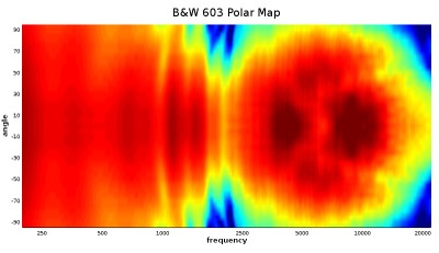

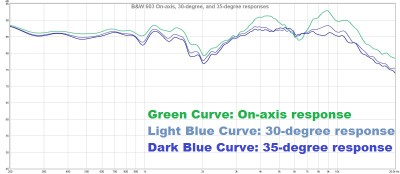

  • On-axis treble is very hot
  • Best listening is done at a relatively particular angle

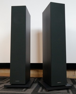

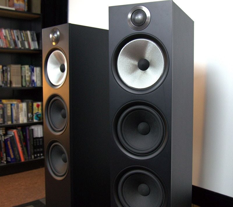

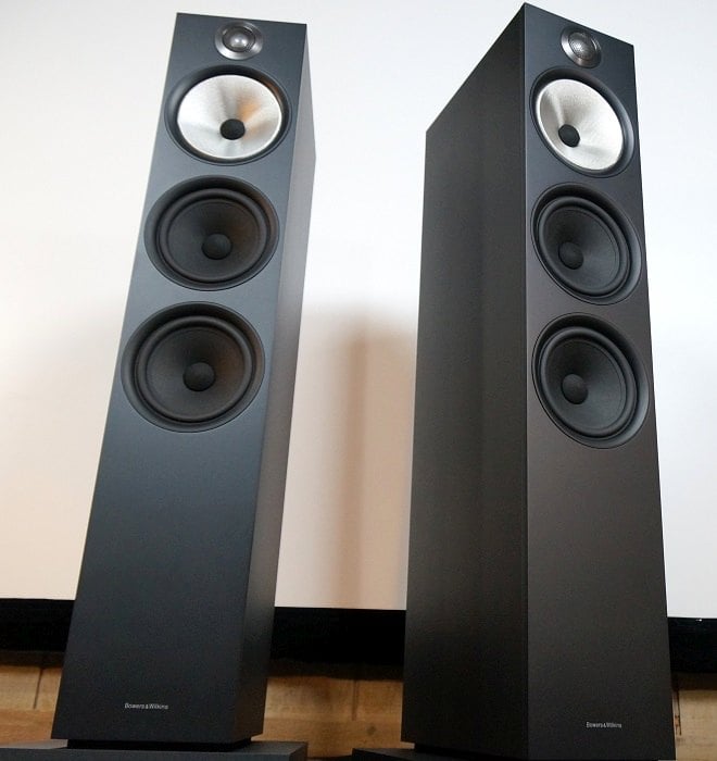

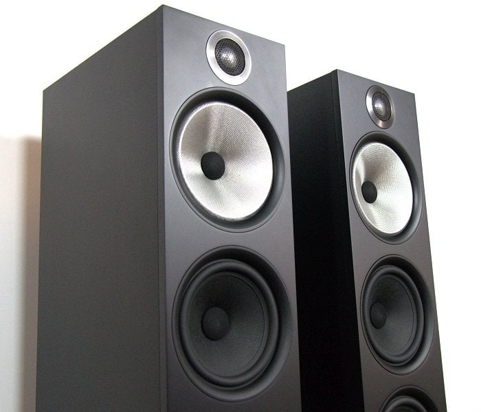

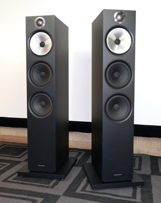

The 603s arrived well-packed for their transit, and they were easy to unpack and assemble. Assembly consisted of attaching the base plinth to the cabinet and some feet to the plinth which only took a few minutes to complete. The 603s come in a matte black or white finish, and I received the black finish. They have a very clean and simple modern look. One aspect that helps in this respect is the magnetically-attaching grilles that do away with the need for grille guides on the front baffle. They do nothing to eschew a boxy look, in fact, they emphasize the fact. There are no curves save for the circular shape of the drivers. The 603s are clean oblong boxes, and the only detailed features on them lay in the driver cones and tweeter cover. With the grille on, the drivers are hidden, and the speakers turn into nearly abstract geometric shapes. The simplicity is the point here, and these aren’t going to stand out much in a wide range of room decors. They are designed not to clash with interior styling, and they will not draw much attention to themselves.
603 pair10   603 pair grilles3
B&W 603 Grilles Off (left pic); Grilles On (right pic)

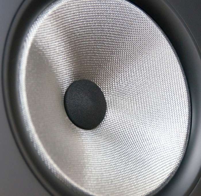

The standout visual feature is the silver midrange driver which uses a shiny woven cone that B&W calls the Continuum cone. The tweeter also has a metallic texture, and it is placed behind a protective metal mesh. The bass drivers use matte black cones that do not visually distinguish themselves from the rest of the speaker. The cabinet rests on a plinth base that does lend it a classy touch, however, the boxy nature of the plinth gives it some pretty hard corners that would be painful to stub a toe on; do not place these speakers in high foot-traveled areas! Overall, the 603s are nice looking in a ‘smart’ and tasteful way, but not in a graceful and dazzling way. They are more like a well-groomed gentleman in a nice suit rather than a curvaceous woman in a flowing dress, and their aesthetic is more formal and business-like rather than genial or delicate.

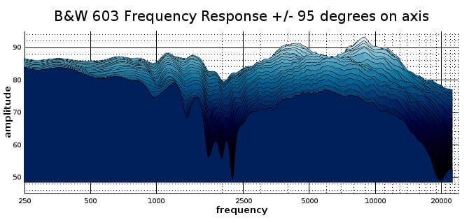

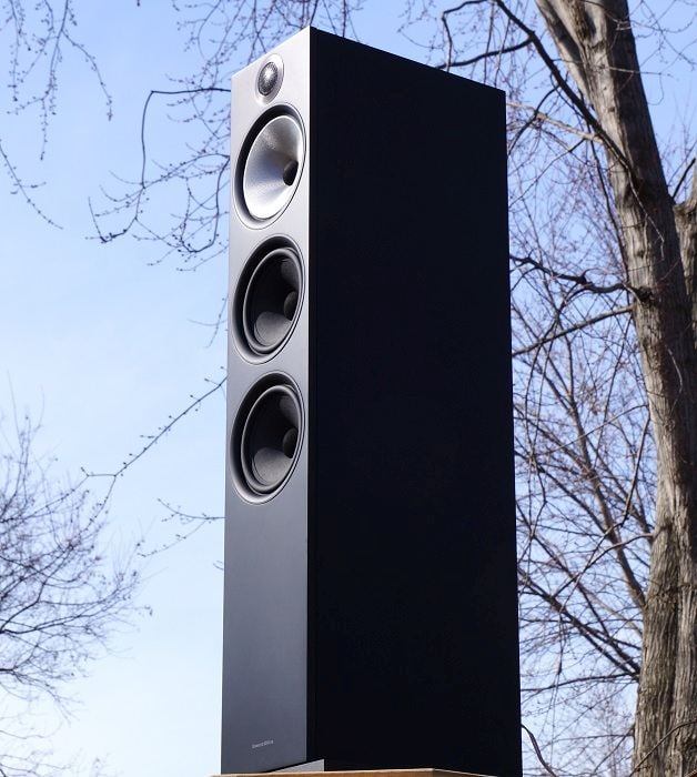

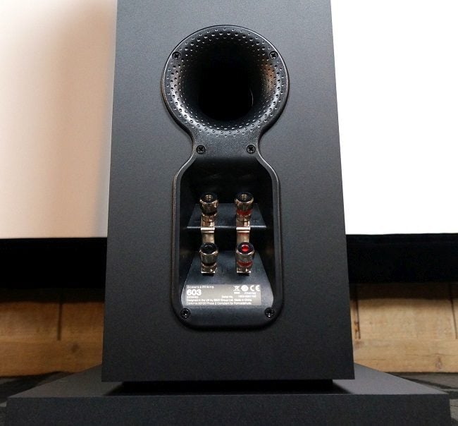

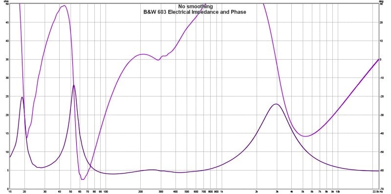

603 tweeter closeThe B&W 603 is a three-way floor-standing speaker that uses a 1” dome tweeter, a 6” midrange driver, and two 6.5” bass drivers. It is rear-ported and claims a low-end -6dB point of 29 Hz. On paper, that makes it a fairly capably if not an unusual design for a tower speaker, so what is it doing to set itself apart from the crowd? Let’s go over the components that make up the 603, starting at the top and going down.

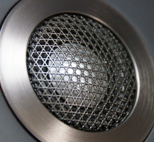

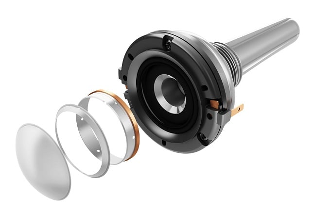

The 603 uses what B&W call a ‘Decoupled Double Dome tweeter’ that pushes break-up effects well outside of audible frequency ranges. ‘Break-up’ in loudspeaker driver terms is when the cone or diaphragm of the transducer oscillates so fast that it bends and fails to maintain its shape. This can cause a very ragged frequency response which leads to a whole host of audible problems. All drivers will hit break-up at some point as the frequency goes up, so the thing to do is push break-up behavior as far up in frequency as possible so that it is easy to filter out. In the case of the ‘Decoupled Double Dome’ tweeter, the upper limits of human hearing act as the filter.
600_Series_tweeter_v3_zoom_high_rez
The mechanism of the way it accomplishes pushing break-up to such high frequencies, according to Eric McBride, an acoustical engineer at B&W is this:
"The decoupled double dome uses a two-part construction, allowing for first break-up performance of 38kHz. The primary dome is a 30-micron aluminum dome: light, sensitive, easily driven. We then stiffen its periphery using a second, stiffer dome (50-micron) that has its center portion cut away, leaving just the outer ring portion intact. This second bracing ‘ring’ is bonded to the rear face of the 30-micron dome, creating a diaphragm that has an outstanding combination of lightness and stiffness."
The tweeter is tucked in near the top edge of the speaker which should help alleviate baffle diffraction.
Moving on to the midrange driver, the 603 uses B&W’s proprietary ‘Continuum’ cone material which replaced the Kevlar midrange cones that they had used for so long. Like Kevlar, the Continuum is a coated woven material, but Continuum is something that B&W developed in-house, so they have full control over its production. B&W first used Continuum in their 80X D3 series, and now it this technology has finally trickled down to their entry-level models. B&W claims that the 603 midrange closeContinuum material makes break-up artifacts less severe so that should make the speaker smoother at higher frequencies.
The 603 also uses B&W’s ‘Fixed Suspension Transducer’ (FST) technology in the midrange, which B&W claims reduce the problems of conventional surrounds where the surround material is less controlled and can interfere with the linear motion of the woofer. FST is more controlled because it is smaller and therefore has less room to undulate. Undulations in the surround can have resonances that can fight against the direction of travel of the cone itself. FST also uses surrounds that have mechanical properties that are similar to the edges of the cone itself so that, according to B&W’s literature, “bending wave energy traveling up the cone passes through to the surround. And if those properties are resistive or lossy, the energy can be converted harmlessly into heat. The result is that far less energy is reflected back into the cone than with a similar driver with a normal surround.” As for the bass drivers, the two 6.5” woofers use paper cones, but I don’t see anything particularly unusual about them.

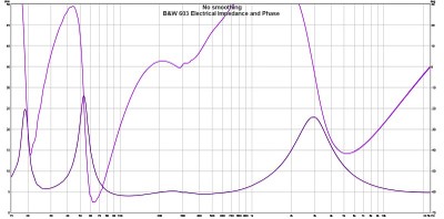

The crossover circuit uses a 3rd order low-pass filter on the bass drivers at 350 Hz, and a 2nd order low-pass filter on the midrange driver at 4 kHz. That is an extraordinarily high frequency to cross a 6” cone over to a 1” dome tweeter. While the Continuum cone might not have substantial break-up artifacts at higher frequencies which could mangle the response, there is still the question of directivity matching of a cone of that size at such a high frequency. On the plus side, it allows603 rear the tweeter to use a gentle 1rst-order high-pass filter that it might not be able to were the crossover set at a lower frequency. Polyester film capacitors are used for high-frequencies, and a new electrolytic capacitor is used for low frequencies. The 603 is bi-ampable with a nickel jumper between the input terminals.
The 603 cabinet is a relatively solid build that brings the speakers up to 53 lbs. each, which is a bit hefty considering these aren’t large towers. The front baffle is 1” thick MDF and the side panels and interior bracing is ¾” thick MDF. Taking a peek inside the cabinet, I can see a network of vertical and horizontal window braces and a generous amount of stuffing. A quick knock test elicits a dull thud which indicates a dense and inert enclosure. The port is 6” long and 2” wide and is significantly flared at both ends. The port is covered in small dimples which supposedly generate tiny eddy currents as air flows over it, and this is intended to help the air flow through the port smoothly and more quietly. The principle is the same used in the dimples found in golf ball construction in that the tiny eddy currents helps to stabilize wind flow. As was mentioned before, the cabinet is mounted on a plinth that gives the speaker a stylish touch and also helps to give it a sturdy platform, so these speakers are not easy to knock over. 603 port plugs

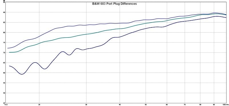

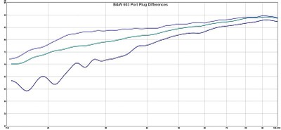

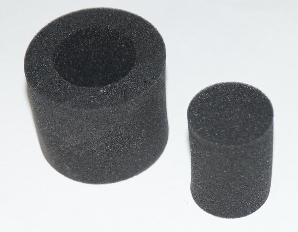

The 603s come with an unusual port plug for those who want to reduce the low-frequency response of the speaker. This can come in handy if the user is forced to place the speaker’s rear end near the wall, because this type of placement can load the port and dramatically increase bass output (although not extension). The core of the port plug can be removed which will add extra damping on the port response instead of merely sealing the port which totally eliminates all port output. The ‘additional damping’ port plug configuration will reduce bass but not to the extent that totally sealing the port would. The disadvantage of using the plug with its core open is that will significantly increase chances of port turbulence (“chuffing”) at drive levels much lower than if the port was open. However, in my experience, I find that port turbulence is difficult to hear if the port is not facing the listener. 603 pair close7

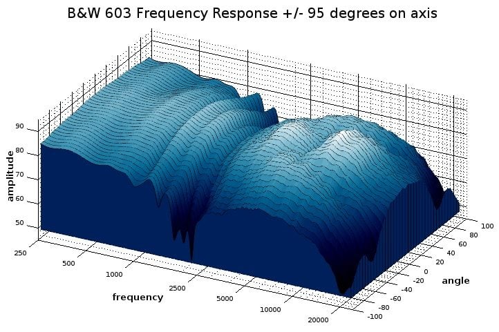

So what does the design add up to? The key to the design of the 603 is the midrange driver. There are some advantages to its approach but also a disadvantage. The midrange driver is used over nearly three and a half octaves. The advantage to that is that there should be no crossover irregularities in that range, and that is especially beneficial because most music and voice content lives in this range. B&W is trying to keep this all-important frequency range sequestered to one driver, so the sound should be very unified and free of any phase or time-domain problems. The Continuum cone must really be high-performing for B&W to have such confidence in it to use such a large diameter cone up to 4 kHz. Another advantage to using such a large diameter cone to such high frequencies is that it will have a lot of displacement ability for the higher frequencies of its range, and that will be beneficial for the dynamic range. The disadvantage, as mentioned before, is that a 6” cone will start to constrict its dispersion around 3 kHz. The tweeter may make up for that by having a 1rst order slope, so it may start to come in wide where the midrange begins to beam. We will examine the speaker’s acoustic behavior more in the measurement section, but for now, let’s hear what it sounds like.

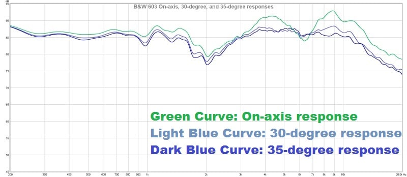

In my 24’ by 13’ (approximately) listening room, I set up the speakers with stand-off distances between the back wall and sidewall, and equal distance between speakers and listening position. I used various toe-in angles during listening and settled with the speakers facing forward in a parallel direction since having the speakers directly face the listening position seemed to take the edge off of an elevated treble level. Listening distance from the speakers was about 9 feet. Amplification and processing were handled by a Pioneer Elite SC-55. No room correction equalization was used. For movies, subwoofers were used to supplement the bass with an 80 Hz crossover frequency.
Music Listening
As always, I like to begin listening with content thaBlue Birdt emphasizes the human voice, because that is the most important instrument that a sound system should reproduce correctly. Toward this end, I selected the 1994 album ‘Blue Bird’ by legendary blues artist Jimmy Rogers. Mr. Rogers was one of the instrumental figures in creating the ‘Chicago Blues’ style, and this award-winning album was one of the last recorded by Mr. Rogers before his passing. It mostly consists of original compositions by Jimmy that includes well-known pieces and also hitherto unperformed pieces. While Jimmy’s vocals take center stage, he is backed with a very talented ensemble playing bass, piano, harmonica, and drums. The first thing that struck me about the 603’s reproduction of ‘Blue Bird’ was their precise soundstage. Imaging was very well-defined with Roger’s voice occupying a very clear center position, and accompanying instruments surrounding him in various locations depending on the track. The spatial illusion created by the 603s was quite vivid and almost tangible from my listening position. Jimmy’s slightly raspy voice was rendered with detail and crispness as was the instruments.
One thing that I noticed while listening to ‘Blue Bird’ was that the bass wasn’t quite as present as I was used to in other tower speakers of a similar class. One of the reasons may have been I was coming fresh off of reviewing the Klipsch RP-8000F which had unusually elevated bass for a tower speaker. Manufacturers of these ostensi603 pair15bly full-range speakers have to decide how to shape the bass response. If they make the bass response absolutely flat down to port-tuning, that risks bloating the bass in medium-sized or smaller rooms, so few manufacturers use that kind of response. Most of them taper off the bass at various slopes that they think will combine with the room acoustics to provide a full but not overwhelming bass sound for end use, and even the Klipsch RP-8000Fs do this, although not very aggressively. It was immediately apparent that B&W had a steeper slope of this nature since I could clearly hear deep bass, but it is not very potent. I had the speakers pulled out pretty far in the room, so to bring some more presence to the bass, I pushed them back much closer to the walls. This placement allowed the boundaries to reinforce the low frequencies, and that really did the trick in bringing out the bass. The album sounded full and tonally balanced after repositioning the speakers.
There is an advantage and disadvantage to this kind of bass response, and it is a trade-off that all loudspeaker manufacturers have to decide upon. The advantage to having a more aggressive low-frequency roll-off is that the end user can decide how much bass they want their speakers to produce by simply positioning them accordingly. If the user prefers bass with a lighter touch, simply place the speakers away from walls or use the provided port plugs. For heavier bass, place them close to walls. For speakers like the Klipsch RP-8000Fs, this is not an option, at least in a medium or small room; they are expected to be used in conditions that do not boost the bass by a lot. The disadvantage to B&W’s approach is that if the user wants strong bass, they must place the speakers near a surface, but sometimes that placement can have acoustically adverse effects in other respects. One odd choice is the inclusion of port plugs with what is already a somewhat curtailed bass response. Personally, I would have preferred a more intrinsically powerful deep bass response that port plugs could have tamed per the user’s tastes; this would have given the user more freedom to place the speaker where ever they want while still maintaining a potent bass sound. Of course, this is all a moot point when subwoofers are used.
