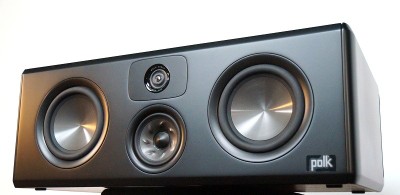

  • Type: 3-way vented center channel speaker
  • Tweeter:  1" (2.54 cm) d (Round) Pinnacle Ring Radiator
  • Midrange: 4" (10.16 cm) d (Round) Turbine Cone
  • Woofer: (2)  6.25" (15.88 cm) d (Round)
  • Frequency Response: 42 Hz → 50,000 Hz
  • Nominal Impedance Range: 3.4 ohms → 4 ohms
  • Sensitivity (1 watt @ 1 meter): 87.5 dB
  • Lower and Upper -3dB Limits: 55 Hz → 38,000 Hz
  • Peak Power Handling: 300 watts
  • Tweeter/Midrange Crossover Frequency: 2700 Hz
  • Midrange/Woofer Crossover Frequency: 260 Hz
  • Weight: 40.8 lbs (18.51 kg)
  • Dimensions (HxWxD): 9.47" (24.05 cm) x 26" (66.04 cm) x 13.44" (34.14 cm)
  • Available finishes: Black Ash or Brown Walnut
  • Warranty: 5 years (non-transferable) with 5-year extension upon product registration

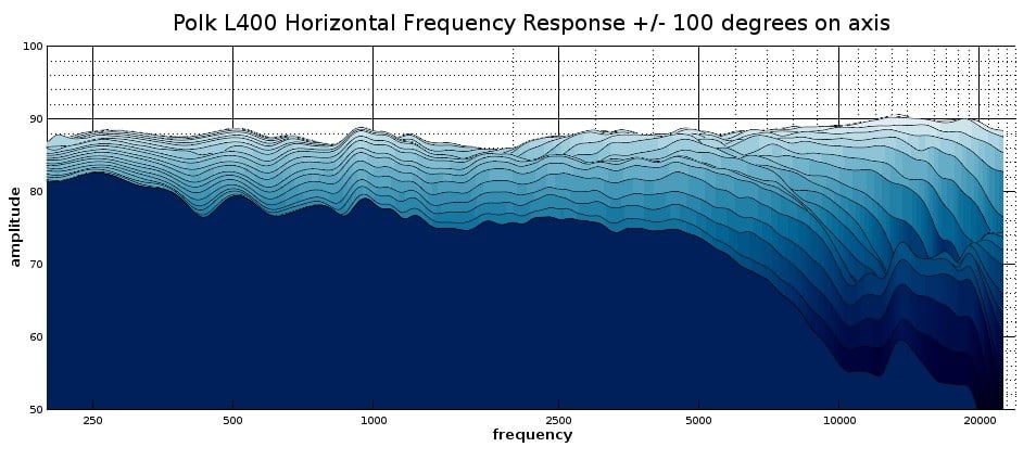

  • Best dispersion performance from any center speaker reviewed so far

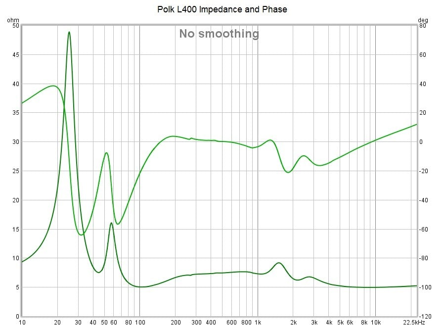

  • 4 ohm impedance can be difficult load for some receiver amplifiers

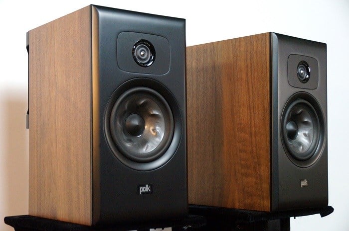

Polk Audio wol200 pair.jpgwed the audio world with their massive Legend L800 tower speakers, but those towering speakers have overshadowed the fact that Polk released other speakers in the Legend series also, although those other speakers did not boast Polk’s SDA technology. While the L800’s SDA technology was indeed impressive, we found the L800s to be a good loudspeaker in a multitude of other ways as well, so it stood to reason that the other speakers in the Legend series should have the same high level of engineering. We decided to put that theory to test, so in for review today we have the Polk Audio Legend L200 bookshelf speakers and L400 center channel speaker.

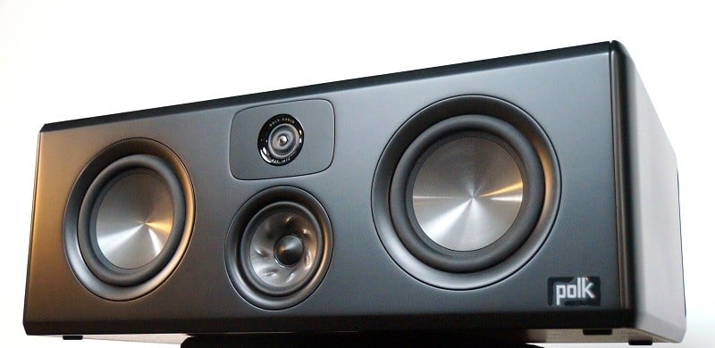

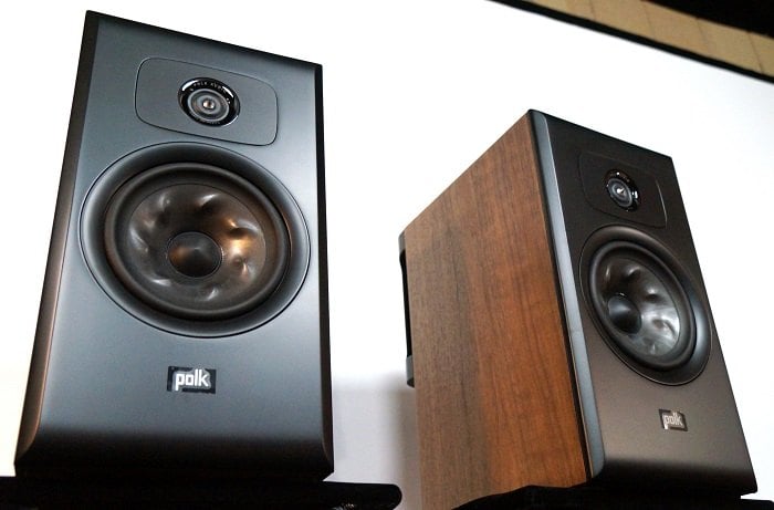

Far from being mere accessories to the L800, the L200 and L400 are quite formidable in their own right, as they should given their pricing. The design, style, and construction of these speakers suggest something that is capable of high fidelity sound. Let’s dive in to explore these speakers and then listen to them and measure them to see if they keep the promises they make as a part of Polk’s flagship series…
Appearance

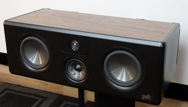

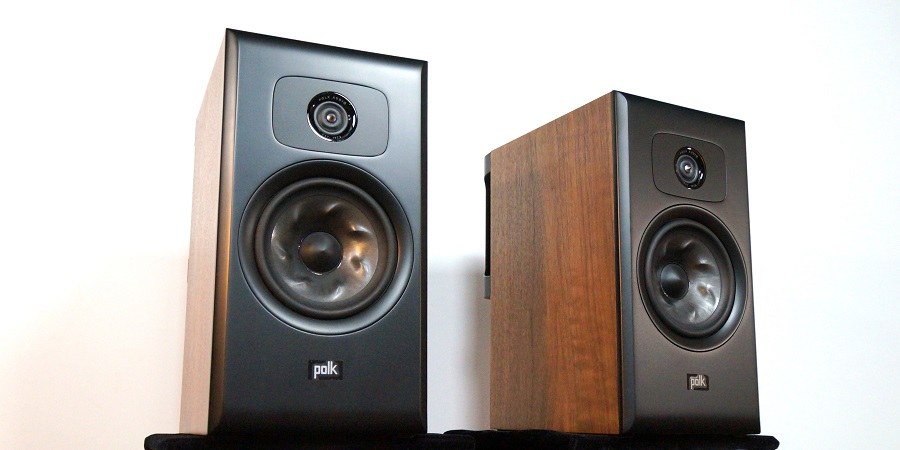

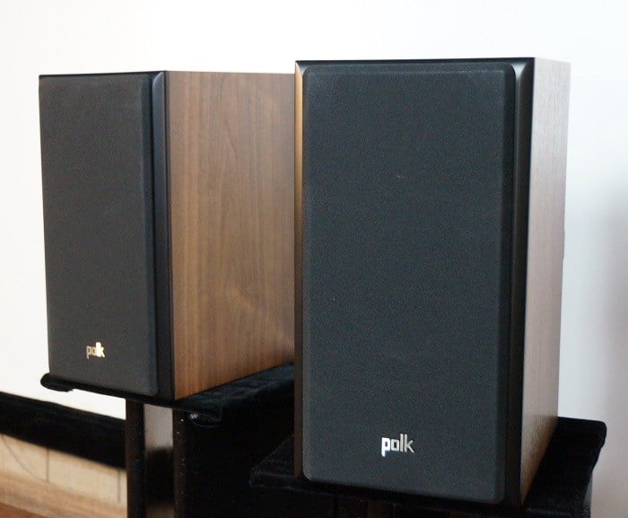

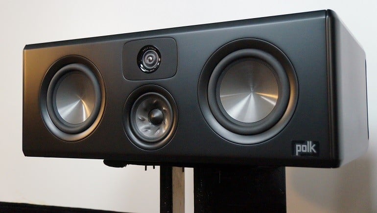

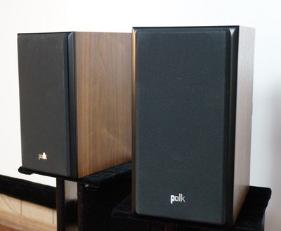

The Polk L200 and L400 speakers came well-packed, and upon unboxing, revealed some very nice and conservatively-styled speakers. The Legend speakers play it pretty safe as far as aesthetics go. They have a satin black front baffle with some softly-chamfered edges. The rest of the enclosure can be had in either a Black Ash or Brown Walnut finish, but the Black Ash finish comes with a gloss black front baffle instead of satin black.These are readily discernible as real wood finishes and do lend an element of higher-end panache to these speakers. The grilles are normal black-fabric wrapped frames with a continuous chamfer angle to go with the front baffle. There is a Polk badge in the lower part of the front of the speaker with or without the grille. The grille uses magnetic adhesion so there are no grille guides on the front baffle. The drivers themselves are the only element that lends anything unusual about the appearance of these speakers. The woofer cone has some angled dimples that Polk calls a ‘Turbine Cone’ that resembles a kind of vortex. It does look slightly abnormal but kind of cool nonetheless. The ring radiator tweeter has a sharp point in the center that looks a bit more distinct than the typical dome tweeter, but again, it looks a bit more interesting for that matter.
Overall, this is a very nice execution of a traditional loudspeaker aesthetic. It should fit in very well with a wide range of interior decors. Both the L200 and L400 are very tastefully designed, and they are not likely to draw attention to themselves. The only caveat is that the L400 is a bit larger than most center speakers. That larger size is necessary for the kind of performance it offers, however. It would be difficult to execute a three-way center in a smaller enclosure, and that three-way design is needed for the caliber of performance that it is targeting. But if you can make it fit, it isn’t likely to stand out as much thanks to its restrained styling.

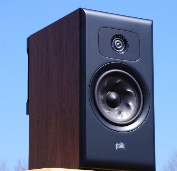

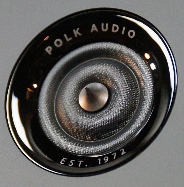

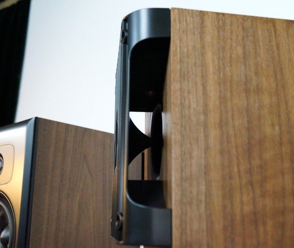

On the surface, tl200 tweeter close3.jpghe Polk Legend L200 and L400 look like a typical two-way bookshelf speaker and three-way center speaker, but many of the interesting and distinguishing design characteristics of these speakers are not ones that you would catch at a glance, so let’s scratch below the surface. To begin our discussion of the design of these Polk Legend speakers, let’s talk about the tweeter. Instead of using a dome tweeter, Polk has opted for a ring radiator which is a very different design than a dome but not one that Polk was unfamiliar with, having used ring radiators on their outgoing flagship LSiM series. The way ring radiators work is that instead of having the voice coil former affixed to a dome as in traditional dome tweeters, the voice coil former is simply connected to two large soft ringed suspension pieces: an outer ring and an inner ring. The inner ring is connected to a stationary rod in the center that also holds that needle-looking phase plug. Whereas in normal dome tweeters, the acoustic radiating surface is the dome, in a ring radiator, the acoustic radiating surface is these two large suspension rings. Normally the suspension bits in drivers are used merely to hold an acoustic radiating surface in a manner where it only has one plane of travel, back and forth.
One of the advantages of ring radiators is that ‘break-up’ modes are pushed out to much higher frequencies versus typical dome tweeters. ‘Break-up’ modes are where the radiating surface, whether that be a dome, cone, or plane, loses its shape from playing frequencies so high that it bends only part of the surface instead of the entire surface. It can really hurt the sound quality from any speaker where it is not controlled. Another advantage is that ring radiators can easily play to ultrasonic frequencies since the soft suspension piece being driven is usually much lighter than traditional dome materials.

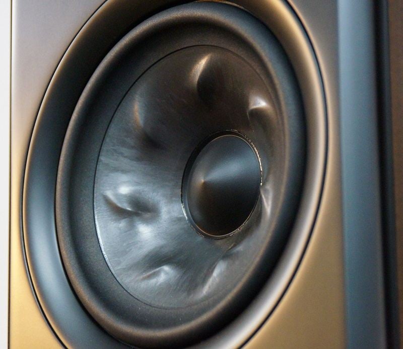

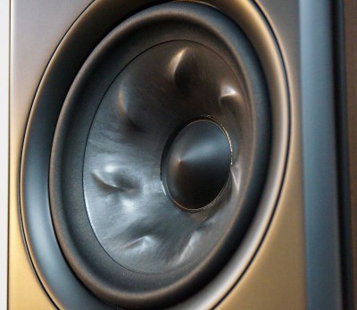

As was mentioned before, the midrange driver is a unique design in the Legend series. The cone is made out of foamed polymer and is peculiarly shaped such that Polk calls it the ‘Turbine Cone.’ The cone has seven fin-type protrusions that form a vortex pattern hence the name ‘turbine.’ The shape and number of these fins are claimed to make the cone stiffer which can drive break up modes higher in frequency where they will be easier to filter out by the crossover circuit. Lower bass is produced by the port which uses Polk’s ‘Power Port’ design that has been seen on previous higher-end speaker lines from Polk. The idea behind the Power Port is that it preserves the laminar flow of air within the port by controlling its contact with the environment from a flared cone piece that is mounted over the port opening. This should protect against port turbulence at higher drive levels better than traditional port designs. I would guess that the plate which covers the port also helps to load the lower frequency output a bit more.

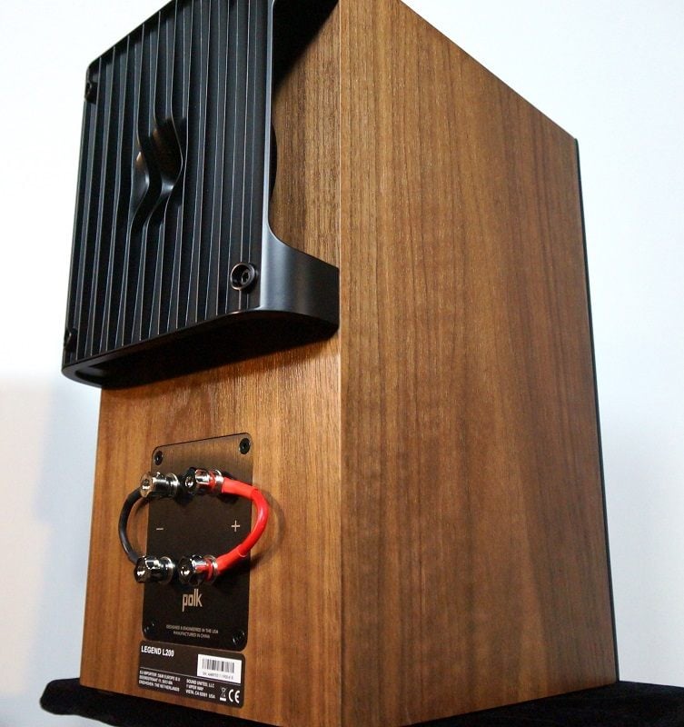

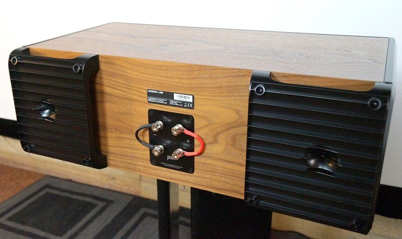

    The cabinets of the L200 al200 rear2.jpgnd L400 are stout affairs and comprise the bulk of their respective weight. I wasn’t able to get a close look at the bare drivers since a trim ring covers the frame screws, and I didn’t want to risk breaking these expensive speakers to get a peek at the internals. The cabinets feel solid, and a knock test doesn’t reveal any hollowness or any feeling of flimsiness. It’s constructed out of 3/4” MDF panels and braces with a 4/5” MDF front baffle. The braces are optimally placed according to FEA analysis and laser vibrational analysis. The midrange driver in the L400 is in an enclosed compartment so that back waves from the bass drivers do not affect its position. A healthy amount of foam and polyfill are placed in the cabinet for internal damping. There are dual 5-way binding posts lined with a wire jumper for those who want to bi-wire or bi-amp these speakers. I think the ability to bi-wire or bi-amp is a bit absurd for the L200 particularly, but I get that it is a market-demanded feature for a speaker of this price point. The speakers come with magnetically adhesive grilles that Polk claims do not cause much diffraction, and given the low-profile of the grille frames, they don’t look like they would be a significant source of diffraction.
    All in all, the L200 and L400 speakers look to be solidly-designed bookshelf and center speakers with some innovations befitting the flagship line from a major speaker manufacturer like Polk Audio. One appealing aspect particular to the L400 is the three-way design and layout of the drivers where the tweeter and midrange driver are vertically-aligned. This alignment of the tweeter and midrange plus the low crossover frequency of the midrange driver to bass drivers should ensure that there are virtually no horizontal off-axis lobing nulls that occur with so many other two-way center speakers with dual active woofers in a horizontal arrangement. That means that the sound projected by the center speaker should have good consistency over a very wide area. This is not the case with many center speakers, especially those that simply plant a tweeter between two woofers on a horizontal plane, but the L400 is a real effort to avoid that pitfall (the problems with that design approach can be read about in our article detailing the difference between horizontal vs vertical speaker designs and in our article about center channel design considerations). And now that we have talked about how the L200 and L400 speakers work, let’s see what they sound like…

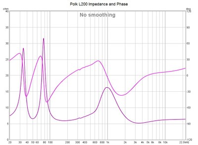

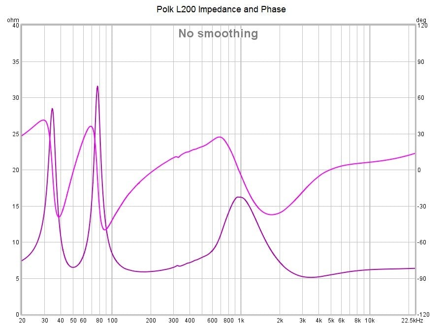

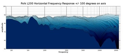

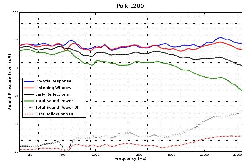

    Stereophile review with measurements of the little brother Polk L100 bookshelf speakers here:
    Stereophile Review of Polk L100

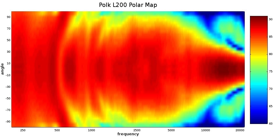

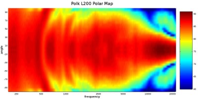

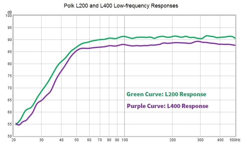

    Looks like a little bit of a tough impedance, plus a big resonance can be seen on the port output around 700Hz.
    I wonder if the bump ShadyJ saw in the response of the L200 speakers around 500-600Hz is also a port resonance showing up for that speaker?

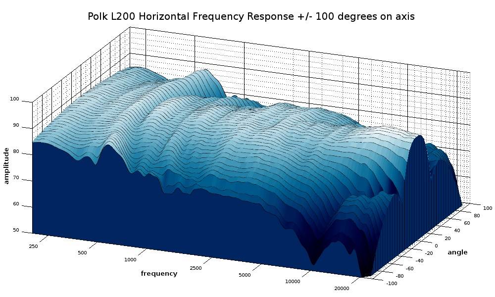

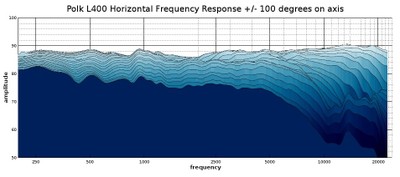

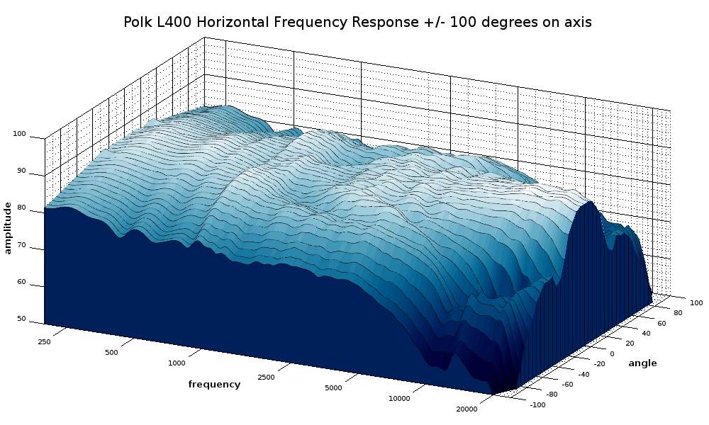

    Also, the ring radiator tweeter's dispersion is quite narrow, with it dropping off to the sides (beaming) starting as low as around 5kHz.
    I did do near-field measurements of the L200, and I do see some evidence of a resonance at around 500Hz in a near-field measurement of the port. That may be cause for that off-axis peak in that range. I am guessing it is.
