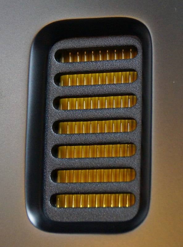

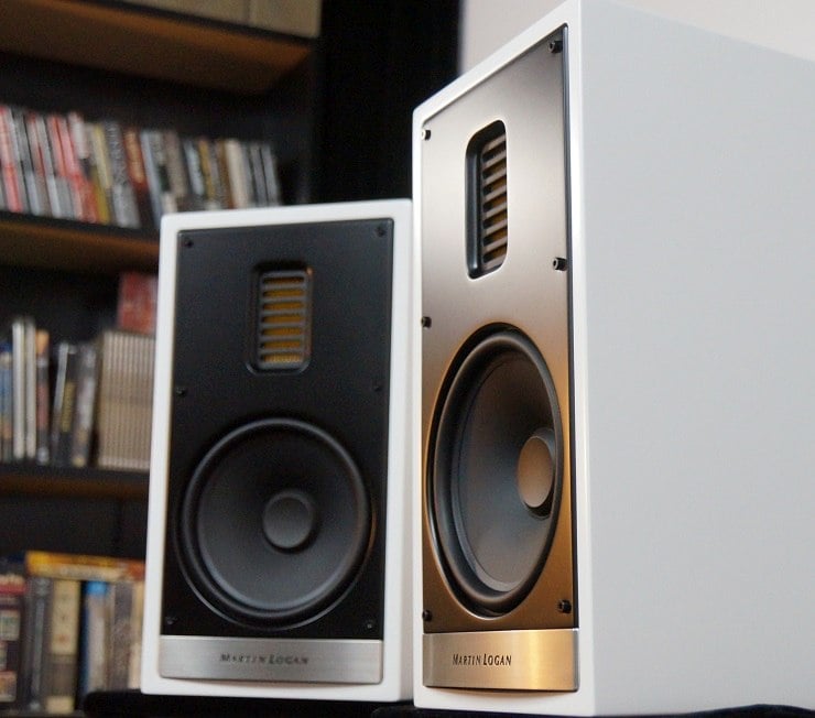

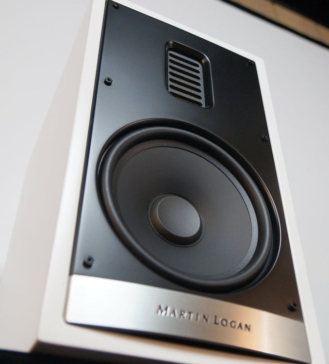

The MartinLogan
Motion 35XTi is a two-way bookshelf speaker using a 6.5” woofer and an AMT
tweeter. Let’s begin our description of the 35XTi by talking about the tweeter.
While AMT tweeters are becoming more popular, they haven’t yet overtaken dome
tweeters as the most widely used tweeter type, but they do have their

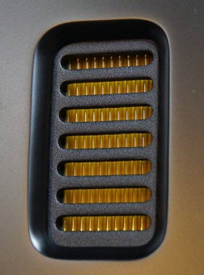

advantages. The AMT tweeter on the 35XTi is on the larger side with a 1.2”x2.4”
size. This should allow a tremendous amount of dynamic range. AMT stands for
“Air Motion Transformer”. As opposed to conventional dome tweeters that oscillate
pistonically, AMT tweeters contract and expand the folds of a pleated membrane
to produce sound. To explain using an example, imagine the folded surface of a
half-closed curtain- then line the interior folds of the curtain with
conductive rods on adjacent sides of the folds, and set two powerful magnets on
the sides of the curtain. Run some alternating current through the conducting
rods and their newfound electromagnetic field will rapidly collapse and expand
the folds of the curtain, and, in doing so, squeeze air in and out of the folds
thereby creating pressure waves that we experience as sound.
A major advantage in this design is that since the folds of the diaphragm are much deeper than they are wide, the air is ejected out at a much faster speed than the vibration of the diaphragm itself- as much as five times faster. Another advantage is the very light mass of the diaphragm that makes it very easy to move and to change direction since it does not have the momentum of the weight of typical dome tweeters. These elements give AMT tweeters an extended response well into ultrasonic frequency ranges. Also, since AMT tweeters can have a relatively large radiating surface that couples with the air, they have a very wide dynamic range.
MartinLogan 6.5" Aluminum Woofer (left pic); AMT tweeter (right pic)

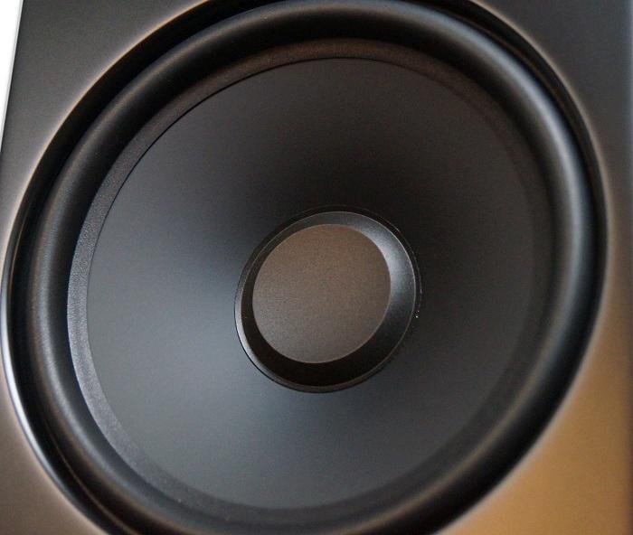

The bass driver uses an aluminum cone, and MartinLogan correctly points out that aluminum can act as a heatsink for the coil which can help alleviate thermal issues. The 35XTi uses a raised concave dustcap that MartinLogan claims reinforces the rigidity of the cone while reducing breakup modes. I am told by MartinLogan that it's superior to purely concave dustaps that tend to flex in the midpoint and do little to add structure to the cone. The raised dustcap adds structure and rigidity, which reduces radial vibration modes. Looking at the bass driver removed from the cabinet, we see a large ¾” thick magnet with a 4 ¼” diameter mounted in a cast polymer basket. It is certainly among the beefier 6.5” drivers I have seen.

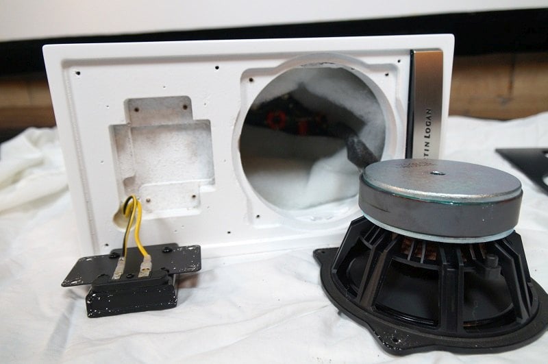

Inside view of MartinLogan Motion 35XTi Bookshelf Speaker

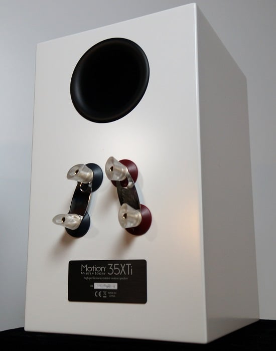

The cabin
et is
made from MDF and uses a hefty 1.2” thick front baffle with 0.7” thick side
panels. There is a healthy amount of stuffing inside to damp internal pressure
waves. The aforementioned port is mounted in the back and is 7” long with a 2
1/2” diameter. That is a pretty large port for a bookshelf speaker. It is
flared on both ends. There are no feet on the enclosure, but the speakers are
shipped with some adhesive rubber dome feet that the user has the option of
applying if they wish. The 35XTi has some cool-looking 5-way binding posts on
the back. They have to be the most stylish binding posts I have yet seen. There
are two sets of them so the speaker can be bi-amped or bi-wired. As I have
discussed in past reviews, there isn’t really a good reason to do this with
conventional home audio speakers. Bi-wiring has zero benefits, and the benefits
of bi-amplifying bookshelf speakers such as these are very unlikely to be
audible. The inclusion of this kind of option is going to cause more problems
through misuse and misunderstanding than it will ever solve. Still, it doesn’t
hurt anything so long as the instructions in the owner’s manual are followed,
and these binding posts are gnarly, so I’m not going to rag on this too hard.

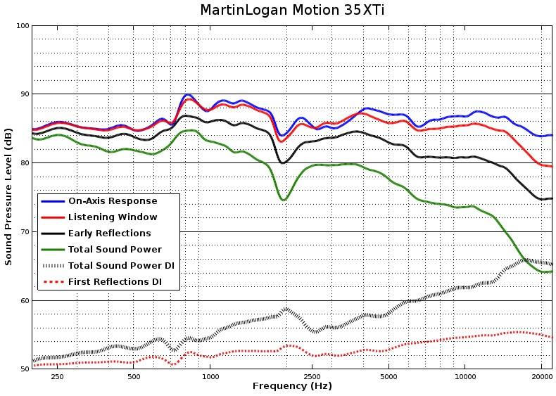

The MartinLogan Motion 35XTi was measured in free-air at a height of 7.5 feet at a 1-meter distance from the microphone, and the measurements were gated at an 11-millisecond delay. In this time window, some resolution is lost below 250 Hz and accuracy is completely lost below 110 Hz. Measurements have been smoothed at a 1/12 octave resolution.

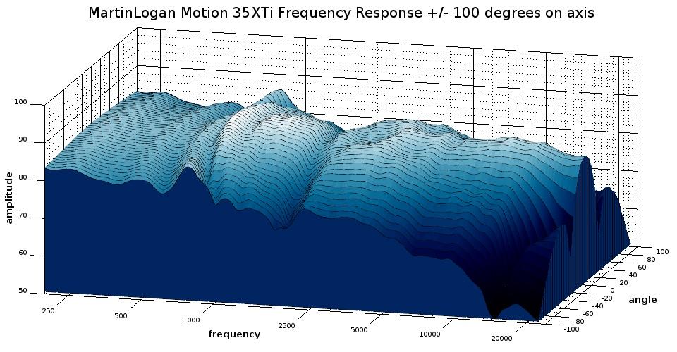

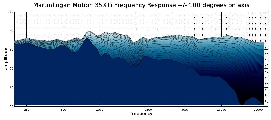

The above graph shows the direct-axis frequency response and other curves that describe the speakers’ amplitude response in a number of ways. For more information about the meaning of these curves, please refer to our article Understanding Loudspeaker Measurements Part 1. The most prominent feature of these responses is the elevated region from 800 Hz to about 2 kHz. If it weren’t for that bumped-up region, the 35XTi speakers would have a pretty flat response. The question is, how does that affect the sound? That is an upper midrange region, and I would guess that its effect would be to emphasize the harmonics of vocals and many instruments. This is a heavily-used frequency region, and a plateau like this is sure to color the sound. In my listening to these speakers, I didn’t notice anything particularly unusual in this region, but that could have been due to the recordings I was listening to which may not have highlighted this trait. It might not be obvious listening to the speaker’s sound by itself, but against a totally neutral response, it would be audible. One aspect about it that could hide the audibility is the shape; it is like a high-Q shelf filter, and the abruptness of the Q of this resonance keeps it tightly contained to this frequency band. If I had to guess, I would say this is a deliberate voicing of this speaker. MartinLogan says that a flat response is not ideal for real-world use. Such a voicing will essentially accentuate any lead instruments, especially vocals and human voices. This might make these speakers a good choice for those who have trouble with dialogue intelligibility. The problem is if there is already an excess of energy in this range within the recording, that could end up making that recording sound ‘shouty’ in vocals and give some ‘glare’ to instrumentals.

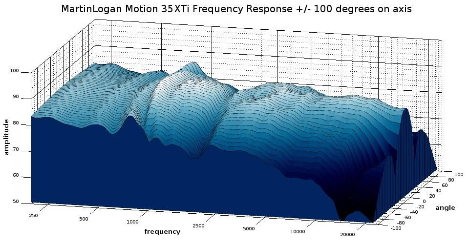

The above graphs depict the speaker’s lateral responses out to 100 degrees in five-degree increments. More information about how to interpret these graphs can be read in this article: Understanding Loudspeaker Review Measurements Part II. One thing we can see more clearly from this graph is that the 800-2000 Hz resonance seems to be composed of two different components: one that is angle dependent and another that isn’t. We can see that the crossover frequency occurs right around 2 kHz, and that the crossover circuit is not perfectly blending the woofer and tweeter. It results in a dip that is pretty mild out to 20-degrees, but does turn into a bit more significant of a dip outside of a 20 degree angle. The fullest and most neutral sound from the 35XTi will occur on-axis. One thing we can see is that the AMT tweeter is pretty well-behaved. Some of the AMT tweeters that we have come across in other loudspeakers proved to be a bit erratic, but this is one of the better AMTs that we have seen.

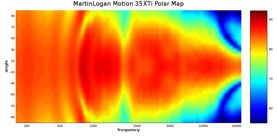

The above polar map graphs show the same information that the preceding graphs do but depict it in a way that can offer new insight regarding these speakers’ behavior. Instead of using individual raised lines to illustrate amplitude, these polar maps use color to portray amplitude and this allows the use of a purely angle/frequency axis perspective. The advantage of these graphs is they can let us see broader trends of the speaker’s behavior more easily. For more information about the meaning of these graphs, we again refer the reader to Understanding Loudspeaker Review Measurements Part II. In this graph, we get a better look at the crossover issue. If it weren’t for that crossover incongruity, the 35XTis would have very nice directivity control. Again, the tweeter seems to be doing its job well. And also, again, we can see that the most even response occurs within 20 degrees of the on-axis angle.

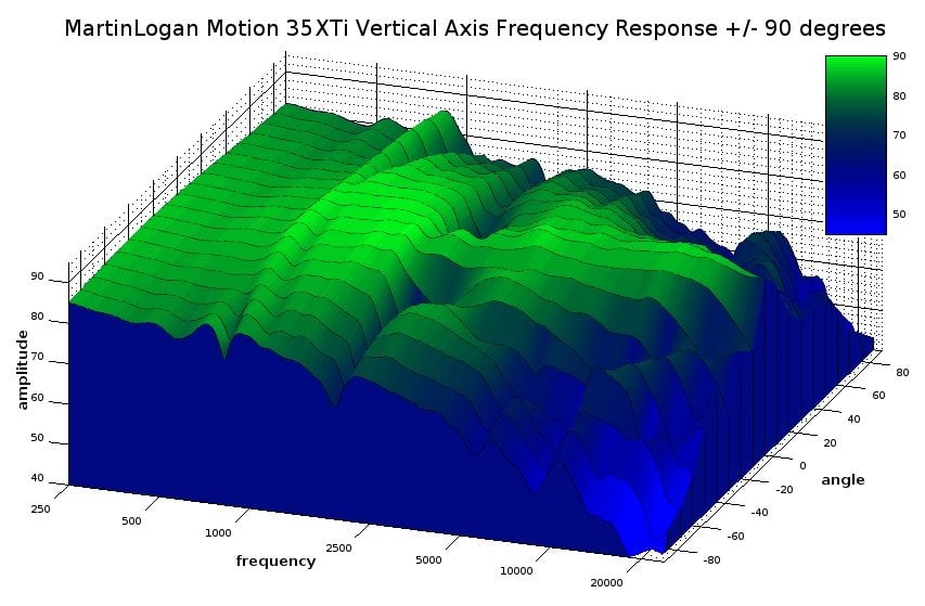

The above graph shows the 35XTi speaker’s response behavior along its vertical axis where zero degrees is directly in front of the tweeter, negative degree values are below the tweeter, and positive degree values are above the tweeter. It should be said here that the vertical response isn’t nearly as critical as the horizontal response, so an imperfect vertical dispersion is much less of a problem. As always in non-coaxial two-way speakers, we see a slight null occur off-axis. This null is quite a bit less severe than in many other loudspeakers of this type. What is far more significant is how much the tweeter narrows in dispersion on the vertical axis. Above 5 kHz, the off-axis dispersion rapidly collapses. As is so often the case, this speaker is best listened to with the listener’s ears roughly level with the tweeter. The response keeps a pretty even keel out to 10 degrees, so there is a little bit of vertical angle in which the sound should stay consistent.

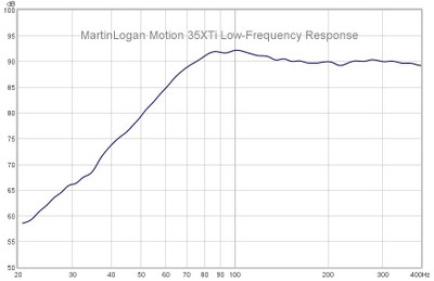

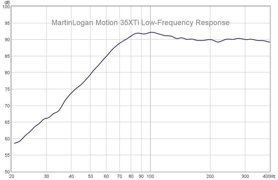

The above graphs show the MartinLogan 35XTi speaker’s low-frequency responses that I captured using groundplane measurements (where the speaker and microphone are on the ground in a wide-open area). MartinLogan specifies this speaker with a 50Hz-25kHz response with a +/-3dB window. By my measurements, that does not seem to be the case. I would say that the 35XTi is down by 10dB at 50 Hz and that its +/-3dB window starts a bit above 60 Hz. This speaker is not cut out for deep bass, and that is just fine with me. This is what subwoofers are for. I don’t normally expect bookshelf speakers to tackle deep bass, and there are significant compromises that must be made when they attempt that. We do see a slight amount of extra energy produced by the port, but it shouldn’t be enough to color the sound much. MartinLogan’s overly-optimistic extension rating for the 35XTi notwithstanding, this is not a bad low-frequency response. Boundary reinforcement might be able to extend the bass to get usable output to below 60 Hz, so users who don’t have a subwoofer handy can experiment with placement near room surfaces to increase the bass response.

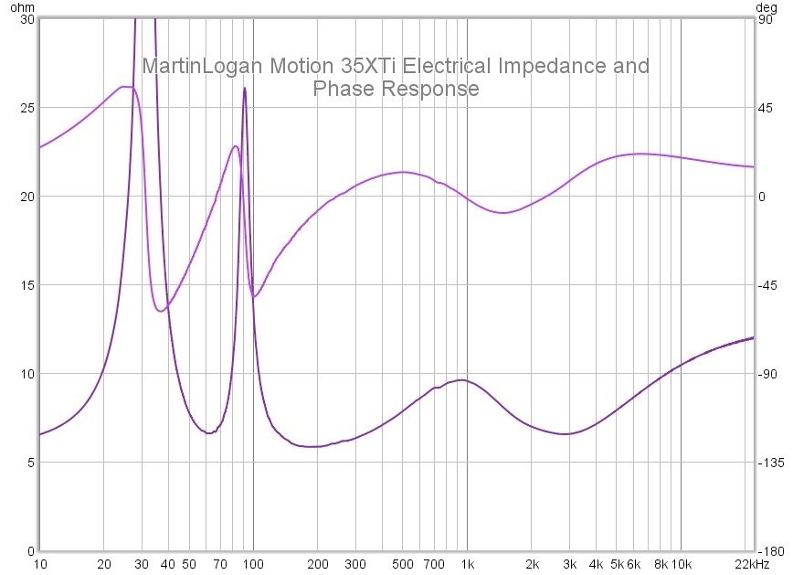

The above graphs show the electrical behavior of the MartinLogan 35XTi speakers. MartinLogan characterizes these as 4-ohm speakers, and I find that to be a very conservative rating. They could easily have specified these to have a 6-ohm nominal load, and I would not have argued. The minima occur at 180 Hz at just a hair under 5 ohms, but that is with a not-terrible phase angle. Most amplifiers, even cheap ones, should be able to drive these speakers just fine. This might be a tough load for a cheap amp to push at a high drive level for a long time, but other than that, it’s not something to worry about (not that anyone is going to use a $1,300 speaker set with an entry-level amplifier). Port tuning looks to be a bit above 60 Hz. I measured the 35XTi speaker’s sensitivity at 88.2 dB for 2.83v at 1 meter which is lower than MartinLogan’s spec of 92 dB for 2.83v at 1 meter. That is a fairly significant difference, but 88.2 is still a bit above average for bookshelf speakers in this class.
